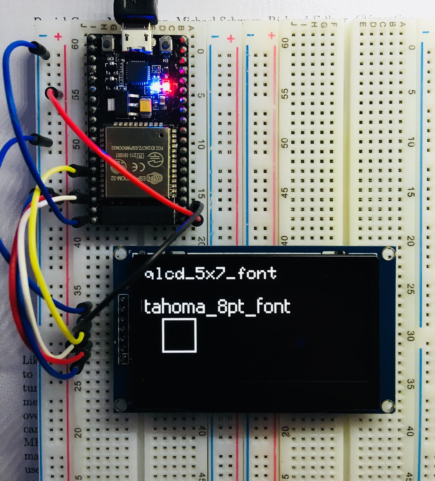

Falls jemand sowas sucht ...
https://www.amazon.de/Displaymodul-Arduino-SSD1309-Parallel-Schnittstelle/dp/B0749DYGSW/ref=sr_1_15?ie=UTF8&qid=1515855635&sr=8-15&keywords=oled+display+arduino
https://github.com/imxieyi/esp32-i2c-ssd1306-oled (Achtung den PURE-C
Branch clonen!)
Auf I2C muss man noch etwas loeten:
_
You have to prepare the board before it will work:
Remove R17 and place it on position of R15
Solder a short or 0 ohm on position R13
Solder a short or 0 ohm on position R18 or connect the CS pin to ground
Connect the OLED display to the ESP with Gnd, 3.3V, SCL and SDA
also connect the RES pin of the OLED display to the ESP_reset_pin. (or 3.3Vcc)
If you do not connect the CS pin to ground and the RES pin to RST the display will stay dead.
The Oled uses the normal address 3C and works perfectly well with the standard OLED SSD1306 plugin.
Angeblich waere das Display wohl ein SSD1306 - aber egal mit der Lib
lauefts!
