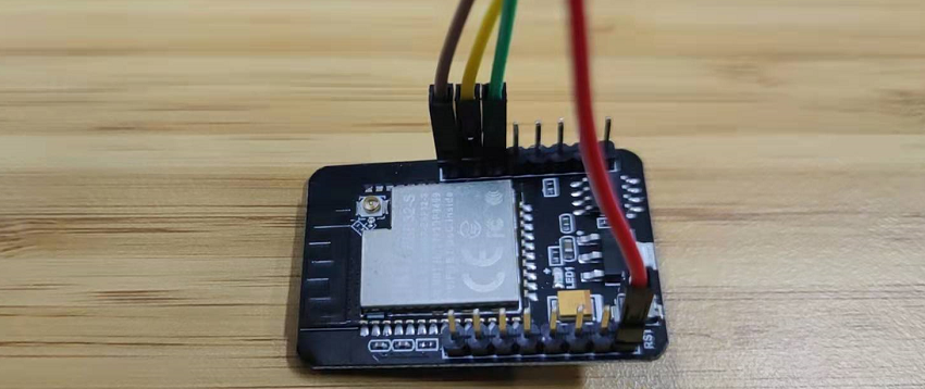

First of all, we need get ready our hardware:

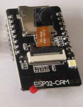

1、An ESP32-CAM dev board
2、A camera, like OV2640 or OV7670, I use the OV2640 for test
(siehe 图片1)
Ps:I think the OV2640 for test, the OV7670 better for projects

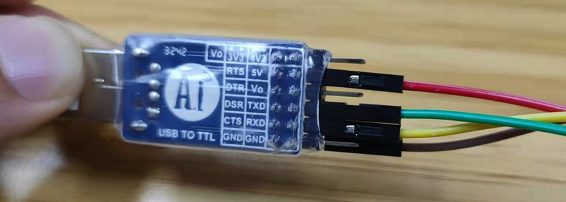

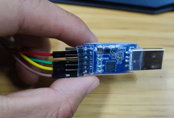

3、TTL to USB module
(siehe 图片2)

Step 3
Put your ESP32-CAM link to TTL to USB module
TTL to USB 5V link ESP32-CAM 5V
TTL to USB GND link ESP32-CAM GND
TTL to USB TXD link ESP32-CAM U0R
TTL to USB RXD link ESP32-CAM U0T
Like this:
(siehe 图片3、4)

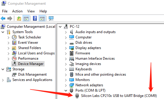

Take your TTL to USB module into USB interface of your computer, and
open your PC Manage——Device Manager——Ports, remember your COM
(siehe 图片5)

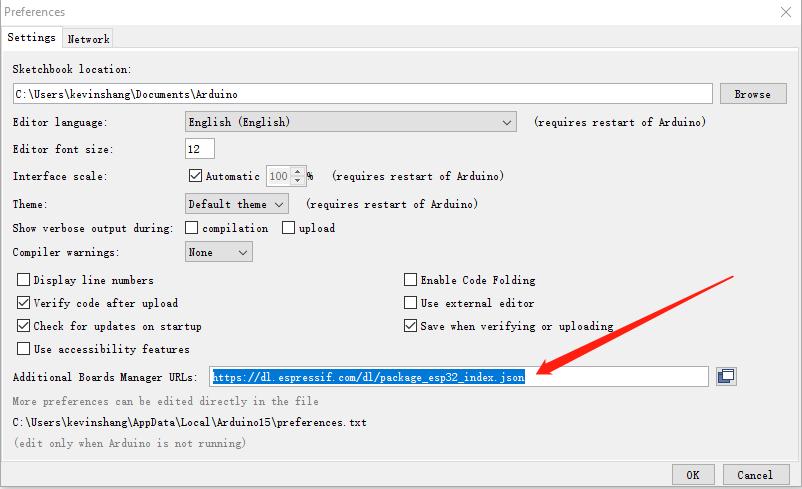

Step 5
Open your Arduino IDE, File——Preferences, take
https://dl.espressif.com/dl/package_esp32_index.json into Additional
Boards Manager URLs
(siehe 图片6)

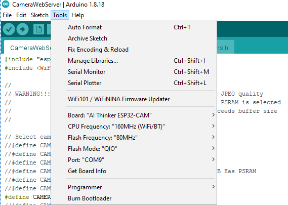

Step 6
Click Tools, find Board, choose AI Thinker ESP32-CAM, find CPU
Frequency, choose 160MHz(WiFi/BT), find Port, choose your own COM(in
Step 4)
(siehe 图片7)

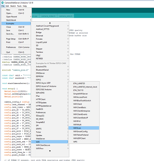

Step 7
Click File——Examples——WiFi——WiFiScan
(siehe 图片8)
