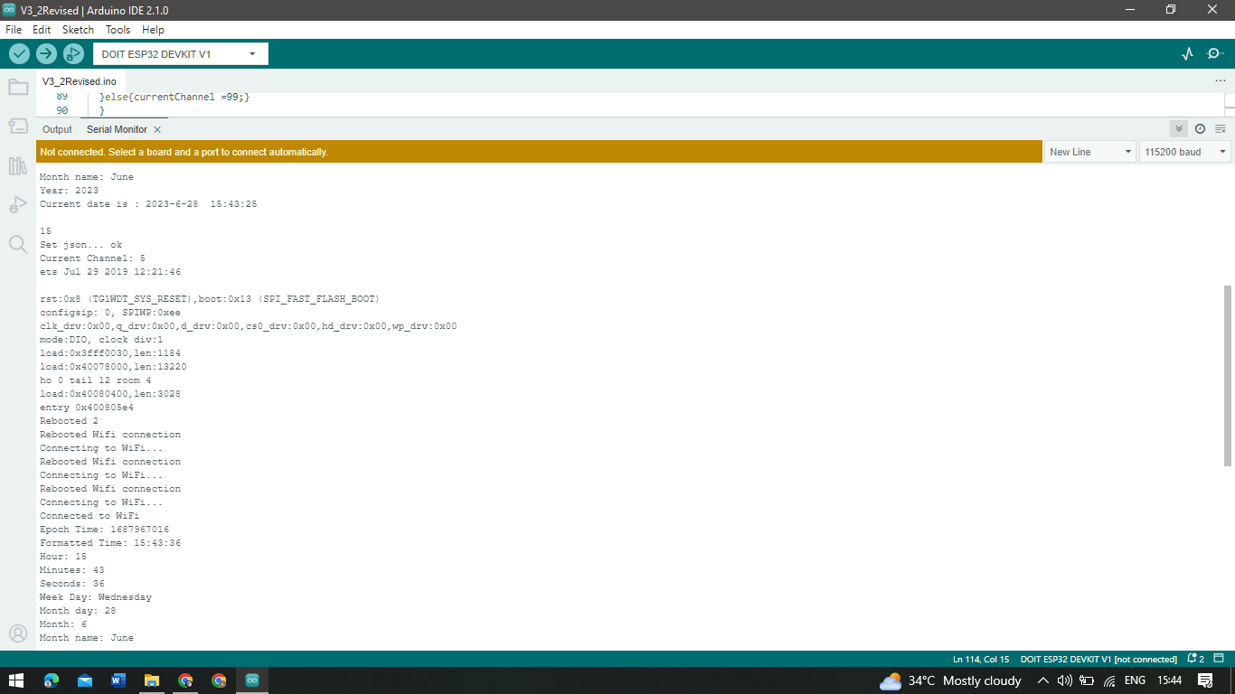

Hello,
I have a issue, I ran a code, it ran perfectly, then I made changes in
the loop. Before making the changes, I wrote a separate code according
to the changes I made, and ran it, It worked perfectly as well. When I
combined the original code, and the code separately. Changed the
variables, removed a small "; " missing type errors. Ran the code. It
connected to wifi, then when I pressed button on IR , it showed 2, and
after sending the data to firebase. It started to print connecting to
wifi and connected to wifi. There was no internet connectivity issues,
because the previous code did the same thing and it ran smoothly. while
This after I press a key on IR remote says Connected to wifi.
I want to know if this issue is code based which I highly doubt because
I have debugged it multiple times or if It is caused by program storage
space because it is 86% where as global variables use 14%.So, my program
resets After I press a button on the remote and it shows the digit.
https://hastebin.com/share/wahubaguca.cpp
Please help me solve this problem, I have been at it for days.

von Monk (Gast)
If you can post 84 kB images, you can also attach source code files.
Your file is much smaller, but also larger files even several megabytes
work fine.
Reduce your code step by step to see when it start working again. Then
you know which part causes the problem. E.g. you could start with the
block that produces the JSON output.
von Humza U. (humza_u)
That's what I did, I first remove IR related code then test the rest, It
worked fine, Then I removed the JSON and rest, to check the IR related
code, and it worked fine as well. but when I test both together, it
works but whenever I pressed button to see IR code, it resets the whole
program.

von Stefan F. (Gast)
const int numChannels = 12;
const unsigned long channelHex[numChannels] = {...}
for (int i = 0; i <= 99; i++)
   if (results.value == channelHex[i]) ...
You read much more array elements, than exist. Maybe that triggers the
restart.
