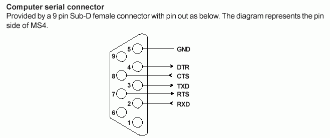

i have a haematology cell-counter device. in the manual book it's said
that it can be connect to pc via rs232 cable connection. the
configuration rs232 on that device i enclose in the rs232.doc
i have try to laplink and non cross rs232 cable, but it's not working
at all ( i can't receive and transfer data).
my question : how rs232 configuration on the pc side ? (on the device
side you can take alook at file rs232.doc).
thank you, and please respon asap ....

hi markus, it's me again
i have A haematology cell counter DEVICES.  into the manual book it's
said that it CAN connect to PC via rs232 cable connection. the
configuration rs232 on that DEVICE i enclose (rs232.gif), i'v try with
laplink and non CROSS rs232 cable, but it's not working at all(i
can't receive and transfer DATA).  my question:  how rs232
configuration on the PC side?  (on the DEVICES side you CAN take alook
at file rs232.gif).  thank you, and please respon asap....
Hi
Maybe you have to change configuration in your COM-Port.
Your Devide uses things like bits per second, databits, parity and
stopbit. That configuration of the PC has to be the same as it is in
your Device.
