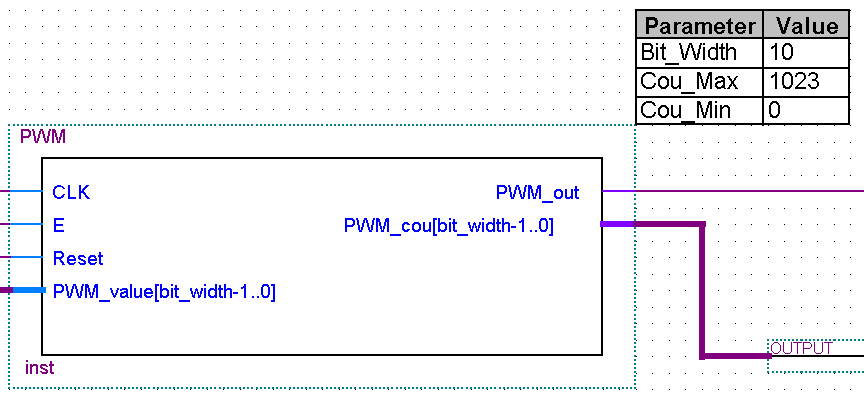

Gast #680820
> .. denn wenn du irgenwo an einer Stelle im Code was ändern musst, darfst du
> nicht vergessen erneut ein Symbol-File zu erstellen ..
Solange man nichts an der Schnittstelle ändert, muss man auch keine neue
Symbol-File erstellen.
In der Symbol-File wird nur die entity grafisch umgesetzt.
>> PWM.bdf >>
WARNING: Do NOT edit the input and output ports in this file in a text
editor if you plan to continue editing the block that represents it in
the Block Editor! File corruption is VERY likely to occur.
Copyright (C) 1991-2007 Altera Corporation
Your use of Altera Corporation's design tools, logic functions
and other software and tools, and its AMPP partner logic
functions, and any output files from any of the foregoing
(including device programming or simulation files), and any
associated documentation or information are expressly subject
to the terms and conditions of the Altera Program License
Subscription Agreement, Altera MegaCore Function License
Agreement, or other applicable license agreement, including,
without limitation, that your use is for the sole purpose of
programming logic devices manufactured by Altera and sold by
Altera or its authorized distributors.  Please refer to the
applicable agreement for further details.
(header "symbol" (version "1.1"))
(symbol
  (rect 16 16 320 144)
  (text "PWM" (rect 5 0 30 12)(font "Arial" ))
  (text "inst" (rect 8 112 25 124)(font "Arial" ))
  (port
    (pt 0 32)
    (input)
    (text "CLK" (rect 0 0 21 12)(font "Arial" ))
    (text "CLK" (rect 21 27 42 39)(font "Arial" ))
    (line (pt 0 32)(pt 16 32)(line_width 1))
  (port
    (pt 0 48)
    (input)
    (text "E" (rect 0 0 7 12)(font "Arial" ))
    (text "E" (rect 21 43 28 55)(font "Arial" ))
    (line (pt 0 48)(pt 16 48)(line_width 1))
  (port
    (pt 0 64)
    (input)
    (text "Reset" (rect 0 0 29 12)(font "Arial" ))
    (text "Reset" (rect 21 59 50 71)(font "Arial" ))
    (line (pt 0 64)(pt 16 64)(line_width 1))
  (port
    (pt 0 80)
    (input)
    (text "PWM_value[bit_width-1..0]" (rect 0 0 130 12)(font "Arial" ))
    (text "PWM_value[bit_width-1..0]" (rect 21 75 151 87)(font "Arial"
    (line (pt 0 80)(pt 16 80)(line_width 3))
  (port
    (pt 304 32)
    (output)
    (text "PWM_out" (rect 0 0 47 12)(font "Arial" ))
    (text "PWM_out" (rect 236 27 283 39)(font "Arial" ))
    (line (pt 304 32)(pt 288 32)(line_width 1))
  (port
    (pt 304 48)
    (output)
    (text "PWM_cou[bit_width-1..0]" (rect 0 0 121 12)(font "Arial" ))
    (text "PWM_cou[bit_width-1..0]" (rect 162 43 283 55)(font "Arial" ))
    (line (pt 304 48)(pt 288 48)(line_width 3))
  (parameter
    "Bit_Width"
    "10"
  (parameter
    "Cou_Max"
    "1023"
  (parameter
    "Cou_Min"
    "0"
  (drawing
    (rectangle (rect 16 16 288 112)(line_width 1))
  (annotation_block (parameter)(rect 320 -64 420 16))
