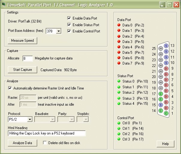

Hallo
Ich habe ein komplexes und komfortables Programm geschrieben, das es
erlaubt, mit dem Parallel Port ein digitales Oszilloskop zu betreiben.
Es enthält einen Logik Analysator für serielle Protokolle. Die Ausgabe
erfolgt in farbigen Grafiken.
Das Programm und sein Sourcecode stehen gratis zur Verfügung.
Ich bitte die Betreiber dieser Seite mindestens einen Link auf der
Oszilloskop Seite und zu der Logic Analyser Seite zuzufügen. Besser noch
einen Abschnitt zum Thema.
Elmü
Download und Artikel:
http://www.codeproject.com/KB/system/17ChannelLogicAnalyzer.aspx
Features:
* Digital Oscilloscope / Logic Analyzer with up to 17 input lines
* Uses the parallel (printer) port for input.
* While Logic Analyzers normally are very expensive, this one is for
zero cost
* Written in speed optimized C++ to get the maximum possible sample
rates
* The program is a stand alone single EXE file which neither needs any
additional DLLs nor any framework. It runs out of the box
* Runs on all Windows platforms (95, 98, ME, NT, 2000, XP, 2003, Vista,
2008, Windows 7, 2008 R2)
* Runs on 32 Bit Windows and 64 Bit Windows
* When first run, installs a driver to access hardware IO ports on all
NT platforms
* Plays a sound via PC speaker to prove that the driver works correctly
* Shows the actual state of the input lines life in the LED's of the GUI
* Captures up to 500.000 samples / second (depending on your hardware
and OS)
* Captures to memory (rather than disk) for maximum speed
* Capturing runs always with the maximum frequency that the hardware
allows
* Memory saving capture technology stores only the changes of the input
lines rather than storing all lines with each sample that is taken
* The capture process is independent of data analyzing so you can try
various settings to display the captured data in the best way
* The analyzer generates coloured oscilloscope diagrams with a raster
grid
* The output is written into an HTML file and one or multiple GIF files
* So the analyzer results can easily be shared with other people who
must not install any program to view a proprietary binary format
* You can write an individual heading into each analyzer output to
distinguish them later in a multitude of files
* When analyzing data, you can choose to delete old analyzer output or
keep the old files
* The time axis shows absolute or relative time with microsecond
precision (Performance Counter)
* Automatic detection of inactive input lines shows only the channels
that have activity
* Automatic detection of idle time cuts out long phases of inactivity
* Automatic detection of input frequency chooses the adequate raster
unit like on a real oscilloscope (10 µs, 20 µs, 25 µs, 50 µs, 100 µs,
etc..)
* Automatic detection of context switches of the operating system
* Decoding of serial protocols like I2C Bus, PS/2 Bus, SMBus, ModBus,
SPI Bus, Asynchronous (RS232, RS422, RS485), Infrared Remote Controls,
Smartcards is partially already implemented or may be added by you.
* Decoded serial data (Start Bit, Parity, Acknowledge, Stop Bit) and the
Byte that they represent is written into the diagram
* Very cleanly written source code with a proper error handling and
plenty of comments

Hab mir schon mal die Hilfe durchgelesen, bin mir bei einigen Dingen
noch nicht so ganz sicher. Wenn ich jetzt z. B. die serielle
Schnittstelle abhorchen möchte dann leg ich den TX meiner seriellen an
z. B. Status 0, GND an z. B. Pin 25, stelle unter Analyse die
Schnittstelle ein und leg los?
Wo ich mir auch noch nicht so sicher bin ist die Sache mit der
Überprüfung der Spannungen. Meine Serielle "liefert" +3V - 0V. Ich hab
mal einige Pins an meim paralellen nachgemessen. Was mir schon komisch
vorkommt wenn ich die GNDs gegeneinander messe ham die teilweise 4,45V??
Die anderen Pins ham teilweise 4,45V und teilweise 0V.
Was mach ich falsch.

Nein
Das solltest Du auf keinen Fall tun. Die serielle Schnittstelle gibt
Spannungspegel aus, mit denen Du die Druckerschnittstelle zerstören
kannst.
von Elmü (Gast)
Hallo Stefan
"mal" lesen reicht nicht.
Lies den Artikel bitte GRÜNDLICH!
Die serielle Schnittstelle liefert positive und negative Signale.
Die kannst du nicht einfach mit der parallelen verbinden.
Siehe Wikipedia: RS232!
Ausserdem kannst du auf dem SELBEN PC nur dann Daten der seriellen
messen (natürlich über einen Pegelwandler) wenn diese langsam sind (z.B.
4800 Baud) Ansonsten fressen dir die Treiber der Seriellen zu viel CPU
weg und du bekommst lange Aussetzer in denen du nix messen kannst.
(siehe Abschnitt Context Switch)
Also:
1.) Entweder niedrige Baudrate
2.) Serielle Kommunikation mit zweitem PC messen
Wenn du ein Modem hast, kannst du das gewandelte RS232 Signal IM Modem
selbst abgreifen, dort wo es aus dem Pegelkonverter herauskommt (z.B.
MAX232 von Maxim)
Was das Messen der Parallelen angeht das ist ausführlich im Artikel
beschrieben. Allein Spannungen messen reicht nicht. Du musst das mit den
Widerständen so probieren wie beschrieben.
Was deine seltsamen Messungen angeht:
Kann es sein, dass in deinem Kabel nicht alle Adern verbunden sind ?
Elmü
> and OS)
was kommt denn real so raus unter NT oder XP mit dem Parallelport
Treiber? Vor allem wie sieht die Sampleratengenauigkeit unter XP aus
wenn dem Programm mal kurz der Task entzogen wird oder Interrupts
bearbeitet werden? Als ich Ende der 90er (WIN95/NT40) mal was über den
Parallelport einlesen musste hatte ich teilweise über 100ms Aussetzer.
