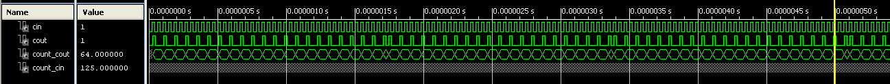

library IEEE;
use IEEE.STD_LOGIC_1164.ALL;
use IEEE.NUMERIC_STD.ALL;
entity Divider is
    Port ( cin : in  STD_LOGIC;
           cout : out  STD_LOGIC);
end Divider;
architecture Behavioral of Divider is
signal cnt : integer range 0 to 124 := 0;
signal enable : std_logic;
begin
   process begin
      wait until falling_edge(cin);
      if cnt<124 then cnt <= cnt+1;
      else            cnt <= 0;
      end if;
      if cnt<64 then  enable <= '1';
      else            enable <= '0';
22
      end if;
23
   end process;
24
25
   cout <= cin when enable='1' else '0';
26
27
end Behavioral;
Und braucht gerade mal
Device Used   XC9536XL-5-PC44
Macrocells    Pterms         Registers     Pins         Function Block Inputs
9/36  (25%)   16/180  (9%)   8/36  (23%)   2/34  (6%)   15/108  (14%)
Diese Testbench
LIBRARY ieee;
USE ieee.std_logic_1164.ALL;
USE ieee.numeric_std.ALL;
USE ieee.math_real.ALL;
use std.textio.all;
use ieee.std_logic_textio.all;
ENTITY tb_divider IS
END tb_divider;
ARCHITECTURE behavior OF tb_divider IS
    -- Component Declaration for the Unit Under Test (UUT)
    COMPONENT Divider
    PORT(
         cin : IN  std_logic;
         cout : OUT  std_logic
22
    END COMPONENT;
23
24
25
   --Inputs
26
   signal cin : std_logic := '0';
27
28
   --Outputs
29
   signal cout : std_logic;
30
31
   signal count_cout : real := 0.0;
32
   signal count_cin  : real  := 0.0;
33
34
BEGIN
35
36
  -- Instantiate the Unit Under Test (UUT)
37
   uut: Divider PORT MAP (
38
          cin => cin,
39
          cout => cout
40
41
42
   cin <= not cin after 10ns;
43
44
   count_cout <= count_cout+1.0 when rising_edge(cout);
45
   count_cin  <= count_cin+1.0  when rising_edge(cin);
46
47
   process
48
   variable l : line;
49
   variable r : real;
50
   begin
51
      wait for 1 ms;
52
      write(l, string'("teilerverhaeltnis: "));
53
      r := count_cin/count_cout;
54
      write(l, real'image(r));
55
      writeline(output, l);
56
   end process;
57
END;
zeigt dann an, dass das Ganze prinzipiell geklappt hat:
teilerverhaeltnis: 1.953125e+00

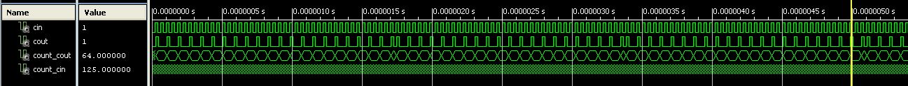

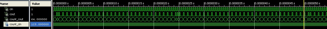

Aber auch die elegantere Lösung macht sich nicht ohne:
library IEEE;
entity Divider is
end Divider;
signal cnt : unsigned (6 downto 0) := (others=>'0');
signal enable : std_logic := '0';
begin
   process begin
      else            cnt <= (others=>'0');
      end if;
      enable <= cnt(0) after 7 ns;
      if cnt=0 or cnt=60 then enable <= '1' after 7 ns;
22
      end if;
23
   end process;
24
25
   cout <= cin after 7 ns when enable='1' else '0' after 7 ns;
26
27
end Behavioral;
Ich habe hier mal für die Simulation noch ein paar Zeiten eingeführt, um
zu sehen, wie sich das Ganze in etwa verhält.
Lediglich 2 PT für den zweiten Vergleicher werden zusätzlich benötigt:
9/36  (25%)   18/180  (10%)  8/36  (23%)   2/34  (6%)   15/108  (14%)
von Georg Bunter (Gast)
Ah ja, du gibst bei cnt=0 und bei cnt=60 jeweils noch einen Impuls dazu.
Dann gibt es auf 125 Eingangsimpuls 62 + 2 = 64 Impulse.
Hübsch.
Ich habe mal den Schaltplan, den ich ganz oben gepostete habe
entdröselt:
Da ist ein Zähler (1/2 74HC390), der zählt von 0...4
Das Nor-Gatter lässt nur bei Zählerstand 0, 1, 2, 3 die Eingangsimpuls
durch.
Bei Zählerstand 4 kommen die Eingangsimpulse nicht durch.
Es werden also 4 von 5 Impulsen durchgelassen.
Also ist es ein Teiler durch 1,25
Werden drei solche Teiler hintereinandergeschaltet haben wir einen
Teilerfaktor von 1,953125  QED
