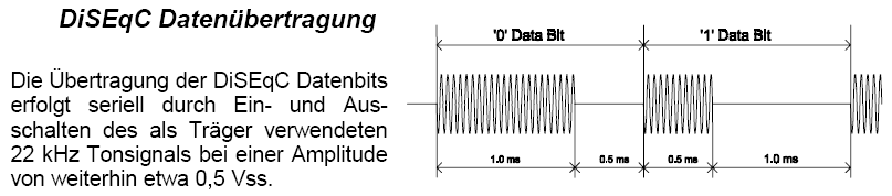

Die Datenkommunikation bei USALS bzw. DiSEqC erfolgt mit aufmodulierten
22kHz-Signalen (siehe Anhang).

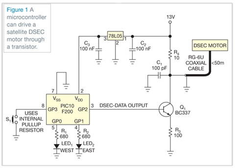

von ingenium (Gast)
Microcontroller drives DSEC motors
Use satellite disk motor in stepper-motor applications.
http://www.edn.com/article/511510-Microcontroller_drives_DSEC_motors.php
von Martin M. (martin69)
@ingenium:
vielen Dank für den Link.
Was mich wundert ist, daß das 22kHz-Signal bei der angegebenen Schaltung
digital zu sein scheint.
Ich habe mal den Entwickler des Teils angemailt. Mal sehen, ob ich eine
Antwort von ihm bekomme.
Martin
Nun kam die folgende Antwort von dem Entwickler. Er hat mir erlaubt, den
Inhalt der Email hier rein zu kopieren:
First of all, here are the documents used, otherwise, the circuit would
not have been designed:
-1- EUTELSAT: Positioner application note version 1.0
-2- EUTELSAT: Bus functional specification version 4.2
-3- EUTELSAT: Application information for using a PIC microcontroller in
DiSEqC and simple switcher Versiuon 1.0 (based on an old PIC16C620)
-4- ELEKTOR ELECTRONICS 9/2006: (page46) DiSEqC monitor, PIC listens in
on satellite receiver control bus, based on a PIC16F628
-5- diseqc12_navod_fw114_fw115.zip, from Hynek GAJDA (Tcheque republic)
based on a PIC16F84A
The most important thing is to well undestand the bus functionality,
from which I wrote the assembler code EMITMSG (in the file DiSEqC.INC).
The 22kHz is a digital square wave generated by the routine "emit22kHz"
(in the file DiSEqC.INC), and holds the message data format, as
specified in reference 2, pages 8,9,10. Briefly:
- to send a bit at logic "1", you just have to send 11 cycles of 22kHz
(see routine "emit1")
- to send a bit at logic "0", you just have to send 22 cycles of 22kHz
(see routine "emit0")
Finally, emitting a binary code (1 byte + odd parity bit) consists of a
combinaison call of these two routines.
Messages hexadecimal data E0 31 69 FF (1 step to West),  E0 31 68 FF (1
step to East) and  E0 31 6B 00 (goto reference position) have been
retreived from Tables 5 and 6, pages 15 and 16, in reference 1.
Then I tried the circuit of ELEKTOR, which worked well.
Finally, I looked again at the old circuit of EUTELSAT (PIC16F620) and
tried to optimize it, with a smaller PIC, and a basic assembler code to
drive the motor 1 step to East, or 1 step to West, or return to a
reference position (0° South).
Best regards
Charaf Laissoub

von Cyrus X. (cyrus-nab)
@Martin, @Ingenium,
ich arbeite momentan an diesem Projekt mit der Schaltung des
EDN-Networks.
Habt ihr daran weiter gearbeitet? Wenn ja, welche Erfahrungen habt ihr
damit gemacht?
Ich erhalte mit der Schaltung, obwohl ich aus dem Arduino UNO direkt ein
schönes Rechtecksignal erhalte, starke Überschwinger bei steigenden und
fallenden Flanken.
Ich habe sie nur leicht abgeändert um sie mit dem Arduino zu verwenden.
Hierzu habe ich den oberen Teil zur Spannungsregelung entfernt, da der
Arduino eine interne Spannungsregelung besitzt.
Danke für eure Hilfe!
