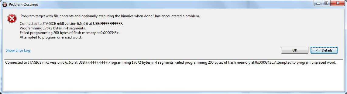

Das flash läßt sich nicht programmieren:
Executing cmd.exe /C avr32program -c USB:FFFFFFFFFFFF -pjtagicemkii --gui --part AP7000 program -fcfi@0 -F elf -O 0 -v -e -R -r E:\Users\FBE\Documents\Atmel Studio\6.2\STK1000\STK1000 - DRIVERS - LCD Controller (LCD) moving bitmap example\Debug\STK1000 - DRIVERS - LCD Controller (LCD) moving bitmap example_DEBUG.elf  (WAIT)
Connected to JTAGICE mkII version 6.6, 6.6 at USB:FFFFFFFFFFFF.
Programming 17672 bytes in 4 segments.
Failed programming 200 bytes of flash memory at 0x0000343c.
Attempted to program unerased word.
Process failed with error code 1.
Ist der Flash Speicher hinüber?
