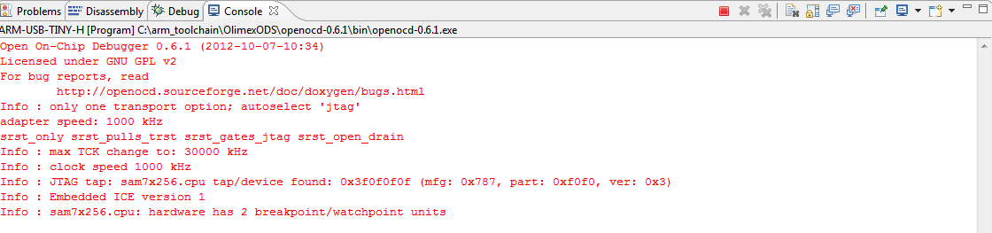

Bei Debugging kriege ich das:
source .gdbinit
target remote localhost:3333
localhost:3333: A connection attempt failed because the connected party
did not properly respond after a period of time, or established
connection failed because connected host has failed to respond.
monitor reset init
"monitor" command not supported by this target.
monitor arm7_9 force_hw_breakpoints enable
monitor arm7_9 fast_memory_access disable
symbol-file main.out
monitor flash write_image erase unlock main.bin 0x00100000
monitor sleep 100
monitor arm7_9 fast_memory_access enable
monitor reset halt
thbreak main
No hardware breakpoint support in the target.
continue
The program is not being run.
Die Verbindung mit localhost ist leider fehlgeschlagen. Hast du
vielleicht eine Ahnung, woran das liegen könnte? Ansonstens so sieht
meine Debug Configuration aus:
'Initialize' commands
monitor reset init
monitor sleep 100
'Run' commands
monitor reset halt
thbreak main
continue
Dke im voraus-
Yann
