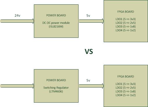

Hello people, I am designing the power supply chain of an ALTERA FPGA
and I am wondering about which power converter is better to use. My plan
is to create a power board to convert from 24v to 5v and from this power
board drive 5v to the
FPGA board. Then I will use some LDO to generate from 5v the FPGA
voltages (See picture attached). My big question is about which
component is better to convert 24v => 5v. I was thinking to use a DC-DC
power module (ISL8216M instead of a
switching regulator (LTM4606) because it is easier to implement (you
only need a pair of coupling caps and go) you will have lower switching
noise and lower heating dissipation. But I would like which are the
drawbacks of using the DC-DC
power module and if some one has another good idea, please tell me.
Hi E.P.
depends heaviliy on the power requirement of the FPGA which you did not
specify. In case the current you require is more than 1A you'l end up
with a DC/DC vonverter there also.
You will need a DC/DC switcher there anyway, you choose the one that you
like best.
The ISL8216M is a complete module and is scheduled EOL at mouser, you
might want to check whether that is available in the future. AND: it is
quite expensive.
The LTM4606 is a chip for a regulator and you have to build everything
yourself that is "contained" in the above module BUT it is cheaper.
You also might look into power supply solutions (Circuits) that supply
all of the required voltages for the FPGA. Check the datasheet or the
webpage of Altera.
rgds
