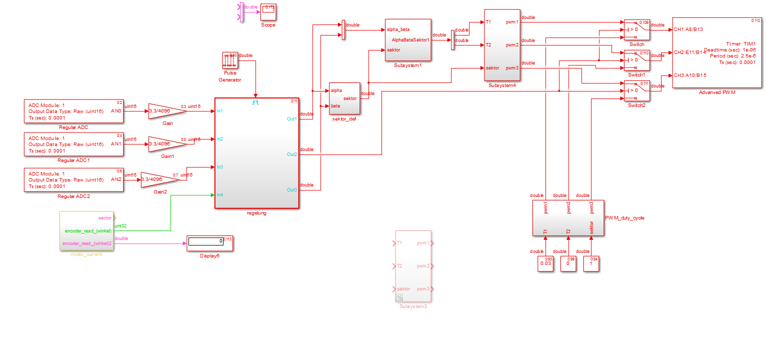

hallo,
am alex student in germany.
am working now (MAtlab/simulink) on a project: FOC (field oriented
control) of BLDC with the STM32f4 discovery board and a boostxl pack.
i have allready done the SVPWM.
and the problem now is the FOC: it didn´t work.
am using an 'inkremental' encoder for the relativ position. that give me
the mechanical angle und i had transfort it to electrical angle.
i have also using ADC of the stm32f4 phasis current.
Problem:
1) i need the absolut rotation
2) i have to give the absolut angle to my FOC.
    -> i dont know how it's working
why do you need to give the absolute angle to the foc?
You don`t need a sensor at all if you are using theese boards.
With the voltage and current measurements of all three phases and some
knowledge of the motor you are able to control it.
