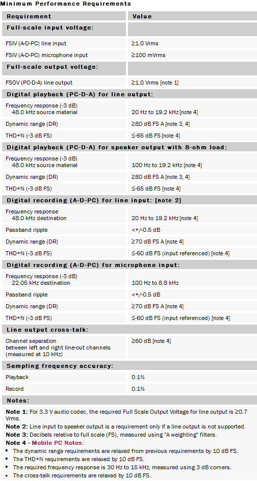

#5153691
Die AC'97-Spezifikation sagt:
> The AC ‘97 Revision 1.03 architecture was intended to enable low cost, yet
> high performance audio Codecs by establishing a standard split of the
> digital and analog portions of the audio subsystem.  AC ‘97 Revision 2.0
> brought low cost, and flexible integration of a modem Codec to the AC-link
> as well.
Die nachfolgende HDA-Spezifikation sagt:
> Extensive support for scalability in controller, link, and codec design to
> optimize for cost, performance, or features [...]
> The controller is physically connected to one or more codecs via the High
> Definition Audio Link.  The link conveys serialized data between the
> controller and the codecs.  It is optimized in both bandwidth and protocol
> to provide a highly cost effective attach point for low cost codecs.
Bei integrierten Soundchips kommt es oft nur auf den Preis an. Eine
Soundkarte dagegen lässt sich schlecht als Upgrade verkaufen, wenn man
am falschen Ende 50 Cent gespart hat.

#5159060
bluppdidupp schrieb:
> Die Mainboardhersteller halten sich inzwischen wohl doch etwas mehr an
> die Beispielschaltungen von Realtek und co.
Microsoft hat die Mindestanforderungen für das "Designed for
Windows"-Bapperl immer weiter hochgedreht. Z.B. Windows 7 Audio Logo
Changes
http://download.microsoft.com/download/7/E/7/7E7662CF-CBEA-470B-A97E-CE7CE0D98DC2/Win7Logo_Aud.docx
sagt:
> In real-world scenarios, few users maintain an isolated machine for audio
> streaming. However, these users reported that certain audio solutions or
> system setups provide a poor end-user audio fidelity experience.
> To solve this problem, we added a “Real World Stress” tool to the WLK 1.3
> Audio Fidelity Test. This tool simulates real-world user scenarios and
> loads on the system (such as video playback) and measures the audio
> fidelity against THD+N requirements. This prevents excessive noise that
> other hardware on the system generates.
