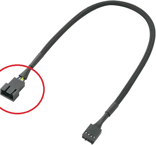

Hättest Du da evtl. einen genauen Typ, auf der Homepage von Molex kann
ich bei dieser Serie nur den Typ für Leiterplatten (THT) finden. Das
Teil für die Kabelmontage (Crimp Housing) finde ich nur als Female (der
rechte Verbinder im Bild oben)
Iche suche allerdings den linken Verbinder.

Gibts wohl nur direkt aus China.
Unofficial male connectors
Unfortunately there is no standard male connector in the KK 100 family,
but this hasn’t stopped a slew of unofficial connectors from being
produced.
http://techmattmillman.s3.amazonaws.com/wp-content/uploads/2015/06/kk100male1.jpg
Compatible KK 100 male connectors
Above is a variety of Chinese manufactured connectors I’ve purchased off
eBay and Alibaba which are designed to mate with KK 100 female
connectors. They are only found in 2, 3 and 4 positions, because, these
are the variants used for PC fans.
The quality of these is not comparable to that of the mating connectors,
but perhaps this is not so surprising, given the intended market of
these connectors.
