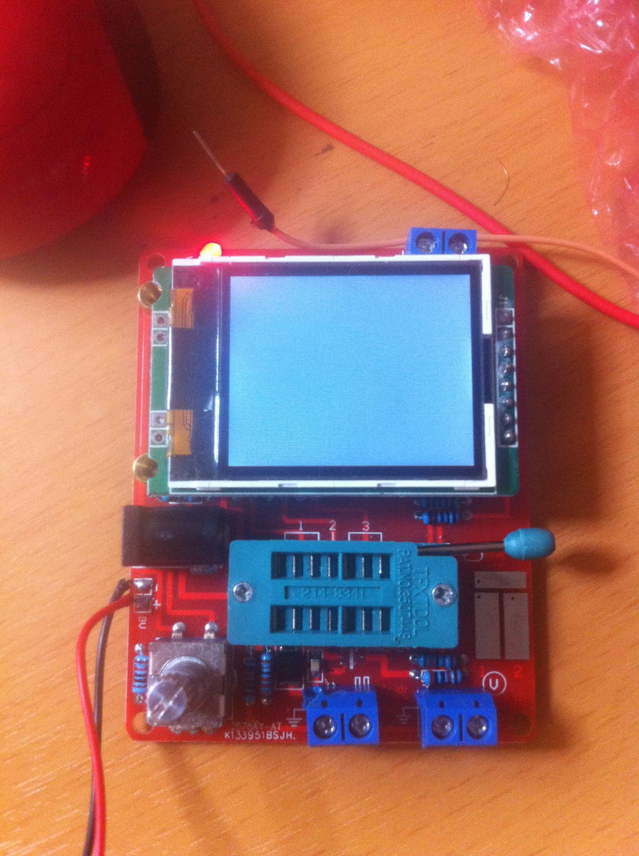

I tried to re-program a problematic GM328 that was not possible to
calibrate.
https://www.youtube.com/watch?time_continue=1&v=JCP7oWG3D3w
No matter what mega328_GM328 version I used from
https://www.mikrocontroller.net/svnbrowser/transistortester/
I always get a white blank screen.  The fuses I used are: lfuse=0xF7
hfuse=0xD9 efuse=0xFF
I even tried the versions below without success.
GM328_EZM_v1.12k_r464_EN.zip
GM328_EZM_v1.12k_r508_EN.zip
GM328_EZM_v1.12k_r541.zip
Any recommendations?
Regards,
#5789956
these boards are available with a number of different displays. looks
like your new firmware doesnt support your display.
you could read back the flash and test it against the file you wrote,
but i dont expect any differences.
do you know what display(controller) you have? if its one of those from
ebay or aliexpress you might find the information on the back of the
display, if not it might also be available on the sellers page.
then you need to find firmware for that display(controller). if you cant
you need to get the source (this project should be open source) and
modify one so that it supports your display. Also check if the pins
connected to the display correspond to those in the source.
next time make a backup of the flash if its not read protected before
you try to upgrade, if it is a chinese version with a custom display you
will have to write your own code to get it working, but its much more
likely that you just use the wrong version and there is already one
working.
OP #5792678
Horst O. schrieb:
> Hi John,
> ... tray out the version "mega328_color_kit", i have tested with
> GeekTeches GM328A, i think, it is the same display and works fine.
> Regards
Hi, I will try it and I will let you know.
BTW, the display has the following ICs. A) TI Hex Inverting Buffer and
Converter (7CA676M) CD4050BM G4 and B) AMS1117 DROPOUT VOLTAGE REGULATOR
and an SMD resistor. Nothing else.
OP #5792700
Horst O. schrieb:
> Hi John,
> Regards
It worked !!! I am very glad! Thank you for your precious advice !!
