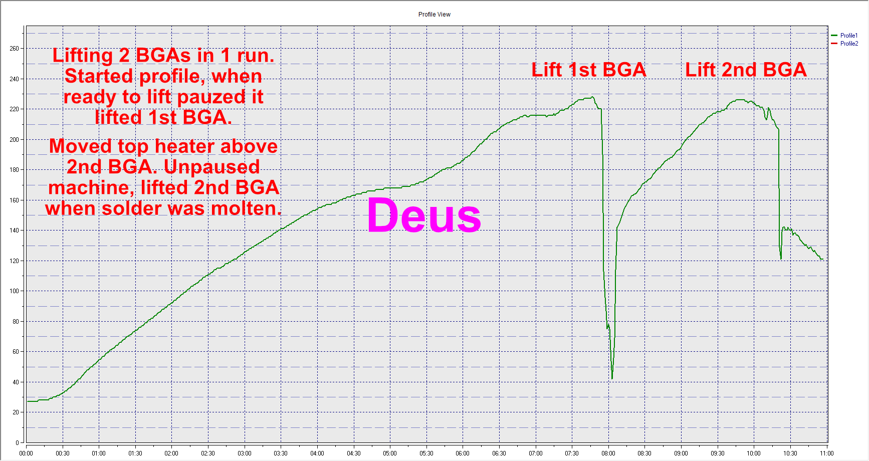

#5830666
Micha W. schrieb:
> Already contacted Elstein for pricing information about their heaters -
> maybe I'm going to build my own one...
Curious for the result. Keep me updated please ?
Another advantage of 2 zone rework stations like my Achi.
Hot air, not all but more advanced ones, use 3 zones. An IR preheater, a
HA bottom heater in the middle. You have to place the BGA above that
heaters as that runs a profile together with the 3th top HA heater.
If you need to remove 2 BGAs on the same pcb, you do the 1st, let the
machine cool off, replace pcb for the 2nd BGA, restart process.
I can start mine, do 1st BGA, pauze machine, move top heater above 2nd
heater, unpauze machine and lift 2nd BGA.
