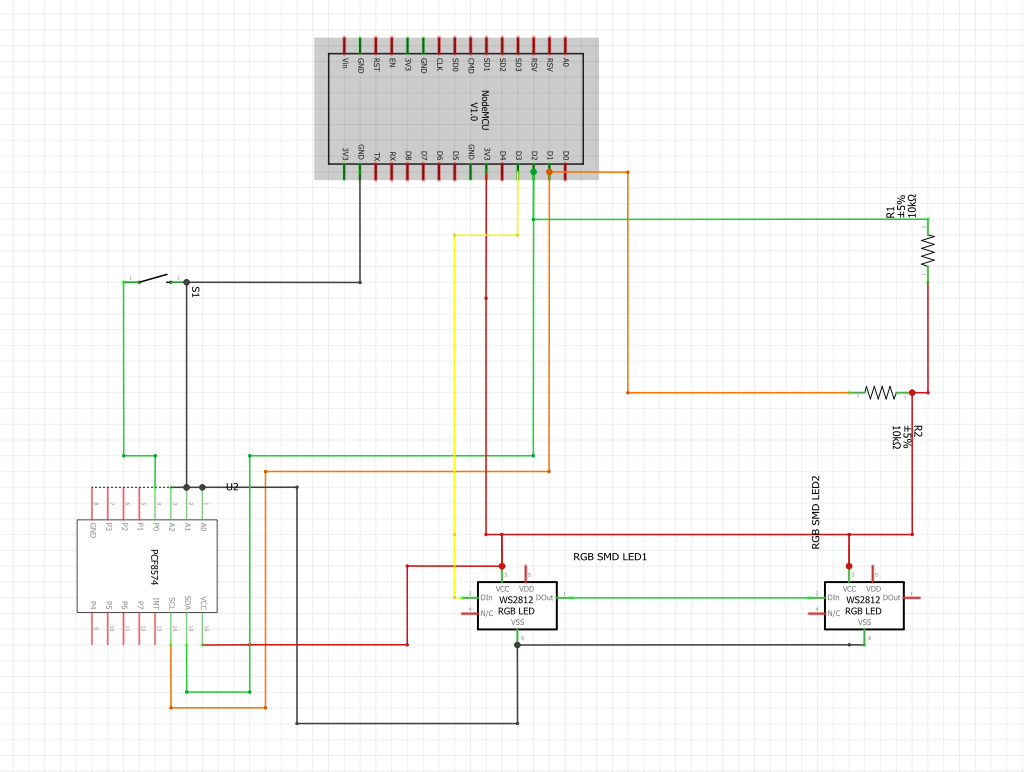

since I started working on my project again. I have just created the
schematics of my project (see attachments). Also, I am going to measure
the voltage on each pin today and post an update later.

von W.A. (Gast)
Ed S. schrieb:
> I have just created the schematics of my project (see attachments).
Pse check your attachment. You appended a fancy picture but not the
schematic for your circuit.

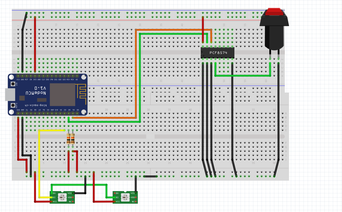

von Ed S. (ed_s)
Hello,
thanks for clearing this out! I hope the picture in this attachment is
sufficient enough. I will also provide you guys with the fritzing file
if needed.
Best regards.
von Stefan F. (Gast)
I see two possible issues.
10kΩ ist too much for the I²C Pull-Up resistors. Better use 2,2kΩ or
1,8kΩ.
The WS2812 LED might require 5V power supply and you should put a
resistor (220 - 470Ω) in the signal line. I'm not sure why this is
needed but it was suggested very often by other people.

von W.A. (Gast)
Ed S. schrieb:
You should provide a power supply for the LEDs (VDD on WS2812).
Filters on VCC line are missing at WS2812 (100nF capacitor and 150Ω
serial resistor, cf. datasheet "Typical application circuit").
Regards

von Ed S. (ed_s)
Is that really necessary? The SMDs seem to work fine even without the
VDD power supply (light up in all colors) and I have already soldered
and integrated them into the industrial buttons :d
Ok, I will connect them to the circuit and post an update (most likely
tomorrow).
Best regards
