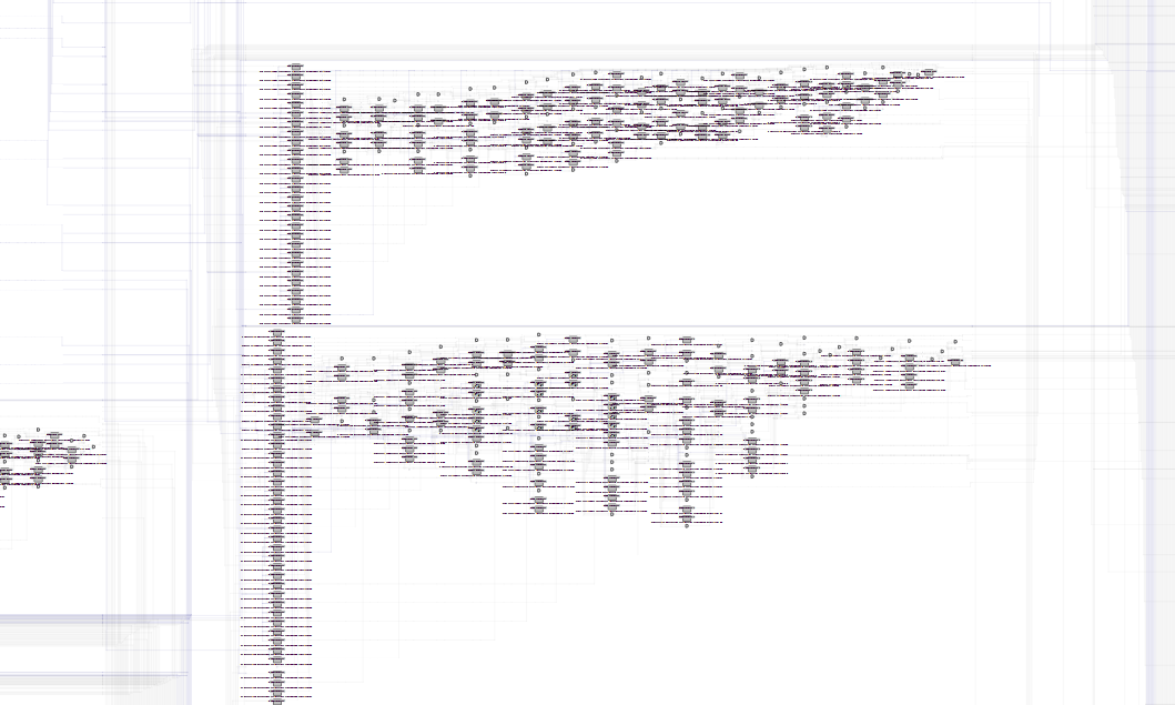

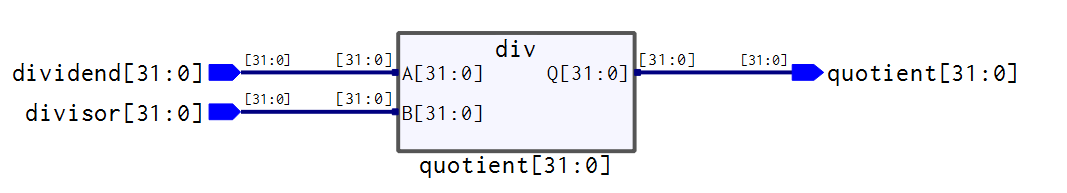

Ich habe den folgenden Code mal im Lattice Diamond durchnudeln lassen:
library ieee;
use ieee.std_logic_1164.all;
use ieee.numeric_std.all;
entity div32 is
  port
    dividend : in unsigned( 31 downto 0);
    divisor  : in unsigned( 31 downto 0);
    quotient : out unsigned( 31 downto 0)
end entity div32;
architecture bhv of div32 is
begin
  quotient <= dividend / divisor;
end architecture bhv;
Dafür werden ca. 2000 LUT4 benötigt und der Chip ist zu einem Drittel
voll:
   Number of registers:      0 out of  7209 (0%)
      PFU registers:            0 out of  6864 (0%)
      PIO registers:            0 out of   345 (0%)
   Number of SLICEs:      1095 out of  3432 (32%)
      SLICEs as Logic/ROM:   1095 out of  3432 (32%)
      SLICEs as RAM:            0 out of  2574 (0%)
      SLICEs as Carry:        593 out of  3432 (17%)
   Number of LUT4s:        2189 out of  6864 (32%)
      Number used as logic LUTs:        1003
      Number used as distributed RAM:     0
      Number used as ripple logic:      1186
      Number used as shift registers:     0
   Number of PIO sites used: 96 + 4(JTAG) out of 115 (87%)
Ich fürchte HLS macht ohne spezielles Pragma auch eine parallele Lösung
draus.
