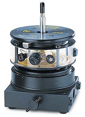

Mechanical Wave Driver https://www.pasco.com/prodCatalog/SF/SF-9324_mechanical-wave-driver/index.cfm
