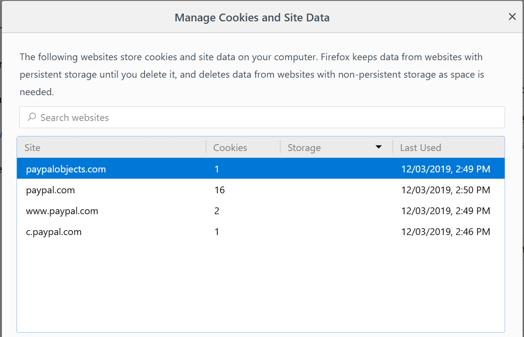

1575380742.031   7093 192.168.1.8 TCP_MISS/301 274 GET h**p://www.paypal.de/ - DIRECT/104.86.47.193 -
1575380755.156   5922 192.168.1.8 TCP_MISS/200 908 POST h**p://ocsp.digicert.com/ - DIRECT/93.184.220.29 application/ocsp-response
1575380763.547   7359 192.168.1.8 TCP_MISS/200 9054 CONNECT www.paypalobjects.com:443 - DIRECT/23.58.216.208 -
1575380763.641   7453 192.168.1.8 TCP_MISS/200 8356 CONNECT www.paypalobjects.com:443 - DIRECT/23.58.216.208 -
1575380763.656   7468 192.168.1.8 TCP_MISS/200 24399 CONNECT www.paypalobjects.com:443 - DIRECT/23.58.216.208 -
1575380763.672   7484 192.168.1.8 TCP_MISS/200 8542 CONNECT www.paypalobjects.com:443 - DIRECT/23.58.216.208 -
1575380763.688   7500 192.168.1.8 TCP_MISS/200 45818 CONNECT www.paypalobjects.com:443 - DIRECT/23.58.216.208 -
1575380764.563      0 192.168.1.8 TCP_DENIED/403 1323 CONNECT ak1s.abmr.net:443 - NONE/- text/html
1575380770.063      0 192.168.1.8 TCP_DENIED/403 1345 CONNECT www.google-analytics.com:443 - NONE/- text/html
1575380774.250      0 192.168.1.8 TCP_DENIED/403 1333 CONNECT ad.doubleclick.net:443 - NONE/- text/html
1575380775.703      0 192.168.1.8 TCP_DENIED/403 1375 GET h**p://detectportal.firefox.com/success.txt - NONE/- text/html
1575380779.563      0 192.168.1.8 TCP_DENIED/403 1323 CONNECT ak1s.abmr.net:443 - NONE/- text/html
1575380780.266      0 192.168.1.8 TCP_DENIED/403 1345 CONNECT www.google-analytics.com:443 - NONE/- text/html
1575380835.734      0 192.168.1.8 TCP_DENIED/403 1375 GET h**p://detectportal.firefox.com/success.txt - NONE/- text/html
1575380859.234  10859 192.168.1.8 TCP_MISS/000 0 CONNECT smartlock.google.com:443 - NONE/- -
1575380895.460 116288 192.168.1.8 TCP_MISS/200 9302 CONNECT t.paypal.com:443 - DIRECT/23.58.216.208 -
1575380895.773      0 192.168.1.8 TCP_DENIED/403 1375 GET h**p://detectportal.firefox.com/success.txt - NONE/- text/html
1575380896.460 122335 192.168.1.8 TCP_MISS/200 12400 CONNECT t.paypal.com:443 - DIRECT/23.58.216.208 -
1575380915.492 122461 192.168.1.8 TCP_MISS/200 32656 CONNECT c.paypal.com:443 - DIRECT/23.58.216.208 -
1575380915.492 115836 192.168.1.8 TCP_MISS/200 2936 CONNECT c.paypal.com:443 - DIRECT/23.58.216.208 -
1575380939.492 175601 192.168.1.8 TCP_MISS/200 99421 CONNECT images.ctfassets.net:443 - DIRECT/99.84.156.3 -

von Larry (Gast)
> nur zu zu Google
Ja:
Einen Keks setzt das nicht.
Den ganzen (Google-)Rest kann man getrost blocken.
Was dann nicht sehr ergiebig ist fuer G...
