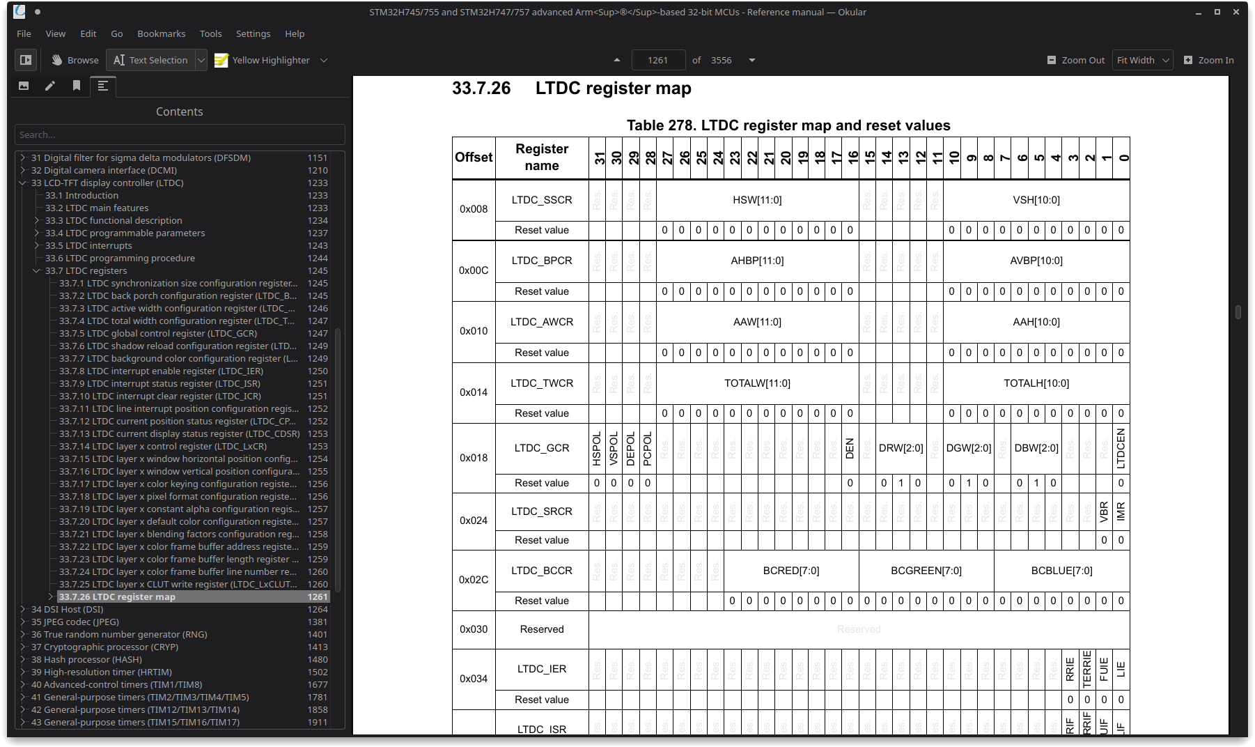

Zu einem LCD-Controller mit 32-Bit Registern hab ich mal ChatGPT befragt
und der hat ein paar ausgegeben. War zu Faul um selber zu suchen:
Meine Eingabe bei ChatGPT:
Hi! Exists there LCD controller with 32 bit registers?
Ausgabe von ChatGPT:
Hi! Yes, there **are LCD controllers with 32-bit registers**—especially in modern microcontrollers and display controllers that are designed for higher-resolution displays or more complex graphics.
### Examples of LCD controllers with 32-bit registers:
1. **STM32 Microcontrollers (STMicroelectronics)**
   * Many STM32 MCUs (like STM32F4, STM32F7, STM32H7 series) have **LCD-TFT controllers** (LTDC) with 32-bit registers.
   * Example: The **LTDC** controller in STM32F429 has 32-bit wide registers used for pixel formatting, layer configuration, and frame buffer control.
2. **SSD1963 LCD Controller**
   * While its data bus can be 8/16/24-bit depending on configuration, **its internal control registers are accessed through 16-bit commands**, but some registers can act like 32-bit when combined.
3. **RA8875 / RA8889 (RAiO)**
   * These are advanced TFT LCD controllers that sometimes deal with 32-bit-wide data when interfacing with a 32-bit system, although their register interface is typically 8/16-bit.
4. **FT81x series (FTDI / Bridgetek)**
   * The FT810/FT811/FT812/FT813 (EVE - Embedded Video Engine) family uses **32-bit aligned registers and memory access**, especially for graphics command FIFO and display list processing.
22
5. **FPGAs with Soft or Hard LCD Controllers**
23
24
   * In custom or SoC FPGA designs (e.g., Xilinx Zynq or Intel/Altera SoC FPGAs), the LCD controller (AXI-based or custom) often uses **32-bit or even 64-bit registers** for configuration and data.
25
26
27
28
### Why 32-bit Registers?
29
30
* **More efficient access** on 32-bit or 32-bit+ architectures.
31
* Allows configuration of multiple fields (e.g., x/y position, color depth, layer blending) in one register.
32
* Easier to align with 32-bit graphics memory addressing.
33
34
Would you like a specific recommendation based on resolution, interface type (RGB, MIPI, SPI, etc.), or target platform (MCU, FPGA, etc.)?
Wobei zu mindestens die Ausgabe vom RA8875 nicht stimmt. Die sind laut
Datenblatt nur 8-Bit breit. ChatGPT behauptet 8/16Bit.

Hab ich erwähnt. Ist aber in einem SoC implementiert. LTDC bei zum
Beispiel STM32H747. Diesen Controller verwendet STMicroelectronics auch
in anderen Controllern, nicht nur den STM32H747.
Anbei ein Screenshot von der Register Übersicht in der TRM vom LTDC im
SoC. Sehen für mich persönlich wie 32-Bit Register aus. Gibt auch eine
Exception vom Cortex-M7 oder M4 wenn man hier auf Teile (unaligned)
zugreift.
Und es gibt sicher auch andere.
