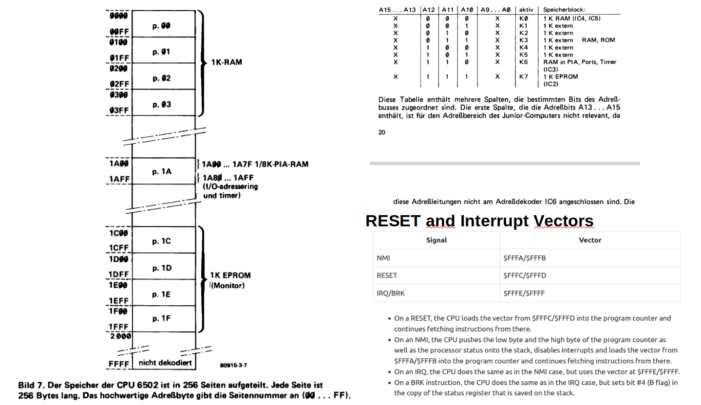

Im Moment versuche ich gerade, Assemblercode für den Junior-Computer mit
dem C-Compiler zu erzeugen.
 * Blinking an LED connected to PORTB0 of a Junior Computer

Das Problem: wie kann man aus diesem Assemblerfile den Binärcode
erstellen, so dass er an der Adresse 0x300 beginnt?

Mein Konfigurationsfile sieht so aus ( beim STACKSTART bin ich mir noch
unsicher )
SYMBOLS {
    __STARTUP__:   type = import;
    __STACKSIZE__: type = weak, value = $0080;
    __STACKSTART__: type = weak, value = $0180;
MEMORY {
    ZP:       file = "", define = yes, start = $0000, size = $0100;
    CPUSTACK: file = "",               start = $0100, size = $0100;
    RAM:      file = %O, define = yes, start = $0300, size = $0800 - __STACKSIZE__;
SEGMENTS {
    ZEROPAGE: load = ZP,     type = zp;
    STARTUP:  load = RAM,    type = ro;
    LOWCODE:  load = RAM,    type = ro,  optional = yes;
    ONCE:     load = RAM,    type = ro,  optional = yes;
    CODE:     load = RAM,    type = ro;
    RODATA:   load = RAM,    type = ro;
    DATA:     load = RAM,    type = rw,  define   = yes;
    BSS:      load = RAM,    type = bss, define   = yes;
FEATURES {
22
    CONDES: type    = constructor,
23
            label   = __CONSTRUCTOR_TABLE__,
24
            count   = __CONSTRUCTOR_COUNT__,
25
            segment = ONCE;
26
    CONDES: type    = destructor,
27
            label   = __DESTRUCTOR_TABLE__,
28
            count   = __DESTRUCTOR_COUNT__,
29
            segment = RODATA;
30
    CONDES: type    = interruptor,
31
            label   = __INTERRUPTOR_TABLE__,
32
            count   = __INTERRUPTOR_COUNT__,
33
            segment = RODATA,
34
            import  = __CALLIRQ__;
35
von Klaus (feelfree)
Christoph M. schrieb:
> Jetzt scheint der Compiler das Linker-File zu ignorieren
Hab's ja auch nicht angegeben.
Probier's mal mit deinem -C junior.cfg statt -t none.
