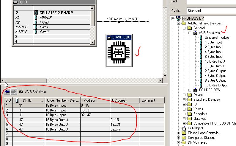

I'm sorry for the late reply. Did you manage to make it work? If not I
can also post code for the UNO/Nano version.
I made it work with a Nano (MEGA328) and 5 i2c PWM output expanders. I
have been testing this slave for 3 months now with no profibus errors.
It works great but only goes up to 45.45k speed
Anyway those 5 PWM expander provide 48 PWM outputs!

von Tadej S. (tadythefish)
Hello
Sorry for the late reply. I have editedd the programs and made 3
versions.
Mega2560 UART2
Mega2560 UART3
Mega328
I have not tested the UART3 version so please if it works leave reply or
if it dos not :)
EDIT: Whoops.. both attachements are the same :D

Hello Tadej,
i have test the Mega2560 UART3.
You have forgotten to change in row 853:
UCSR2B |= _BV(UDRIE2);  // <<< AVR Version
into
UCSR3B |= _BV(UDRIE3);  // <<< AVR Version
then it works.
But I get a lot of warnings when compiling.
The Problem is the conversion from unsigned char* into char*
for example:
if (checksum(&uart_buffer[1], 3) != FCS_data) break;
you must write for correctly syntax
if (checksum((char*)&uart_buffer[1], 3) != FCS_data) break;
Currently my Profibus connection works with 93750baud without problems.
Thanks.
PS:  Why did you insert an offset (+5) in uart_buffer?

Hi @Amigo I., and many thanks for the reply.
I tried the Tadej S. code, but without result, in the PC i don't see the
state of the digital input (for example Arduino pin 4) change.
How is mapped this digital input (pin 4) of Arduino in the PLC?
In the Hardware Configuration (Step7) i have make for first an Universal
Module, for second 1 byte Input and for third 1 byte Output. It's ok
this configuration?
Do you have an example or a screenshot of your project that works?
Thank you very much
M @ TTI @
von Rico S. (ridchi1980)
You must Write the state of Pin4 as Bit0 in data_out_register[0] then
you can used this in PLC I1.0 ect... The input Adress is this who
configured it in Hardwareconfig.

von Amigo I. (Firma: hobby) (sony2019)
> this configuration?
> Thank you very much
> M @ TTI @
You can play the variable "data_in_register" and "data_out_register"
related the I/O in "doit" routine.
In Simatic you can see in variable table.
