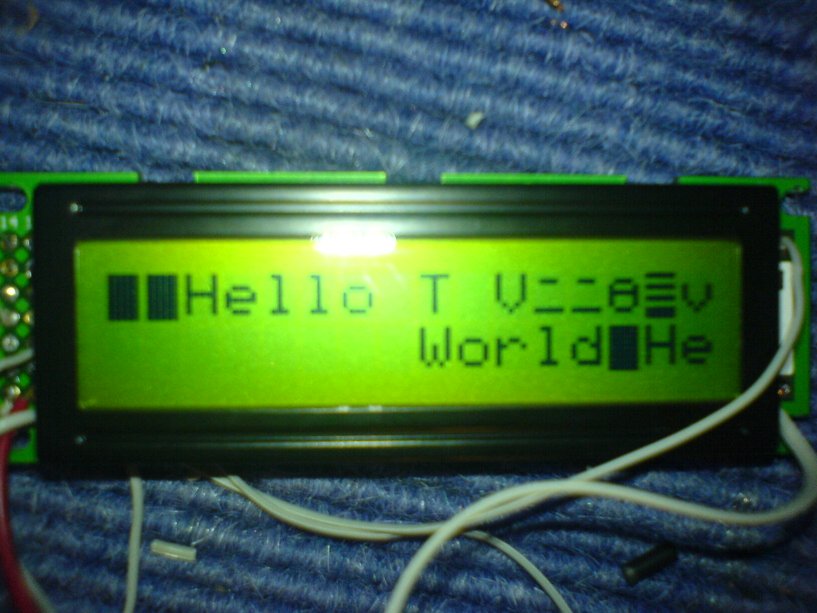

So leuts jetzt fängt es an lustig zu werden. Hab ja um zu sehen ob was gesendet wird eine LED von - µC Board zu auf den jeweiligen Pin gehalten. Dann bin ich auf die Idee gekommen mal die Reset Taste zu drücken, während ich das Kabel noch am Pin hatte. Folgendes ist passiert: Siehe Bild ;) Was kann ich nun daraus schließen ?
The controller chip on LCD module must be compatible with the Hitachi HD44780 controller chip. "INITLCD" is not necessary because Bascom AVR will call it automatically at start up if LCD commands are used in the program. (Like CLS, LCD, ..)."INITLCD" is used to reinitialize the LCD at runtime in case you power down the LCD and then power it up again.(e.g., to save batteries). You can try to add "INITLCD" before "Cursor Off Noblink" but I don't think that this will fix your problem. What you can do: ============================================== Option 1: Check again your hardware and all the used connections. Is the the R/W pin of the LCD permanently connected to GND? ============================================== Option 2: Buy an LCD compatible with the Hitachi HD44780 chip. Note that Bascom AVR also support the LCD controller KS077 and the LCD controller used by the EA-DOG LCD modules. See Bascom help file "CONFIG LCD". ============================================== Option 3: Keep your LCD. (You will need the full version of Bascom AVR). Download the datasheet of the controller chip used by your LCD module. Instead of using "Config Lcdpin" use the Bascom library lcd4.lib. You will have to modify the Bascom library lcd4.lib to suit the needs of the used LCD controller chip. Note that in this case "Config Lcdpin" is not used because the used pins are defined in the library lcd4.lib. Remember to put $lib "lcd4.lib" at the beginning of your program. The Bascom libraries are written in assembly but the code in the lcd4.lib is very simple to modify and to understand. It might be that you only need to modify the fixed delays used in the library. (This library does not use the busy flag of the LCD so the R/W pin of the LCD must be permanently connected to GND). If you try to modify lcd4.lib, make sure you make a copy of the original file before you modify it. ==============================================
Kann mir jemand erklären wie genau ich eine Lib umsetzen kann, die auch die Busy Flags auswertet ? Was würden denn passieren wenn die Busy Flags ausgewertet werden und die Quartzangabe nicht stimmt ? Kann es dann immernoch zu Taktfehlern kommen ? Hoffe auf eure Hilfe. Edit. Auf dem Display seinen auch die Infos die übertragen werden sollen anzukommen, wenn ich eine Led von Masse auf Displaypin lege und den Resettaster drücke: (Bild siehe Anhang)
See the Bascom AVR library "lcd4busy.lib" which is located in the folder LIB. Do you have the full version of Bascom AVR? (The source code of the LIB files in not included with the demo version). Which Bascom version are you using?
