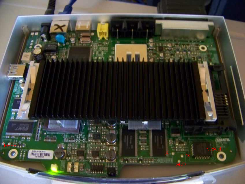

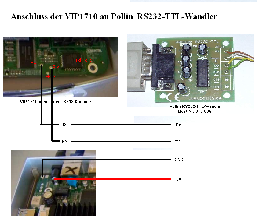

Serielle Schnitstelle ist "J12"
Version mit großem Kühlkörper / 39l040 / Flash
Bild einer Kreatel Box

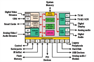

Xilleon 210 is the most advanced system-on-chip available for value-priced STBs and DTVs. The design integrates a CPU, flexible and powerful TS demux, conditional access, MPEG-2 decoding of video and audio at SD or HD resolutions, market-leading powerful graphics, video picture processing technology and a range of peripheral I/O including an on-chip USB1.1 controller and video DACs meeting worldwide video standards (PAL/SECAM/NTSC).
The video picture processing features high quality scaling with pan-and-scan, windowing and aspect-ratio controls, together with pixel based de-interlacing, flicker-filtering, brightness, contrast and color management, ensuring excellent TV picture quality.
The Xilleon 210 incorporates a powerful 300MHz 32-bit MIPS CPU and a performance-optimised memory controller coupling the chip to an external 16 or 32bit single-channel DDR memory at speeds of up to 183MHz. This combination of CPU and special attention to the internal memory architecture design ensures optimal processing power for the core feature set as well as a plentiful supply of CPU bandwidth for responsive and compelling TV applications.
A complete reference-platform development kit including drivers and sample applications is available, enabling rapid time-to-market development.
Features and Benefits
       * Multi-standard TS Demux and Descramblers to support worldwide markets (DVB, ATSC)
       * Single MPEG-2 SD (X210D) or HD (X210H) decode
       * Integrated 2D/3D Graphics processor
       * Powerful and flexible Display Engine featuring high quality scaling of Video and Graphics and picture processing technology
       * Integrated 300MHz 32-bit MIPS CPU

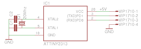

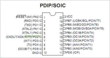

Automatisches Ausführen nach Systemstart über AVR an serieller Konsole
ands hat dazu einen ATTiny2313, 20MHz Quarz und 2x22pf an die serielle Konsole gehängt. Im AVR-GCC Programm wird auf den Konsoleprompt gewartet und dann 'sh /flash2/motorola.sh' ausgeführt. Bis zum Konsoleprompt vergeht ca. 1min.
Download: http://www.mikrocontroller.net/attachment/80402/vip1710_t2313.zip

tftp Programme TFTPd32
Pegelwandler max232
oder
TTL-Schnittstellenkabel, z. B. aus Handydatenkabel gebastelt
Com-Einstellung: 115200,n,8,1
Anschluss des Pollin RS232-TTL-Wandlers an den seriellen Port der VIP1710:
Hochauflösende Bilder
