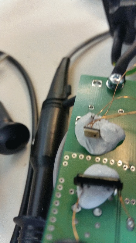

Hi all,
I want to read out a MEMS microphone ( namely Knowles SPM1423HM4H-B ) to
my Cortex M4 over the I2S interface. I did not find any templates for
the initialization on the net, so I implemented it ;).
The mic needs a clock of up to 3MHz and is sending out pulse density
coded bits ( the more ones, the higher the signal, sort of sigma-delta
coded ). The clock and the bitstream are read over the SPI/I2S of a
Cortex M4. I use the SPI-2 interface, because SPI-1 is occupied by the
JTAG adapter. The SPI2 is configured for I2S protocol and packs the
bitstream to 16Bit words (PCM mode, I2S receive master). For a completed
16Bit word an interrupt is generated. I use a 80MHz clock and a 1/32
prescaler, so the clock for my mic is 2.5MHz. With a single interrupt
for 16Bits we get an interrupt load of 156250 interrupts/s.
The enclosed main.c for gcc is only a template for the setup of the
GPIOs, the SPI/I2S and the interrupt controller. I stripped it but maybe
some debug stuff is left. I do not claim that it can be compiled, just
use it as a working example.
I fed the mic with a synchronus 2.441KHz = 2.5MHz/(16*64) test tone, see
the picture. I recorded the bitstream (16384*16Bit) and made a FFT of
it, see the screenshots, unit is dB. I got wonderful noise shaped
sigma/delta spectra with 60dB SNR (well, roughly), see the zoomed
spectrum.
The mems mics are all digital, high bandwidth and easy to read without
analog preamps.
Nice stuff!
Cheers
Detlef
