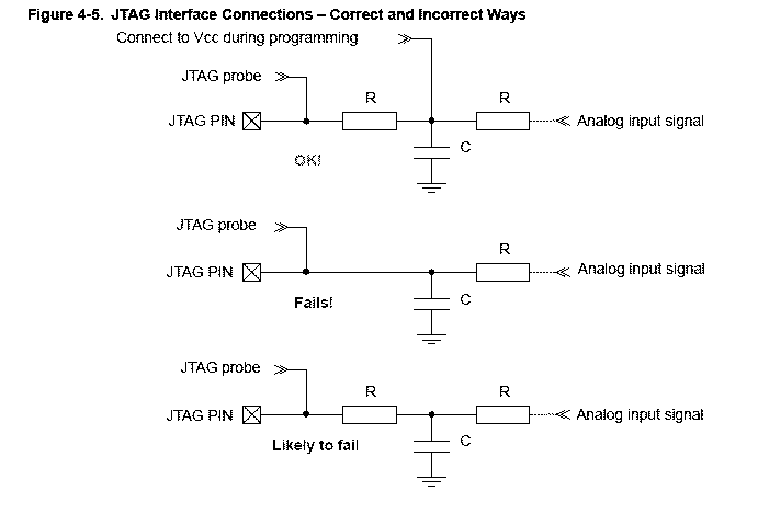

https://de.scribd.com/document/317989319/Atmel-2521-AVR-Hardware-Design-Considerations-ApplicationNote-AVR042
