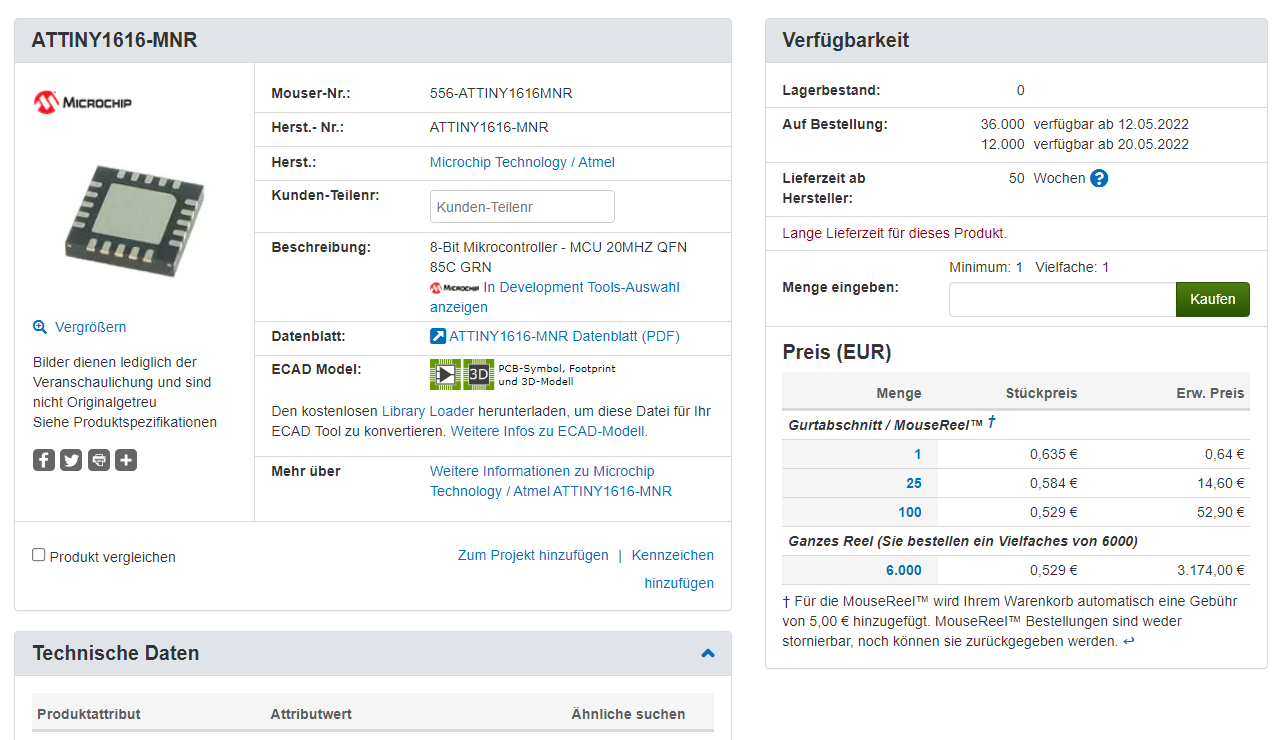

von Georg M. (g_m)
ATtiny1616-MNR
20-Pin VQFN 3x3mm
Flash: 16 kB
SRAM: 2 kB
EEPROM: 256 bytes
16-bit Timer/Counter type A (TCA): 1
16-bit Timer/Counter type B (TCB): 2
12-bit Timer/Counter type D (TCD): 1
