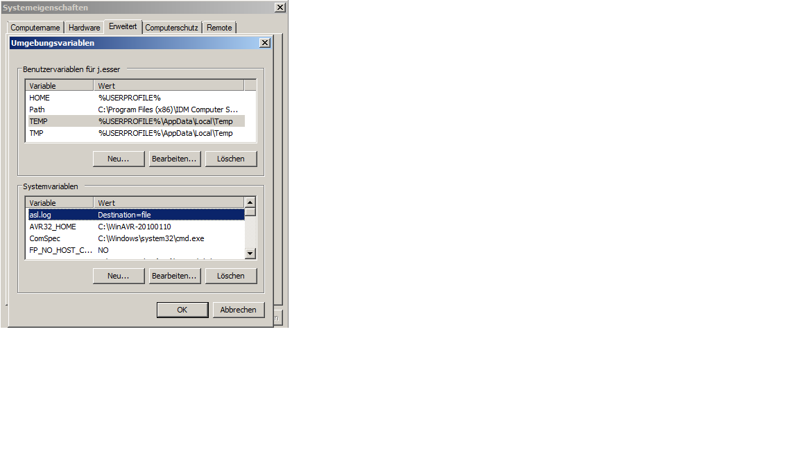

So ich habe mich mal an die letzte Version gewagt. Es sind 2 Verzeichnisse dazu gekommen. include und libexec. Nur libexec existierte schon, also in libexec.2010 umbenannt. include gabs noch nich somit reinkopiert. Ich bekomme immer folgende Warnung: bash.exe: warning: could not find /tmp, please create! Liegt das am Build? Oder kann Johann beim nächsten Build einfach was dran ändern? Ansonsten scheinen alle meine bisher getesteten Programme ohne Fehler zu kompilieren. Danke für die Arbeit! Building file: ../helper.c Invoking: AVR Compiler avr-gcc -Wall -Os -fpack-struct -fshort-enums -std=gnu99 -funsigned-char -funsigned-bitfields -mmcu=attiny85 -DF_CPU=8000000UL -MMD -MP -MF"helper.d" -MT"helper.d" -c -o "helper.o" "../helper.c" bash.exe: warning: could not find /tmp, please create! Finished building: ../helper.c Building file: ../main.c Invoking: AVR Compiler avr-gcc -Wall -Os -fpack-struct -fshort-enums -std=gnu99 -funsigned-char -funsigned-bitfields -mmcu=attiny85 -DF_CPU=8000000UL -MMD -MP -MF"main.d" -MT"main.d" -c -o "main.o" "../main.c" bash.exe: warning: could not find /tmp, please create! ../main.c: In function 'Sec': ../main.c:308:26: warning: unused variable 'o_tcnt0' [-Wunused-variable] volatile static uint8_t o_tcnt0 = 0; ^ ../main.c: In function 'CalMaxStrom': ../main.c:596:20: warning: variable 'GMax' set but not used [-Wunused-but-set-variable] uint8_t GMin = 0, GMax = 0; // Anfangswerte um Potistellung von min und max zu ermitteln. ^ Finished building: ../main.c Building file: ../uart.c Invoking: AVR Compiler avr-gcc -Wall -Os -fpack-struct -fshort-enums -std=gnu99 -funsigned-char -funsigned-bitfields -mmcu=attiny85 -DF_CPU=8000000UL -MMD -MP -MF"uart.d" -MT"uart.d" -c -o "uart.o" "../uart.c" bash.exe: warning: could not find /tmp, please create! Finished building: ../uart.c Building target: E-Kart.elf Invoking: AVR C Linker avr-gcc -Wl,-Map,E-Kart.map -mmcu=attiny85 -o "E-Kart.elf" ./helper.o ./main.o ./uart.o bash.exe: warning: could not find /tmp, please create! Finished building target: E-Kart.elf Invoking: AVR Create Extended Listing avr-objdump -h -S E-Kart.elf >"E-Kart.lss" bash.exe: warning: could not find /tmp, please create! Finished building: E-Kart.lss Create Flash image (ihex format) avr-objcopy -R .eeprom -O ihex E-Kart.elf "E-Kart.hex" bash.exe: warning: could not find /tmp, please create! Finished building: E-Kart.hex Create eeprom image (ihex format) avr-objcopy -j .eeprom --no-change-warnings --change-section-lma .eeprom=0 -O ihex E-Kart.elf "E-Kart.eep" bash.exe: warning: could not find /tmp, please create! Finished building: E-Kart.eep
Dann mach doch halt ein scheiss /tmp Verzeichnis.
Wo ist dein Problem?
Mein Problem ist das ich unter SCHEISS Windows arbeite und dort bringt das nix ;) Und wo ist dein Problem?
Jörg Esser schrieb: > Mein Problem ist das ich unter SCHEISS Windows arbeite > und dort bringt das nix ;) Sicher, dass ein mkdir C:\tmp das Problem nicht beseitigt?
GCC legt während des Compilierens temporäre Dateien an, für die natürlich ein Verzeichnis zu bestimmen ist. Das ist OS abhängig, und GCC versucht zunächst Werte unterschiedlicher Umgebungsvariablen wie TMP, TEMP, TMPDIR oder Standardverzeichnisse wie /tmp, /var/tmp, /use/tmp etc. Für Windos verwendet er die Systemfunktion GetTempPath die ebenfalls Werte von TMP und TEMP und auch USERPROFILE abtestet. Die Meldung bedeutet also, daß is deinem System kein Ordner für temporäre Dateien bestimmt werden kann. Übrigens kommt die Meldung nicht von GCC, der würde melden "Cannot create temporary file in ...". Das Problem wird auch ausführlich im Web besprochen und tritt auch für andere Tools wie GIT auf.
Bearbeitet durch User

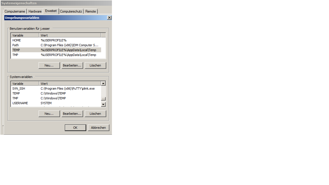

Ok dann werde ich mal eine TMP Variable anlegen. Denn mit einfachem Verzeichnis anlegen ist es natürlich nicht getan. Zumindest nicht bei mir :)
Hmm mein Windows 7 hat aber diese Umgebungsvariablen. Vorschläge? Bitte 2. Temp.png beachten kann den ersten Anhang leider nicht mehr löschen.
Das ist alles ein Problem der Bash, nicht von GCC. Siehe z.B.: http://cygwin.com/ml/cygwin/2006-12/msg00484.html Hier half das Setzen der Umgebungsvariablen nebst Reboot: http://www.avrfreaks.net/comment/73423#comment-73423

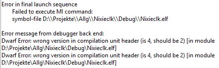

Moin, ich benutze zur Zeit die GCC-4.8.1 (von Georg) in Eclipse mit dem AVR-Plugin. Läuft soweit gut bis auf die Debugging-Infos(?) im ELF-File. Ich habe "dwarf-2" eingestellt und erhalte beim Aufruf von AVR-GDB (über Eclipse ) die Meldung ... (siehe Snapshot im Anhang). Wenn ich "stabs" oder "stabs+" einstelle, ändert sich die Fehlermeldung nicht. Verwende ich WinAVR_20100110 mit "dwarf-2" funktioniert es. Ich kann zwar erstmal mit WinAVR_20100110 debuggen und wenn es läuft auf GCC-4.8.1 wechseln. Aber vielleicht gibt es ja Abhilfe? Danke, 900ss
