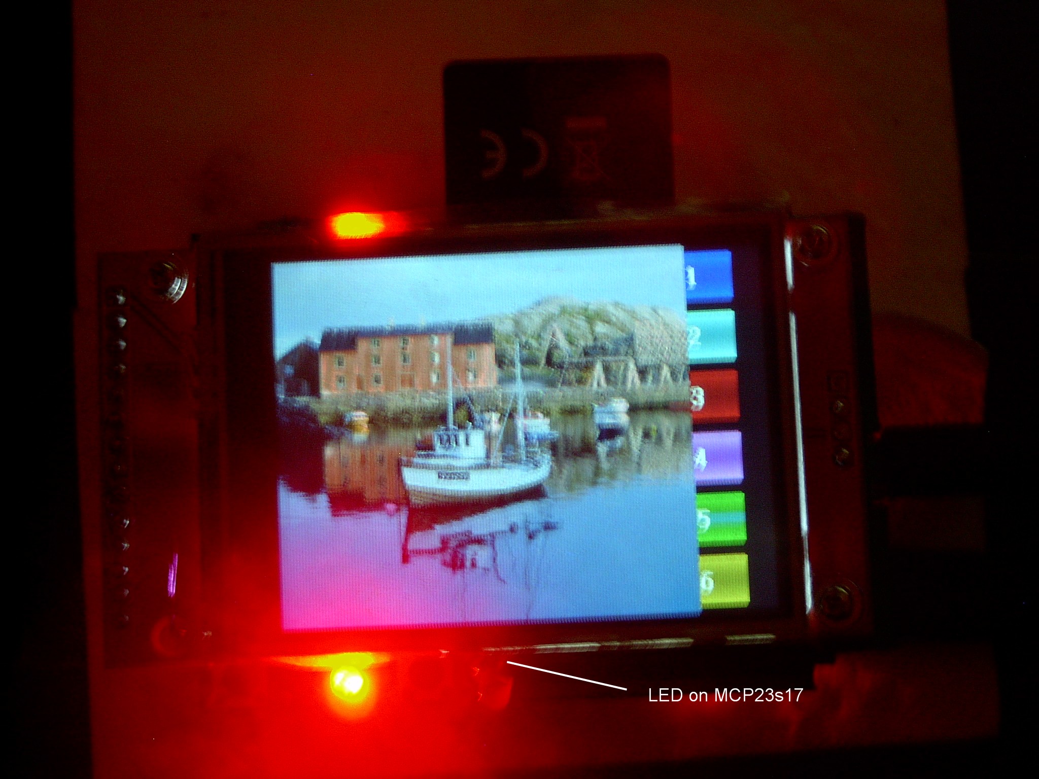

For wiring, I'll describe what's in front of me. The order below is
always
Display -> ESP
First, we have the shared SPI bus pins; these are hardware SPI and you
must use the same pins on the ESP8266.
SDO(MISO) -> MISO (GPIO12)
SDI(MOSI) -> MOSI (GPIO13)
SCK -> SCLK (GPIO14)
If you have/use the touchscreen, you also must connect the touch driver
to the same SPI bus pins:
T_DO -> MISO (GPIO12)
T_DIN -> MOSI (GPIO13)
T_CLK -> SCLK (GPIO14)
The rest of the pins are my (arbitrary) choices -- the only restriction
is that T_IRQ cannot use GPIO16 if you plan to use ISRs for touch
(because that pin doesn't support interrupts), otherwise you can choose
as you wish. My library does not register an ISR, though.
For the TFT driver (ILI9341):
D/C -> GPIO2
CS -> GPIO4
RESET -> GPIO5
If you use those, then you can instantiate Ucglib with (you'll have to
add it to the Ucglib examples; in the XPT2046 library examples, it's
already there):
Ucglib_ILI9341_18x240x320_HWSPI ucg(/*cd=*/ 2 , /*cs=*/ 4, /*reset=*/
5);
For the touch driver:
T_CS -> GPIO16 (aka XPD ?)
T_IRQ -> GPIO0 (must disconnect every time you reflash!!)
If you use those, you can initalize my library with
XPT2046 touch(/*cs=*/ 16, /*irq=*/ 0);
In retrospect, GPIO0 was less than ideal for T_IRQ (but I had hooked up
everything else when I got to touch, and I'm ashamed to say I've been
too lazy to swap :) ): T_IRQ has a 10K pullup, and GPIO0 needs to be low
on powerup to reflash, so on my ESP board I have to disconnect either
T_IRQ or the display module's power.
Finally, don't forget the power pins:
VCC -> 3.3V
LED -> 3.3V
GND -> GND
