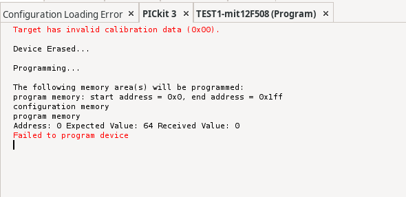

Hier ist der Output eines typischen Brennversuchs, hat noch jemand eine
Idee ?
VG Harry
Connecting to MPLAB PICkit 3...
Currently loaded firmware on PICkit 3
Firmware Suite Version.....01.56.09
Firmware type..............Baseline
Programmer to target power is enabled - VDD = 5,000000 volts.
Target has invalid calibration data (0x00).
Device Erased...
Programming...
The following memory area(s) will be programmed:
program memory: start address = 0x0, end address = 0x1fe
configuration memory
program memory
Address: 0 Expected Value: a01 Received Value: 0
Failed to program device

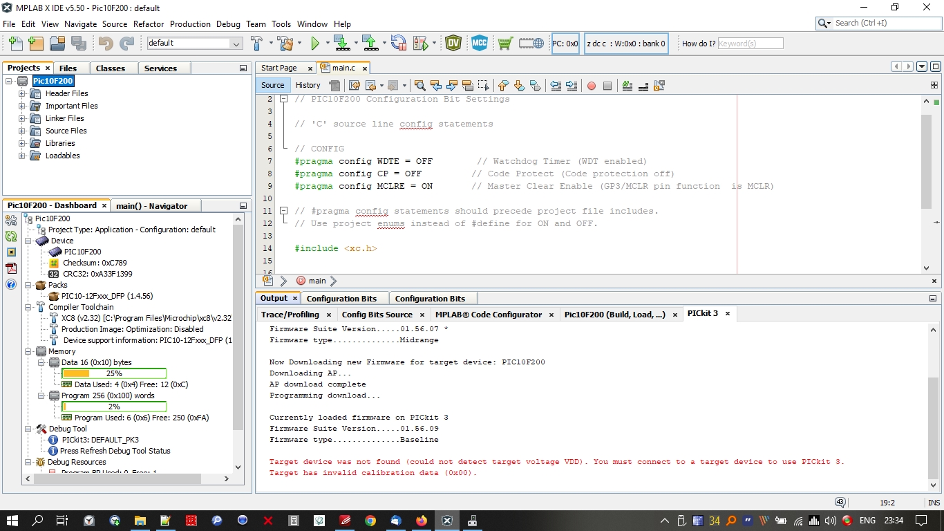

Beispiel (ohne externe 5V und mit 5V aus dem Pickit):
PICkit 3 is trying to supply 5,000000 volts from the USB port, but the target VDD is measured to be 4,625000 volts. This could be due to the USB port power capabilities or the target circuitry affecting the measured VDD.
The target circuit may require more power than the debug tool can provide. An external power supply might be necessary.
Connection Failed.
Also stelle ich auf das um, was der Pickit gibt, 4,625V :
Programmer to target power is enabled - VDD = 4,625000 volts.
Device Erased...
Programming...
program memory
So, ich weiß mir auch keinen Reim darauf.

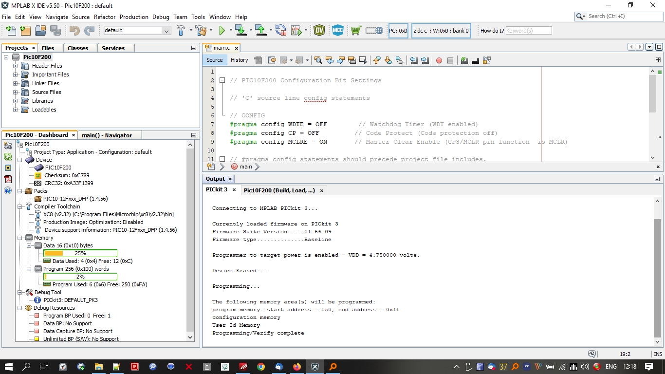

Firmware type..............Midrange
Target voltage detected
Target device PIC10F322 found.
Device Revision ID = 2
Device Erased...
Programming...
program memory: start address = 0x0, end address = 0x1ff
Programming/Verify complete

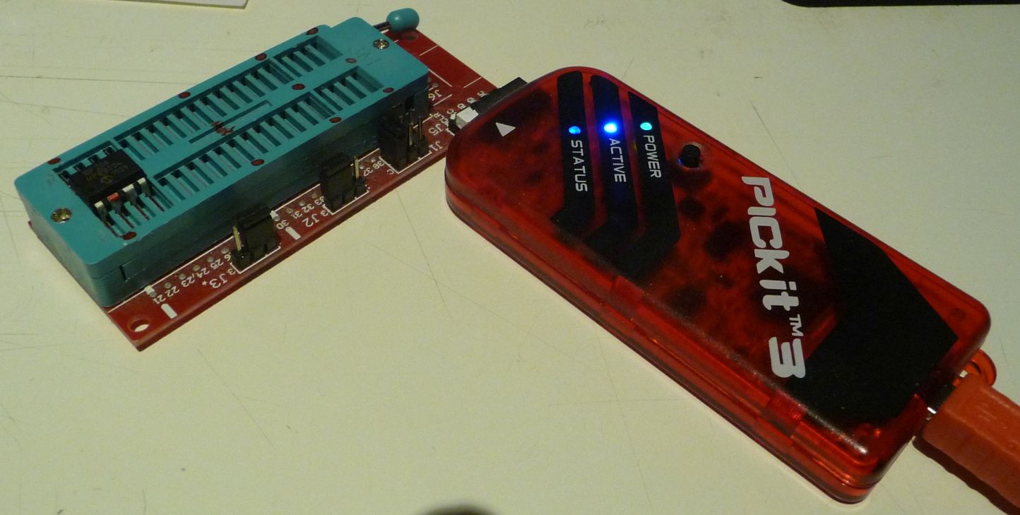

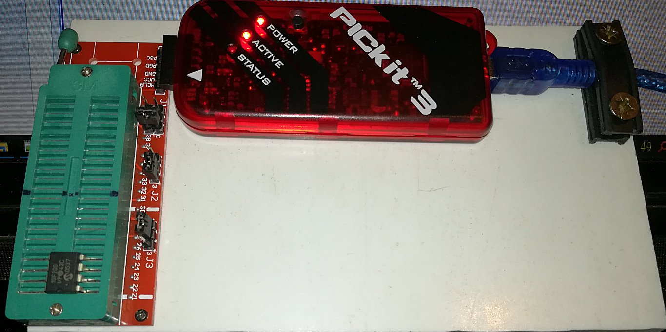

Hier mal ein Bild :-)
von derEine (Gast)
Soll das so sein, dass der Pic auf Pin 17 bis 24 des Nullkraftsockels
hängt?

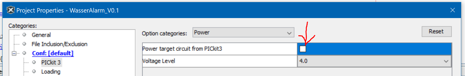

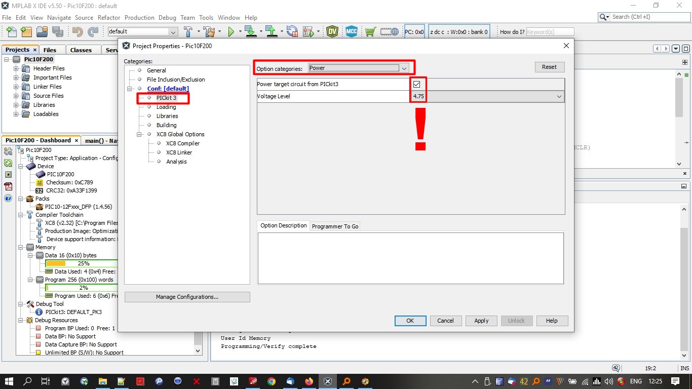

von Teo D. (teoderix)
Wenn NUR durch den PicKit versorgt kommt vollgende Meldung:
PICkit 3 is trying to supply 4,000000 volts from the USB port, but the target VDD is measured to be 3,750000 volts. This could be due to the USB port power capabilities or the target circuitry affecting the measured VDD.
Connection Failed.
Ich bin mir ziemlich sicher, das du das Häkchen nicht rausgemacht hast!?
von Harry R. (harryr)
Ich habe sämtliche Varianten (s.o.) natürlich unter Berücksichtigung des
Häkchens gemacht :-)
> hängt?
Ja
Na dann.
Hatte dieses Nullkraftjumperding, nich schon mal Probleme gemacht!?

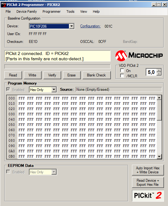

Den Pickit3 kenne ich nicht, aber beim Pickit2 musste man beim PIC10F202
explizit mit "pPIC10F202" den Chip mitteilen, beim PIC10F322 reichte der
Parameter "p" beim Aufruf von pkcmd2 und der PIC wurde automatisch
identifiziert.
Pickit2 sucht die Signatur zuerst mit Vpp ca.8V, danach mit Vpp ca.12V.

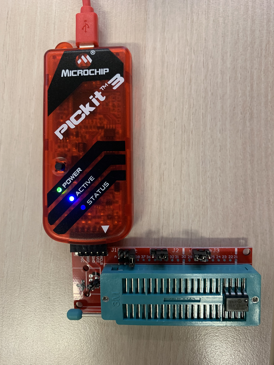

Also das hier:

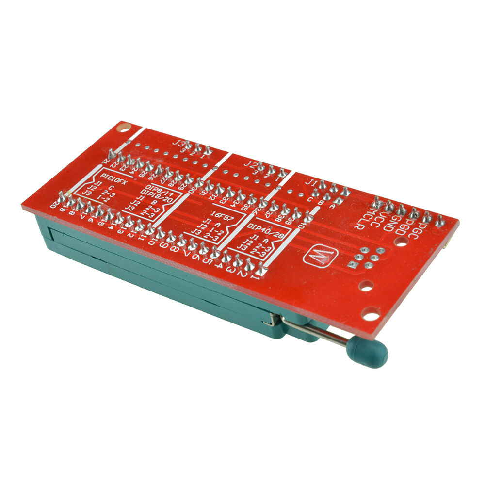

https://robu.in/product/pic-icd2-pickit2-pickit3-universal-programming-adapter-programmer-board/
Da steht:
The seat supports the following programming microcontroller:
    PIC16/18XX 40PIN Series devices (except 16F59)
    PIC16/18XX 28PIN Series devices (except 16F57)
    PIC16/18XX 18PIN Series devices
    The PIC 8PIN/14PIN/20PIN family of devices (except 10FXX)
Beachte das "except 10FXX". Kann also nicht funktionieren.
Da gibts drei Möglichkeiten:
1. Du bist zu dumm zum Datenblatt lesen
2. Du hast die Produktbeschreibung vorm Kauf nicht gelesen
3. Du hast nicht die Verbindungen zwischen dem ICSP-Header und dem PIC
durchgemesen, wie man dir gesagt hat.
fchk
von Ron-Hardy G. (ron-hardy)
Die sind aber auch gemein unten trotzdem PIC10FX raufzuschreiben...
Ich fand das auch widersprüchlich, was stimmt denn nun ?
Klingel es raus!
von Frank K. (fchk)
Hast Du denn auch die Jumper richtig gesetzt?
fchk
Tststs, wie kannst Du nur... ;DDD

Die Jumper dueften richtig gesetzt sein - decken sich mit meinen selbst
erstellten Vorlagen.

ich habe hier meine PIC-Umgebung auf einem alten Win-XP-System mit der
freien Version von CC5x als C-Compiler und sowohl Notepad++ als auch
Geany als IDE.
Mit dem PIC10F206 gibt es keine Probleme (den 10F202 habe ich nicht).
Mein Programmer ist ein Pickit2-Nachbau (DIY), aber ein Pickit3 sollte
es doch auch tun...
Der Aufruf aus der IDE lautet unter Geany
pk2cmd -PPIC10F206 -F%d/%e.hex -M
Für PICs mit ID-Erkennung reicht -P als Parameter.
Unter Xubuntu starte ich aus Geany den CC5x-Compiler mit Wine und als
Programmer ein pk2cmd für Linux (von github gezogen).
Wenn bei Harry die HEX-Datei schon vorhanden ist, sollte sich der
Programmer doch auch mit pk3cmd starten lassen?
pk3cmd -PPIC10F202 -Fharry.hex -M
Erni
Toxic schrieb:
> Auf page 102 ist die Microchiploesung und auf page 104 ist das
> Clone-Schematic.Irgendwo mal heruntergeladen.Ob es stimmt was da zu
> sehen ist kann ich nicht sagen...
> Beachte auch:es ist moeglich,dass dein Pic schon beschaedigt
> ist.Eventuell einen neuen nehmen oder auch mal einen anderen Pic zum
> Testen verwenden(Jumper setzen...)
Hmm, mein Clone ist nicht so einfach zu dekodieren. Zumal es nur zwei
Widerstände mit 100 Ohm gibt, eine schnelle Lötlösung ist ziemlich
ausgeschlossen.
ABER: die Lötpfostenreihe für den Stecker ist erkennbar schlecht
verlötet, ich glaube da lasse ich gleich mal etwas heißes Zinn
nacharbeiten.

Ich hatte allerdings noch nie einen PIC10F2xx programmiert bis eben eben
gestern Abend.Tja - schoener Mist:Pic nicht erkannt egal welche VDD man
per Software einstellte.
Mein PIC ist ein Original(von Reichelt) und lag bisher nur unbenutzt
herum.
Es war gestern ziemlich spaet - ich werde eventuell heute nochmal
checken ob ich ihn "gebraten" bekomme ...
Mehr kann ich im Moment nicht dazu sagen.Steh selbst auf dem
Schlauch....
Vielleicht stimmt auch was mit dem Adapter nicht.Man sollte mal
ueberpriefen ob die entsprechenden Programmierleitungen auch da anliegen
wo sie sollen.Ist ja shnell gecheckt

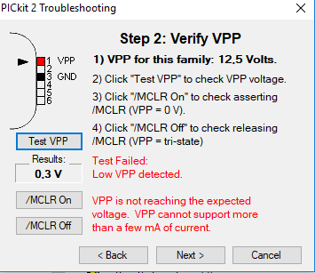

Zur Sammlung nichtfunktionierender Pickits kann ich auch beitragen!
Nachdem mein Selbstbau-Pickit2 lange Jahre zuverlässig lief, konnte ich
auf meinen frisch geätzten Platinen den bestückten PIC(16F1509) nicht
flashen. Lange nach einem Fehler auf der neuen Platine gesucht und nicht
gefunden. Dann, nur zum Test, ein altes Board mit einem 12F629 genommen
- ging auch nicht mehr. Rumgemessen und mit dem Scope festgestellt, dass
der Pickit nur noch Pulse von 6V und 8V an Vpp anlegte. Pickit-Hardware
war aber auch ok. Mit der Pickit2-GUI das Testmenü aufgerufen und die
Kalibrierung neu durchgeführt - danach lief wieder alles! Der Pickit
erzeugt, je nach PIC-Type, die Vpp mit 8V bzw. 12V. Warum die
Kalibrierung verlorenging weiss ich nicht.

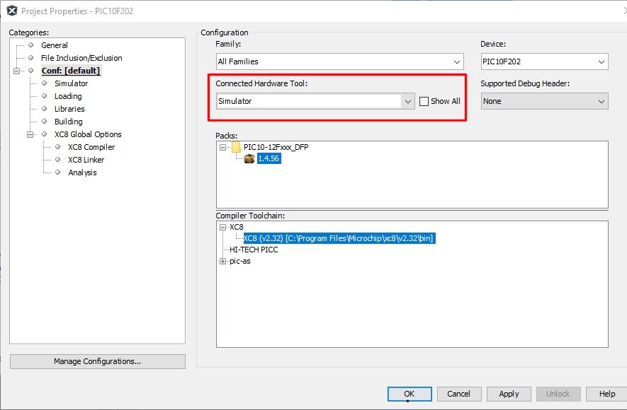

von Toxic (Gast)
Update !
Das Programmieren hat funktioniert !
Mir ist gestern ein Fehler unterlaufen - es war schon spaet am Abend....
Ich vermute ,dass dem TO das gleiche Missgeschick passiert.
1. Ich hatte vergessen MPLABX mitzuteilen ,dass der PIC vom PicKit mit
Spannung versorgt werden soll.Dazu muss man ein Haekchen setzten.Vorgabe
ist EXTERN !!!!!
2.Die "Power" muste ich von von 5V auf 4.75V(wie ueblich...)
verringern.Mit 5V Volt Vorgabe gunktioniert es nicht.Man bekommt
ansonsten die Meldung,dass nur 4.75V USBspannung gemessen werden
siehe Anhang

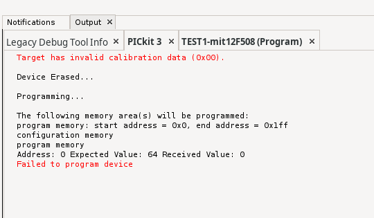

Also, ich habe jetzt mal mit einem PIC12F508 getestet, das Ergebnis ist
erratisch, mal wird gebrannt, mal nicht.Das wirklich popelige
Testprogramm (LED AN/AUS) läuft jedenfalls nicht. Ich vermute mal, dass
der gesamte Programmer irgendwie wackelig ist, da er ziemlich zufällig
brennt oder halt nicht.

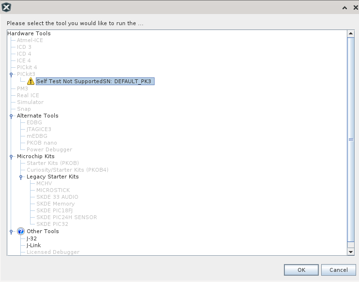

Wie rufst du denn das Testmenü auf (Bzw wie geht das mit einem PICKIT3)
VG
> ist EXTERN !!!!!
> siehe Anhang
Danke für den Hinweis, mit Haken gesetzt funktioniert es NIE, mit
externen 5V manchmal (vorgeblich), aber das IMAGE macht dann rein gar
nichts auf dem PIC.

Ich habe meinen PicKit und den Adapter auf einer Grundplatte befestigt
(siehe Anhang im frueheren Posting)um Wackelkontakte und dergleichen
auszuschliessen.Den Adapter und PicKit einfach so lose miteinander zu
verbinden halte ich nicht fuer ideal.....
Das Haekchen muss definitiv gesetzt sein,wenn du keine EXTERNE
Betriebsspannung verwendest.Externe Betriebsspannung macht in meinem
Augen nur Sinn,wenn der PIC innerhalb einer Schaltung programmiert
werden soll.In deinem Falle ist das ja nicht notwendig,da du ihn separat
auf den Adapter stoepselst.Der PIC alleine zieht bestimmt keine 20A...
Ohne Haeckchen und unter Verwendung des Adapters funktioniert das
Brennen nicht,weil das PicKit dann keine Betriebsspannung zur Verfuegung
stellt....

Ich habe da schon alle Möglichkeiten durch, keine war besser oder
schlechter, alle aber nicht zufriedenstellend.
> stellt....

von Erni (Gast)
Ich habe die Pickit2-GUI aus diesem Paket:
https://ww1.microchip.com/downloads/aemDocuments/documents/OTH/ProductDocuments/SoftwareLibraries/Firmware/PICkit2v2.61.00SetupA.zip
Auf der Pickit3-seite scheint es sowas nicht mehr zu geben
https://www.microchip.com/en-us/development-tool/PG164130
Auf dieser Seite ist ein Pickit2-Bausatz mit der Microchip-Software,
dort gibt es auch die von mir benutzte GUI
http://www.elproducts.com/build-your-own-pickit-2.html
http://www.elproducts.com/uploads/9/2/9/8/9298268/pickit_2_v2.61.00_setup_a.zip
Hier ein Video von Microchip, wo die GUI für Pickit3 gezeigt wird
https://www.youtube.com/watch?v=3EkNUa2nSDE
Leider finde ich keinen Download dazu.
Unter dem Menüpunkt Tools konnte man den Programmer konfigurieren und
auch Vdd und Vpp statisch anlegen und mit dem Multimeter messen. Da es
das Programm (zumindest vor 10 Jahren laut Video-Kommentar von
Microchip) gegeben hat, wird es wohl noch irgendwo zu finden sein -
hoffe ich.
Kann es sein, dass die angeschlossene LED ein ISP-Signal (ISPSDA,
ISPDAT) zu stark belastet?
von Erni (Gast)
Tippfehler, DAT und CLK natürlich.

von Hans (Gast)
habe früher die 10f200 mit dem Pickit2 benutzt, soweit ich mich erinnern
kann, musste man beim 10f200 den Typ manuell eingeben, alle anderen(die
höheren) wurden automatisch erkannt, sonst gabs keine Probleme. Aber
eigentlich sind die 10f200/206 Müll, haben nicht mal Interrupt und nur
einen lausigen Stack.
Gruss Hans
von uxdx (Gast)
Ist bei allen PIC10F2xx so, erst die PIC10F3xx werden erkannt. Auch bim
PICKit3

Ich bin am Rande eines Nervenzusammenbruchs :-|
Ich habe alle Tipps und Infos aus dem Internet gecheckt, Verkabelung
geprüft,
statt dem PIC10F202 den PIC12F509 getestet, es kommt nur Murks heraus,
sprich:
Falls der Pickit3 sich mal bequemt zu Programmieren (nur mit externer
Spannungsversorgung!) läuft mein Minimalprogramm kein bisschen.
Alle Kabel auf allen Breadboards wurden getauscht, gemessen. Da ist kein
Fehler,
dafür löte und bastle ich einfach zu lange, es liegt nicht am
mechanischen Aufbau.
Das einzige was mir noch in den Sinn kommt:
Der Pickit3 ist einfach ein Montagsprodukt.
von Erni (Gast)
Hast Du ein Oszilloskop (auch leihweise) mit dem Du die Pegel an den
ICSP-Leitungen messen kannst?
Vielleicht erreicht Vpp nicht den nötigen HV-Pegel? Dieser sollte 12,5V
bis 13,5V sein.
> bis 13,5V sein.
Nein habe ich nicht :-) Ich will im Moment nix mehr machen und habe eine
Art Hilfethread aufgemacht. Ich vermute mal , dass es irgend so etwas
ist, aber da das nicht reparabel ist würde mir das reine Wissen um die
Ursache ja auch nicht weiter helfen. Trotzdem danke für deine Hilfe.
von Erni (Gast)
Hmm, ja, schwierig... Wenn Du den Pickit nur mal testweise an einen
Windows-Rechner anschliessen könntest um dort mit der Pickit-GUI die
Diagnose- und Kalibriertools zu nutzen... Da braucht man auch nur ein
Multimeter um die Pegel zu checken. Aber Windows kommt ja bei dir nicht
ins Haus - und unter Wine wird die USB-Verbindung nicht klappen. Schade,
dass auch ein Ludipipo nicht mehr auf neuer Hardware funktioniert...

von Toxic (Gast)
Harry R. schrieb:
> PIC12F509 getestet
Ich nehme an,dass du die entprechenden Jumper und auch die neue Position
dabei beruecksichtigt hat.
Klar besteht die Moeglichkeit,dass der Programmer defekt ist aber nun
nochmal in alle Ruhe:
1.Wird das PicKit von Windows erkannt? Nach dem einstoepseln muss ein
"PalimPalim ertoenen.Dabei leuchten fuer ein paar Sekunden 3 rote LEDs
auf die sich dann auf 2 LEDs reduzieren: POWER  und AKTIV
Einen Microchip oder China-Eintrag fuer das PicKit  kann ich im
Geraetemanager nicht vorfinden.
2.Ich wuerde zudem das PicKit ohne eingesetzten PIC einstoepseln
3.Nachdem Windows das PicKit mit "Halloechen" begruesst hat den zu
brennenden PIC in den Adapter einsetzen.
4.Erstelle ein neues Projekt,waehle den zu brennenden PIC aus,den
Compiler XC8 ,vergib einen neuen Projektnamen und setze dieses Projekt
als "Main Project" - das ist auch Vorgabe.Wenn man mehre Projekte im
MPLABX zur Auswahl hat,immer darauf achten,das man auch das richtige
Projekt ausgewaehlt hat.Dies muss man besonders beachten,wenn man
staendig zwischen Projekten hin und herhuepft....ist mir z.B. nun bei
dir passiert:PIC10F200 und PIC10F202.
5.Nachdem das neue Projekt erstellt ist klicke mit der rechten Maustaste
im   linken Projektfenster auf dein Project.Gehe auf "set
configuration",dann customize und waehle den PicKit als Hardware tool.
6.Im MPLABX Menue siehst du oben 2 "Hammersymbole".Das uebernaechste
Symbol ist der Button um das Projekt zu Kompilieren und zu brennen!Bevor
du das tust,gehe nochmal zurueck zu den Projekteigenschaften und finde
dort das mittlerweile eingetragenen PicKit3.Klicke darauf und waehle
unter "option categories" POWER aus.Mach ein Haekchen in die "Box" rein
fuer interne Power.Gegebenfalls verringere auch die Spannung von 5V auf
4.75V
7.Brenne den PIC.Es erfolgt in 2 Schritten:Kompilieren und Brennen.
ALLES muss ohne  Fehler durchlaufen.keine roten Hinweise etc...
8.Hier bei mir nach dem Brennvorgang:Haekchen gesetzt und 4.75V
gewaehlt...
Programmer to target power is enabled - VDD = 4.750000 volts.
Device Erased...
Programming...
program memory: start address = 0x0, end address = 0x4

Ich sebst kann kaum noch was zu diesem Posting beitragen.Mein PIC10F200
laesst sich zumindest fehlerlos programmieren mit Clone PicKit und China
Textooladapter.Vorgehensweise habe ich auch erklaert.
Das einzige was mich noch interessiert ist der letzte Eintrag nach der
Programmierung in MPLABX.Da sollte stehen:
Und generell:Ich verwende ca. 6 verschiedene PIcs fuer meine Projekte -
alle lassen sich problemlos programmieren,wenn man ueber die Tuecke des
PicKits becheid  weiss:Spannungsreduzierung von 5V auf niedrigere Werte
sollte ein PIC mal nicht erkannt werden....
Poste doch einfach mal einen Screenshot oder copy/paste das
Programmierergebnis

Toxic schrieb:
> Harry R. schrieb:
>> Der Adapter funzt ja leider nicht mit dem PIC10202F
> Hab ich da was ueberlesen? Probleme mit dem Textooladapter?
Ja, andre User haben das geklärt. Aufdruck sagt ja, Beschreibung und
User sagen nein.
Haste wenigstens mal andere USB Buchsen und evtl. Verlängerungen
ausprobiert!?
Teo D. schrieb:
> Eigentlich wollte ich..... was solls.
> @Toxic ;P
> Teo D. schrieb:
>> Harry R. schrieb:
>>> betreibe den PIC10F202 mit (externer)
>>> Power (=5Volt),
>> Davor wird doch explizit gewarnt!
>> Hoffentlich is der Programmer nicht hinüber....
Dazu noch eine Anmerkung. Wenn der Programmer hinüber ist, dann war er
es schon vor der ext. Spannung, denn der Output hat sich nicht geändert.
Er findet die externe Spannung auch brav und misst korrekte 5V.
> In MPLABX gibts noch einen Selbsttest für die Programmiertools. KA was
> und wie da getestet wird, habs selbst noch nie gebraucht. Versuch macht
> kluch...
Wo gibts den Selbsttest denn ?
> Toxic schrieb:
Es klappt weder mit Adapter, noch mit Breadboard.
> User sagen nein.
> ausprobiert!?
Ich habe es an drei verschiedenen REchnern ausprobiert, heute sogar
(Herr verzeih mir) an meinem Window10-Arbeitsplatzrechner.
Ergebnis: siehe Screenshot
(Verwendeter PIC: PIC12F508)
Seufz
Probier mal den Selbsttest. Auch wenn ich da wenig Hoffnung habe, dass
da was verwertbares bei rauskommt....
MPLABX: Debug/vorletzter Menüeintrag.
Siehe Screenshot
Oje.... :´(
Teo D. schrieb:
> Oje.... :´(
Kannst du bitte einen Sceenshot machen, damit ich sehe, wie es aussehen
sollte.
Ich teste heute mal auf einem Windoof-Rechner.
"Not supported" Heiß nichts anderes als "Vergiss es, es gibt kein Tool
für den PicKit3".
Es ist typisch für Microchip, alles aufzulisten, ob unterstützt oder
nicht.
> für den PicKit3".
> nicht.
Was bedeutet denn dann dein "Oje" ?
Weils halt mal wieder nicht unterstützt wird und dir eine weitere
Enttäuschung bereitet hat. :(
von Max M. (Gast)
Teo D. schrieb:
Aber nur der Selftest wird nicht unterstützt.
Der PIC10F200 kann mit dem Pickit 3.
https://pic-microcontroller.com/pickit-3-supported-devices/

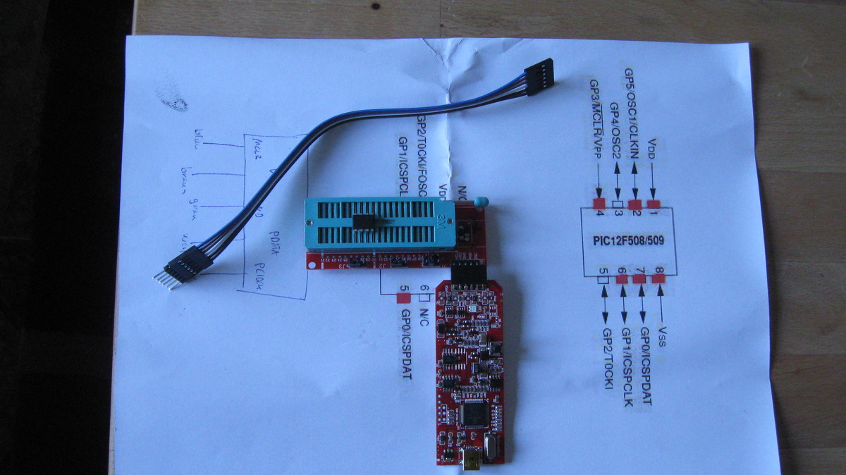

Zeig mal den kompletten Aufbau zum Programmieren und Testen, mit jedem
Kabel, jedem Netzgerät, jedem Bauteil gut sichtbar + Schaltplan.
Da ist der Wurm drin.
Ein def. Programmer geht nie und nicht nur gelegentlich.
Und alles sieht danach aus als ob die Datenverbindung zwischen Pic und
Programmer nicht steht.
Ich tippe auf schlechte GND Verbindung zwischen PIC und PC und/oder eine
ext. 5V Versorgung mit mieserabler Stabilität.
Zu lange Kabel zum Pic, ext. HW die an den Signalen zerrt etc. pp.
Max M. schrieb:
> Teo D. schrieb:
https://youtu.be/vp9hw9tRSpM  #-|
Max M. schrieb:
> Teo D. schrieb:
> Ich bin immer noch der Meinung Dein Problem liegt im Aufbau.
> Du hast mehrere Merkwürdigkeiten.
> - Der Pickit kann nicht speisen
> - Mit Ext Speisung geht es hin und wieder.
> - Das PRG läuft trotzdem nicht.
So, Bild ist angehängt, fotografiert im Offlinemodus,
also nicht am Rechner. Man sieht den Pick und "sein" mitgeliefertes
Board,
gejumpert auf DIP8. Kein Kabel zwischen Board und PickIt3. Ich habe
sämtliche
Verbindungen von der Platine des Pickit3 aus durchgemessen (deshalb
liegt er "nackt" da) und zwar jeden Pickit3-Ausgang auf alle 8 Pins des
hier verwendeten PIC12F508.
Alle Kontakte sind einwandfrei in der Nähe von 0 Ohm. Man sieht mein
ausgedrucktes Schema für den PIC12F508 im Hintergrund, alles entspricht
genau der Spezifikation.  GP5/OSC1/CLKIN liegt ebenfalls an Ground, ich
denke, das muss so sein, falls nicht, ist das ein Fehler auf dem Board,
den ich nicht korrigieren kann. USB-Kabel zeige ich nicht, ist nicht das
tollste, ein Ersatzkabel ergibt das gleiche enttäuschende Ergebnis.Genau
so habe ich das alles an den USB gesteckt und versucht zu brennen
(nächstes Bild)
Er geht NUR, wenn externe Spannung anliegt, nicht immer, aber ab und zu.
Das Testprogramm (LED-Blink) ging aber noch nie.
Nein, wenn Ground auf GP5 okay ist, sind die Verbindungen geradezu
erstklassig.
Nein, die externe Spannungsversorgung ist ein frischer 9V-Block mit
7805 für die 5V (ich habe das aber aufgegeben, da externe
Spannungsversorgung nicht wirklich geholfen hat). Was man auf dem Board
noch sieht, sind zwei Pfosten, an die ich externe Spannung anlegen kann.
Die wird, wenn im MPLAB so eingestellt (keine Versorgung durch Pickit)
erkannt und richtig mit 5V gemessen.
Wie man sieht, gibt es gar kein Kabel im Testaufbau, ob mit oder ohne
Kabel, es ergibt sich das gleiche (siehe Screenshot).
Jetzt möchte ich bitte nichts mehr über Verbindungs/Kabelprobleme lesen.
Das (wenigstens) passt und ist in Ordnung.
Grüßle Harry
So, ich habe heute mal auf einem Win100 getestet und das Tool
PICkitminusV2 verwendet. Scheint so eine Art Miniatur
Programmer-Oberfläche mit eigenem os für den Programmer zu sein. Da gibt
es einen Menüpunkt "Troubleshooting"
und der auf dem Screenshot gezeigte Test zeigt wohl die Ursache meiner
Probleme.
Was meint ihr ?
Grüßle
von Fred R. (Firma: www.ramser-elektro.at/shop) (fred_ram)
Harry R. schrieb:
> Was meint ihr ?
Das das Tool scheinbar für den PicKit2 ist und du ein PicKit3 hast.
PicKit3 und PIC12F508 geht definitiv!

von Max M. (Gast)
Harry R. schrieb:
> ich
Herrgott im Himmel, nun lass doch mal das nutzlose Textool Genök weg und
verbinde ganz simpel auf einem Steckbrett gemäß der Beschreibung im
Datenblatt des Pic.
Du must auch nicht raten was gefordert ist, das steht alles schwarz auf
weiß im Datenblatt.
Mal zeigts Du einen original Pickit 3 und der PIC steckt am Rand der
ominösen Textool PCB und mal zeigst Du etwas ganz anderes bei dem der
Pic irgendwo mittig steckt.
Dein 'Plan' wie was verdrahtet ist, ist keiner.
Da ist kein Stück draus zu erkennen welcher Pin des PIC zu welchem
Anschluss des Pickit Verbindung hat.

von Stephan S. (uxdx)
>> a) Der Adapter funzt ja leider nicht mit dem PIC10202F
Natürlich funktioniert der auch mit dem PIC10F202, gerade hier
ausprobiert, allerdings nicht mit MPLABX sondern der alten
PICKit-Software (ohne X). Es kann also nicht am Textool_Adapter liegen.
Hier die Bilder, geht mit PicKit2 und PICKit3. Der PIC10F206 ist fast
identisch mit 10F200, hat nur mehr Speicher. Ist dein Adapter richtig
gejumpert und der IC richtig eingesetzt?
So hat es bei mir nie ausgesehen, es gibt/gab immer nur "000" statt
"FFF".
Das Jumperthema ist durch, das Gerät ist am Arsch, der nette Chinese
würde es auch zurücknehmen, leider hat er sich zum Thema Rückerstattung
der Kosten noch nicht geäußert :-|

nicht sicher ob das überhaupt noch maintained wird.
Ich verwende jetzt den PicIt2 mit MBLAB X 6.05.
Wie das funktioniert habe ich im Thread
Beitrag "Lösung/Solution : Verwendung von PiCKit2 + MPLAB IDE vX.Y"
dokumentiert.
Danke und Grüße
