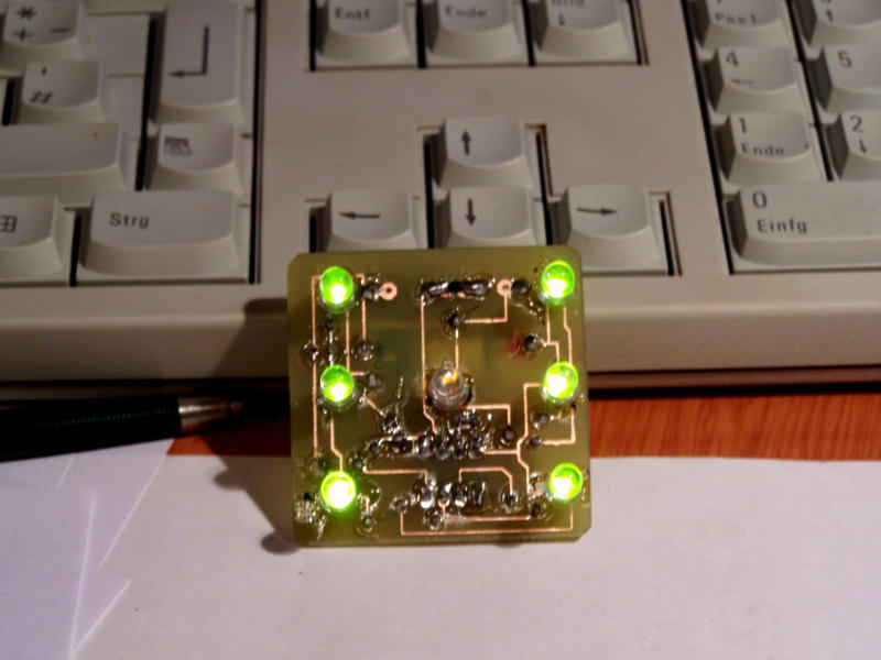

; Wuerfel mit 7 led an 4 portpins
;c. b.f.2005
; 3,6Volt - int. ozzilator  ca.500 khz
; power save mode
;plus piezopiepser fuer blinde :-)) an port pb1
; trigger  - level interupt on port pb1
.include "2343def.inc"
.device at90s2343
;    Bit     76543210
.equ  WZ6 = 0b1101000    ; bits for numbers
.equ  WZ5 = 0b11100100
.equ  WZ4 = 0b11101100
.equ  WZ3 = 0b11100101
.equ  WZ32 = 0b11110100    ; 2th for 3
.equ  WZ2 = 0b11101101
.equ  WZ22 = 0b11111100    ; 2th for 2
.equ  WZ1 = 0b11110101
.equ  WZa = 0b00011101  ; All LEDs
.equ  key = 0x01      ; Key on Port-Bit 1 from Port B
.def  Dice_Reg = r17    ; Register for the pictures
22
.def  Temp = r16      ; scratch
