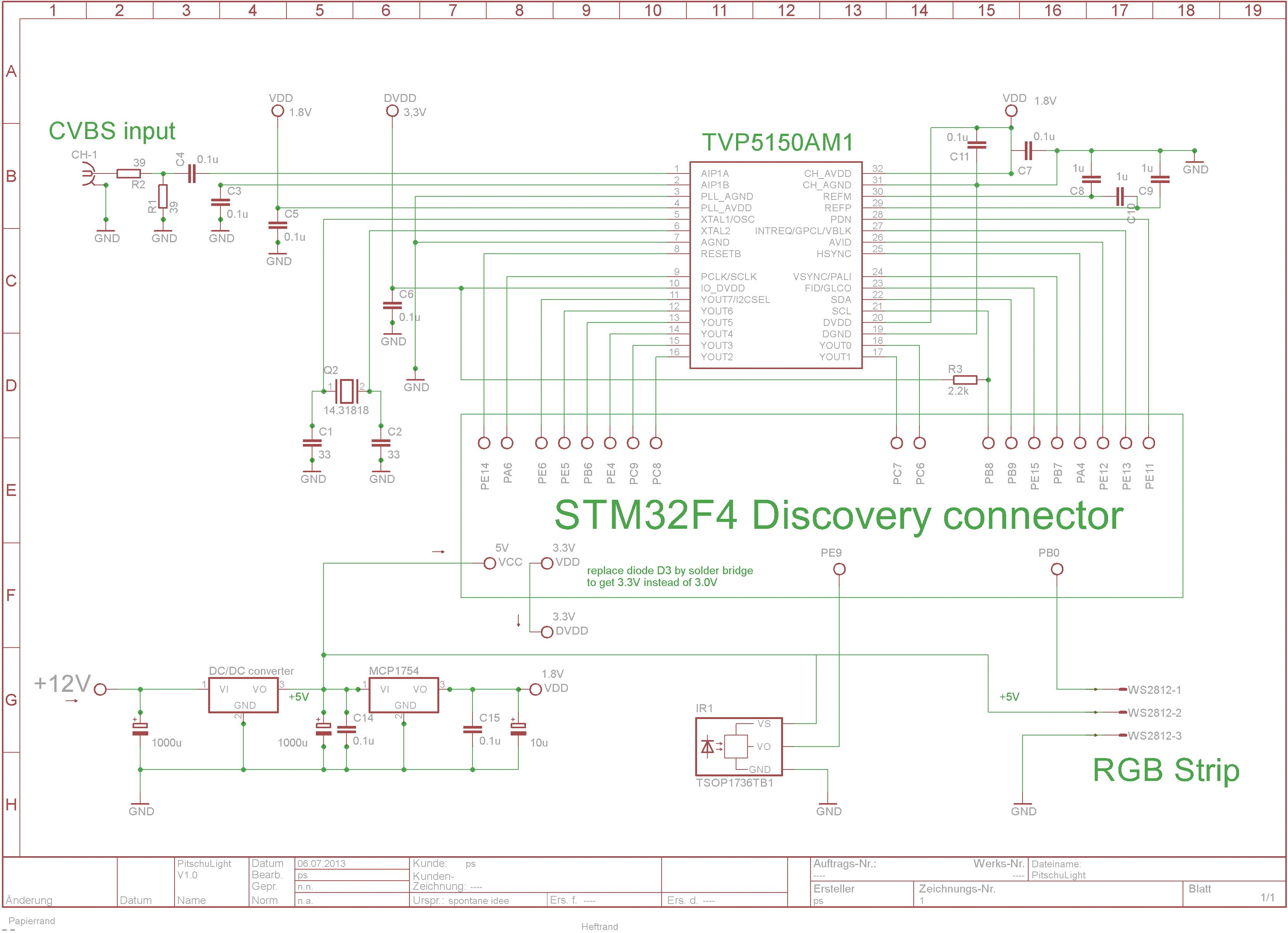

von zoe (Gast)
I got exactly this problem like Pat Wat has before, no video signal
can anyone check is there anything fail in this schematic and PCB?
(atached)

von pitschu (Gast)
The file formats in your rar file are not usable for me. Can you make
PDF files of the schematic? Especially the TVP input and connection to
the STM32 are important.

von pitschu (Gast)
I'm not sure whether you soldered the TVP right. It seems that you
connected the input signals to pins 17 + 18 instead of 1 + 2. But I
can't really check it with your picture (could you please mark the pin 1
on the picture).
Does the crystal 143F3I really have 14.31818 MHz?

von pitschu (Gast)
Yes, you are right, the I2C bus seems to be working. But the signal on
pins 1 or 2 looks wrong on your scope screenshot. It should look exactly
like the signal out of the chinch socket (second screen shot) with only
half of the amplitude. Maybe you damaged the TVP chip.

von pitschu (Gast)
That's right, but the peaks to GND are missing. These peaks (you should
see them at least every 20ms with your 'scope') are the X/Y sync signals
are are important for correct video detection. The status log shows,
that the sync signals are missing and the scope shows, that it's true
Please check the 1.8V and 3.3V supply of the TVP.
von Waldemar H. (vual)
Zoe schrieb:
> yeah i have measured it and it show like this. just a little bit lower
> than the original
> output from yellow chinch on converter
OK, sorry i misunderstood you. I thought the measurement on the TVP-Pin
was in Post Beitrag "Re: Ambilight mit STM32F4discovery und TVP5150AM1"
First of all, i don't see any FBs on your Board (photos), second I would
bridge all FBs (with a wire, solder-bridge) until the board has full
functionality and check the supply voltages with oscilloscope

von Zoe (Gast)
i used 1uh FBs for FB1 2 and 3,
von zoe (Gast)
the 1.8 voltage supply is 1.69 volt measured
the 3.3 is 3.14
von Waldemar (Gast)
> the 3.3 is 3.14
not good... but i don't know that this coases the problems
Datasheet says min 1,65V. Maybe you have some error in your measurement
and then you get in trouble
Is the voltage regulator getting hot? Maybe your TVP is bad and draining
to much current, so this will cause the lower voltage on 1,8V rail
have you looked with your oscilloscope: are the voltages stable?

von Zoe (Gast)
hello pitschu
after 1 busy month i got back to this board
change the 5150 AM1 chip vendor and got this like you said
status 0E
von Zoe (Gast)
the log lock 0E and nothing show out to the led.led is off
what is the problem here? the tvp board is working right? because the
video status is 0E
von Zoe (Gast)
finally the led turn on and reacto to the screen but with the weird way
the green on the screen is the white, the color is not true and only
afte the log show
IR data: 0040, rep count: 20
Mood/Ambi mode switched to 02
IR data: 0040, rep count: 1
Mood/Ambi mode switched to 01
the led turn on,
otherwise. it's off
help
von Zoe (Gast)
ah yes it's happen when i press the button on stm32 board. then log show
ir data received and led turn on. the black is pure green (wrong color)
and it's not stable
this is the log
q
Current dynRows:
 AVG:  89 107 111 115 112 114 105  96  96  96  97  95 102 100  96 103
83  94 12 160 137 153 152 152 153 157 138 129 29 130 131  76  91  96   0
0   0   0   0   0
 CON: 197 341 350 332 313 302 302 209 203 208 214 214 212 199 191 196
160 200 245 271 260 291 288 287 282 283 269 267 269 260 270 146  69 110
0   0   0   0   0   0
 ACH:   0  18   4   4  -3   2  -9  -9   0   0   1  -2   7  -2  -4   7
-20  11  30  36 -23  16  -1   0   1   4 -19  -9   0   1   1 -55  15   5
-96   0   0   0   0   0
 CCH:   0 144   9 -18 -19 -11   0 -93  -6   5   6   0  -2 -13  -8   5
-36  40  45  26 -11  31  -3  -1  -5   1 -14  -2   2  -9  10-124 -77
41-110   0   0   0   0   0
 dynTop = 0000, dynBot =   33
 Black level =    0
Current dynCols:
 AVG:  45  48  46  45  45  45  45  45  46  47  45  55  56  57  57  57
57  55  50  56  58  57  63  69  66  65  65  62  51  55  55  55  58  52
49  50  50  48  50  64  65  68  71  71  75  91  99 102 101 100  95  89
84  82  75  65  56  56  56  55  55  54  56  44
 CON: 140 153 154 150 145 147 146 153 160 179 185 229 281 290 296 302
300 288 292 298 295 295 283 323 316 325 317 307 249 286 303 315 321 256
248 254 252 225 246 323 330 335 339 341 358 396 395 404 404 400 391 381
347 336 303 258 199 204 207 202 204 190 174 118
 ACH:   0   3  -2  -1   0   0   0   0   1   1  -2  10   1   1   0   0
0  -2  -5   6   2  -1   6   6  -3  -1   0  -3 -11   4   0   0   3  -6
-3   1   0  -2   2  14   1   3   3   0   4  16   8   3  -1  -1  -5  -6
-5  -2  -7 -10  -9   0   0  -1   0  -1   2 -12
 CCH:   0  13   1  -4  -5   2  -1   7   7  19   6  44  52   9   6   6
-2 -12   4   6  -3   0 -12  40  -7   9  -8 -10 -58  37  17  12   6 -65
-8   6  -2 -27  21  77   7   5   4   2  17  38  -1   9   0  -4  -9 -10
-34 -11 -33 -45 -59   5   3  -5   2 -14 -16 -56
 dynLeft = 0000, dynRight =   63
 Black level =    0
von Zoe (Gast)
aaaaaaaaaaaaaaaaaaaaaaaaaaaah yeasssssssssssss everything is working
now. just solder wrong pin E6 so all green color.
thank you all

ich habe ein Board hier liegen.
Leider bekomme ich nichts vom TVP5150. Ist der TVP5150 kaputt?:
Auto switch source to 1
No video signal at source 1, mode = 0
Auto switch source to 2
No video signal at source 2, mode = 0
von Pit S. (pitschu)
Das sieht so aus, als ob der I2C keinerlei Daten vom TVP bekommt (nur
0en). Prüf mal, ob die I2C Pullups vorhanden sind und die CLK line
toggelt. Die Spnnungsversorgung des TVP auch mal checken. Im schlimmsten
Fall ist der TVP wirklich hin.
pitschu
von Fridolin O. (muebau)
Das Board ist doch so korrekt zusammengesteckt, richtig?
Und die Schraubkontakte habe ich wie in der Zeichnung verwendet.
Da es sich um ein Board von Stefan E. (guellehans) handelt sollte das
alles korrekt sein. Er sagte er habe das Board damals getestet.
> Im schlimmsten
Naja das koennte dann nur ueber ESD passiert sein.
Wie koennte ich den Tod vom TVP5150 feststellen?
muebau
von Hoang Anh LeZoe (Gast)
FB1 nd FB3 are open (3rd image) so no 1.8vA and AGND for tvp5150. just
bridge them with solder or use ferrite beads
Thank you a lot. The ambilight works perfectly.
