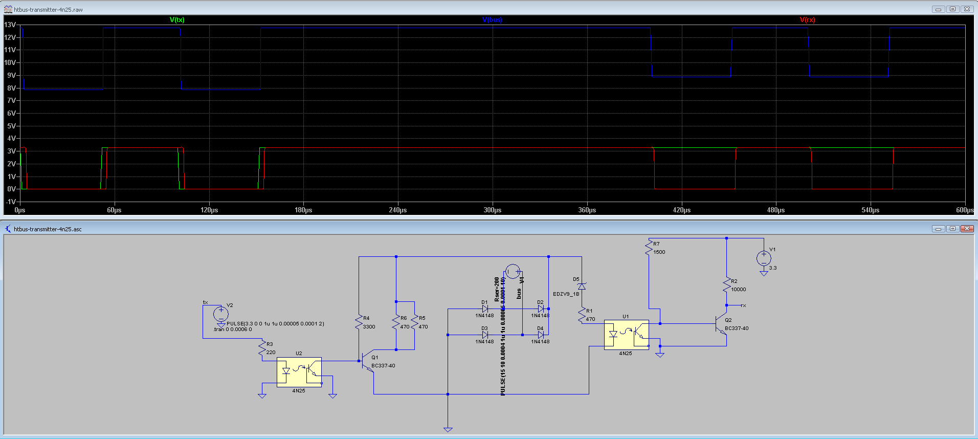

Luca schrieb: > I'd like to get the simulation working correctly so I can swap the > optocouplers with different ones I have available and see if the > waveform is still acceptable. I'm not sure you'll find that used optokopplers in LTspice. It's better to compare the datasheets of that selected optokopplers I'll think. Most important is the rise- and fall-time to get the best serial signalisation. Regards Norbert
Oh, I found a model online for the H11L1, the optocoupler I have available has no schmitt trigger and even if it is slower it gave an apparently good enough result in the receiver, but I'd like to simulate the transmitter.

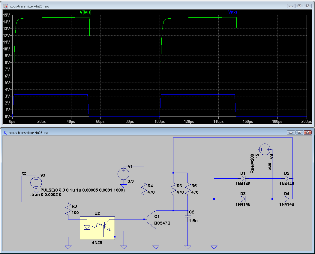

I came up with this circuit (I have some 4N25 around), do you think it could work?
Mmh, I put V1 on the bus side so I was losing the isolation provided by the opto. This is a revised version with the transmitter and receiver. What do you think?

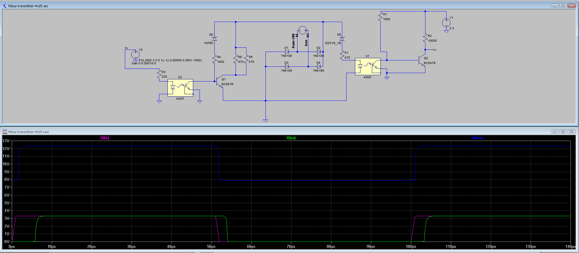

Luca schrieb: > This is a revised version with the transmitter and receiver. > What do you think? Your simulated 4N25 seems to be fast enough to do the job. But there are some problems with that design: 1. Q1 is closed (default current-flow) if V2 is low or disconnected. -->> No 'failsave' available and blocking the heater-bus on failures. 2. D6 not required, but use the resistor-value with higher value. 3. UART-signals from MCU have high-levels in idle-mode, so your design is wrong. Please look at my design, strip it down and simulate this with the 4n25. Regards Norbert
Hello, thank you for your feedback, really appreciated. Regarding 1., I didn't think of that, but since my bus is currently unused and I will only connect this interface, in turn permanently connected to an esp32 (so that V2, aka tx, will be idle high, phototransistor of U2 closed, Q1 open, bus high), I'm not sure it is a problem. Regarding 2., good, I'll remove the zener and adjust the resistor. Regarding 3., maybe the ltspice model I found of the H11L1 is wrong, but when I simulated your transmitter it gave me the same result as my circuit: tx high, (idle) green trace) -> bus high (blue trace), tx low (transmitting) -> bus low. Same for the receive side: bus high -> rx high, bus low -> rx low. Should they be inverted?
Latest iteration with the zener removed and changes in the simulation (V2 simulates the transmission for a short while and after that V4 simulates the reception). Edit: in the real circuit the GND in the middle won't be connected, but AFAIK in ltspice it's needed otherwise it cannot simulate the circuit.

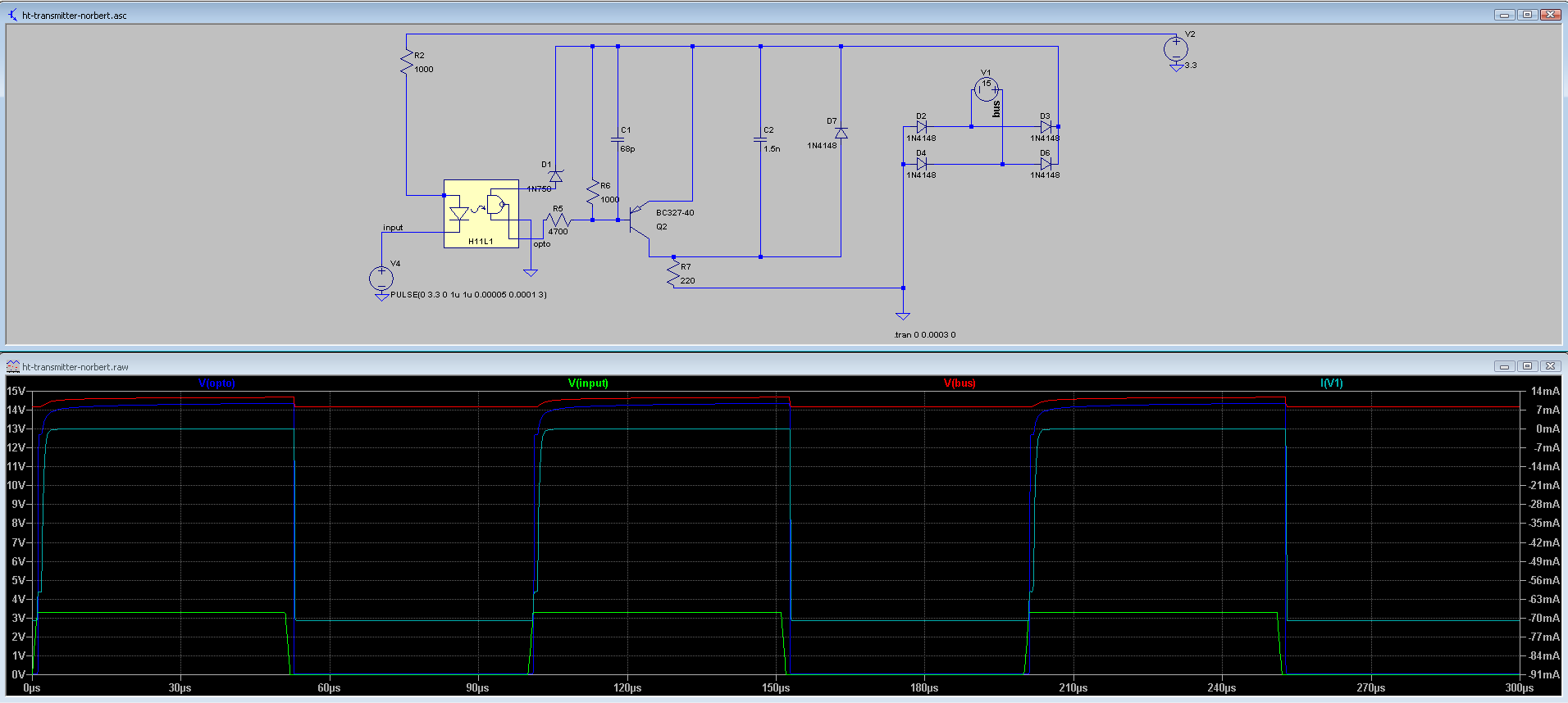

This is my attempt to simulate your circuit. As I said in my first message, the voltage swing is very low, but the current in the bus seems ok (70mA, not really sure it's actually ok). But I see that it follows the input (input high -> optocoupler high -> bus high, input low -> optocopler low -> bus low).

Luca schrieb: > This is my attempt to simulate your circuit. > As I said in my first message, the voltage swing is very low, but the > current in the bus seems ok Thanks for your simulations-attempts. Keep in mind that this heater-bus has NOT a full-duplex communication. You have to simulate that RX-direction and the TX-direction separately and not in one turn. Regards Norbert
Norbert S. schrieb: > Luca schrieb: >> This is my attempt to simulate your circuit. >> As I said in my first message, the voltage swing is very low, but the >> current in the bus seems ok > Thanks for your simulations-attempts. > Keep in mind that this heater-bus has NOT a full-duplex communication. > You have to simulate that RX-direction and the TX-direction separately > and not in one turn. Yes, that's what I did in htbus-transmitter-4n25.asc (*) (I first simulate a couple of pulses in the tx side, then, after a delay, a couple of pulses on the bus (to test the rx side). In case of ht-transmitter-norbert.asc I only simulated the transmitter. (*) It turns out that what I have available are 4n27 but the simulation doesn't change.
