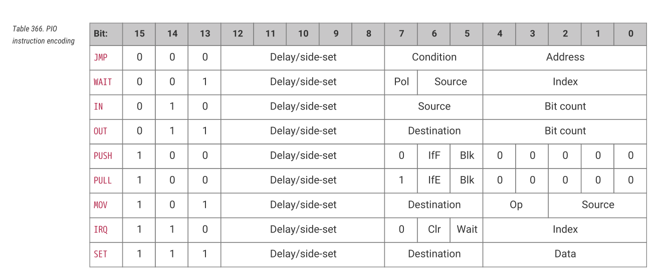

3.3.7. Pseudoinstructions
Currently pioasm provides one pseudoinstruction, as a convenience:
nop
Assembles to mov y, y . "No operation", has no particular side effect, but a useful vehicle for a side-set
operation or an extra delay.

Siehe Datenblatt
3.4.7.2. Operation
A nonblocking PULL on an empty FIFO has the same effect as MOV OSR, X. The program can either preload scratch register X with a suitable default, or execute a MOV X, OSR after each PULL NOBLOCK, so that the last valid FIFO word will be recycled
until new data is available.
