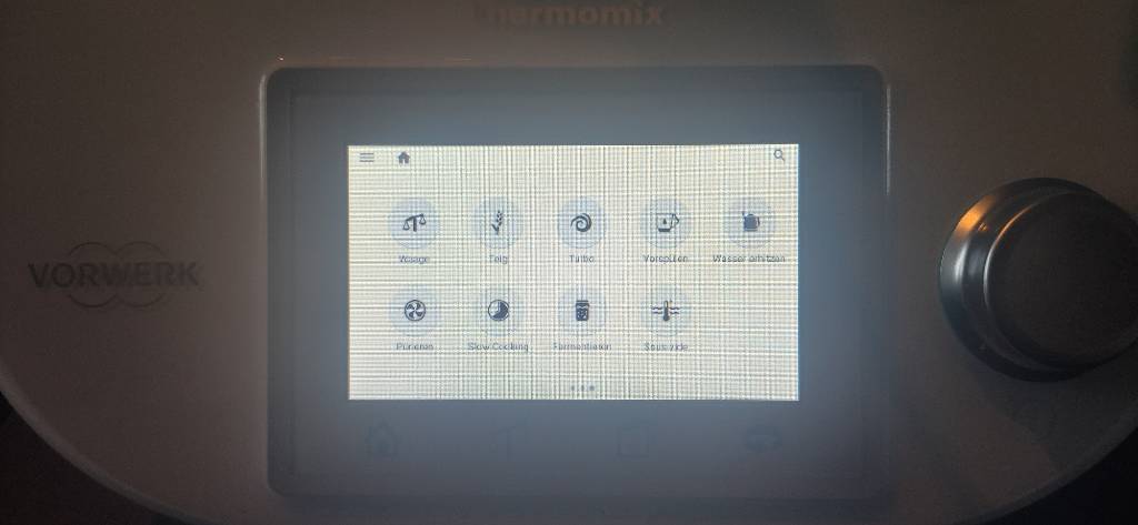

Hans H. schrieb:
> TM6 is coming:
> https://thermomix.vorwerk.de/thermomix/tm6/
Seems like Vorwerk is pissed....
von Bimby T. (bimby)
Martin S. schrieb:
> Hans H. schrieb:
> TM6 is coming:
Well it seems that they tried to copy the Monsieur Cuisine Connect from
Lidl...
Allmost all new features could be added to the TM5 with a software
update...
Here the first test and differences to the TM5:
https://youtu.be/5fjKtTg441g
Maybe it is time to find out a way how to upgrade the TM5 with the
software from the TM6... :P
von Ivo B. (ivoburkart)
Sieht aus als hätte der TM6 eine Web-basierte Oberfläche :-)
von Hans H. (Firma: kobs-ng) (haschhans)
Was genau verleitet dich zu dieser Aussage?
von Marco H. (marco_h883)
Hans H. schrieb:
Wir haben den TM6 zu Hause stehen. Ich würde auch sagen, dass der
Zugriff auf die Rezeptarchive webbasiert ist. Aber andere Funktionen
sind wie bisher keine weboberfläche.

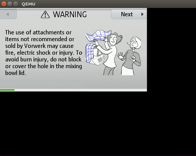

von Erlantz L. (erlantz_l)
Hello from Spain ;)
Boot GUI Sistem (actually working on it):
/opt/Thermomix.sh : script that launches log processes and calls the GUI
/usr/sbin/supervisor : "supervises" tm5 hardware and if all is ok runs
 the thermomix GUI (binary is /opt/Thermomix/Thermomix )
/usr/sbin/supervisor_config.xml : here are the parameters thar reads
supervisor
We can launch supervisor from shell as root:
supervisor -m SERVICE  :a mode that lifts with preset IP (192.168.76.1),
mouse and keyboard, uses some port but does not start the GUI
supervisor - m GUI : It runs the GUI, and yo can see a screen but but
you still can not move forward, I need a mouse
Other servies:
supervisor -m OTA : search upgrade
To launch linux  I use the tm5.sh script  that is in this forum
(Beitrag "Re: Thermomix Rezeptchips")
but not necessary chroot, and I have changet it to launch witch screnn
and 256M of ram (max ran to qemu) :
qemu-system-arm -M versatilepb -kernel vmlinuz -initrd initrd.img -m
256M -hda disk.qcow2 -append "root=/dev/sda1" -redir tcp:8022::22
thins to do:
It,s not necesarry to mount partition, you can make it in same
partition:
mkdir -p /mnt/rwfs/data/system_config
Copy binaries fron thermomix rootfs
cp -r /tm5/usr/* /usr
cp -r /tm5/opt/* /opt
rc.local form thermomix rootfs is not necessary, only the binaries that
I mention are necessary
Note: I'm trying to stabilize GUI, from time it falls
I use a raspberry pi 2b witch chroot, supervisor service works but I
still have no luck witch  touch screen I can't use screen. If anyone can
use screen (ikaro) please tell us how can
I do not know how to apply that with qemu, but I am sure the tm5 uses
the NOVATEK NT11004 display, this should be the touchscreen driver :)
https://github.com/wondermedia/wm8850/tree/master/ANDROID_3.0.8/drivers/input/touchscreen/novatek

von Peda D. (peterdan8888)
I habe angefangen dem Editor von Kyroth das Datenbankformat vom Rezept
Chip beizubringen.
Das entpackte Image vom Rezept-Chip (enc_dump) wird benötigt um den
Editor zu testen.
Zzt. kann er nur Rezeptdaten einlesen. TM-Schritte und
Änderungen/zufügen folgt im Laufe der Zeit.
Kann das alles nur nicht testen, da der Raspistick bei mir leider nicht
funzt.
Würde mich sehr freuen wenn jemand mit mehr Zeit und/oder besseren
Programmierkenntnissen
das Teil übernehmen will (Benötigt HTML/JS/SQL Kenntnisse)
Quellcode ist zzt ein wenig chaotisch da ich einfach über den Code von
Kyroth "drüberprogrammiert" habe.
Das Bild stammt von einem Test, lasst euch also nicht verwirren, er
liest das schon richtig ein.
Hello,
I have added basic database support for Kyroth's editor (from 2016)
atm, it can only read in the recipes from the cook stick (enc_dump is
needed from your recipe-chip).
I can unfortunately not test whether changed/new data is compatible,
because the raspi stick does not work for me.
But i will continue on this editor until somebody with better
programming skill and/or more time will adopt it.
It uses HTML/JS/SQL and was tested on Mozilla and Chrome.
Scource Code is a mess right now, because I have overwritten SOME parts
to get the database included.
The picture is from a test so don't get irritated - recipe reading works
well.
Peter
We can do:
- decrypt cook-sticks, modify and add recipes with a python library
- simulate cook-sticks with rpi zero
- download recipes from cookidoo and add them to a cook-stick
- make TM accept modified cook-sticks on firmware 2.4 and before
- gain root access on firmware 2.4 and before
- emulate firmware with qemu, unpack update packages
We can not do:
- make TM accept modified cook-sticks on firmware >2.4
- gain root access on firmware >2.4
- downgrade TM to 2.4
- emulate TM's touchscreen gui with qemu
We will do:
- create web gui running on rpi zero, using the library, to add, edit
and share recipes comfortably
We could do:
- test things for you with root access on our second TM
- help you working on downgrading to 2.4
If you have questions or want to contribute to the web gui, please write
a message.
