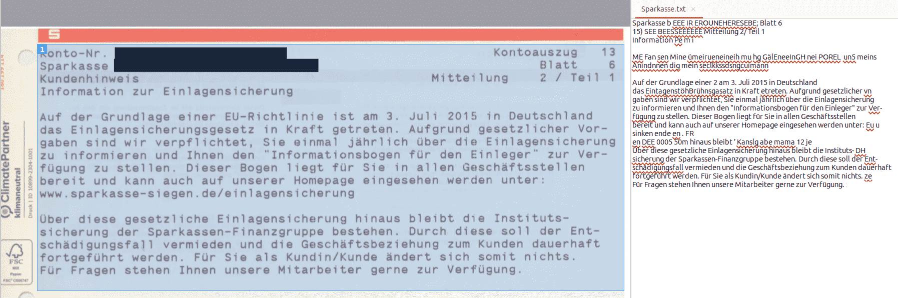

cat Blocktext.jpg |java -jar tika-app-2.9.1.jar erkent: INFO [main] 16:03:57,018 org.apache.tika.parser.ocr.TesseractOCRParser Tesseract is installed and is being invoked. This can add greatly to processing time. If you do not want tesseract to be applied to your files see: https://cwiki.apache.org/confluence/display/TIKA/TikaOCR#TikaOCR-disable-ocr <?xml version="1.0" encoding="UTF-8"?><html xmlns="http://www.w3.org/1999/xhtml"> <head> <meta name="Resolution Units" content="inch"/> <meta name="Number of Tables" content="2 Huffman tables"/> <meta name="File Modified Date" content="Do. März 14 16:03:56 +01:00 2024"/> <meta name="Compression Type" content="Progressive, Huffman"/> <meta name="Data Precision" content="8 bits"/> <meta name="Number of Components" content="3"/> <meta name="tiff:ImageLength" content="1233"/> <meta name="Component 2" content="Cb component: Quantization table 1, Sampling factors 1 horiz/1 vert"/> <meta name="Thumbnail Height Pixels" content="0"/> <meta name="Component 1" content="Y component: Quantization table 0, Sampling factors 1 horiz/1 vert"/> <meta name="Image Height" content="1233 pixels"/> <meta name="Thumbnail Width Pixels" content="0"/> <meta name="X Resolution" content="300 dots"/> <meta name="Image Width" content="2456 pixels"/> <meta name="File Size" content="386189 bytes"/> <meta name="Content-Type-Parser-Override" content="image/ocr-jpeg"/> <meta name="Component 3" content="Cr component: Quantization table 1, Sampling factors 1 horiz/1 vert"/> <meta name="Version" content="1.1"/> <meta name="X-TIKA:Parsed-By" content="org.apache.tika.parser.DefaultParser"/> <meta name="X-TIKA:Parsed-By" content="org.apache.tika.parser.image.JpegParser"/> <meta name="X-TIKA:Parsed-By" content="org.apache.tika.parser.ocr.TesseractOCRParser"/> <meta name="File Name" content="apache-tika-15348064881531317815.tmp"/> <meta name="tiff:BitsPerSample" content="8"/> <meta name="tiff:ImageWidth" content="2456"/> <meta name="Content-Type" content="image/jpeg"/> <meta name="Y Resolution" content="300 dots"/> <title/> </head> <body><div class="ocr">a0ov 277 44% 1] ClimatePartner klimaneutral Sparkasse Blatt 6 Kundenhinweis Mitteilung 2.07> Ter 4 Information zur Einlagensicherung Auf der Grundlage einer EU-Richtlinie ist am 3. Juli 2015 in Deutschland das Einlagensicherungsgesetz in Kraft getreten. Aufgrund gesetzlicher Vor- _ gaben sind wir verpflichtet, Sie einmal jahrlich Uber die Einlagensicherung = zu informieren und Ihnen den “Informationsbogen flr den Einleger”™ zur Ver- * flugung zu stellen. Dieser Bogen liegt fiir Sie in allen Geschaftsstellen ® bereit und kann auch auf unserer Homepage eingesehen werden unter: o WWW.Sparkasse-siegen.de/einlagensicherung ° Uber diese gesetzliche Einlagensicherung hinaus bleibt die Instituts- sicherung der Sparkassen-Finanzgruppe bestehen. Durch diese soll der Ent- | schadigungsfall vermieden und die Geschaftsbeziehung zum Kunden dauerhaft fortgefihrt werden. Fur Sie als Kundin/Kunde andert sich somit nichts. Fir Fragen stehen Ihnen unsere Mitarbeiter gerne zur VerfUgung. </div> </body></html>
Umlaute Fehlanzeige? Welche Sprache war eingestellt? Olivers große Kopiererverschwörung habe ich noch nicht angeschaut: "Im August 2013 kam heraus, dass so gut wie alle Xerox-Scankopierer beim Scannen Zahlen und Buchstaben einfach so durch andere ersetzen."
Franko S. schrieb: > cat Blocktext.jpg |java -jar tika-app-2.9.1.jar > erkent: eher nicht so viel richtig. Oliver

1 | tesseract Blocktext.jpg delme -l deu |
2 | Tesseract Open Source OCR Engine v4.1.1 with Leptonica |
3 | cat delme.txt |
liefert:
1 | BUU AFFE REN |
2 | |
3 | „ ClimatePartner |
4 | |
5 | klimaneutral |
6 | |
7 | Sparkasse Blatt 6 |
8 | Kundenhinweis Mitteilung 2: Je Teilıd |
9 | Information zur Einlagensicherung |
10 | |
11 | Auf der Grundlage einer EU-Richtlinie ist am 3. Juli 2015 in Deutschland |
12 | das Einlagensicherungsgesetz in Kraft getreten. Aufgrund gesetzlicher Vor- |
13 | . gaben sind wir verpflichtet, Sie einmal jährlich über die Einlagensicherung |
14 | = zu informieren und Ihnen den "Informationsbogen für den Einleger” zur Ver- |
15 | 3 fügung zu stellen. Dieser Bogen liegt für Sie in allen Geschäftsstellen |
16 | |
17 | & bereit und kann auch auf unserer Homepage eingesehen werden unter: |
18 | |
19 | 2 wWww.sparkasse-siegen.de/einlagensicherung |
20 | |
21 | ° Über diese gesetzliche Einlagensicherung hinaus bleibt die Instituts- |
22 | sicherung der Sparkassen-Finanzgruppe bestehen. Durch diese soll der Ent- |
23 | \ schädigungsfall vermieden und die Geschäftsbeziehung zum Kunden dauerhaft |
24 | fortgeführt werden. Für Sie als Kundin/Kunde ändert sich somit nichts. |
25 | Für Fragen stehen Ihnen unsere Mitarbeiter gerne zur Verfügung. |
Vorher bearbeitet: gecropped, per schwellwert nach schwarz/weiss gewandelt: tesseract wie oben aufgerufen:
