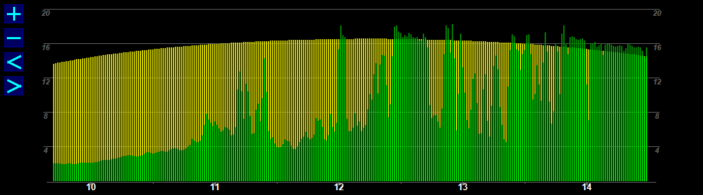

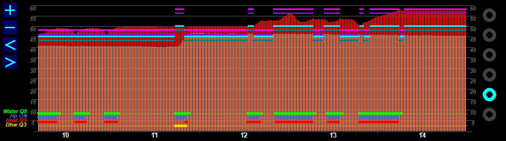

von Silvio A. (silvio_a)
I want to share the good functioning of the Photovoltaic and ThermoPump
systems.
Attached two snapshots of the graphs of the day 01/25/2015 with sun and
scattered clouds.
1- PW graph shows the production, in green, of the photovoltaic system
    with reference to the theoretical production, in yellow.
2- HT graph describes the activity of the heatpump.
    horizontal lines, in fuchsia, are the setting of the value 740" and
"741";
    horizontal lines, in cyan, are the setting of the values "1610" and
"1612".
3- As can be seen, when the production of energy exceeds 10 kWh,
    for at least 3 minutes, the settings are raised;
    if it falls below this level, again for 3 minutes, the settings are
lowered.
4- The heat demand ends at 10:40;
    resumes at 12:30; the temperature has a steep descent, sensor B4,
rises again at 12:41, but stops at 12:46.
5- The heat demand ends at 13:30.
6- From 13:30 onwards there is an accumulation of heat power.
7- the shortest length of Hp-ON, in blue, is 8 minutes, the new setting
   of "2842".
8- the shortest distance of Hp-ON, in blue, is 10 minutes, the new
setting
   of "2843".
I am very Happy.
Silvio.

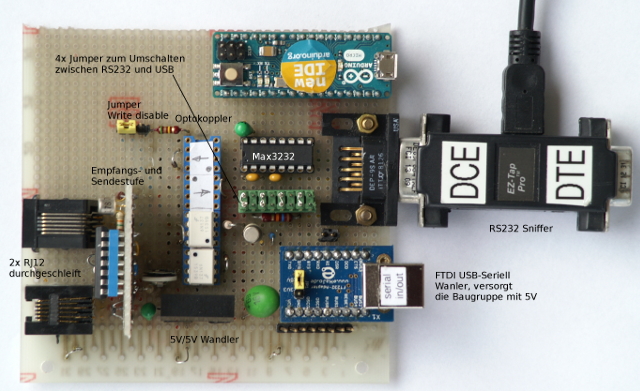

von Michael R. (mitternachtsdiver)
Hi Mauro,
You can use the diagram i posted on 9.1.2013, regarding arduino check
the post from Sacha on 26.1.2013 (BSB.rar)
I also posted on 5.1.2013 a spreadsheet with parameters that might help
to identify messages on the bus depending on the system you try to
access.
Best regards
Michael

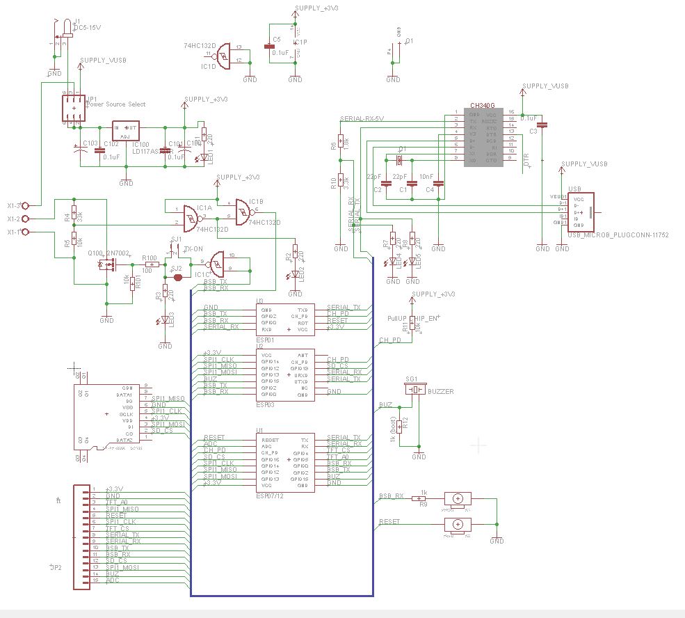

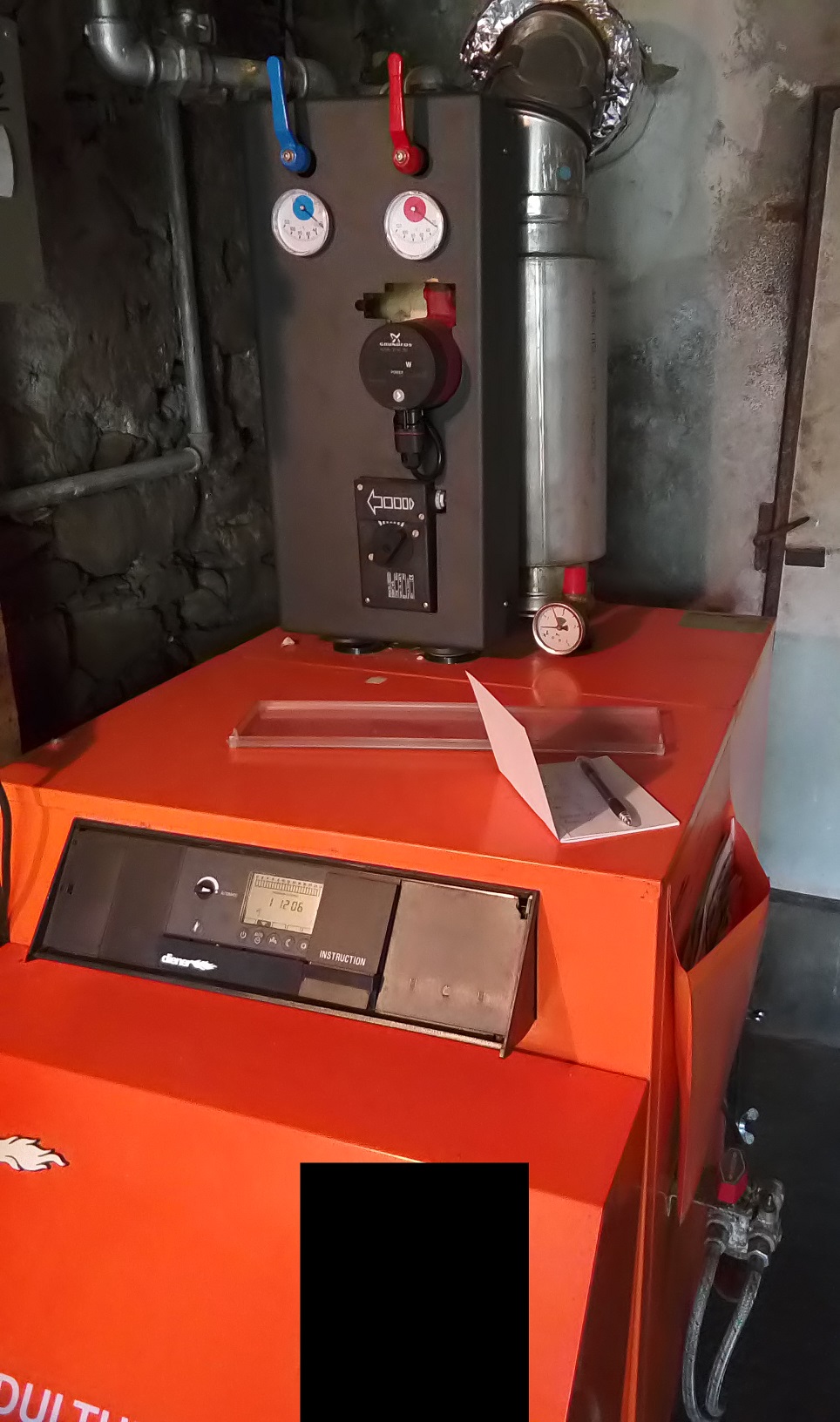

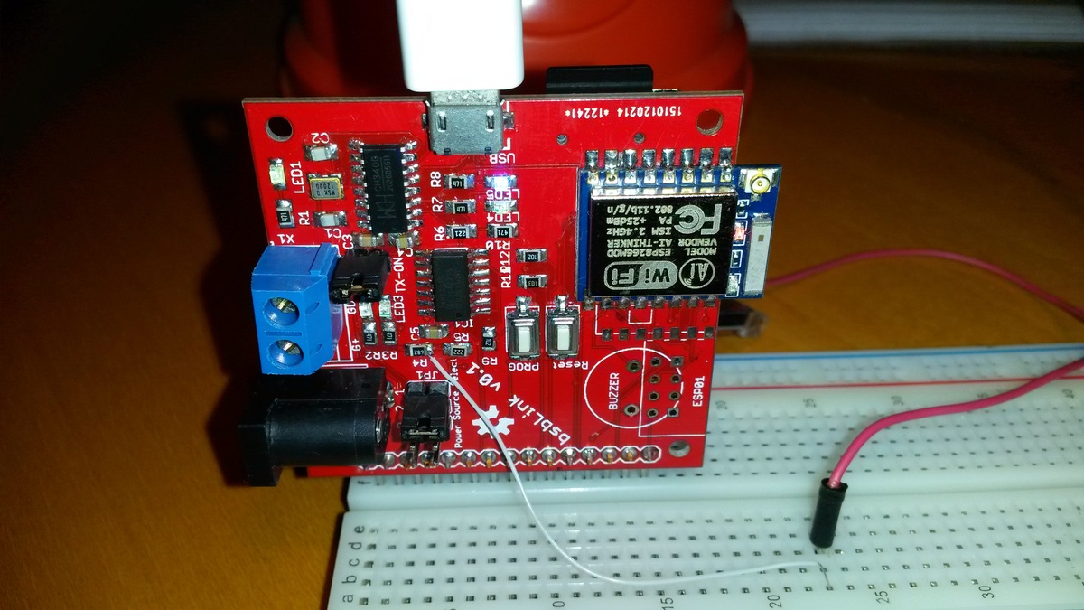

von Rolf S. (layerone)
Guten morgen
Draussen liegt der erste Schnee und ich habe einigen Output zu
verkünden.
Zuallererst möchte ich allen Beteiligten insbesondere Kuscheganxta
,anndann , mitternachtsdiver und niob danken.
Ihre Erkenntisse haben mir als Hobbybastler sehr geholfen.
Ich habe mich diesen Herbst entschlossen, meine neue Heizung zwecks
datenauswertung und optimierung zu überwachen.
Ich habe diesen inzwischen sehr langen Thread gelesen, etwas
zusammengefasst, eine kleine Schaltung erstellt, ein Platinchen in China
bestellt, etwas C++ zusammenkopiert, ein Excel erstellt und einige
weitere Quellen im Internet bemüht.
Gerne würde ich eure Meinung und insbesondere Verbesserungsvorschläge
entgegennehmen.
Das Modul basiert auf dem ESP8266, welcher auch mit der Arduino IDE
programiert werden kann und nebenbei Wifi eingebaut hat.
Die Daten werden auf eine MicroSD Karte geloggt. Seit zwei Wochen ist
der Prototyp an einer Thysion S mit einer Siemens LMU7 am bsb Bus aktiv
und speichert minütlich KesselTemp/Vorlauf/Rücklauf und
Aussentemperatur.
Bei der Schaltung würde ich gerne noch einen Verpolungsschutz und
Entstörung einbauen. Bei der Spannungsversorgung bin ich mir bezüglich
Verlustleistung und Stabilität nicht ganz sicher (peak ~200mA).
Hat eine Elektronikprofi Lust und Zeit ?
Die Korrelation der bsb Commands (A1..A4) mit einer
Bedienzeilennummer(BZ) habe ich mit einem C# progi erstellt, welches via
Serial das Telegramm zur aktuellen gewählten Bedienzeile empfängt und
nach der entsprechenden BZ fragt. Beim AVS37 Display sind einige
Menüpunkte mit zwei Werten ausgestattet, und generieren auch
entsprechend Requests/Answer Telegramme auf dem Bus und sind in der
Datei bsbcmd.txt mit "-2" erkennbar.
So kann man bequem im Fachmannmodus jede Einstellung an der Heizung
anwählen und am Notebook die entsprechende BZ eingeben.
In diesem Zusammenhang bin auch das Dokument LMU-2.08-3.0-p7494_1e.pdf
von Siemens gestossen, welches einige Parameter sehr detailiert erklärt.
Leider behandelt es nicht alle Parameter, da es sich auf die ältere
LMU64 bezieht.
Hat jemand ein solches Dok in Deutsch für die LMU7 ?
Weitere Meilensteine:
Ich werde in den nächsten Tagen/Wochen einigen Code auf Github
platzieren und eine v0.2 der Platine erstellen.
Auch wird Wifi/mqtt ein Thema sein.
Die wichtigsten Fakten zum Bus findet Ihr unter
http://steini.net/wp/?p=139 und zur Platine http://steini.net/wp/?p=192
gruss aus der verschneiten Schweiz

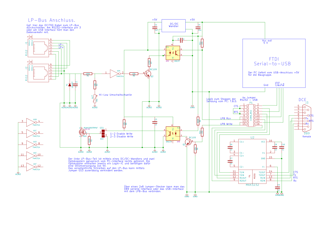

von Harald B. (brha)
Guten Tag!
1. Oben hat schon ein Schreiber die Frage gestellt, was aus dem Wiki
geworden ist.  Ist das nun endgültig in der Versenkung verschwunden?
2. Ebenfalls ist hier mehrfach die Frage gestellt worden, wie die
Sendeelektronik des LPB-Bus-Interfaces mit Spannung versorgt werden
soll.  Ich hatte mir einen Design wie folgt überlegt, auch inspiriert
durch die galvanisch getrennte Schaltung mit Optokopplern aus diesem
Forum.  Das Ergebnis ist, kurz gefasst: für die LPB-Bus-Sendeseite kann
ein DC-DC-Wandler die Stromversorgung übernehmen.  Hier die Langversion
der Beschreibung:
Die Verbindung zum PC geht über USB mit einem FTDI Schnittstellenwandler
USB <=> seriell. Die Platinchen gibt es fertig, sie sind in der Lage,
außer der Signalwandlung nebenbei auch 5V mit max 500mA (siehe USB
Spezifikation) für das gesamte Interface zu liefern. Damit ist die Frage
der Stromversorgung für das LPB-Bus Interface insgesamt beantwortet. Das
OCI700 Service Tool wird ja auch über ein USB-Kabel mit dem PC verbunden
und braucht keine externe Stromversorgung.
Der FTDI-Wandler liefert serielle Empfangs- und Sendedaten mit
TTL-Level. Serielle Empfangsdaten vom LPB-Bus gehen zum PC, serielle
Sendedaten vom PC gehen zum LPB-Bus. Mit einem Pegelwandler TTL <==>
RS232 könnte man diese beiden Datenströme abgreifen und an einem
zusätzlichen seriellen Interface mitschneiden (oder gleich ein solches
serielles Interface als Datenverbindung zum PC benutzen).
Ich denke an einen Ausbau der PC-Seite mit einem Arduino, der schon
Empfangsdaten vorverarbeitet, bevor der PC sie zu sehen bekommt und der
beim Senden CRCs einfügt und auf Kollisionen prüft.
Optokoppler für Daten vom und zum LPB-Bus zwischen der PC-seitigen
Elektronik und dem LPB-Bus-Interface trennen die Heizung galvanisch vom
PC.
Die Stromversorgung des LPB-Bus-Interface ist ueber einen DC-DC-Wandler
(ca. 3 Euro) ebenfalls galvanisch getrennt. Der Preis geht im Rauschen
des Projekts unter).
Diese Trennung lässt mich, was die Heizung angeht, ruhig schlafen.  Ein
abgerauchter PC wäre einfacher zu ersetzen :-)
Das LPB-Bus Interface sieht aus, wie schon im Forum beschrieben:
empfangsseitig ein Spannungsteiler und (Darlington-)Transistor als
Eingang, der Transistor treibt die LED in einem Optokoppler LPB-Bus ==>
PV. Der Ausgang eines  zweiten Optokopplers PC ==> LPB-Bus treibt einen
MOSFET als Sende-Schalter. Es gibt Optokoppler mit integriertem CMOS/TTL
Treiber (hp 5082-4360, 6N137, HCPL2630 (dual), PC900V, usw.), welche die
Schaltung auf beiden Seiten vereinfachen helfen.  Deren aktive
Ausgangsstufen benötigen aber eine Betriebsspannung; ohne einen
DC-DC-Wandler für diese Spannungsversorgung funktioniert das nicht.

Erfolgsmeldung: Mein Eigenbau-Interface funktioniert lesend und - noch
ohne CSMA/CA, das wird der nächste Schritt - schreibend.  Was ich vom PC
über eine serielle Leitung an das Interface sende, wird auf den Bus
geschrieben und unmittelbar vom Empfangsteil, das am Bus hört, über die
serielle Leitung wieder an den PC zurückgegeben. Die Heizungssteuerung
und einen LB-Bus brauche ich zu diesem Test nicht, nur ein 12V-Netzteil
und einen Pull-up Widerstand an der Bus-Datenleitung :-)
Als nächstes kommt die von Sascha auf dem Arduino programmierte
Kollisionsvermeidung zum Einsatz.  Eigentlich sollte dafür ein Arduino
micro ausreichen.  "We'll see, said the blind man as he picked up the
hammer and saw."
Bei der Portierung der BSB.rar Software (siehe oben) auf einen Arduino
micro habe ich folgendes festgestellt:
1. Man muss beachten, dass der Arduino micro nicht die selben Rx/Tx Pins
für das Software UART verwenden kann wie der Arduino Uno, für den Sascha
sein Programm geschrieben hat.
"Not all pins on the Leonardo and Micro support change interrupts,
so only the following can be used for RX: 8, 9, 10, 11, 14 (MISO),
15 (SCK), 16 (MOSI)."
Ändern der Instantiierung in BSB_Demo.ino
// Arduino Uno:
// RX Pin 5, TX Pin 4
//BSB bus(5,4);
// Arduino micro:
// Rx Pin 8, Tx Pin 9 (beispielsweise)
BSB bus(8,9);
2. In Zeile 172 in bsb.cpp habe ich den Zähler der for-Schleife
sicherheitshalber auf null initialisiert: for (byte i=0; i < LEN; i++)
3. Sascha verwendet eine modifizierte SoftwareSerial library, um eine
Methode aufrufen zu können, die in der Arduino SoftwareSerial-library
'private' wäre. In seiner modifizierten SoftwareSerial library ist in
der include-Datei SoftwareSerial.h die Methode uint8_t rx_pin_read() bei
den 'public' Methoden statt bei den 'private' Methoden aufgeführt.
Sollte der Compiler diesen Fehler melden, hat man die Standard-Arduino
library erwischt.
Ob die SoftwareSerial library die Daten invers oder in Standardlage
verarbeiten soll, könnte man im Konstruktor über einen dritten boolschen
Parameter bestimmen.

Es gibt bei mir einige BZ (ELCO-avs37) mit zwei Anzeigewerte, diese habe
ich in der EtherCalc Tabelle mit einem -2 postfix versehen.
Die protocol.md ist herrvorragend.
Es gibt noch das Telegram type=8 [ERROR] und entsteht wenn z.B ein
illegales cmd (Field ID) abgesetzt wurde try 063D0D0518.
@brha
EtherCalc
hat in der tabelle oben links so einen pfeil nach unten -> Export in
html|csv|Excel.
cmddb.txt
Ich hab mir ein C# Progi zusamengestiefelt, damit ich bei der
Korrelation CMD und BZ keine Fehler mache (steno liegt mir nicht) .
Die Anbindung erfolgte seriell an den bsblink und prüfte, ob zum cmd
eine BZ vorhanden ist, ansonsten erscheint eine Inputbox für die Eingabe
der unbekannten BZ. Das ganze war ein "Quick and Dirty" Aufbau.
Die entstandene Datei war im Post
Beitrag "Re: Brötje ISR Plus Kommunikation / LPB".
Siemens LMU's
Grundsätzlich werkelt beim BSB immer eine Siemens Steuerung, welche von
OEM "individualisiert werden kann.Im Kapitel 12 @
LMU-2.08-3.0-p7494_1e.pdf findet man zwei weitere nummernspalten und
eine TextSpalte (z,b pH2Omin) und die entsprechenden Berechtigunslevels.
Leider führt dieser Weg der Datenaquise nicht wirklich zum Ziel, wenn
man nur einige "nützliche" Werte auslesen möchte. Siemens könnte sich
viel Reputation holen, wenns Sie etwas auf Transparenz setzten würden.
SoftwareSerial:
Diese Erfahrungen habe ich auch gemacht. Ich würde gerne auf HW Serial
wechseln (robuster und Parity ist dabei), aber leider hat der ESP8266
(mein aktueller favorit) dazu zuwenige pins.
Testing mit bsbsimu
Damit ich den Aufbau Testen konnte habe ich mit einem Logicanalyser eine
Aufzeichnung des bsb Signals der Heizung gemacht, die Daten konvertiert
und auf einen UNO geladen und diesen an mein bsblink angeschlossen. So
kann ich jederzeit offline testen. http://steini.net/wp/?p=250
Github
kann man herunterladen dann sind die Daten lokal verfügbar.
git ist eine Versionsverwaltung erlaubt nahezualles -> sofern man zeit
hat sich einzuarbeiten.
Glossar
BZ= BedienZeile
cmd = Telegramm byte 6->10
bsblink = meine HW implementation - esp8266 basierend

Anbei zwei Bilddateien: erstens der Schaltplan eines LP-Bus Interface
mit galvanischer Trennung zwischen Heizungsgeräten und
Datenverarbeitung; zweitens ein Bild des Aufbaus.
Ich hatte mehrere Gründe, zwei Varianten des seriellen Interfaces
einzubauen.  Einer war der schon vorhandene Sniffer für RS232, den ich
mit seiner kommerziellen Software und meinen selbst geschriebenen Tools
weiter verwenden will, ein anderer Grund war die Stromversorgung der
Baugruppe aus dem USB-Anschluss des PC. Weiter oben habe ich die
Funktion schon beschrieben.

Raspberry serial interface
An einer Stelle steht,  dass bsbgateway leicht auf den Raspberry
portiert werden kann (auf hick-ups bei der Portierung komme ich gleich).
Ich habe etliche meiner Raspberries mit einem MAX3232 Pegelwandler und
einem DB9 Anschluss versehen und fände den Kleincomputer für diese
Anwendung in der Tat recht praktisch.
Der Raspberry hat aber keine RS-232 Steuerleitungen wie z.B. RTS / CTS
und weiß deswegen nicht, ob das LPB-Interface seinen Datenstrom stoppen
will.  Was übersehe ich da?  Wie kann das Monoflop dann den Datenstrom
vom Raspberry aufhalten?
Ich habe bei mir einen USB-auf-RS232 Adapter von der Stange am laufen,
bei dem alle Pins korrekt angebunden sind.
Der Max232 hat (vom flüchtigen Blick aufs Datenblatt) nur einen Hin-und
Rückkanal. Die sauberste Lösung wäre wahrscheinlich einen zweiten MAX232
als Pegelwandler für die Statusleitung(en) einzusetzen und die TTL-Seite
an die GPIOs anzuschließen. Laut http://elinux.org/RPi_Serial_Connection
/ Abschnitt "Handshaking Lines" kann man bestimmte GPIO-Pins als
RTS/CTS-Pin konfigurieren.

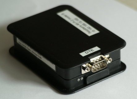

von brha (Gast)
[quote="Joachim"]Ich habe bei mir einen USB-auf-RS232 Adapter von der
Stange am laufen, bei dem alle Pins korrekt angebunden sind.[/quote]
Ja, die Möglichkeit böte mein LPB-Interface mit dem FTDI Platinchen
ebenfalls und ist auch schon dafür verdrahtet (siehe Schaltplan).  Es
kann nur sein, dass ein Raspi für das Interface nicht genügend Strom
liefern kann.
Bei bisherigen Anwendungen des Raspi seriellen Interfaces brauchte ich
selbst bei 115,200 bps weder die DTE- noch die DCE-Seite einzubremsen.
Ein Raspi mit seriellem I/F sieht z.B. so wie im Bild aus; ein MAX3232
SMD-Chip samt SMD-Kondensatoren an den Beinchen klebt ohne Platine
kopfüber innen am Deckel. Ihren Hinweis auf die entsprechende
Mehrfachfunktion der GPIO-Pins habe ich mir jedenfalls abgespeichert,
danke! Damit ließe sich der Raspi am seriellen port dann mit einem
LP-Bus Interface verbinden.

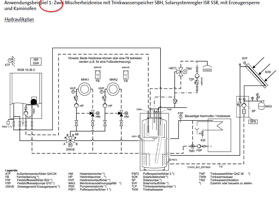

Ahoi brha,
Ich hab mal 20min verschwendet.
Frage:Was ist eine ISR_SSR und wo ist da BSB ?
Task : Google: ISR-SSR
File :Montageanleitung ISR SSR - TheKeSo.de / Seite 8:
Anwendungsbeispiel 1: studiert. Aha
Seite 9:Anschlussplan aha
eventuell eine LMU74xxx und eine RVS65xxx(wohl mit irgendeiner AVSxxx)
PS:Meistens sind hinter den Elektrokomponenten Barcodes mit der genauen
Siemens Typenbeschreibung aufgeklebt.
Zitat brha:
Momentan stehe ich vor einem Rätsel.  Warum sollte ausgerechnet (m)eine
Anlage die einzige sein, die ein anderes Bus-Protokoll fährt als alle
hier bisher vorgestellten Anlagen?  Meine Anlage besteht aus einem
Heizkessel mit seiner eingebauten Steuerung, per Bus verbunden mit einer
ISR-SSR Steuerung, die wohl der master des Ganzen ist und die auch eine
Solaranlage steuert.
Antwort(spekulativ):
Du hast zwei Steuereinheiten, welche mit einer Wärmeanforderung über lpb
gekoppelt sind.
ich gehe jetz raus an die herrliche Frühlingssonne.
von brha (Gast)
Mir kommt ein Verdacht.  Es gibt offensichtlich an ein und derselben
Steuerung zwei Buses: LPB und BSB. Beide sind nur auf Layer 1 identisch.
Der Titel des Forums hat bei mir gedanklich den Schalter auf "LPB"
umgelegt, aber offensichtlich schwenkte die Diskussion und Datenanalyse
dann ausschließlich auf den BSB um.
@Rolf S.
Das "etwas-genauer"-Bild hat die Glocke zum Schalter-Umlegen bei mir
geläutet. Darin sehe ich am SSR Solarsystemregler ISR-SSR-RVS65.583
einen Anschluss für den LP-Bus ganz links oben, der sich bei Montage der
ISR-SSR mit Gehäuse innerhalb des Wandgehäuses befindet.  Auf den habe
ich mich bisher bezogen und habe mein Interface daran angeschlossen.
Was die Fragezeichen in Ihrem Bild angeht: Über die Bustechnologie der
BE (Bedieneinheit) und FB (Fernbedienung) kann ich keine Aussage machen.
Die Klemmenbezeichnungen CL- und CL+ beim Bus FB könnten auf einen Typ
BS-Bus hindeuten.
Die Verbindung zwischen SSR Solarsystemregler und Kesselregler geht über
einen LP-Bus. Es gibt Kesselregler, bei denen ein Busmodul CIB C oder
Busmodul BM zwischengeschaltet ist, sowie z.B. den Kesselregler
ISR-RVS43.122/100, der selbst einen LP-Bus Anschluss hat und kein
Busmodul braucht. Jedenfalls sieht es nicht so aus, als ob die Kessel
über den BSB mit dem Rest der Anlage kommunizieren. Zudem sind alle
Anlagenteile mit dem Service Tool OCI700 über einen der LP-Busanschlüsse
auslesbar und, wo vorgesehen, programmierbar. Auch das waren Gründe,
weshalb ich hier nur "LPB" gedacht habe.
Im dem "etwas-genauer"-Bild sind rechts neben dem LB-Bus-Anschluss
weitere Busanschlüsse, von denen zwei mit "BSB" gekennzeichnet sind. Die
werde ich mir jetzt vornehmen und denke, dass ich dann über dasselbe
rede wie die anderen Schreiber hier. Wenn ja, dann haben Sie mich auf
den richtigen Weg geführt.

Gerhard,
tut mir leid, dass Sie warten mussten, ich bin nur noch selten hier.
Nur zum Mitschneiden der Busaktivitaet braucht man kein OCI700, da
reicht eines der hier im Forum beschriebenen Interfaces wie z.B ich es
==> hier Beitrag "Re: Brötje ISR Plus Kommunikation / LPB" beschrieben
habe.  Einfachere Loesungen haben zum Teil keine galvanische Trennung
zwischen Heizung und Computer, wovon ich dringend abrate.
Ein solches Interface kann man entweder an den LP-Bus oder an den BS-Bus
anschliessen, denn beide Buses haben die gleichen elektrischen
Parameter.  Weder fuer den einen wie fuer den anderen Bus braucht man
die speziellen Steckverbinder von Broetje; fuer den BS-Bus nimmt man
Flachstecker-Verbinder 6.35 mm. Mit dem weiblichen Gegenstueck zu einem
Pfostenverbinder im Rastermass 2.54 mm kann man sich selbst einen
Anschluss an den LP-Bus zusammenloeten.
Bei meiner Entwicklung einer Hard- und Software als BS-/LP-Bus
Zwischengesicht ist ein Programm entstanden, das (a) den Mitschnitt der
BS-Bus Kommunikation analysiert und übersichtlich ausgibt und (b) über
serielle PC-Ports meinem BS-Bus Interface eine real existierende Heizung
vorspiegelt, die auf Anfragen sinnvoll antwortet.  Die
Anfrage-Telegramme und die Antwort-Telegramme, die "von der Heizung
kommen" nimmt das Programm aus einem früher einmal an der Heizung
erstellten Mitschnitt des Bus-Verkehrs. Man kann so ein BS-Bus Interface
am Labortisch in beiden Richtungen austesten.
Die Schreib-Verbindung zum "Bus-Draht" werde ich als Nächstes
herstellen. Es wird einfach ein MOSFET sein, der den Buspegel
entsprechend dem seriellen Bitstrom von einem der seriellen PC-Ports mit
4800 bps moduliert.  So "antworten" die simulierten Heizungsgeräte auf
die GET- oder SET-Kommandos vom BS-/LP-Bus Interface, das die
"Antworten" wiederum empfängt.
Wer es ausprobieren will: die tar-Datei in einem eigenen Verzeichnis
auspacken und
   tar xzf analysis_pz.tgz
   analyzeBus.py D-E.dat
ausführen.
Hinweis: Das Programm ist für Python 2.7 geschrieben und nur unter Linux
getestet.
Die D-E.dat Datei ist von einem Analysator für serielle Verbindungen
namens EZTap Pro (http://www.stratusengineering.com/) erzeugt worden.
Was darin steckt, steht in lesbarer Form in der D-E-ana_dat.txt
Ausgabedatei des Programms. Sie liegt bei, falls jemand nicht Python
installieren will. Zum Mitschneiden braucht man nur einen Bus-Adapter
mit Lesezugriff und natürlich den RS232-Analyser.
UNIT-TEST
Zusätzlich zur Analyse, die den Busverkehr formatiert ausgibt
(festgehalten in der Datei D-E-ana_dat.txt), kann man einen
Unittest-Modus zuschalten. Dann bedient das Programm zwei serielle
PC-Ports und generiert aus der Logdatei Anfrage-Telegramme und die
zugehörigen Antwort-Telegramme. Dafür muss das BS-Bus Interface den
Schreibmodus beherrschen, den man aber zuerst einmal ohne Gefahr für die
Heizung am Schreibtisch mit einem simulierten Bus testen kann.
Das Programm kann im Unittestmodus eine Logdatei namens UT-log.txt (in
der tar-Datei) schreiben, in der die Telegramme nachzulesen sind, die
über das BS-Bus-Interface "mit der Heizung" ausgetauscht wurden.

[quote]Die Platine von freetz war für mich die effizienteste Lösung
(weil
verfügbar und ohne große Kenntnisse realisierbar). Die Schaltungen für
RPi mögen noch leichter realisierbar sein aber für den
Lötkolbenunkundigen nicht beherrschbar. Da müsste es auch mindestens
einen Bausatz dafür geben.[/quote]
Wenn mich mein Gedaechtnis nicht taeuscht, erwartet bsbgateway die Daten
einfach an einem seriellen Computer-Interface. Eine Bus-Interface
Schaltung muesste also fuer Desktopcomputer neben galvanischer Trennung
und Pegelwandlung noch RS232 oder USB sprechen koennen. Das koennte beim
RasPi wie gesagt evtl. entfallen.
Ich hatte mir mein eigenes Businterface gebaut, das ueber RS232 und USB
mit einem Computer verbunden werden kann. Weiter oben ist meine
Schaltung abgebildet, die aber noch kleine Fehler enthaelt und daher
ueberholt ist. Ein Bausatz mit Platine waere dennoch ausschliesslich
fuer Hobbyisten geeignet, die wirklich gut mit dem Loetkolben umgehen
und mit diesem Werkzeug eine Platine mit SMD-Bauteilen bestuecken
koennen.

von Frederik H. (freetz)
So, nach einiger Zeit der Planung und des Bugfixings gibt es nun dank
der Hilfe von Johannes Löhnert eine neue Version der Adapter-Platine.
Diese hat für den Arduino die gleiche Funktion wie vorher, kann aber nun
über eine Buchsenleiste auch an einem Raspberry Pi betrieben werden, und
zwar mit der bsb_gateway Software von Johannes
(https://github.com/loehnertj/bsbgateway). Die Software hat zwar nicht
die umfangreiche Parameter-Anzahl wie BSB_Lan, aber die Grundfunktionen
sind auch dort vorhanden, und wer schon einen Pi bei sich zu Hause
liegen hat, für den ist das vielleicht eine interessante Alternative
(bei mir hat es seltsamerweise beim Pi 3 Aussetzer gegeben, beim Pi 2
lief alles problemlos, aber vielleicht sind die seriellen Pins des Pi 3
bei mir auch nicht ganz in Ordnung).
Man muss sich beim Zusammenbauen allerdings zwischen einer der beiden
Einsatzmöglichkeiten entscheiden, denn der Pi hat als Anschluss ja
Stiftleisten, während der Arduino Buchsenleisten hat. Beide
Anschlussmöglichkeiten gleichzeitig einzubauen, käme sich also in die
Quere. Für einen Wechsel müsste man also die jeweilige andere Variante

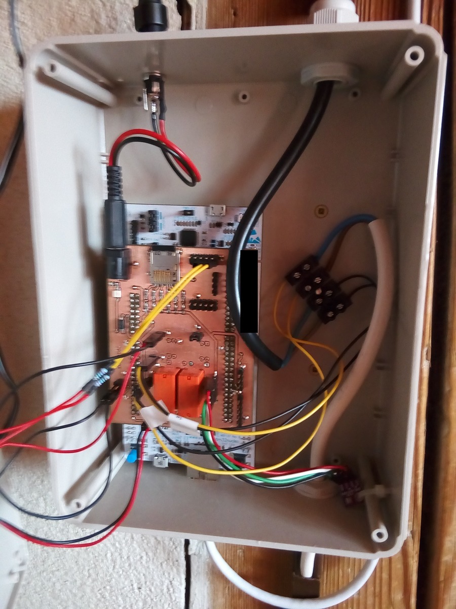

von Simon (Gast)
Ich habe meine alte Heinzung (mit QAA50 alt version) automatisiert.
Ich kann von meiner Wohnung, die Heizung meines zweiten Hauses
einschalten.
Ich benutze einen STM32F7 mit Chibios und MbedTLS.
Es war sehr schwierig, weil der QAA50 gar nicht wie der QAA70
funktioniert.
Ohne diesen Thread hätte ich es nie getan.
Das Schema von "bsb_lan" funktionierte gar nicht mit meiner Heizung.
(Übertragungsrate zu niedrig, Logikpegel abhängig von der Leistung,
falsche Übertragungspolarität, linear-Opto-Isolatoren zu schwach)
Ich benutzte die Idee von "brha": ein 1W 5VDC/5VDC mit isolation.
So könnte ich meine MOSFETs und logik-Opto-Isolatoren polarisieren, auch
when der 12V nicht vom PPS kommt.
Vielen dank,
Simon

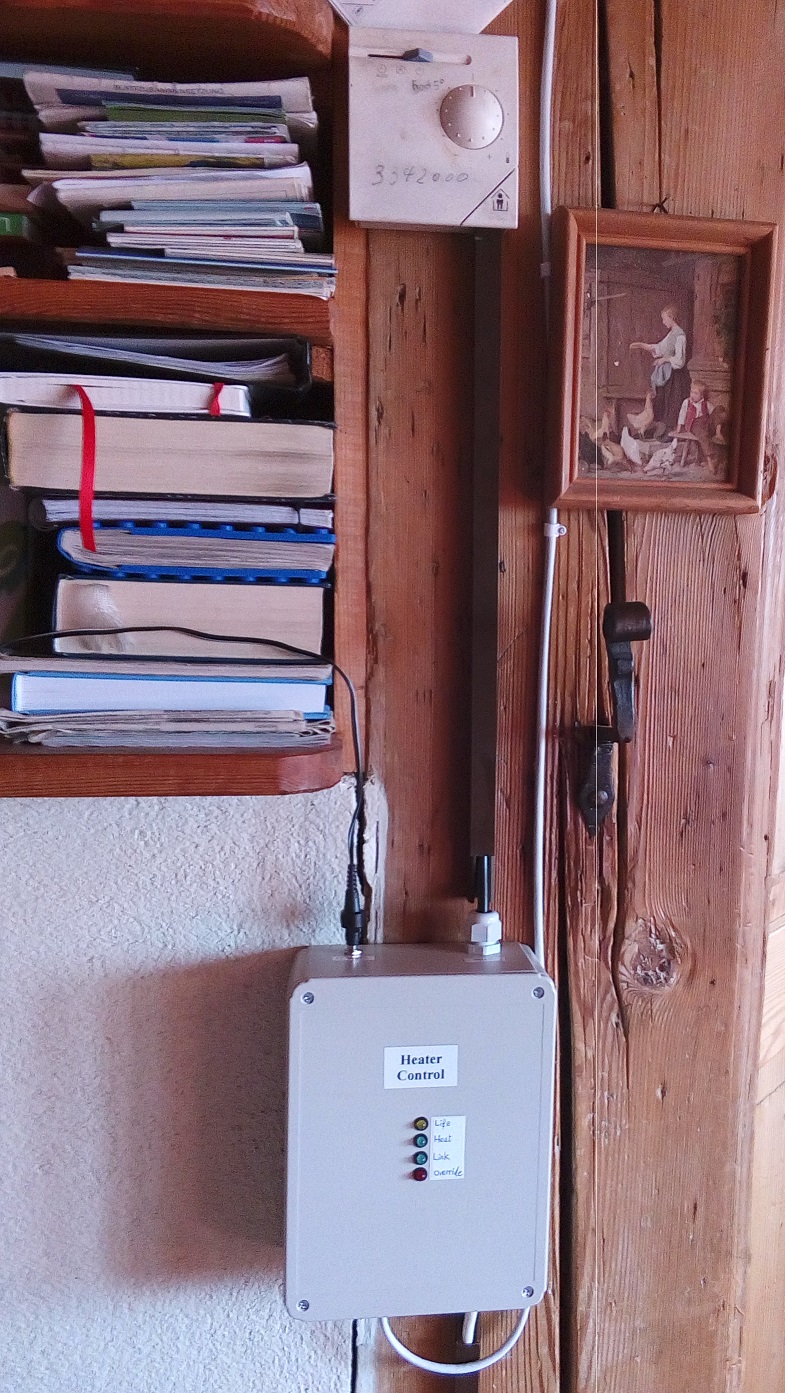

von Simon (Gast)
Hello,
The QAA50 room unit use the 12V PPS bus to communicate with my heater.
As it differs significantly from QAA70, I'll post here my observations:
(Message formatting, CRC etc. is already discussed inside this thread.)
The protocol is serial 4800bit/s, 1startbit, 8databits, 1odd parity bit,
2stopbits.
Heater messages (loop from 1 to 4):
1) 0x1D48FFFFFFFFFFXXCC: ?
always 0x00
2) 0x1D4DFFFFFFFFFFXXCC: Burner
0x0D = burner not active
0x07 = burner active
3) 0x1D4FFFFFFFFFFFXXCC: Room device
0x00 = room device present
0x01 = no room device
4) 0x1D4CFFFFFFFFFFXXCC: Comfort mode
0x00 = economy
0x01 = comfort
QAA50 messages (loop from 1 to 6):
1) 0xFD38FFFFFFFFFFXXCC: Room device type
0x52 = QAA50
2) 0xFD4EFFFFFFFFFFXXCC: ?
always 0x00
3) 0xFD49FFFFFFFFFFXXCC: Heater mode
0x00: automatic
0x01: manual
0x02: standby
4) 0xFD55FFFFFFFFFFXXCC: ?
always 0x03
5) 0xFD18FFFFFFFFXXXXCC: temperature setting potentiometer
min -3°C: 0xFF54 = -172, this is int16_t
middle 0°C: 0x0004 = 4
max +3°C: 0x00BC = 188
6) 0xFD28FFFFFFFFXXXXCC: room temperature * 64
20°C = 0x0500
QAA50 Special messages:
0xFB4CFFFFFFFFFFXXCC: comfort mode set
0x00 = economy
0x01 = comfort
0xFE4CFFFFFFFFFFXXCC: comfort mode validate
always 0xFF
When the heater is started, the bus will come at 12V. Then the heater
will pull the bus to 0V for a short time. When it goes back to 12V, the
heater will search for a room device. The heater will alternatively send
a message 0x1D.... and a request 0x17 with about 0.5s beetween the two.
The room device must send its message about 1ms after the 0x17 from the
heater.
When the room device is not paired with the heater, it must start by
sending 0xFD38... after the 0x17 that follows a 0x1D48... It is the only
way to pair the room device to my heater. (My heater displays override
when the room device is paired) After this, the room device can answer
to 0x17 with messages from its loop.
To toggle the comfort mode of the heater, the room device must answer
0xFB4C... to a 0x17. the heater will send 0x17 again, the room device
must send 0xFE4C... The heater will then send it's updated setting
0x1D4C...
I used two relays so the the room device is normally connected. I can
remotely switch the room device away, and switch my MCU on the PPS bus.
I wait until my heater pull the bus low for a short time and start
searching for a room device. Once it is done, my MCU start acting like
it is the room device (using BME280 temperature sensor). It is a very
easy way to remotely control the heater.
Best regards,
Simon
