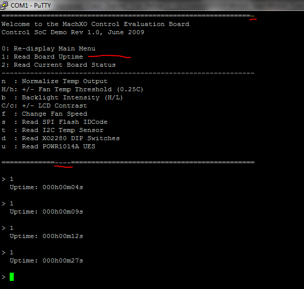

MachXO Control Developer Kit mit REFDESIGNS als Source Code
NV FPGA Derivat : Lattice MachXO LCMXO2280C
control_SoC_demo.ldf --> Lattice Diamond Design-File
C:\B_CPLD2\Demo_MachXO_Control_SoC\source\imp
Der uptime_wb.v Verilog Code habe ich via Project Manager gemoddet.
*.syn import to Lattice Diamond V3.1.487 Project. -->>
C:\B_CPLD2\Demo_MachXO_Control_SoC\project\control_SoC_demo.ldf
2* uptime_wb.v ???
C:\B_CPLD2\Demo_MachXO_Control_SoC\source\uptime_wb.v
C:\B_CPLD2\Demo_MachXO_Control_SoC\project\impl1\source\uptime_wb.v
C:\B_CPLD2\Demo_MachXO_Control_SoC\project\prom_init.hex
Path impl1
 /* Fu-Knoten : A4-Definition*/
  always@(posedge sec_clock or posedge rst_i) begin
    if (rst_i)
  begin /* Clear */
      hours  <= 0; /*Zero-HH:MM:SS $08_Bit_Spur*/
      minutes <= 0;
      seconds <= 0;
    end
    else begin
      if (seconds[7:0] < 59) begin //
        seconds <= seconds + 1;
      end
      else begin
        minutes <= minutes + (1); // INC_Minutes
        seconds <= 0;
        if (minutes > 58) begin // 59??
          minutes <= 0;
          hours <= hours + 1;
        end
      end
    end
  end
endmodule
/* ENDE */
Das Menue geht und ist Command Interface via WishBone Bus @Interface
   Prozessanschluss#$(00)  <-->UART V24 --(Terminal)--USER-PC

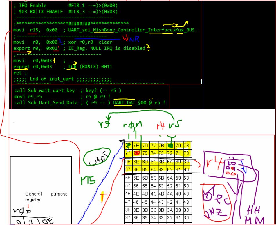

Register Rules r0---
;Sub_1 UART-I/O-WishBone Bus
.equ UART,           0x00 ; @!Base_Adress$(00)
.equ ADC,            0x10 ;
.equ SPI,            0xA0 ; 1010 0000 0000 0000 [0000 0000] - 1010 1111
; 1111 1111 [1111 1111] (0xA00000-0xAFFFFF)
.equ TIMER,          0xB0 ;
;!@UART REGISTERS
.equ REG_UART_DATA,  0x00 ; NULL
.equ REG_UART_IER,   0x01
.equ REG_UART_LCR,   0x03
.equ REG_UART_LSR,   0x05
;**Code Sniplet to do Mico8 WishBone  u. Lattice Asm Syntax lernen
Hint: Read  import r5 ; via Reg$05
            export
; UART,           0x00
get_char:
  movi r15,UART
  import r5, REG_UART_DATA ; Read from UART
  cmpi r5, 'm'
  bz init_menu
  cmpi r5, 't'
  callz read_uptime

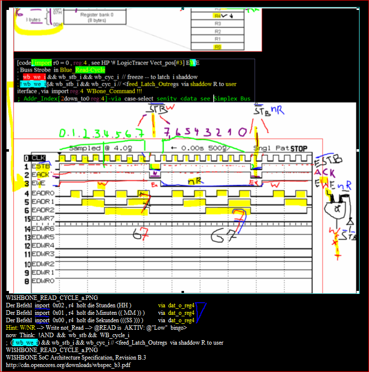

MachX0  Control Develop Kit
Later i will use the new MachX02 with [{preengeneerd}] Embed. Stuff
Fast State 10 case State Engine @2 clk Stoke --1Step....
@Lattice Semiconductor Corporation.
Build Digital@+Analog FPGA inside ispPAC 30
Hint: Look in the owm Diamond IDE
 C:\lscc\LatticeMicoSystem\2.0\micosystem\components\gpio\drivers
Hint:
http://www.latticesemi.com/documents/MachXO%20PLDs%20in%20System%20Control%20Designs.pdf
Hint: compile & run your own stuff Projects
http://www.latticesemi.com/documents/LatticeMico8Tutorial.pdf
rem prom_init.hex" , "menue.hex"
rem prom_init.v
"menue.hex" habe ich mit hex patch gemoddet. siehe Bild
kommt aus ( EBR)? EmbededBlockRam via UART Print Routine.
bingo>
Das ist *.jed File (mit Bin..Stuff Fuse-Map drin. )

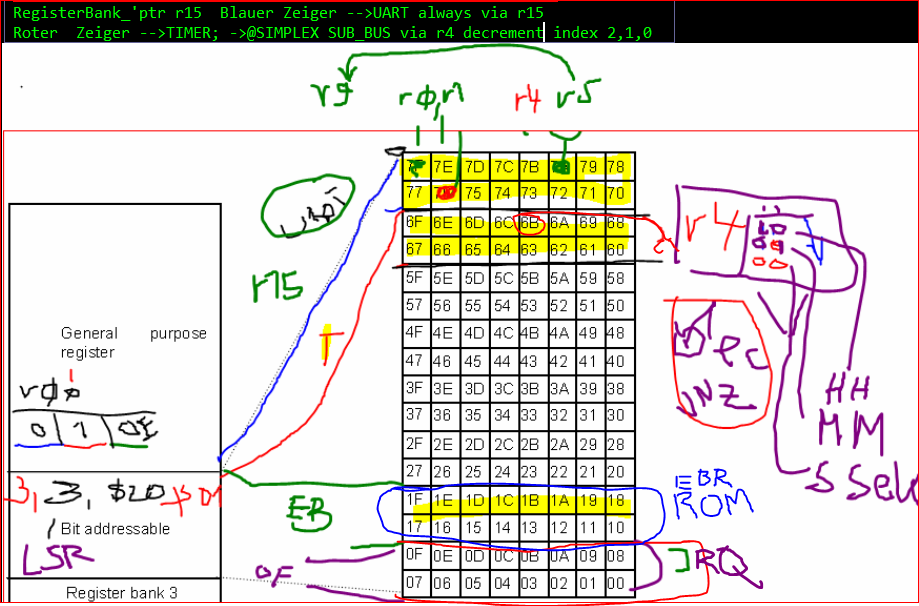

Hint:
0x2C005 is Opcode seti
Thema(1)
Hint:
Da oben in co.asm ist der ProzessAnschluss# nich wie bei mir.
Den co.asm muss ich also auch noch auf mein spezi. WishBone Modell
modden.
-------ACK:STACK_STUKTUR:-----------------------------------------------
assign wb_ack = {
                   1'b0,              // Device #15 (UNUSED)
                   ebr_ack,           // Device #14 ACK (EBR)?
EmbededBlockRam
                   1'b0,              // Device #13 (UNUSED)
                   sram_ack,          // Device #12 ACK (SRAM)
                   1'b0,              // Device #11 (UNUSED)
                   spi_ack,           // Device #10 ACK (SPI)
                   1'b0,              // Device #9 (UNUSED)
                   lcd_ack,           // Device #8 ACK (LCD)
                   1'b0,              // Device #7 (UNUSED)
                   fan_ack,           // Device #6 ACK (fan)
                   1'b0,              // Device #5 (UNUSED)
                   led_sw_ack,        // Device #4 ACK (LED/Switches)
                   i2c2_ack,          // Device #3 ACK (PM I2C)
                   i2c_ack,           // Device #2 ACK (I2C)
                   timer_ack,         // Device #1 (TIMER)
           /*FU''#01*/
                   uart_ack           // Device #0 ACK (UART)
           /*ProzessAnschluss_nummer FU-UART-AT'BASE_00*/
UART ProzessAnschluss# ist nicht 0 sondern
Der Lattice MachXO WishBoneBus ist so einfach wie telefonieren.
also File co.asm analysieren.
Fazit:
Prozess: Register Rules. and Procedure Steps
Reg R15 auf Uart_0 also erst mal in meinem "Daten_Modell"  Null
eintragen
  // movi   r15, TIMER_1
  // export r0, 0x00  ;; issue a 'write' to latch the current time value
  // import r4, 0x02  ;; wahl case hour byte of latched time value
  // .... call wait_for_uart_txrdy
   via r4 import kommt der StundenWert der als Addr_select 0x02 hat
raus.
   >bigo
   nun noch das spezielle r4 Register als Param_werte auf ascii_BCD
modden
   und an den UART mit respective des Timings(wait_for_uart_txrdy) ect.
rausgeben.
   >Bingo.

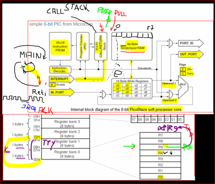

Gast #2929824
Holger erster IRQ PseudoCode mit Eckdaten
## ResetMode> Mico8 PC =00000
org 00 ## store prog_conter absolut  jmp start_m
b startup_1 # jump ZILOG EZ8 ENCORE ???
org 02 ## vector irq trap
int_handler:
nop
nop
nop
nop
reti ## return from 'IRQ_?
org 38 # like the ZILOG EZ8 ENCORE
startup_1: # Label_1
 seti # first set the program to be able to receive interrupt
      # and push
nop
nop
  if (irq_flg) ??
  clear irq_flg ;

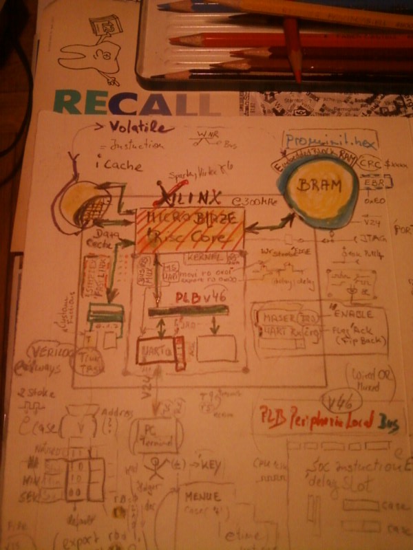

Persönliche Seite #2933253
Das ist was gutes für den FPGA CPU (Synthesized). USER
Hint:
"Build from sratch via Bus Manager"
http://www.origin.xilinx.com/csi/training/embedded-design-with-the-xilinx-embedded-developer-kit.htm
So ist das im Xilinx MicroBlaze abgeleitet.
[code]

; HOLGER think FIXED ADDRES MAPPING UART 0x00,TIMER 0x10 .SPI. EBR
;;;;;;;; *** Utility Functions *** ;;;;;;;;;;;
; The "IoReadWord" and "IoWriteWord" are
; used to read/write the IO Bus.
; "XIOModule_DiscreteRead" and "XIOModule_DiscreteWrite"
; used in SIMPLEX FAST LINK  as a local_Bus to the USER
; Custom Verilog_Sub_Modules as eg: uptime_wb.v defined

read_uptime:
  movi r15, TIMER  ; PLB (v46) select (trigger--export r0,0x00)
  export r0, 0x00  ;; issue a 'read_$00' to latch the current time value
  import r4, 0x02  ;;; hour byte of latched time value
 call send_uart_data
  movi r15, TIMER   ;  PLB (v46) select ()
  import r4, 0x01  ;;; minute byte of time of latched time value
  call int2asc10   ; takes r4 and converts to BCD in r8,r7,r6
  mov r9, r7
  call send_uart_data
  mov r9, r6
  call send_uart_data
  movi r9, 'm'
  call send_uart_data
  import r4, 0x00  ;;; seconds byte of time of latched time value
  mov r9, r7
  call send_uart_data
  mov r9, r6
  call send_uart_data
  movi r9, 's'
  call send_uart_data
  setz ; ????? SettZero what is that
  ret  ; Return from Subroutine
;************{ENDE UPTIME_PROC:(01)]***************************
[\code]
; idcode now in r4
; import as a Fetch and export as a Store, move r0 as a WNR
; Voacabulay: FORTH  Language Parameter Stack
r15********************r4,***,r0
; First store a UART_TTY_0 in reg#15
Gast #2934075
......r0 bleibt auf 0, somit ist lesen aktiv LOW ! via Reg: r0
  import r4, 0x00  ;;; Sekunde byte of time of latched time value
Fazit in Reg: "r4" steht die Address z.B (0x02,0x01,0x00)
 mit dem Befehl "import r4, 00" ist die Sekunde in Register r4 drin.
 Bingo>.
 Danach kann der Inhalt von r4 als 8Bit Wert convertiert zu BCD Routine.
 Danach kommt der Sekunden.Wert an der UART-Schnittstelle raus.
Bingo>.

; asm: export import Rules
;  Register Rules r5,r9
;                            r0,r4
; Register r9 ist das MachxO_Tx >Register, via PIN# (F6) uart_tx
;          r5 ist das MachxO_Rx <|Register via PIN# (F5) uart_rx
22
; #### LOCATE COMP "uart_rx" SITE "F5" ; #pull up 10K.
23
; #### LOCATE COMP "uart_tx" SITE "F6" ;
24
25
;    UART Base ist 0x00000 via Mapping Build Order as Fixed Address.
26
;    LSR UART_Base +5 >LSR 0x0005
27
;    (0x01) Maske Mach_RX 'bit_0 indicates "low" = Zeichen empf.
28
;    (0x20) Maske Mach_Tx 'bit_5 "high" = Zeichen tx_pendig go&wait
29

;############[ init_uart ]#########################
62
init_uart:
63
; IRQ Enable        #EIR_1 --=)>(0x00)
64
; $03 RX|TX ENABLE  #LCR_3 --=)>(0x03)
65
66
67
movi  r15,  0x00  ; UART_sel_WishBone_Controller_Interface>Mux_BUS.
68
69
movi   r0,  0x00  ; xor r0,r0  clear
70
export r0,  0x01  ; IE_Reg. NULL IRQ is disabled
71
72
movi   r0,0x03    ;
73
export r0,0x03    ; LCR (RX&TX) 0011
74
ret ;
75
;;;;; End of init_uart ;;;;;;;;;;;;;
76
;############[ uart_rx_ready ]#########################

;############[ Sub_Uart_Send_Data  ]################
107
; movi r9, 0x41 -- A
108
Sub_Uart_Send_Data:
109
call wait_for_uart_tx_ready ;
110
export r9,0x00 ; r9@ Reg:UART_DATA ! | .machxO_tty.'emit ascii
111
ret ;
112
;;;;; Sub_Uart_Send_Data   ;;;;;;;;;;;;;

; [<INIT STUFF>]####################################
116
Main_Loop_1:
117
118
call init_uart  ; IRQ, EN_TX&RX -->MCU
119
120
121
main_poll_1:  ;  RUN-APP_1 ">>>Launch"
122
123
;########[Echo_Server_&Subs.]#####
124
125
; call delay              ;
126
call Sub_wait_uart_key  ; key? (-- r5 )
127
movi r9,r5              ; r5 @ r9 !
128
call Sub_Uart_Send_Data ; ( r9 -- ) UART_DAT_§00 @ r5 !
129
; call delay         ;
130
131
b main_poll_1     ; ## go back to  main_poll_1

Persönliche Seite #2938661
To do:
Einstellen via Parameter: Ueber internal scratch Pad RAM,
 Call Stack Size .
 or nasty nested Calls via Return Adress ......Stack ...
Zitat:
I do remember the call/return capability was very useful as well as the
internal scratch RAM. Debug could sometimes be a PITA due to having no
internal visibility and being stuck with decoding adrs/data ports. They
simulated well, too.
Docu.
http://link.brightcove.com/services/player/bcpid1384165827001?bckey=AQ~~,AAAABAHLGok~,a3rQal6KQNvidwRyNdKEnQiIAYU82O5J&bctid=1826273843001
Hint: Für SOC Design
http://www.programmableplanet.com/author.asp?section_id=2030&doc_id=244784
Persönliche Seite #2938696
WISHBONE_READ_CYCLE
Der Befehl  inport  0x02 , r4  holt die Stunden (HH )
via  dat_o_reg4
Der Befehl  inport  0x01 , r4  holt die Minuten (( MM )) )
        via  dat_o_reg4
Der Befehl  inport  0x00 , r4  holt die Sekunden (((SS ))) )
via  dat_o_reg4
Hint: W/NR --> Write not_Read --> @READ is  AKTIV: @"Low"  bingo>
now  Think:  !AND  &&  wb_stb &&  WB_cycle_i
;  (! wb_we_i) && wb_stb_i && wb_cyc_i // <feed_Latch_Outregs  via
shaddow R to user
WISHBONE SoC Architecture Specification, Revision B.3
http://cdn.opencores.org/downloads/wbspec_b3.pdf
