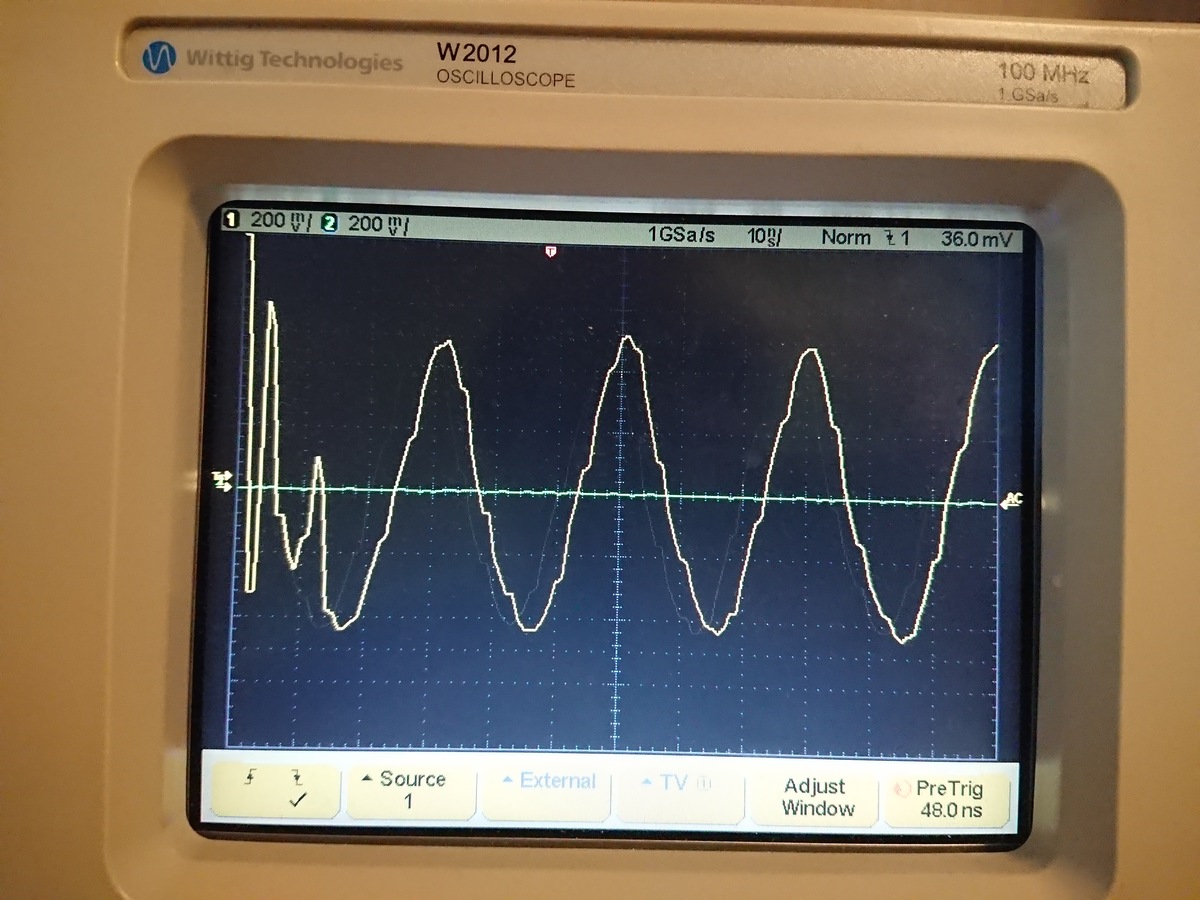

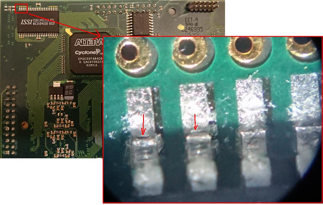

Recently I've got two defective oscilloscopes Wittig W2012 (without
letter "A"). First of all I fixed two cold solder on RAM (interesting
that both osci had exactly the same problem chip and the same problem
pins). What I performed after:
- wrote FW to ESCP16 for HW version 2022A
- added letter "A" to label 2012 (guess that I performed it in a right
way, because I did not find clear instructions how to do it)
- performed LB-mod
- performed Ext-trig-mod
- performed LED-mod
- wrote FW 1.2.BF.7.15
- virtually thanked to the people who worked at the forum before (now I
can just in one click get a lot of information and SW)

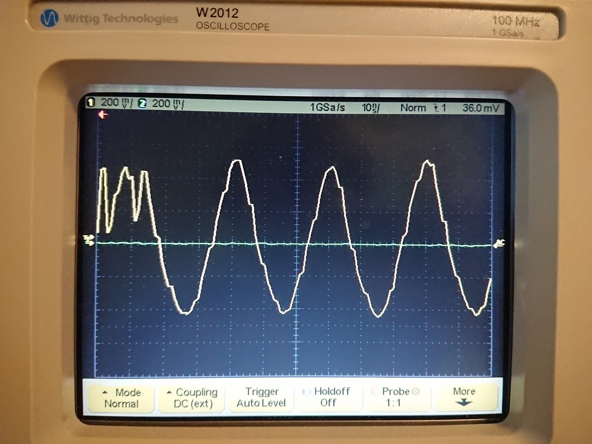

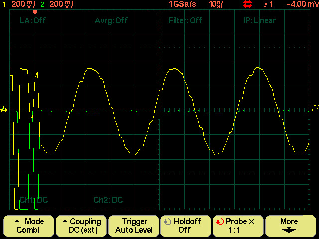

What I have now. Two good oscilloscopes with admissible noise level,
operating external trigger and good FW. I performed a lot of test
procedures and what I figured out. Practically oscilloscopes operate
normally up to 5-10 MHz. If I apply signal with higher frequency I watch
some interference. Independently of time base and time offset
interference is approx 15-20 ns duration. Thе higher the frequency  the
more often appeares interference. For example with 5 MHz signal
interference appeares approx one time per 2-3 seconds. With 30 MHz
signal interference appeares approx 2-3 times per seconds. And so on.

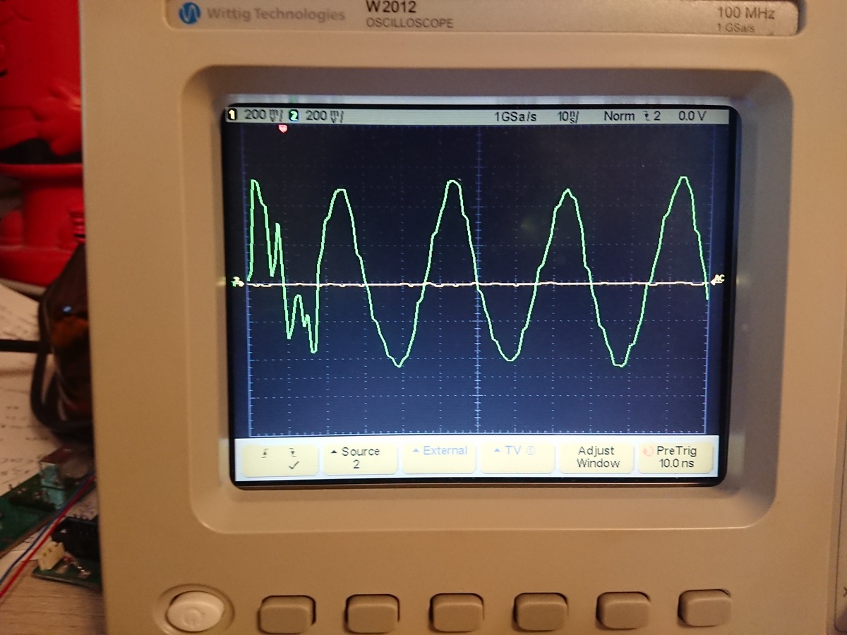

Interference appeares on both channels simulteneously and has approx the
same shape on both channels. Interference did not (!) appeares in Free
Run mode or Ext Trig. Interference appears when synchro mode are channel
1,  channel 2, auto or combi.
What is interesting. I whatched signal at ADC (MAX1121) input with
another oscilloscope. There were no any interferences! But on the screen
they are present. And one more. Both channels have the same problem. And
both oscilloscopes have the same problem.
For me quite difficult to understand the problem because I don't know
was it before repairing and modifications or not.
Questions to experts. What is the principle of synchronization from
signal itself (I mean from channel 1 or 2)? Where I can find diagram for
internal synchronization (at the forum I found diagram just only for
external synchronization)?
Best regards
Slava

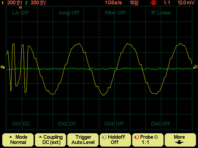

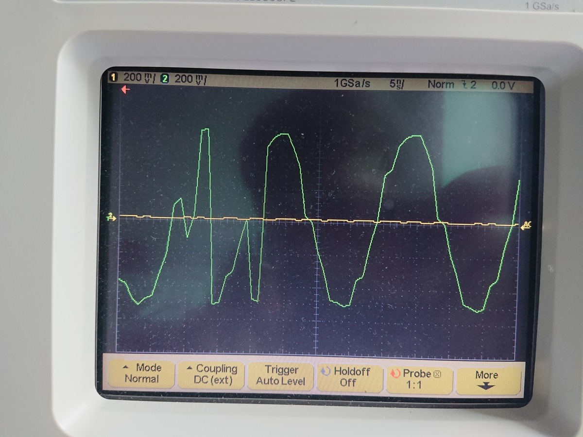

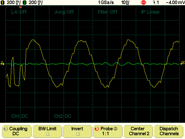

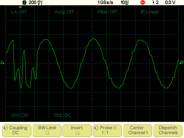

#6257573
Hi Slava - congratulation - well done!
Which hardware version did you choose for your upgrade? The 8C7.x.x
seems to be the better one. Just for information and help, which RAM
(the inner one  or the RAM near the display connector) and which pins
exactly were the problem pins?

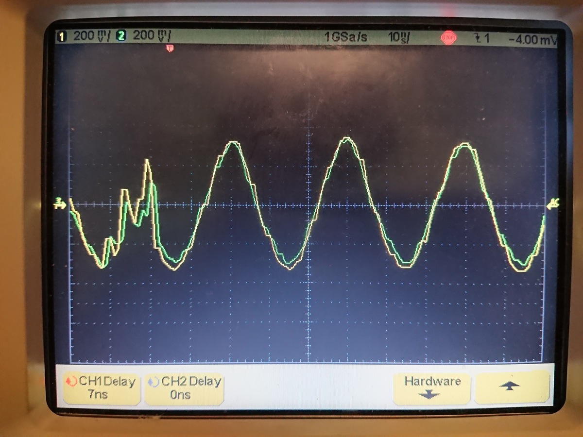

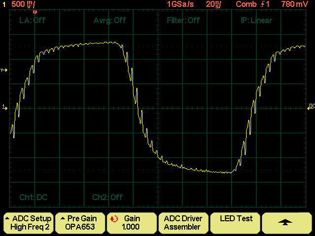

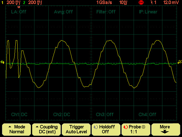

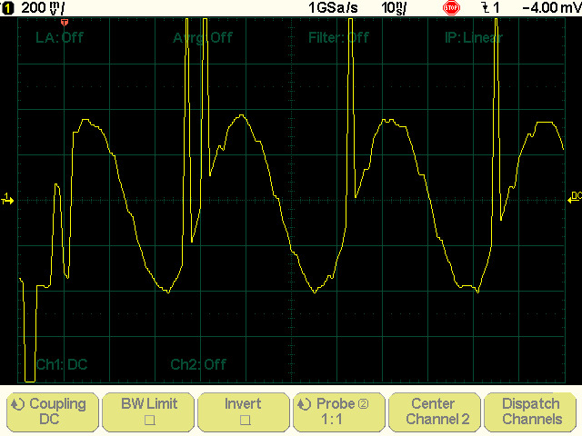

The distortion at Signal beginning is a result of bad trigger
implementation in the FPGA. As you can see on the screenshots it occurs
on my devices also. Here for comparison:
- 8C7.0.J -> the unmodified W2022A
- 8C7.0.G -> OPA653 Mod (W2022A)
- 8C7.0.L -> LB Mod (W2024A)
It is all the same - with one difference: The unmodified 8C7.0.J is
bothered with mighty spikes during the warm up time. After warming up
they disappear.
Kind regards
Hayo

Hello Hayo,
Concerning RAM problem. There were two cold soldered pins (pin 43 A16
and pin 44 A17) on the inner chip (see photo). They are corner pins. I
think this is common technological problem of soldering or overheating
point. Unfortunatelly or not, but I found information about RAM problem
at the forum after fixing the problem. I did a lot of experiments to
figured out what is with RAM and what are the pins exactly broken. Even
wrote software for Windows to analyze RAM through GERMS-monitor. If it
is needed for somebody I can share it in someway. However now I
understand that much simplier way just solder all the pins than analyze
RAM pattern to define exact pins :).
That's good to know for quick testing. The problem with cold soldered
pins of the RAM is well known here. Often the effect are stripes on the
screen - that is because the display output is mapped to a RAM area.
> Even wrote software for Windows to analyze RAM through GERMS-monitor. If
> it is needed for somebody I can share it in someway. However now I
> analyze RAM pattern to define exact pins :).
Indeed it is simplier to solder all pins - but that seems to be a cool
tool for analysing the correct function of the RAM. If you send it to me
with a short description how it works I will upload it in our W2000A
section on Source Forge. I'm sure it will be of good use for someone who
has problems with his device because you can analyze without
disassembling it.

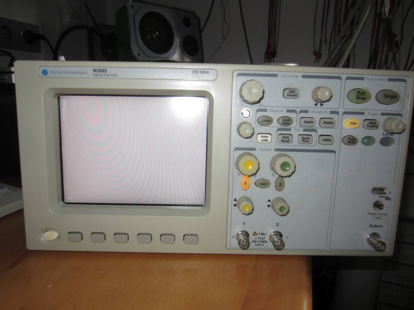

#6473475
Little hint for the display: In the case your screen displays funny
things which shouldn't be displayed normally there may be a contact
problem with the display plug from the display to the PCB (can be seen
with opened DSO).

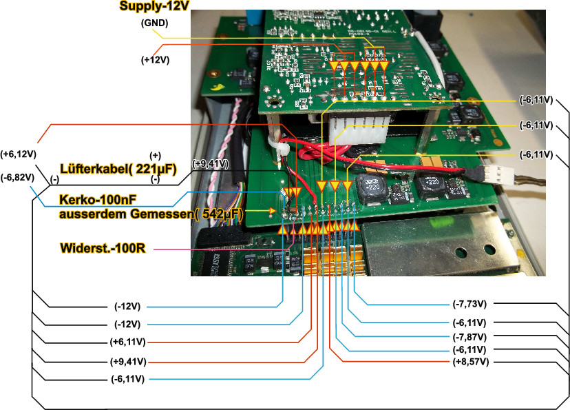

Ich habe die Spannungen auf den Bild im
sourceforge.net/projects/welecw2000a/files/Hardware/Original/Voltage_Sup
ply_001.png  einmal mit meinen verglichen und bei mir habe ich völlig
andere Spannungen gemessen. Meine zwischen 1,2....5V
Sind die Spannungen gegen Masse gemessen?
Wird die Masse wirklich nur über das Chassis verbunden?
Jürgen

Seit heute geht es leider nicht mehr. Nach dem Einschalten ist nur noch
ein schwarzer Bildschirm zu sehen und "Run" leuchtet. Auch das Drücken
der äußeren Tasten um in den GERMS zu kommen, klappt nicht.

Ich habe mitterweile rausbekommen, daß beim Drücken der beiden linken
Tasten das Oszi in den GERMS geht. Beim Verlassen des Modus sind dann
mehrere LEDs (zufällig) aktiv, aber der Bildschirm bleibt schwarz. Ich
werde mal den RAM nachlöten. Auf den ersten Blick ließ sich aber nichts
erkennen.
Ich denke mittlerweile auch, daß es mit dem RAM zu tun hat.
Gruß, Yutie

Hallo hab Yutie's Oszi bekommen,
wie schon erwähnt keine Anzeige.
Habe Rams und Eproms nachgelötet ohne Verbesserung.
Der Ramtest zeigt sofort Fehler, alle LED's leuchten nach upload.
Habe gelesen, dass der Ramtest über die serielle Schnittstelle
Statusmeldungen ausgibt eventuell erfahre ich da näheres.
GERMS scheint zu klappen und das Flashen über Jtac auch sonst käme ja
beim upload vom Ramtest ein Fehler.
Jürgen

ich habe die Spannungen geprüft alle OK das Bild im SF ist verwirrend
habe mal ein neues gemacht mit den Spannungen gegen GND und den dazu
gehörigen Spannungsbereiche der Bauteile.
Flashen konnte aber nur mit der W2022A.jic Datei. Keine Änderung.

#7003188
Na das nenne ich mal wieder gute Arbeit!
Aber eigentlich ist die Ursache nicht überraschend - das RAM ist schief
aufgelötet und hat an einigen Füßen nur minimale Auflagefläche, die ADC
werden sehr warm, was durch thermische Ausdehnung zu einer mechanischen
Belastung der Löt-Pads führt. Deshalb hatten ja auch einige (ich auch)
die ADC mit Kühlkörpern versehen. Das reduziert den Effekt schon um
Einiges.
Nachteil - wenn man die Kühlkörper aufklebt, kommt man an die Pins nicht
mehr ran. Aber irgendwas ist ja immer...
Gruß Hayo

Hallo nochmals!
Mittlerweile habe ich dem Oszi mal einen größeren und leiseren Lüfter
eingebaut. Dafür musste ich das Gehäuse ein wenig bearbeiten.
In den letzten Tagen beim Aufbau eines LC-Schwingkreises mit rund 20 MHz
ist mir aufgefallen, daß das Oszi ab einer bestimmten Frequenz das
Signal mit einer Art "Überlagerung" anzeigt. Deutlich wird das ab etwa 5
MHz. Davon sind beide Kanäle betroffen.
Entdeckt hatte ich das beim Ausmessen eines 10 MHz Quarzofens. Sie
werden aber offenbar nicht mit steigender Frequenz mehr, sondern bleiben
einfach da.
Mit einem der Noise-Filter lässt sich das Problem verringern, aber nicht
ausschalten. Wärmeeinwirkung kann ich ausschließen. Der 80mm-Lüfter
erzeugt einen ordentlichen Luftstrom im Gehäuse.
Die beiden Schirmbleche sind natürlich wieder eingebaut.
Bis auf diese kleine Störung funktioniert das Oszi wieder klaglos.
Gruß,
Yutie
#7083727

Ich brauch einmal wieder deine Einschätzung.
Hab mein Welec hier im Forum verkauft.
Bei mir war alles ok.
Beim Käufer angekommen zeigte es ein weißes Display.
Die Anzeige der LEDs scheint ok.
Sieht meiner Meinung nach einen abgegangenen Display Stecker aus.
Jürgen

Gast #7086834
Hallo nochmals.
Im Anhang mal ein echter Screenshot des Fehlers. :-)
Die Frequenz beträgt 10 MHz aus einem Quarzofen. Bei einem
LC-Sinusoszillator tritt das Problem auch auf. Es macht sich als "Kamm"
bemerkbar. Bei kleineren Frequenzen ist der Fehler nicht sichtbar oder
nicht vorhanden.
Ein Abschlusswiderstand bewirkt keine Besserung. Auch ein anderer
Tastkopf bringt nichts. Die Störung kommt also nicht durch eine externe
Störstrahlung, sondern ist intern.
Beide Kanäle sind betroffen. Die Abschirmbleche sind natürlich wieder
angelötet. Mit dem Noise-Filter lässt sich das gut rausrechnen.
Gruß und frohe Pfingsten,
Yutie
#7086902
Hallo Yutie,
das interessiert mich auch. Hab ja dein Oszi in den Fingern gehabt.
Bei meinen Testmöglichkeiten ist bei 5Mhz Ende Fahnenstange.
Wenn es bei beiden Kanälen auftritt schließe ich eine kalte Lötstelle an
den ADCs aus. Oder es ist ein synchroner Fehler an den ADCs beider
Kanäle.
Tritt es erst bei 20ns auf oder schon bei 50ns oder höher.
Habe beide Kanäle das gleiche Bild?
Jürgen

#7086916
@Yutie
Ja das Problem ist bekannt. Hier handelt es sich um eine Vertauschung
der Bits. Heißt, die ADC werden nicht in der richtigen Reihenfolge
ausgelesen bzw. die Bits nach dem Auslesen vertauscht. Daher ist das
auch nur an den Flanken so stark sichtbar und an den konstanten Stellen
nicht. Das tritt natürlich auch bei 50ns auf, da alles darüber ja nur
interpoliert ist und ebenfalls die 50ns Abtastung verwendet.
Wenn ich das richtig in Erinnerung habe, hängt das zusammen mit der
FPGA-Version und den gewählten Hardwareeinstellungen. Bei meiner 8C7
Version kann man das - glaube ich - durch Umschalten zwischen "Factory",
High Freq 1 und High Freq 2 beeinflussen. Leider kann ich das momentan
nicht prüfen, da ich gerade an Bord bin und kein Gerät hier habe. Wenn
ich morgen wieder zu hause bin probiere ich das mal aus - kannst Du aber
natürlich auch selbst bei Deinem Gerät machen.
Gruß Hayo

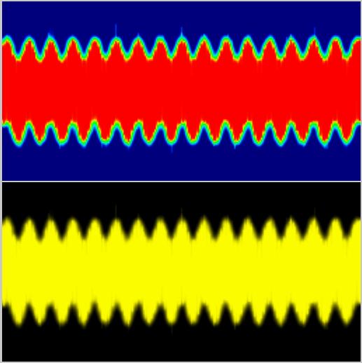

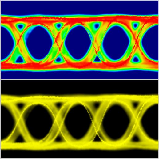

Gast #7087547
Blue F. schrieb:
> Ja wie cool ist das denn? Kannst Du da noch etwas mehr Infos zu
> rausrücken?
(ersmal sorry, dass ich mit eigenen Projekten hier
reinrausche, aber wenn so mancher Troll nur Blödsinn
schreibt.. Ob das Welec jetzt neu oder alt ist,
spielt doch überhaupt keine Rolle, Messungen mit
einem neueren und teureren DSO würde auch keine
"besseren" Daten liefern.)
Mein Design bassiert auf einem einfachen Nachahmen
von Phosphor durch ein Array.
Der einfachste Ansatz ist, die Daten in Form von Punkten
in das Array zu schreiben und evtl. ältere Punkte langsam
ausdimmen zu lassen.
Mein Ansatz geht viel weiter, statt Punkten werden ganze
Linien (nicht ganz so einfach) gezeichnet und parallel
dazu das gesammte Array abgedimmt (bel. steuerbar). Dann
noch entsprechende Filter für versch. Zeitskalen, um nach
Möglichkeit Artefakte zu vermeiden.
Kling erstmal recht einfach, wenn man aber mal die Anzahl
Rechenoperationen hochrechnet, dann kommt man schnell in
den Bereich von Teraops, d.h. für eine CPU, insbes.
NiosII-Derivate, nicht darstellbar. Kleines Beispiel:
alleine die R/W-Ops für die ADC-Array-Stufe bewegen sich
im Bereich 100-150 Gigabyte/sec. Je nach Zählweise bewegt
sich mein Design von 0.5 bis 1.0 Teraops.
Damit erhält man dann so etwa 1 Million Waveforms/sec (bei
etwa 200 Punkten je Waveform, neuere DSOs haben vlt. 10x
so viele Messpunkte!) und sogut wie keine "Auszeit" zur
Anzeige der Bilder, die per simpler GPU parallel berechnet
wird. Dann noch Color-LUT, Panel-Steuerung und IO wie z.B.
UART, und man hat ein erstes einfaches Design.
Nachteil meiner Vorgehensweise ist aber, dass alle Daten
im Phosphor-Array abgespeichert werden und bei jeder Änderung
der Zeitskala (und evtl. Werteskala) gelöscht und neu angesammelt
werden müssen. Alte Messungen gehen also mit Änderungen
der Panel-Einstellung verloren. Bei alten Oszis ist das aber
auch so.
Das ganze habe ich auch als UV- und FT-Plot (inkl. Waterfall-Modus),
mehr als ein Modus gleichzeitig in einem Design ist aber leider als
Platzgründen nicht möglich.
"Cool" sind aber nicht die statischen Bilder, sondern der Verlauf
in Echtzeit auf dem Welec. Z.B. eine Videokamera angeschlossen,
lässt sich das Videobild auf den Bildschirm erahnen, es wird in
Echtzeit 1:1 angezeigt. Und auch die Augendiagramme sehen echt
geil aus, zumind. beim ersten mal.
Zu den 3 Bildern: das erste ist aus einer echten Messung
(Digitalschaltung mit zufälligen 0/1-Wechseln), das Array
wurde dann per UART an den PC geschickt und dort als Graphik
abgespeichter. Die beiden Anderen stammen aus einer SW-Sim.,
die zum einen seltene Ereignisse simuliert, zum anderen die
Zeitskala verstellt (niederfreq. Sinus plus hochfreq. Sinus,
daher der "breite" Verlauf). Dazu hat mir zu der Zeit leider
ein passender Waveform-Generator gefehlt (die beiden letzten
Bilder sind also sozusagen gefakt, aber mit einem passenden
Generator genauso darstellbar).
geschummelt.
Zum NiosII-Design: mehr oder weniger alle Komponenten (UART,
Panel, VGA etc.) sind per AVALON an die CPU angebunden, die
CPU ist nur noch dirigirend tätig, die manuelle Auswertung
z.B. des Panels per SW entfällt. Als Beispiel habe ich mal
ein Panel-Design angehängt. In "compilation" ist das SOF-File
als auch die Pin-Beschreibung (bitte lesen!!), if "NiosIISystem"
die Software. Einfach "startshell" aufrufen (Achtung: läuft nur
unter 11.0, im Skript bitte das Verzeichnis in Zeile 16 anpassen),
dann per "./loadhw.sh" das SOF-File und per "./loadsw.sh" die
Software runterladen. Per "./buildsw.sh" lässt sich die Software
neu compilieren (nicht die Hardware!), an der Software kann man
sich ja mal austoben, viel Spass dabei.
Im Moment fehlt mir aber leider die Zeit, um weiter am
Design zu arbeiten, mein Haus muss renoviert werden. Ich
komme aber in den nächsten Jahren wieder dazu.

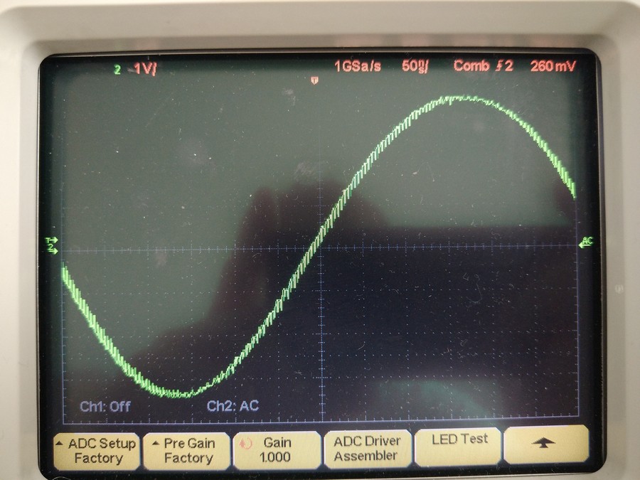

#7088735
Hallo Yutie,
wie schon vermutet ist es die Einstellung im ADC-Setup: Du hast wohl
bei Dir die Einstellung High Freq2 gewählt. Die ist aber nur für einige
Sonderfälle zu empfehlen, wenn man bei sehr hohen Frequenzen mit den
anderen Einstellungen keinen Trigger hinkriegt. Für sonstige Messungen
lieber Factory oder High Freq1 nutzen (siehe Screenshots). Bei Dir ist
der Effekt noch ausgeprägter, weil Deine Frequenz höher und die Flanken
steiler sind. Bei mir sind es nur 5MHz, hatte jetzt keine Lust den
Rechteckgenerator aus dem Regal zu ziehen (zu staubig).
Probier's mal aus...
Gruß Hayo

Moin zusammen!
Ich habe mal mit dem ADC-Setup gespielt. Es ist egal was ich einstelle,
das "Messergebnis" ist das gleiche.
Um einen Sinus mal anzuzeigen habe ich kurzerhand den Lokaloszillator
meines Eigenbau-Mittelwellen-Supers missbraucht. Auch da, bei rund 1,5
MHz, tritt der Fehler auf, wenn auch nur klein.
Ein Abgleichen des Tastkopfs bringt im Übrigen nichts.
Wenn ich den Quarzofen über den zum Oszi gehörigen Tastkopf mit "X10"
messe, dann sieht das Signal noch viel gruseliger aus. Aber gut, das
liegt vielleicht eher an der höheren Frequenz. Die Tastköpfe können es
nicht sein. Mit denen konnte ich einwandfrei ein 100 MHz Sinus-Signal
messen. Die sind auch für 200 MHz spezifiziert.
Ob ich mal die Software neu aufspiele? Vielleicht hat sich etwas
"verrannt"?
Gruß,
Yutie
Gast #7091263
Da ich mein Posting nicht editieren kann:
Die Hardware-Version ist ebenfalls 8C7.0E und die Firmware ist
1.2.BF.8.6, also die aktuelle.
Interessant ist auch, daß die "Störsignale" unterschiedlich sind.

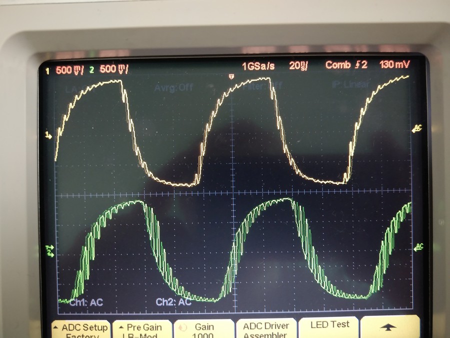

.. und was ich unabhängig von meinen Spielereien noch
schreiben wollte:
Ich lese hier seit glaube ich Anbeginn mit, eines der
Hauptprobleme mit dem HW-Design ist die Clock-Beschaltung.
Das FPGA verfügt nur über 4 PLLs, angesteuert werden aber
8 ADCs (4 je Kanal). Die PLLs sind eiglich in der Lage,
3 Clocks zu generieren, so dass die Phase je ADC einzeln
angesteuert werden könnte.
Aber: erstens sind die ADCs "schlecht" konfiguriert, z.B.
könnten die ADCs mit halber Taktrate angesteuert werden
(der entsprechende Pin heisst glaube ich CLKDIV??) und
zweitens könnten noch unbenutze FPGA-Pins für zusätzliche
Clockleitungen sorgen. So hätte man damit 8 Phasenparameter.
Schade!!!
Bei der gegebenen Beschaltung werden jeweils 2 ADCs beider
Kanäle mit einer Phase bespasst, selbst bei bestmöglichen
Längenmatchings gibt's Versatz. Für "unser" DSO sieht man
dass am Besten in Bildern wie zuletzt von Yutie. Beide
Kanäle zeigen unterschiedliche Signalveräufe bzw. Fehler.
(Längenmatching der Datenleitungen sind dagegen iO)
Abhilfe hier: beim Zeichnen der Punkte/Linien müssen die
Phasen berücksichtigt werden. Das hatte ich mal gemacht,
sieht im Ergebnis dann gut genug aus.

Hallo Yutie,
das Problem kann individuell von Gerät zu Gerät unterschiedlich sein.
Auch bei meinen beiden Geräten sieht das nicht gleich aus. Die Ursache
hat Sigi oben ja schon angedeutet:
Um das Problem so einigermaßen in den Griff zu kriegen, hat WELEC hier
das ADC-Change Register eingeführt, über das wir uns lange Zeit den Kopf
zerbrochen haben. Es steuert vermutlich den Interleave zwischen den
einzelnen ADC. In der Factory Einstellung wird ein Wert aus dem Flash
verwendet den WELEC hier hinterlegt. Evtl. ist dieser Wert bei Dir
schlecht gewählt. Kannst Du Dein Gerät über das RS232 Kabel an den PC
anschließen und mal prüfen was da für ein Wert bei Dir erscheint?
Im Terminal dazu einfach ein Semikolon eingeben (;). Daraufhin gibt das
Gerät eine Liste von Variablen aus. Hier suchst Du jetzt nach
_regADC[F1].adc_change - bei mir ist hier 2020800 eingestellt, beim
anderen Gerät 2020f00.
Zusätzlich wäre noch der Registerinhalt von _regADC[F1].channel_Adr
interessant. Bei mir erscheint hier 5f0a.
Wenn Du Fragen hast zum Einsatz des Terminals - einfach raus damit. Es
gibt auch eine Anleitung im doc Verzeichnis.
Gruß Hayo

#7094416
Hätte mich jetzt auch etwas gewundert.
Aaaber - mir ist gerade die Idee gekommen woran es noch liegen könnte
(war zu naheliegend um gleich drauf zu kommen :-) ).
Wenn Du das Gerät mit der High Freq2 Einstellung kalibriert hast, dann
liegen evtl. verschobene Werte im Kalibrierungsspeicher. Stell doch mal
das ADC-Setup auf Factory, lass das Gerät einen Moment laufen, damit es
warm wird und mach dann eine Kalibrierung.
-> alle Eingänge offen oder kurzgeschlossen
-> Calibration: Standard
-> Default Setup
-> Calibrate Offsets
Letzteres kann bei mehrmaligem Ausprobieren ganz leichte Unterschiede
zeigen. Sieht man daran, wie genau die Nulllage mit den Pfeilen am Rand
übereinstimmt, und wieviel Grundrauschen auf dem Signal ist.
Probier doch mal aus ob das hilft
Gruß Hayo

Hallo!
Okay, dann hatte ich das falsch verstanden. Es sind nur die Kühlkörper
draufgekommen.
Ich habe das Oszi gerade am Rechner angeschlossen und lese die Variablen
(Taste "," laut Hilfe) aus:
* _regADC[F1].adc_change  :  2020f00
* _regADC[F1].channel_Adr :  5f1f
Eine Kalibrierung bringt nichts. Kann man die oben genannten Werte
händisch ändern? Ich kann sie ja notieren und mit den Werten ein
bisschen spielen.

So mein Lieber!
Da ich trotz Coronaerkrankung und angespannter Lage beim Kunden, in der
heimischen Einzelhaft Lust hatte ein wenig an der Firmware zu basteln,
habe mal eine neue Compilation von der 8.6 gemacht und bei SF
hochgeladen:
https://sourceforge.net/projects/welecw2000a/files/Open%20Source%20Firmware/1.2.BF.8.x/
Im ADC Setup sind jetzt zwei neue Einträge Test 1 und Test 2, die Du
ausprobieren kannst. Es handelt sich bei den Werten um die Standard
Flash Werte meiner beiden DSOs. Sie bewirken bei meinen Geräten genau
gegensätzliches Verhalten. Wenn ich eines der Geräte mit den Werten des
anderen lade, gibt es die schon bekannten Zacken auf der Signalflanke.
Ist also schon recht individuell. Bei Bedarf kann ich auch noch weitere
Werte hinzufügen.
Viel Spaß beim Probieren
Hayo
Gast #7102439
Hallo und guten Abend!
Danke für das Modifizieren der Firmware, das werde ich ausprobieren.
Ich habe auch ein bisschen mit dem Oszi gespielt. Eine Sinusschwingung
von 125 MHz ist auf Kanal 1 recht schwer darzustellen, auf Kanal 2 mit
einem Filter hingegen schon.
Kanal 1 klappt bis ca. 40 MHz einigermaßen ordentlich. Mir fallen auf
beiden Kanälen Spikes auf, die nach mehrfachen umschalten der Zeitbasis
meist verschwinden. Tatsächlich kann man im ADC-Setup deren Häufigkeit
beeinflussen. In der Stellung "Factory" sind sie am geringsten.
Bis ca. 100 MHz ist es also auf Kanal 2 brauchbar.
Na ja, ich versuche die Firmware mal und lasse euch wissen, ob und was
sich tut.
blueflash wünsche ich eine gute Besserung.
Danke und Viele Grüße,
Yutie
Gast #7107770
So, die Arbeitswoche ist vorbei und ich hatte Zeit, die Werte zu testen.
Als erstes hatte ich das Problem, daß das Oszi immer die
Software-Version 7.15 ausgab, bis ich merkte, daß ich die falsche
Firmware flashte.
Nach einem neuerlichen Flash probierte ich die beiden Testpunkte aus.
Test1 bewirkte nichts.
Test2 hingegen lässt die "Zacken" auf Kanal1 geringer werden. Es sind
zwar noch immer kleine Stufen sichtbar, aber man erkennt die Sinuskurve
deutlicher. (30 MHz, 50 mV/Div, 10ns/Div).
Kanal 2 ist noch immer gestört, egal welches Setup ich wähle.
Test2 ist also der richtigen Einstellung recht nah.
Danke und Gruß,
Yutie
Gast #7107800
Ich nochmal.
Mir ist gerade etwas aufgefallen:
Nach einiger Zeit zeigte das Oszi wieder diese Zacken an. Jetzt habe ich
es aus-.und wieder eingeschalten und da sind die Zacken wieder fast weg
(mit Test2).
Beim Wiedereinschalten klickten auch die Relais.
Ich habe das gleiche nochmal gemacht und da klickten die Relais nicht.
Vielleicht sind die fehlerhaft geworden oder eine Spannung stimmt mal
wieder nicht. Das könnte ich überprüfen. Vielleicht ist auch ein
Rauschen drauf.
