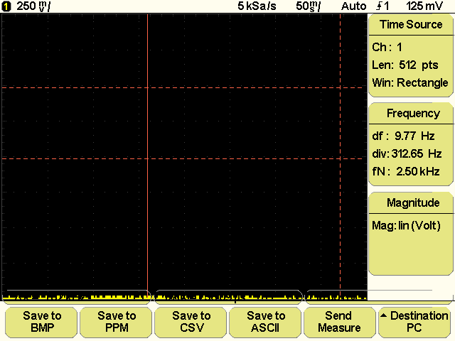

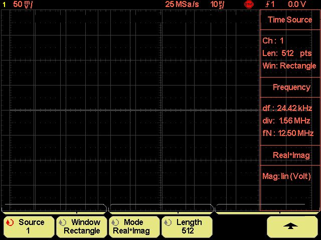

von Andreas W. (andiiiy)
@Hayo,
ich hätte da noch einen kleinen Schönheitsfehler ...
Versuche mal im normalen Horizontalen "Main"-Modus die manuelle Messung
("Cursors"). Dann über "Main/Delayed" auf FFT umstellen ...
... dann sind noch die alten Buttons und Linien (bei mir) zu sehen.
PS: Leider bin ich für mein Käferreporting bekannt ... ;-)
Grüße Andi

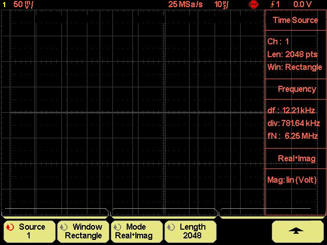

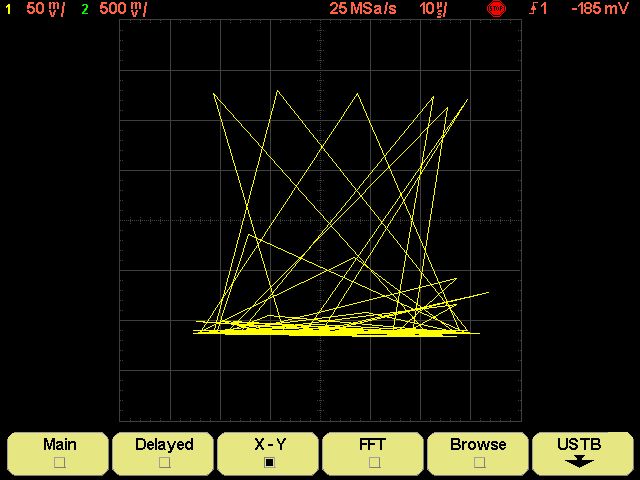

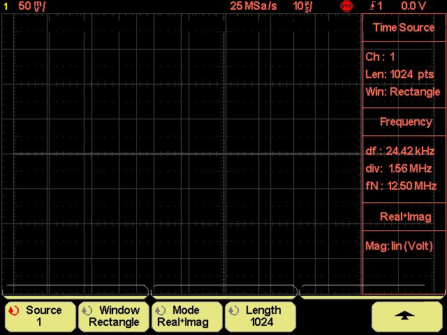

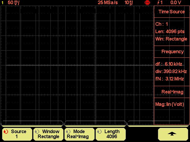

@Hayo
Noch etwas was mit dem Browse-Button ...
Im MAIN mit BROWSE ... Umstellung auf FFT ... zeigt folgendes Bild!
PS: Viel Spaß beim Lernen ... ;-)
Grüße Andi

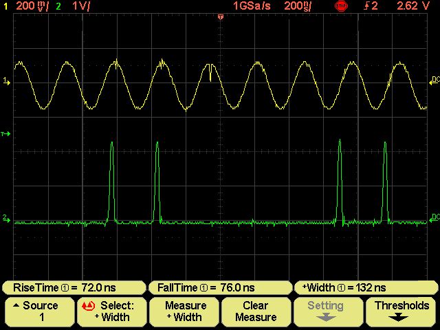

Jörg H schrieb:
>Ein etwas anderer Programmierstiel kann nützen, Tabellen sind nicht mehr
>unbedingt so angesagt wenn sie nur wenige Rechenoperationen ersetzen.
Hayo, in the ultimate 1.2.BF.5.8XE firmware you moved FFT tables from
RAM to flash memory.
Is it also for compatibility with the Jörg H. new OSOZ FPGA design?
Working synergically follow suggestions and planned road map will take
us far, great work!
Thanks Jörg H., Hayo and all which are involved in the Welec Project!
Hayo W. schrieb:
>The main problem is the slow NIOS cpu.
>But it is not forgotten, I just made a little break to solve some
>other issues. If Jörgs new OSOZ FPGA with multiplication unit is running
>stable, it will be no problem to implement the sinc interpolation.
Hayo, this is a good news, i believe sin(x)/x interpolation will be an
important improvement for our beloved DSOs.
Thanks a lot!
Hayo W. schrieb:
>> And again, any news about the spikes fix?
>I got no news about that, but maybe some of the other guys here? This
>problem will also be obsolete with Jörgs new FPGA-design. I'm looking
>forward...
OK Hayo and all.
I hope someone fix the problem in a way or other.
As it is now it is one of the great trouble with the Welec's DSOs.
Lucky are the people which they have the 1C9.0E FPGA version because
seems that have not the spikes problem if I am not wrong reading old
posts in the forum.
May be the new FPGA design surely solve the problem.

This problem is for sure a problem with the timing in the FPGA when
writing ADC values into the capture memory.
If I'm informed right there are existing two main versions (in three
FPGA versions)
Version 1 (which are both of mine) has spikes only on some special
situations and as my 4 Channel DSO when it is hot after using for some
hours.
Version 2 has the spike problem every time! If you got this version, the
only possibility might be to change the FPGA version to one of the
version 1 (don't know if someone tried this).

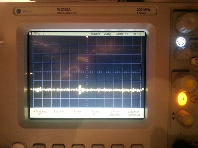

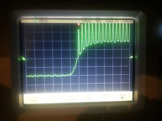

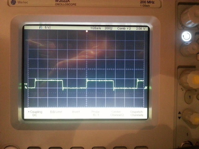

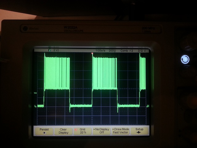

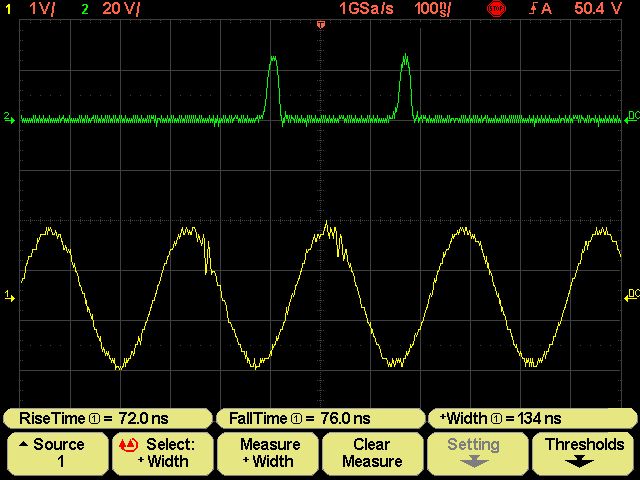

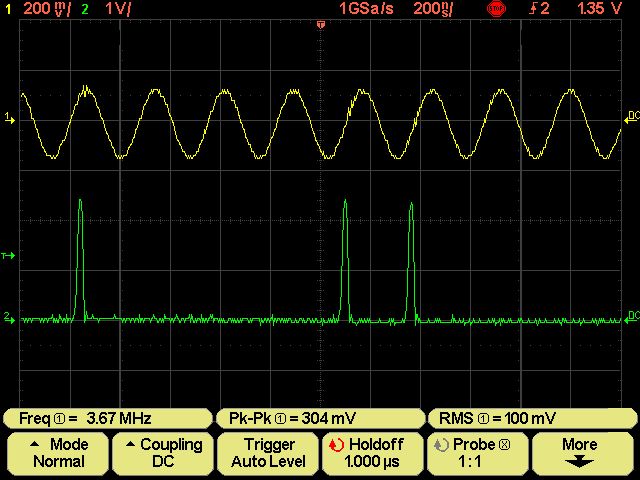

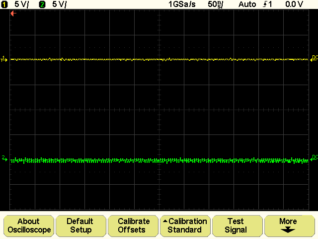

von T. F. (sar)
habe heute gerade mein W2022A auf die neue Firmware aktualisiert.
Wenn ich mit dem w200a-screenshot Tool probiere auf das Oszi zuzugreifen
bekomme ich folgende Meldung:
* Connecting to DSO and retrieving version information... done
w2000a-screenshot: This version needs at least firmware version 2.20, but you've got 0.0.
Please update your DSO.
Außerdem habe ich noch folgende Probleme:
CH1: Auf 1:1 eingestellt (Tastkopf auch): Sobald ich die Skalierung auf
größer 1V/div Stelle bekomme ich kein Signal mehr. Normal oder habe ich
es irgendwie geschafft den Eingangsverstärker oder so zu schießen? Bei
Tastkopf 10:1 ergibt sich das selbe ab Skalierung 10V/div.
CH2: Sobald ich einen Offset einstelle (Position der Waveform am
Bildschirm) und Teile des Signals liegen in der oberen Hälfte zeigt das
Oszi starke Spitzen bzw einen dicken grünen Balken für die Signalteile,
unabhängig von der eingestellten Skalierung.
Ist dies normal?
Danke,
Stefan
Hallo Stefan,
Das beschriebene Verhalten habe ich auf meinem Gerät nicht!
Ich habe zusätzlich noch einen Test beim Kanal 2 durchgeführt .... auch
da kann ich Deinen Fehler nicht reproduzieren.
Probier noch einmal "Utility", "Default Setup" ...
Gruß Andi
von Blue F. (blueflash)
Hallo Stefan,
mein Screenshot funktioniert einwandfrei. Hast Du als Destination "PC"
gewählt?
Auch die anderen Probleme treten bei meinen Geräten nicht auf.
Wie Andi schon sagt Default Setup machen. Bzw. vielleicht die Firmware
nochmal flashen.
Gruß Hayo

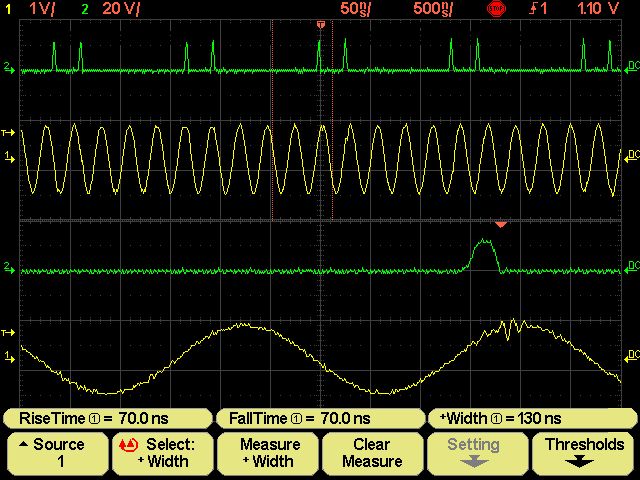

von T. F. (sar)

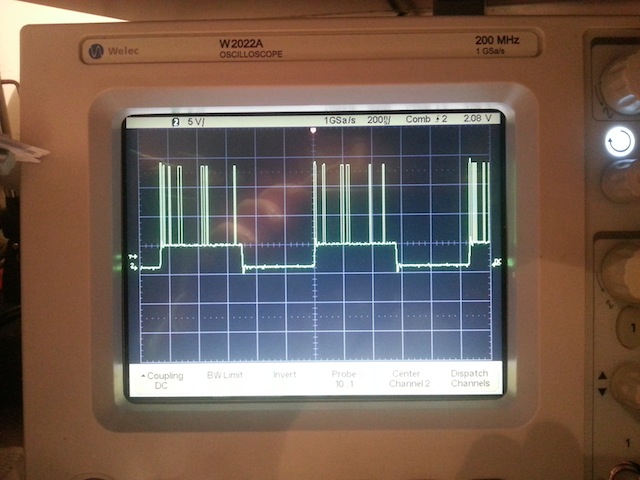

Default Setup und Firmware nochmals flashen haben nichts gebracht. Im
Anhang noch ein paar Bildchen.
Stefan

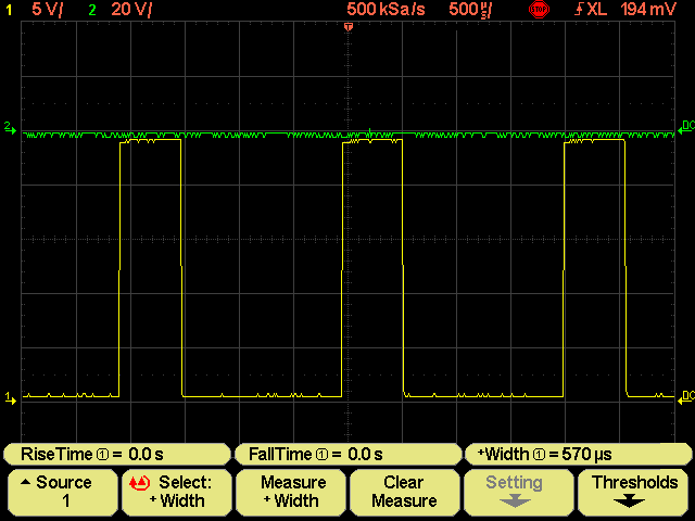

von T. F. (sar)
also das Problem auf Channel 2 tritt nur auf bei einer Timebase kleiner
10us. Bei 10us ist alles o.k. doch sobald ich auf 5us drehe kommen die
Störungen. Hier noch ein Bild der Spitzen bei 10ns Timebase.
Bei CH1 hört man ein Relais umschalten wenn ich bei 1:1 von 500mV auf 1V
schalte. Bei 500mV sehe ich noch was bei 1V nichts mehr. Da scheint es
mir irgendwas intern zerstört zu haben. Komisch da ich bis jetzt nur an
5V uC-Schaltungen / FPGA gemessen habe und eigentlich immer mit 10:1
Tastkopf....
Hatte das Oszi lange nicht im Betrieb und jetzt diese Probleme. Hoffe
jemand von euch kann mit weiter helfen.
Danke,
Stefan
von Jörg H. (idc-dragon)
Stefan: die Spitzen sehen mir aus wie die berüchtigten Spikes,
Datenübernamefehler intern im FPGA wegen zu agressivem Timing, sprich
schlechtem Design.
Bessert sich das wieder, wenn du auf die ältere Software zurückgehst?
Hayo: wird das vielleicht mit dem neuen Code forciert, weil die
magischen Register nicht so stehen wie vorher?
Jörg
von T. F. (sar)
Hallo Jörg,
In der Zwischenzeit habe ich mich größtenteils durch die Welec Threads
hier gekämpft. Ich habe mein Scope jetzt auseinandergenommen und die RAM
und ADC Bausteine nachgelötet. Nach dem Zusammenbau sind die Probleme
von Kanal 2 verschwunden. Juhu.
Für Kanal 1 werde ich in den nächsten Tagen mal das Scope wieder
auseinander nehmen und unter der Abschirmung nachschauen was es mir da
zerstört hat.
Danke,
Stefan

auftaucht.
Zwar konnten wir die Sache auf einen Temperatureinfluss zurückführen
(siehe Hardware Thread) (unter 10°C gibts wohl bei allen Geräten die
Spikes?), allerdings habe ich die Spikes definitv jetzt auch bei etwas
niedrigeren Raumtemperaturen direkt nach dem Einschalten, wo sie früher
nicht vorhanden waren. Unabhängig auch wenn ich eine alte FW aufspiele.
@sar: kannst du das Spike Problem nach deiner Lötaktion auch bei
niedrigeren Temperaturen als erledigt bezeichnen?
Hast du mit Heissluft oder mit dem Lötkolben nachgelötet?
Fast ein Hardware Beitrag geworden, sorry.
von T. F. (sar)
@ben: Ich habe mit Heißluft gelötet. Werde mal schauen ob ich das Oszi
an die frische Luft für einen Test bewegen kann.

Mir war es nie aufgefallen, weil meine DSOs immer den ganzen Tag lang
laufen wenn ich programmiere und teste. Die sind also immer auf
Temperatur. Geht evtl. einigen Anderen ähnlich. Ich habe es erst gemerkt
als ich wegen des Hinweises meine Büchse mal bei niedrigen Temperaturen
auf der Terrasse angemacht habe. Da war ich echt erstaunt. Das Problem
gab es aber wahrscheinlich schon von Anfang an.
Falls die Lötaktion tatsächlich Abhilfe geschaffen hat wäre das
natürlich eine Maßnahme um dem zu Leibe zu rücken.
Gruß Hayo

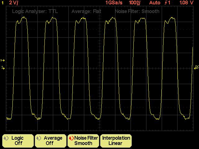

Ich habe hier mal den Auszug der Cutoff-Frequenzen:
- Smooth ca. 80-90 Mhz
- Strong ca. 30 Mhz
- IIR 1 Stage ca. 70-80Mhz
- IIR 2 Stage ca. 35-40Mhz
- IIR 3 Stage ca. 20MHhz
mir würde es besser gefallen, nur die Frequenzen der Filter im Grit-Menu
einzublenden. Das hat eine klare Aussage, finde ich!
Was meint der Rest dazu?
Gruß Michael

Die Cutoff-Frequenzen sind nur für Abtastrate 1GS/s richtig!
Die Eckfrequenzen der Softwarefilter hängen natürlich immer von der
Abtastfrequenz ab.
Der Smoothfilter hat in allen langsameren Zeitbasen die Cutoff-Frequenz
der halben virtuellen Abtastrate, da die tatsächliche Abtastrate viel
höher ist und die ungenutzetn Samples für die Filterung benutzt werden.

P.S. Today, yesterday due the time ;-), my W2022a and W2012a "battled"
against some DSO (LeCroy and Tektronix) winning on them in the display
of an elusive short and fast signal.
The W2012a has achieved similar performance than a Wave Ace 224 by
LeCroy whch is a 200MHz bandwidth DSO, the W2022a was better than
the WaveAce 224.
The results were confirmed by a 500MHz bandwidth DPO by Tektronix,
where the W2022a showed the real shape of the signal that the WaveAce
224 and the W2012a could only do suppose.

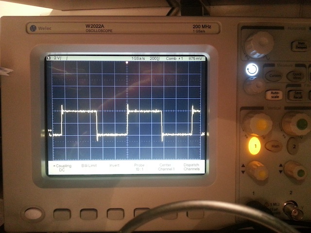

von T. F. (sar)
wenn jemand daran interessiert ist mein W2022A zu kaufen, dann biete ich
es hier jetzt an. Es hat die oben beschriebenen Macken.
Preisvorschläge bitte per PN.
lg,
Stefan
von T. F. (sar)
@all:
Bevor ich das Scope verkaufe habe ich jetzt gerade nochmals die 1.3er
orginal Firmware aufgespielt. Die oben beschrieben Spikes (Heißluft
behob das Problem nur temporär) und auch die Probleme mit dem Kanal 1
sind mit der orginal FW nicht vorhanden! Hat mich gewundert, ist aber
so.
Gibt es noch irgendwas, was ich testen kann um auch die neue Firmware zu
verwenden?
Danke,
Stefan
Hab ich das jetzt richtig verstanden?
Mit der WELEC Gurken-FW hast Du zwar auch die Spikes, aber keine
Probleme mit Kanal 1, während Du mit der BF-Firmware auf Kanal 1
Probleme hast?
Gruß Hayo
von T. F. (sar)
Hallo Hayo,
Die Spikes sind weg. Wegen Kanal 1 habe ich mich getäuscht. Da habe ich
nur auf die angezeigte Kanal-Skalierung geachtet. Diese wird allerdings
beim Umschalten 1:1 zu 10:1 nicht angepasst bei der orginal FW.
Aber die Spikes sind weg und sind bis jetzt auch nicht wieder da.
Stefan

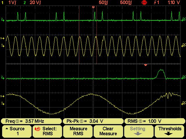

Using DELAYED screen, as well using "Pre Triffìgger Keep+follow", "Keep
Value and "Trace Middle", get garbage on the waveforms at the trigger
time  expecially analyzing two waveforms, seems to me something related
with the infamous "spikes problem".
Same issue is present in MAIN screen using  "Pre Triffìgger
Keep+follow", "Keep Value and "Trace Middle", others configurations are
OK.
Seems to me setting "PRETRIGGER GRID MIDDLE" occasionally moves from the
center of the grid and it is necessary to reset it.
Please see screenshots "DELAYED" and "Spikes when two trace".

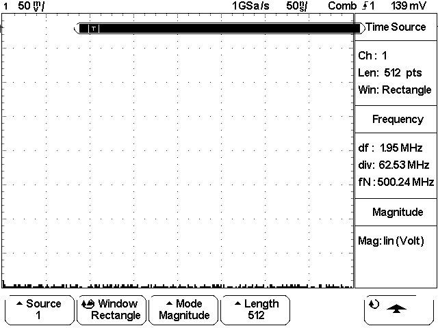

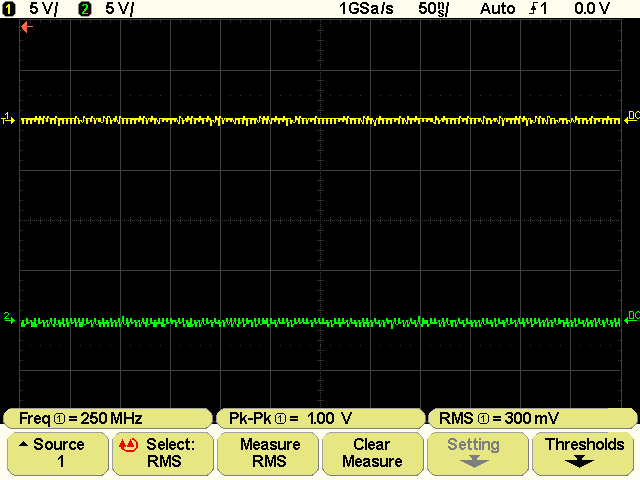

FFT had some issues.
The graticule had garbage(*) on it and this is known, but seems to me
"div" and "fN" values change when choosing for 512, 1024, 2048 and 4096
points.
512 and 1024 points has not changed, but 2048 and 4096 they have their
own values.
Seems to me also scale factor changed setting 2048 and 4096 points but
may be a consequently to other problems in this beta version.
Good the rotary controls, of course 2048 and 4096 points slow down the
screen refresh.
Please look at the screenshots "512 points", "1024 points", "2048
points" and "4096 points".
(*)Graticule issue also involves certain buttons, for instance sometimes
FFT and X-Y become gray even if they can be activated by pushing their
buttons.
Perform reset do not fix grey buttons problem but only graticule and
garbage on the screen.

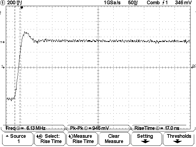

As always the Quick Measure and the X-Y (**) mode they  work like a
charm.
In reference to the precision attainable by the Quick Measure screen,
please to look at the screenshot named "Q-Measure" (*) where you can see
Quick Measure working on the output of my Lyons pulse generator setting
for a 25Vpp pulse with a 10nS of rise time, 8nS of the fall time and
100nS width...RESPECT!
(*) The time trigger position is wrong on the screenshot for the reason
I anticipated when I wrote about the fact some parameters were changed
in values when recalled from memory location, in real time it was right.
(**)"X-Y" it show a 3,6MHz sine wave on X axis and a 44ns pulse repeated
at 1MHz range on Y axis

- Grid and drawing failures are only an beta problem and solved since
BF.6.3
- FFT df/div are correct.  Length 512 / 1024 both use full frequency
range 0.5 * sample rate. Because of only 512 points available on screen
the length 2048 uses 0.25 * sample rate and 4096 uses 0.125 * sample
rate. So you can calculate by Your self which value is correct.
- Trigger -> free run simply means trigger switched off. Data acquistion
is running completely asynchronous as fast as it is possible without
waiting until any event may occur.

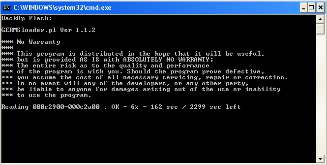

auch mal BtW. ich benutze gerade den Germs für ein Backup mit den
Parametern: perl GERMSloader.pl COM6 -r flash_dump.flash 40000 7fffff
Leider werden dafür satte 2400 Sekunden gebraucht, das macht über 40min.
Gibt es eine Möglichkeit, auch das Dump ziehen zu beschleunigen?
Vielleicht ist es ja nicht so wichtig, ich dachte nur, im Falle eines
Problems, könnte man dann verifizieren!?
...nur so eine Idee.
Gruß Michael
Das neue Makefile ist eingecheckt. Die Verzeichnisstruktur habe ich im
ersten Wurf noch nicht geändert (nur Verzeichnisnamen umbenannt).
@Michael
Nein, das Gesamtbackup dauert halt etwas länger. Aber es werden nachher
weniger als 40 min wenn ich mich recht erinnere, das ist nur die
Anfangskalkulation.
Hayo

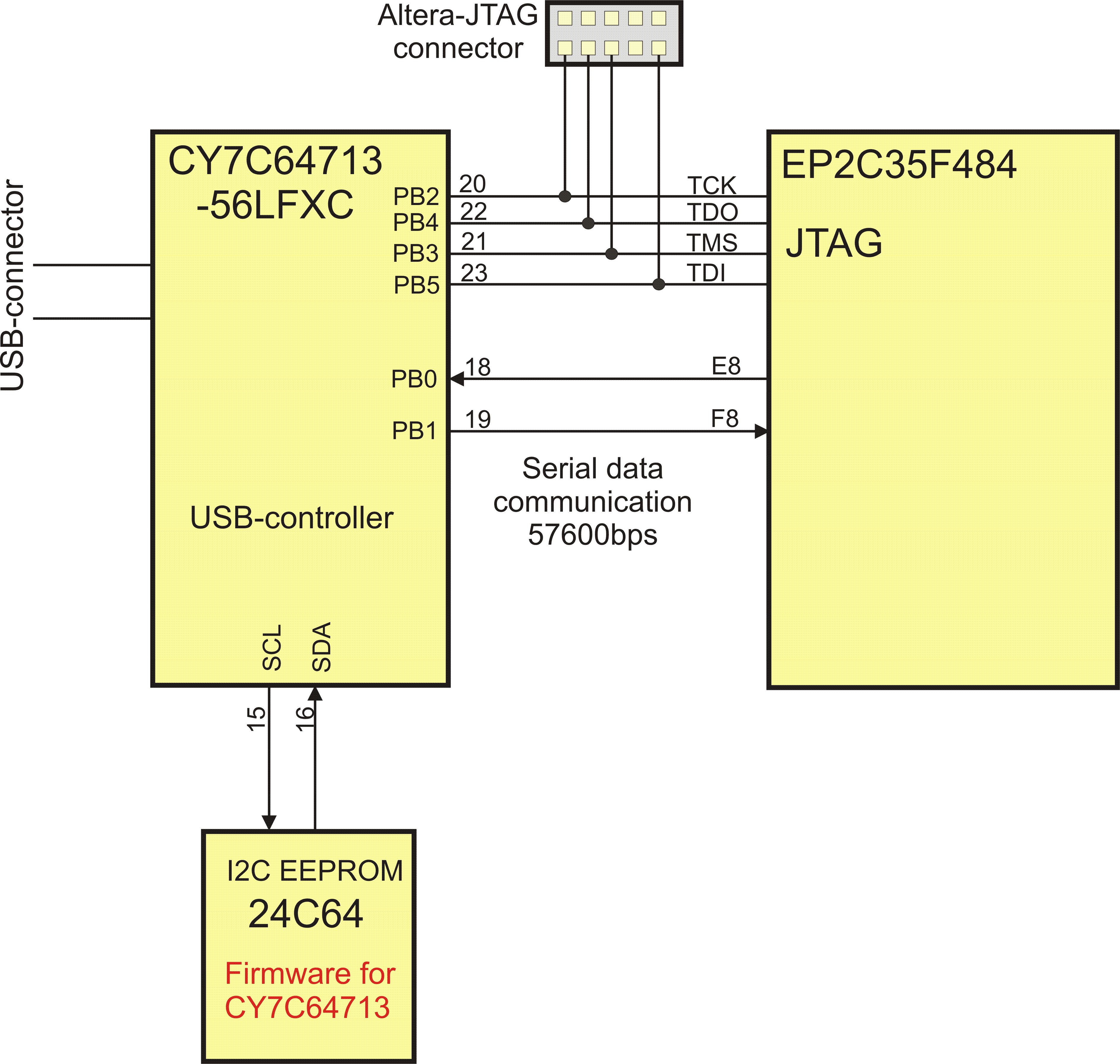

http://sourceforge.net/apps/trac/welecw2000a/attachment/wiki/USBBlaster/Solder%20here%20kl.JPG
@ Mike
> Dafür gibt es doch den Altera-USB-Blaster.
Der geht dann auch auf JTAG. Siehe Anhang
Jürgen

Returning IT, maybe I'm wrong but seems to me in this new release the
trigger works better than ever either inner than EXTernal trigger,
really very good: KLASSE!
Even very nice and impressive the screen status as it is now
implemented: KLASSE!
But only one thing and as always only for knowledge and no for
criticism.
Hayo, now using ALTernate trigger the trigger level on the top of the
screen became 0 Volt but adjusting it throught its knob it is possible
to change the level, which however it remain as it was setted when
ALTernate trigger is switched off returning in usual trigger mode (CH1
or CH2 for two channels DSO version or even CH3 or CH4 for the four
channels version).
Instead if the trigger level knob is not adjusted then switching among
ALTernate tiggers and the previous setting, the trigger level shown on
the top of the screen return to be as it was setted before to switch in
ALTernate mode.
Seems to me the values that I obtain by adjusting the trigger level knob
during the time which ALTernate trigger is settled on are dummy, they
are not real.
I hope I was understandable although I realize I explained badly.
However I don't know why and if this is normal or no, I emphasize it
only as knowledge.

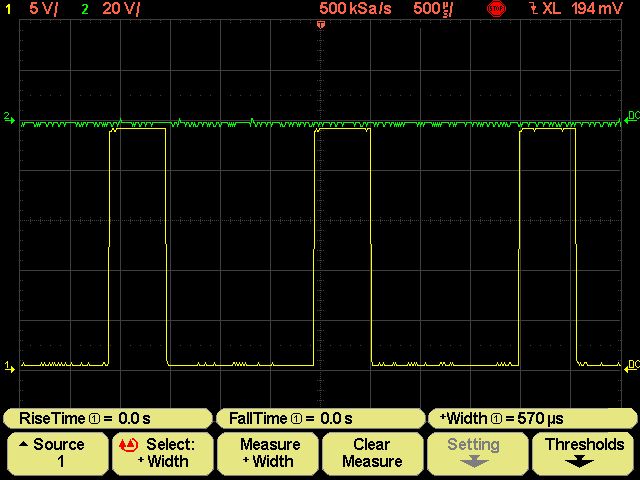

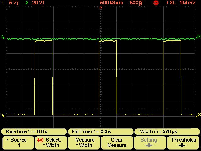

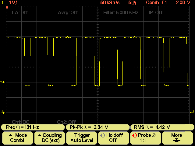

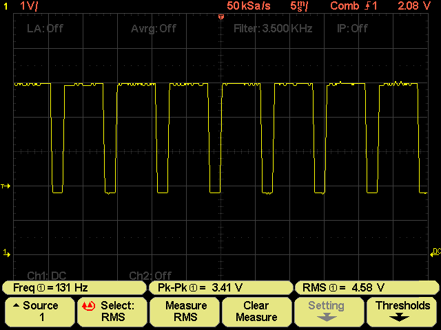

von Michael D. (mike0815)
Hallo Hayo,
dann fange ich mal an:
hier 2 Shots, vorher(6.3) und nachher(6.4)
zu sehen ist ein PWM-Signal mit 131Hz von einem Selbstbau RGB-Dimmer.
Nach dem Flashen der 6.4, habe ich jetzt aber mehr Grundrauschen ohne
Signaleingang, das war vorher weniger.
Für was ist jetzt die Gain im HW-Menu? Zur reinen Feinjustierung oder
Skalierung? Ich denke eher ersteres?
Gruß Michael

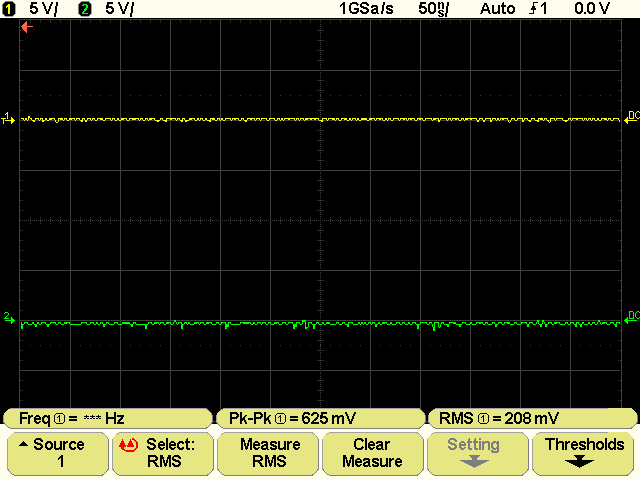

Hier mal die Bilder vom Grundrauschen.
1.Pic: Ver6.3
2.Pic. Ver6.4
Bei beiden Versionen habe ich Defaultsetup gemacht und danach mehrmals
kalibriert.
Gruß Michael
von Charly B. (charly)
moinmoin Hayo & 'Leidensgenossen' ;)
1. das mit den hoheren Grundrauschen ist mir auch aufgefallen
2. das mit der Button Logik ist so BESTENS , 'NUR' haste das
   im Mode/Coupling menue bei den ersten 2 Tasten vergessen ;(
i denke das kann man bei jeder Taste realisieren die ein Popup
oeffnet und dann nur weiterschaltet, i wuerd wetten das nach
kurzer eingewoehnung das keiner mehr missen moechte....
nochmals Danke! & ein schoenes WE
Charly
Sorry, anscheinend ist bei der Kalibrierroutine durch die umfangreichen
Änderungen ein kleiner Bug reingeraten, Korrektur kommt so schnell wie
möglich.
Halo Hayo,
habe gerade hier gesessen, da hat die Email-Trulla geplärrt! ;-)
Natürlich habe ich gleich die 6.4C2 geflasht, Default Setup,
kalibriert...
Der 1.Kanal ist erste Sahne vom Rauschverhalten, der 2.Kanal will nicht,
hast du den vergessen zu korrigieren?
Gruß Michael
Hmm, sieht ja komisch aus. Nein eigentlich sollte das gehen, bei mir
sehen alle 4 Kanaäle gut aus. Warte mal, ich flash das mal eben in mein
W2022A rein, da hab ich noch die 6.3 als Vergleich drin.
Hayo
Ja Du hast recht, da ist noch der Wurm drin, bei mir ist auch der zweite
Kanal nicht kalibriert. Komischerweise ist mein W2014A da ganz
unbeeindruckt.
Ist also in Arbeit, danke für den Hinweis.
Hayo
habe gerade am Trigger gespielt. Es tritt auf bei
50, 20, 10µs,  ok
5µs,   Noise
2µs, 1µs   ok
500ns, Noise
200ns, ok
100ns, 50, 20... Noise
