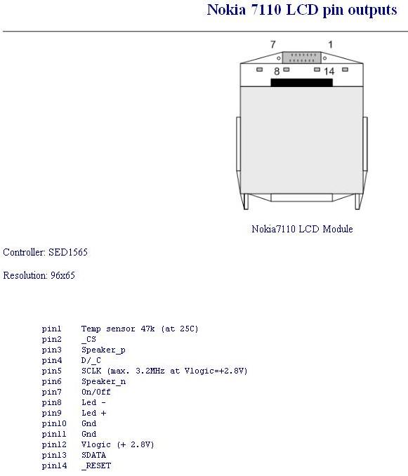

NOKIA 7110
resolution : 96 x 65 pixel display area : colours : 1 Controller : SED1565 backlight : adj contrast : Link : http://module.ro/nokia_7110.html Datei : Media: Nokia7110 Lcd library (SED1565).pdf Library : Datum: Pinout : Media: Nokia 7110 LCD pin outputs.JPG

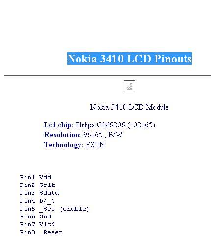

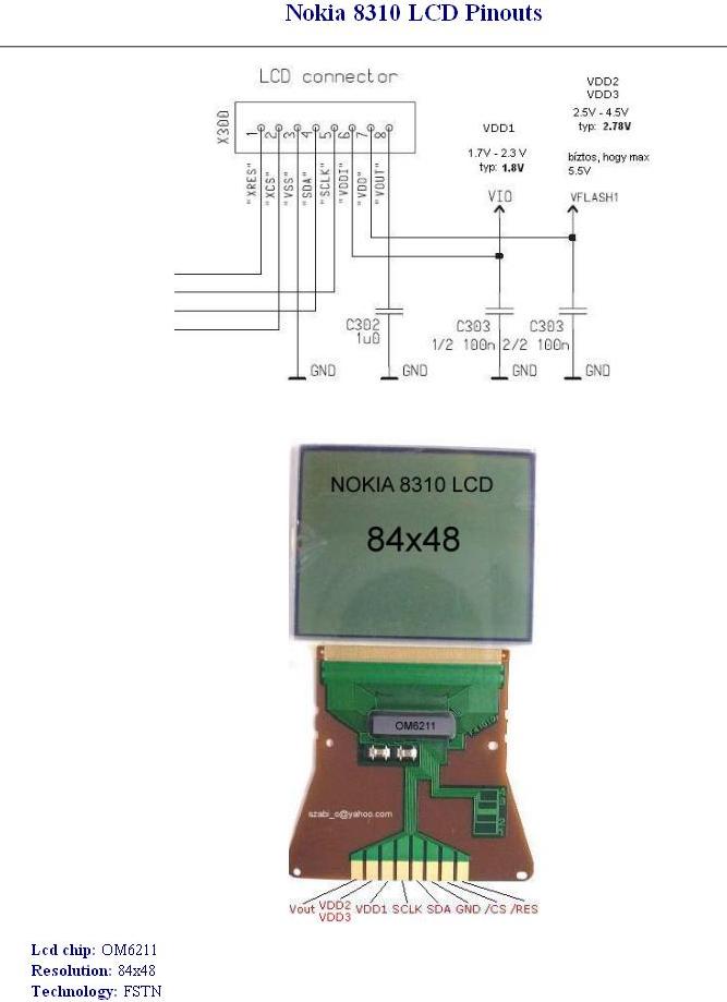

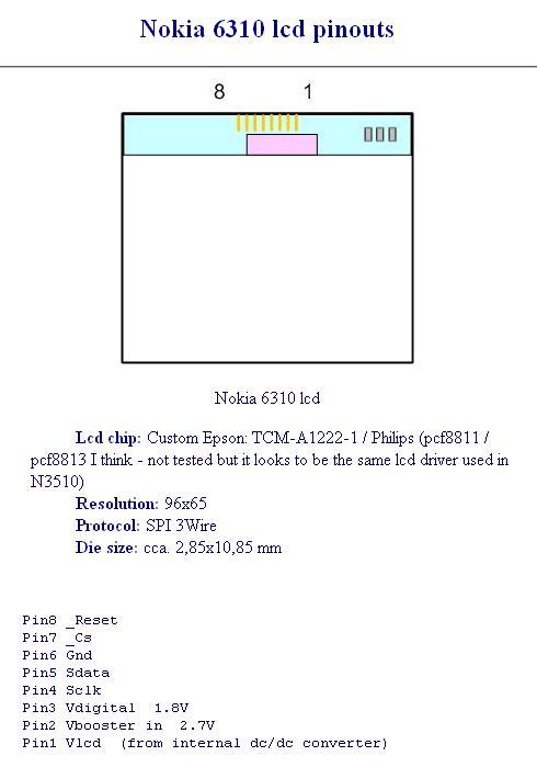

Pinout : Nokia 3410 LCD Pinouts.JPG Pinout : Nokia 6310 lcd pinouts.JPG Pinout : Nokia 8310 LCD Pinouts.JPG
