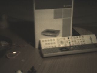

von Martin V. (m_v)
lsusb
Bus 001 Device 003: ID 046d:0840 Logitech, Inc. QuickCam Express
Don't know if it is needed but I made the /dev/video myself before I
loaded the drivers.
/pvr/IDE/build1/tools/qc_driver # ./qcset -i
Name          : Logitech QuickCam USB
Type          : capture subcapture
Channels      : 1
Audio devices : 0
Maxsize       : 360,288
Minsize       : 32,32
Overlay coords: 0,0
Capture size  : 360,288
Chromakey     : 0
Flags         :
Channel       : 0
Tuners        : 0
Flags         :
Type          : camera
Norm          : 0
Brightness    : 32768
Hue           : 32768
Color         : 32768
Contrast      : 32768
Whiteness     : 32768
Depth         : 24
Palette       : RGB888 packed into 24bit words.
Made a picture of the 1760 and 1710 remote. The cam needs a lott of
light so the picture isn't great but it works.
