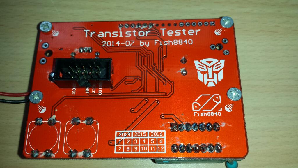

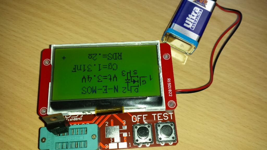

Hallo, meiner kam heute an. Display ist leicht schief und fällt leicht aus dem Hintergrundbeleuchtungsrahmen, naja egal, kann man festkleben. Kam nur 18,- Euro in 12 Tagen. Das Ding funktioniert nach ersten Tests und die Aus-Stromaufnahme liegt bei nicht meßbaren 0,00µA. Ich bekomme aber keine Versionsnummer angezeigt. Nur Batteriespannung und dann das Testergebnis. ICSP zum flashen ist auch nicht drauf. Dachte das wäre dabei.

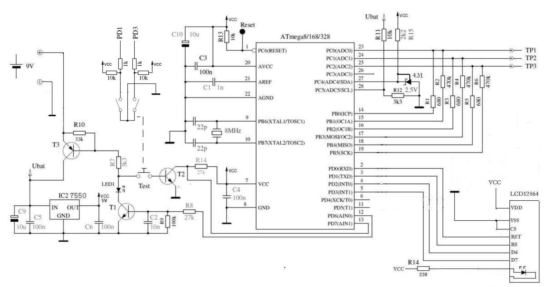

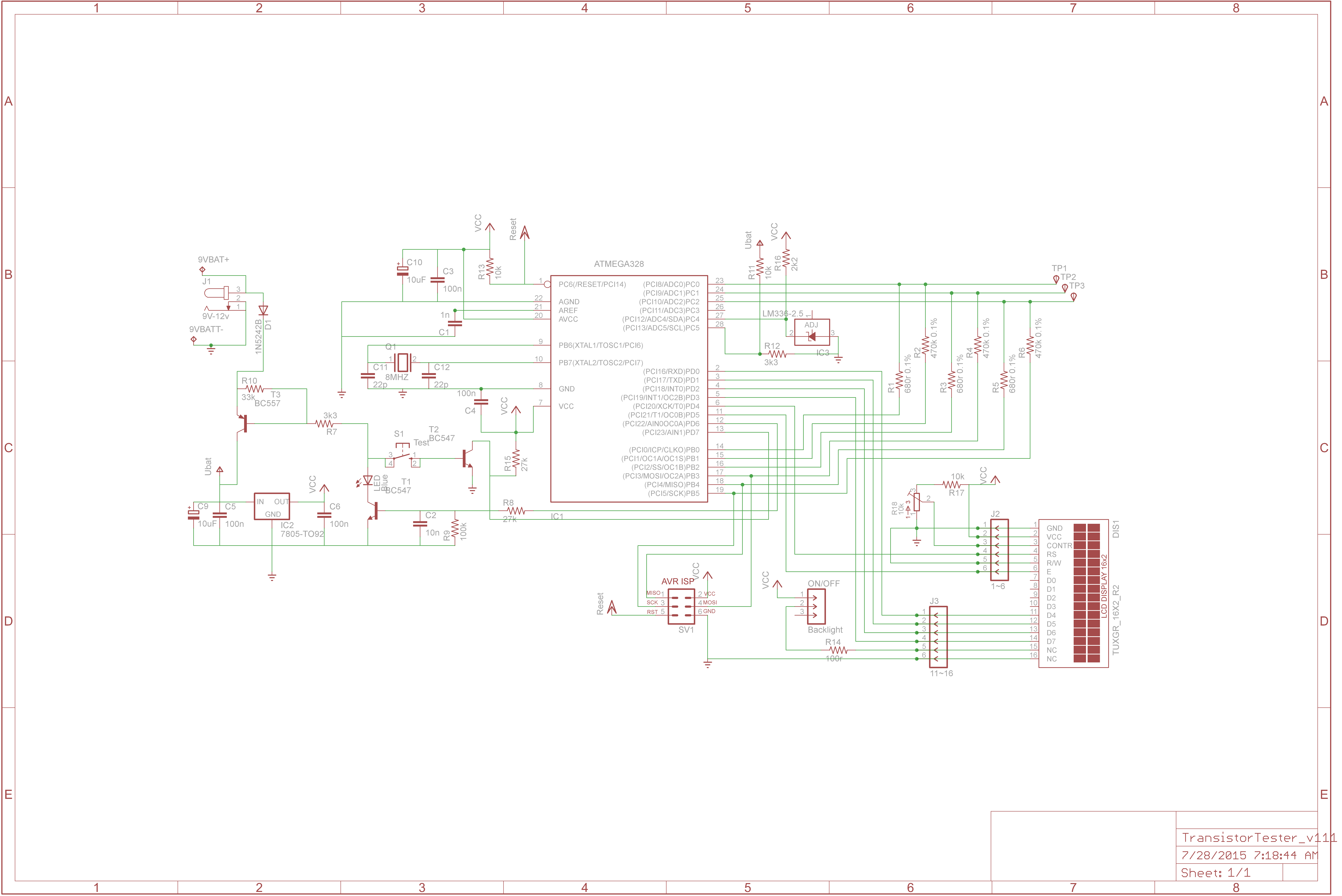

hello ,is my diagram correct?also the components,please guide thanks
dmil schrieb: > hello ,is my diagram correct? Not all junctions are drawn (probably no problem). The T3 transistor BC557 should be a BC557C. The high current gain is required, especially if you use a LED with high burning voltage. A red LED will take the lowest burning voltage, this will increase the base current of T3. You can save a few mA current consumption, if you replace the 78L05 regulator by a MCP1702-5002. The MCP1702 has the same case, but a different pin assignment!
#4214417

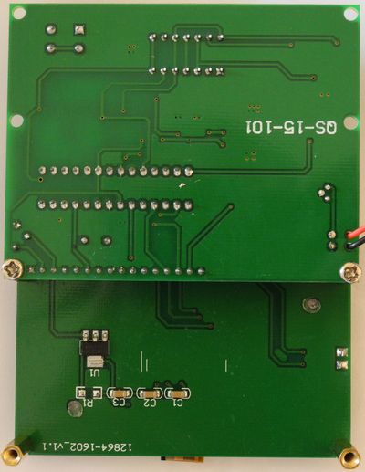

Hallo, on the back side of Display, i have a 3,3 voltage regulator, the pins of this have not to much solder. you board also? Can you resolder? In the front of µC Board also for 5 voltage regulator.
Veit D. schrieb: > Can you resolder? If the controller data inputs are connected directly to the ATmega outputs, you can try to recompile with a modified Makefile. You should set the option LCD_SPI_OPEN_COL and if you can not install the four pull-up resistors to the LCD adapter board, you can also remove the option PULLUP_DISABLE in the Makefile. I don't like the internal pull-up resistors of the ATmega, because it it not possible to switch the output from "high signal" (5V) to "high-impedance" in one step with the enabled pull-up resistors. But I have tested this combination with the simular mega328_fish8840 board without detection of any real problem. I don't own your type of board, so I can not test it.

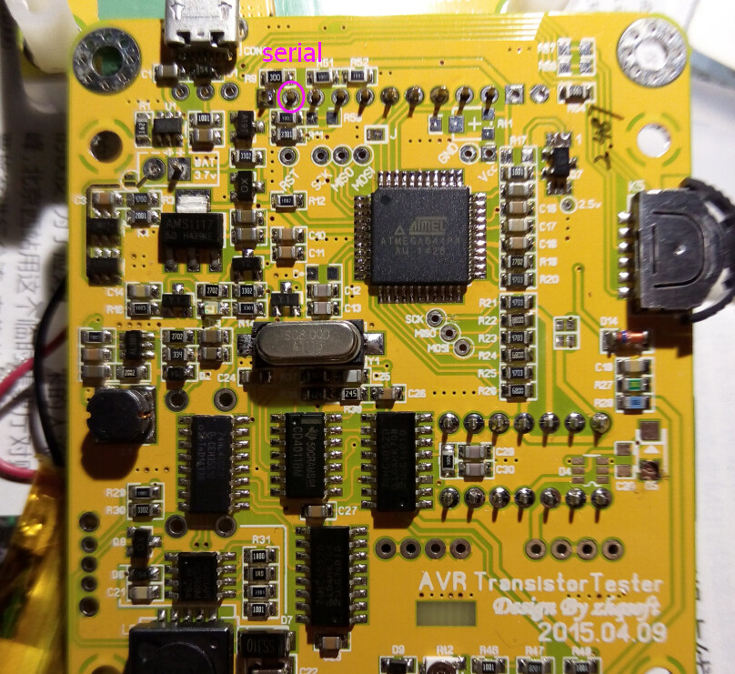

Hi Karl, I removed two pins on the LCD connector (3 and 6) and now the last version of software works normally! The pin 3 was also connected to ground, and as it is the cursor of the contrast potentiometer (not working as it is a software function for this display), when turned off completely it was generating also a short circuit... Usual Chineese engineering. Once more Vielen Dank :-) Denis

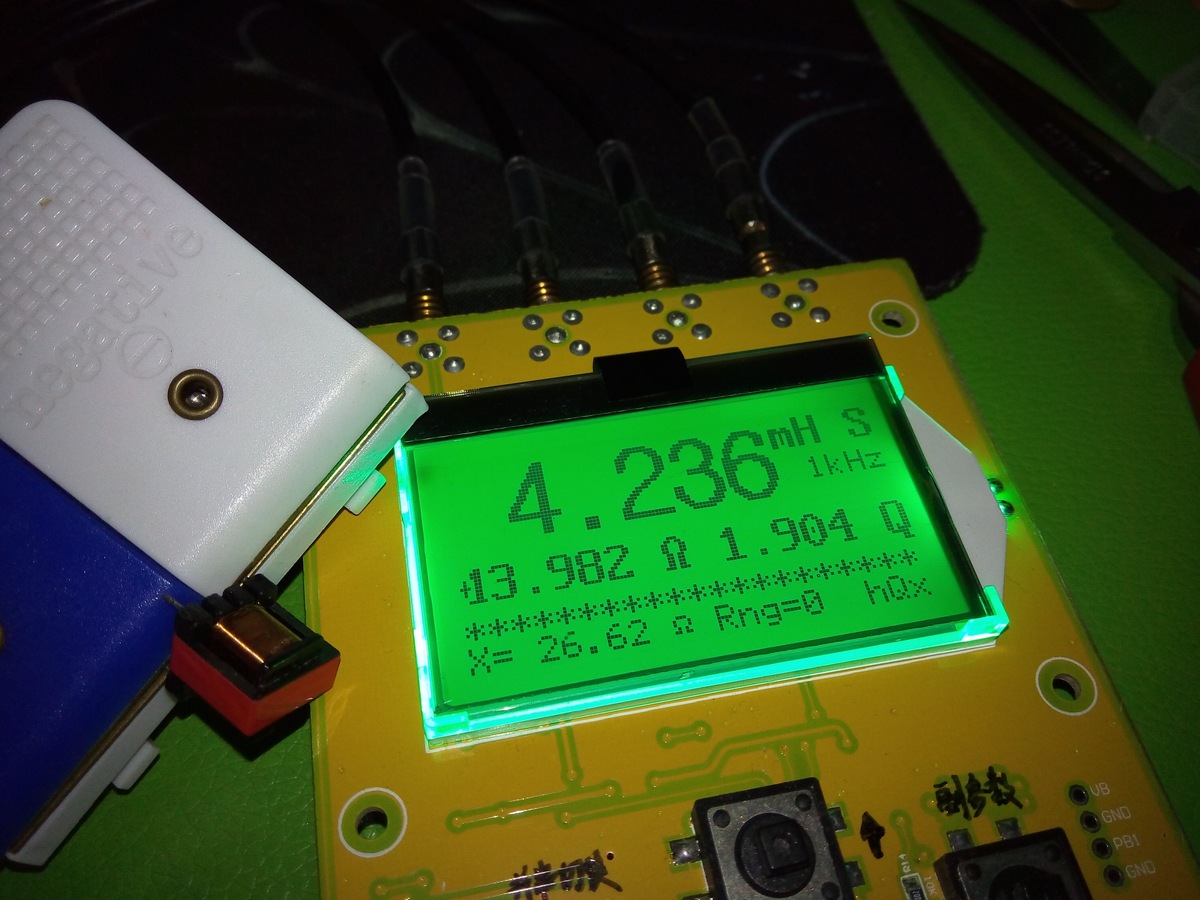

Jörg S. schrieb: > Nach einiger Zeit wechselt Zeile 2 auf 2pF. > Der Punkt 11, in welchem man einen Kondensator zwischen 100nF und 20uF > anschließen soll (1-||-3>100nF) kommt nicht. Bei der Software-Version für einen ATmega644/1284 wird erwartet, daß der Testkondensator (100nF) an PA7 (ADC7) fest verbaut ist. Der zusätzliche 470k Widerstand ist an PC6 angeschlossen. Daher fehlt dann die Aufforderung einen Kondensator anzuschließen.
Messtechniker schrieb: > Induktivitäten: > 22 mH -- 0,02 H -- > 33 mH -- 0,03 H -- > 47 mH -- 4,7 Ohm - Überraschung! > Dafür ist der Tester ja da! Die Ausgabe von 0.02H wundert mich schon. Die Messgrenze ist etwa 10µH, die dann in der Form 0.01mH angezeigt werden. Eine Induktivität von 22mH würde z.B. als 21.7mH angezeigt werden, nicht als 0.02H!

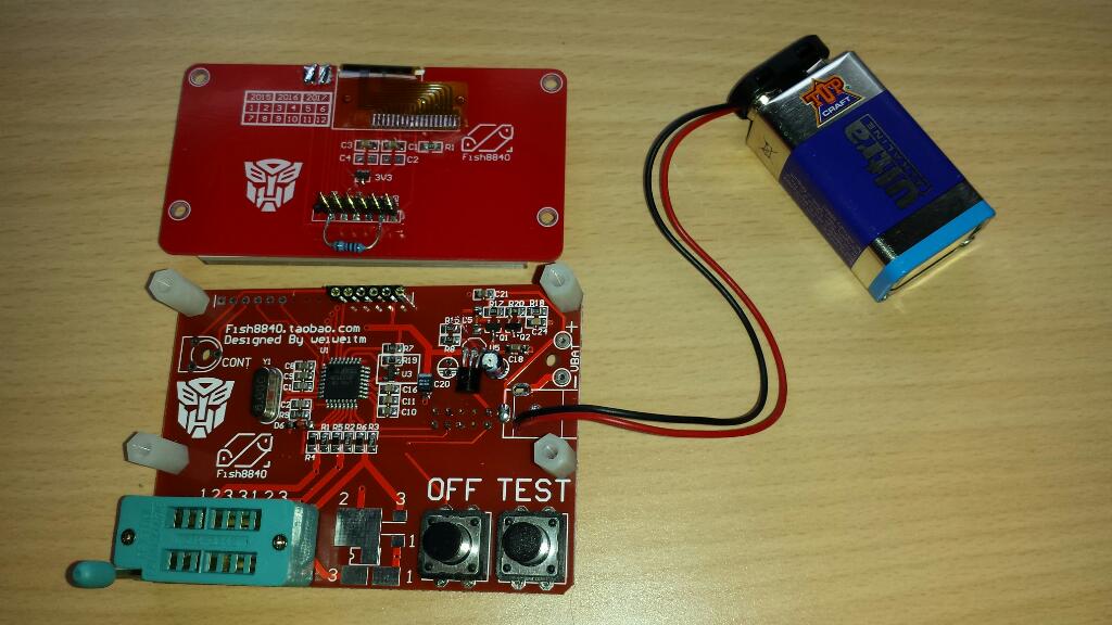

Hallo ins Forum, ich habe einen China-Clone fish8840 (Leiterplattenaufdruck 2014-07) umgebaut und geflasht – siehe ein paar Beiträge weiter oben - dort auch mit Bild-, offenbar ist dieser Klone eine Weiterentwicklung der Leiterplatte, die ich bei Karl-Heinz schon auf dem Foto gesehen habe. Nun habe ich doch noch eine Frage und zwar zur Erweiterung mit einem rotary-encoder, bevor ich da etwas falsch mache oder gar umlöte: Welche Pins könnte ich für den rotary-swich verwenden? PD1 und PD3 steurn bei mir das GLCD (PD1=RS; PD3=SI), sind somit nicht verfügbar wie es die make-file Option vorsieht. PD4 und PD5 wären verfügbar und werden an den LCD-Port geführt, aber dort nicht verwendet, ich könnte in config.h PD4 und PD5 evtl. in die rotary-Funktion einbinden – aber ich fürchte PD4 ist schon für die Frequenzausgabe vorgesehen. PC3 ist so weit ich durchblicke noch frei, falls ich die Software UART nicht benötige. Hat jemand einen Tip oder bei diesem China-Clone fish8840 schon einen rotary-switch eingebaut? Besten Dank. TOM:-)
Tom schrieb: > Hat jemand einen Tip oder bei diesem > China-Clone fish8840 schon einen rotary-switch eingebaut? Die normale Erweiterung des Impulsdrehgebers nach der vorgesehenen Schaltung sollte eigentlich mit dem graphischen Controller ST7565 zusammenlaufen. Die Daten PD1=RS und PD3=SI werden vom Controller nur bei der Flanke von SCLK (PD2) gelesen. Schwierigkeiten bereitet lediglich die Verbindung der 5V Datensignale zum Controller. Hier wären serielle Widerstände (2.7k bis 10k) anzuraten, um eine Spannungserhöhung der 3.3V Betriebsspannung des Controllers zu verhindern. Die Konfiguration im Verzeichnis mega328_fish8840_OC verhindert die Spannungserhöhung dadurch, daß die Ausgänge nur nach 0V geschaltet werden (wie open collector). Die "1" Signale werden hier durch die internen Pull-Up Widerstände erzeugt, die normalerweise abgeschaltet sind. Dann ist aber die vorgeschlagene Schaltung für den Impulsdrehgeber nicht brauchbar. Soweit ich weiß, nehmen die Chinesen mit ihrer Software die Spannungserhöhung des Controllers in Kauf (vermutlich Unwissenheit). Es passiert also auch nicht viel, wenn man die Software im Verzeichnis mega328_fish8840 ohne serielle Widerstände benutzt. Aber die Spannungserhöhung des Controllers kann man bei dieser Betriebsart nachmessen und verbessert sicher nicht die Lebensdauer des ST7565 Controllers. Vielleicht kann man das graphische Display mit einer kleinen Zwischenplatine anschliessen, die sowohl die seriellen Widerstände für die 4 Controllersignale als auch die Widerstände für den Impulsdrehgeber aufnimmt. Wenn der Impulsdrehgeber in der Software mit der Option WITH_ROTARY_SWITCH freigeschaltet ist, werden die Signale PD1 und PD3 bei den Anzeigepausen auf Eingang umgeschaltet. Bei der nächsten Displayausgabe werden die Signale wieder auf Ausgang zurückgeschaltet.

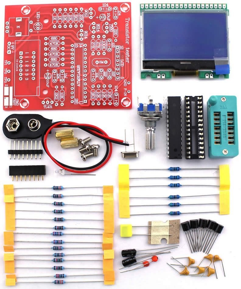

>>> (KKmoon M328 Multifunktions Transistor Tester)
Den Händler finde ich, den Bausatz nicht. Kannst du einen Link posten?

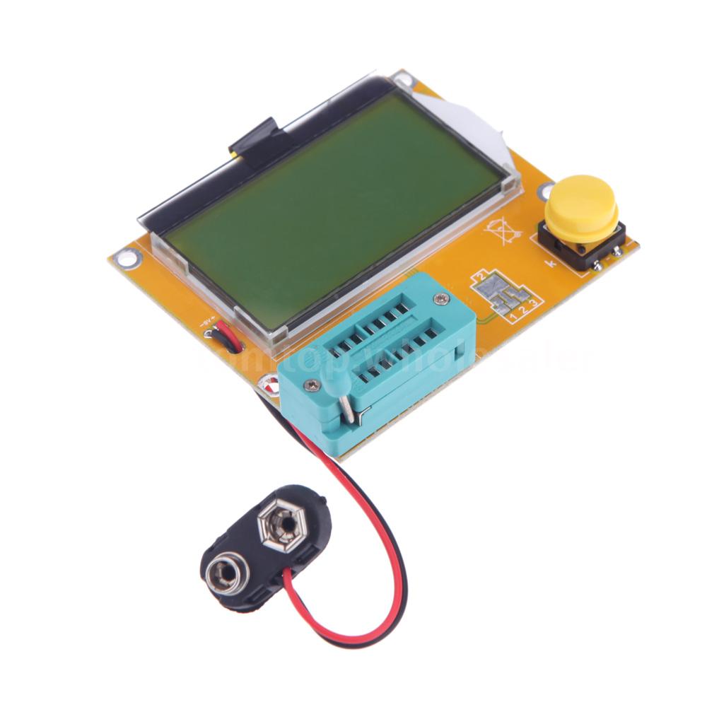

Den habe ich in ca. 5 Sekunden gefunden! http://www.amazon.de/KKmoon-Multifunktions-Transistor-Diodenkapazit%C3%A4t-Frequenzmessung/dp/B013E4L3TA Nur der Preis ist alles andere als günstig, über 23.00€ als Bausatz? Gruß Michael
#4270473
Den hatte ich auch gefunden, jedoch nicht den von derris Bild (s. o.).
Bernd schrieb: > Den hatte ich auch gefunden, jedoch nicht den von derris Bild (s. o.). 3. kleines Bild in der Bildvorschau im amazon Link oben
#4270495
Danke. Ich muss ein ernstes Wort mit meinem Blindenhund reden :)

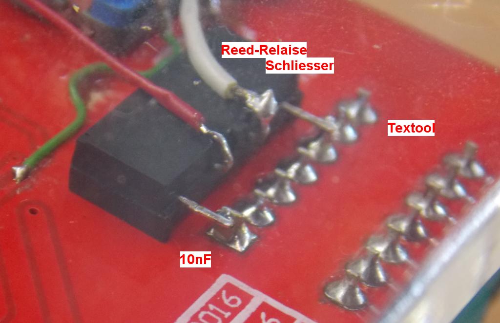

M644 chip, 82uH inductor. 1--RL--3 Revision549 inductance measurement problem? Any inductance value only shows resistance. But Revision529 no problem can be normal display
That's normal, because you have no Reference-Cap in parallel to the
Inductor! Needet for Inductor-Messurement!!!
The Reverence-Cap you have to use is the one you take vor the
Calibration!
See above my Construktion with the Reed-Relaise, that contact a 10nF-Cap
parallel to TP1 and TP3
Gruß Michael

>> Wie ändert sich die Nullkapazität denn durch Öffnen uns Schließen der
>> Textool-Kontakte?
Wenn die Kontakte geöffnet sind, wird -0,04pF und bei geschlossenen
Kontakten -0,56pF angezeigt.
Wir haben hier eine Abweichung von 0,5pF, das ist doch gar nix!
Das Relaise ist ja jetzt auch keine Kilometer vom Textool entfernt. Ich
habe extra alles nah bei einander gelötet und einen 406er Kondensator
(den man kaum sieht)verwendet. Ich denke, das man es nicht viel besser
hinbekommt.
Auf dem Display ist kaum Gezappel zu sehen, bzw. bewegen sich die Werte
im 0,5er Bereich. Ich finde das beachtlich!
Evtl. könnte man noch auf ein 2x Schliesser Relaise zurück greifen, ob
das noch Vorteile bringt, würde die Praxis zeigen.
Gruß Michael

@Karl-Heinz Kübbeler Thank you for your answer. Port is not damaged, just for fun. I tried this method. Open the 45V high voltage test regulator, turn off, test the external voltage input. Critical resistance accuracy is 0.1%. Atmega644 internal reference voltage accuracy is not too ideal. Now there is a problem I have not understand, about serial output. Makefile settings: CFLAGS = -DWITH_UART #CFLAGS = -DTQFP_ADC6 CFLAGS = -DWITH_VEXT TTL receive 115200, PD1 to RXD. GND to gnd. Serial could not receive any data. Do not know what is the problem? I have a lot of TFT serial screen, want to simply do a transfer to display more projects
Zhq S. wrote: > Makefile settings: > CFLAGS = -DWITH_UART > #CFLAGS = -DTQFP_ADC6 > CFLAGS = -DWITH_VEXT > TTL receive 115200, PD1 to RXD. GND to gnd. Serial could not receive any > data. Do not know what is the problem? I think the answer is written in your Makefile, line 204: # The WITH_UART option enables the software UART (TTL level output at Pin PC3, 26). So you should try to use PC3 on pin 26, (and not PD1 which is the TXD pin of the hardware UART). derri.
Zhq S. wrote: > Makefile settings: > CFLAGS = -DWITH_UART > #CFLAGS = -DTQFP_ADC6 > CFLAGS = -DWITH_VEXT > TTL receive 115200, PD1 to RXD. GND to gnd. Serial could not receive any > data. Do not know what is the problem? Oops, on the m644 part, PC3 is not pin 26 but at: pin 25 (DIL40 package) or pin 22 (TQFP package). pin 26 is only for the DIL28 package of m328p. derri
Zhq S. schrieb: > CFLAGS = -DWITH_UART > #CFLAGS = -DTQFP_ADC6 > CFLAGS = -DWITH_VEXT Maybe this should read

Zhq S. schrieb: > TTL receive 115200, PD1 to RXD. GND to gnd. Serial could not receive any > data. Do not know what is the problem? The ATmega644/1284 software has not initialized the serial port in the right manner. You should get data with 9600 baud at the PD1 pin with the latest developer version (SVN rev. 560). The pin number of PD1 is 15 for DIL and 10 for PLCC. SamplingADC is now enabled by default. The calibration procedure asks for a capacitor for L-measurement with the message "Cap for L meas?". You should use a capacitor value between 10nF and 20nF for future measurement of little inductances. If your coil is only detected as resistor, or with little inductance, you should connect this known capacitor (10nF-20nF) parallel to the coil and repeat the measurement. The measurement is now possible between any test ports. You can only measure little capacitors between TP1 and TP3! With samplingADC the resolution is increased to 0.01pF with a 16 MHz crystal. With a 8 MHz clock the resolution is about 0.02pF Best regards, Karl-Heinz

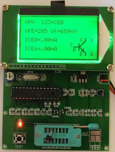

Hallo, mit einem Transistortester (Ebay, siehe Bild) habe ich Probleme. Laut Angebot soll der Tester 25 mA im Betrieb aufnehmen. Tatsächlich nimmt er 75 - 80 mA auf. Im standby sollen es gar nur 20 nA sein. Es sind jedoch satte 230 µA! Für Batteriebetrieb also völlig ungeeignet. Gemessen habe ich mit einem Multimeter. Ein Labornetzteil mit einer Ausgangsspannung von 3,7 V habe ich an den dafür vorgesehenen Anschluss (siehe Bild unten rechts) angelegt. Ist dieser Tester/dieses Problem bekannt? Gibt es eine Lösung? Uleg
#4284937
Please find enclosed the German and English embodiments of the Transistor Tester PC Software, Version 0.1, with English/German Helpfile. It will work with Firmware versions 541 up to but excluding firmware version 560. For Version 560+ its back to the workbench for me to create version 0.2 since the firmware was changed significantly. Teaser: in Ver. 02, table column hFE will be wider to accommodate Darlingtons. Anyway have fun. Yours - Messtechniker
Uleg schrieb: > Ist dieser Tester/dieses Problem bekannt? Gibt es eine Lösung? Dieser Tester ist mir nicht bekannt. Der Standby-Verbrauch könnte von einem falsch positionierten Widerstandsteiler für die Batteriespannung kommen. Die Erfassung der Batteriespannung sollte nicht an der Batterie abgegriffen werden, sondern hinter dem PNP-Schalttransistor. Für den Betriebsverbrauch kann man prüfen, ob bei vorhandener Hintergrundbeleuchtung der Strom für die LED durch größeren Vorwiderstand reduziert werden kann. Gegebenenfalls kann man auch auf die Beleuchtung ganz verzichten. Ein "beliebter" Fehler ist auch, daß die 5V Signalpegel der ATmega-Ausgänge nicht an die 3.3V Eingänge des graphischen Controllers (ST7565) angepaßt werden. Dadurch wird die Betriebsspannung des Display-Controllers auf unzulässige Werte angehoben. Verursacht wird das durch Schutzdioden an den Eingängen des 3.3V Controllers. Hier würden schon serielle Widerstände in allen LCD-Signalen Abhilfe schaffen. Alternativ könnte man die Ausgänge zum Controller auch im "Open Collector" Modus betreiben. Dabei werden die Ausgänge des ATmega nur nach 0V geschaltet (Option LCD_SPI_OPEN_COL). Dann sind aber Pull-Up Widerstände für den High Pegel erforderlich. Von der Verwendung der internen Pull-Up Widerstände wird abgeraten. Die Option PULLUP_DISABLE sollte also möglichst gesetzt bleiben.

Thanks @Karl-Heinz Kübbeler for you work.。 It's working now for serial.Very good。 GIF picture,Compare the test speed of the TP1-TP3 and the other ports. By the basis of the reference voltage, the idea is that the user defined input in the test instrument menu options, the default 2.5V programming. For example, menu - reference voltage & C(uf)-correction. The reference amount put more convenient user input in the terminal. Another thing C(uf)-correction I set +8%, 220uF test results close to the bridge measurement, whether the C compensation also need to improve it? Also revision: 560 includes the previous, LCD1602 328p display,After opening the samplingADC With, after the calibration of the measurement inductance,Calibration information will be lost

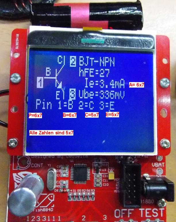

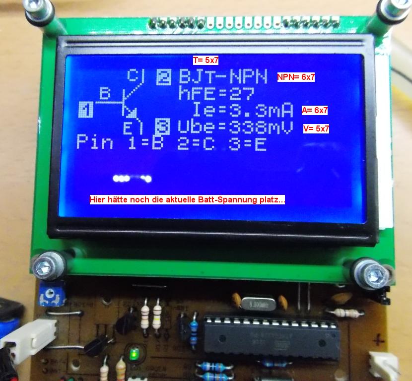

Ich möchte dem Projekt einen 5x8 Matrix-Font beisteuern. Beim 6x8 Font ist der Zeilenabstand etwas eng und stößt teilweise an die Icons insbesondere bei Transistormessung. Anbei das neue File "5x8_vertikal_LSB_1.h", welches in den Ordner "Fonts" kopiert werden muß. Des Weiteren muß noch das modifizierte Header-File "font.h" gegen das bestehende getauscht/überschrieben werden! Anbei noch ein Makefile(FISH8840) welches die Option "CFLAGS += -DFONT_5X8" beinhaltet. Die restlichen Optionen, sind dem jeweiligen Testertyp anzupassen. Viel Spaß mit der neuen Font-Option. Gruß Michael
