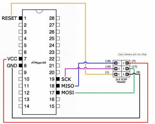

Thanks Tomas! I'm almost done building my AVR-ISP. I went for the LPT version with a SN74HC244N protection IC, and it's own socket for the ATMega, powered from +/-5V USB. Basically it's this one: http://www.scienceprog.com/avr-isp/ but i added a USB plug only for power, so to be independent from the tramsistortester. Hope that's ok for the chip, as i know USB power isn't perfect. It usually has +/- 0.3V. Another concern is regarding the GND of the ATMega chip. It has 2 GND's, and i don't know which one to use.. I see the transistor tester has a different route for each of them (they're not strapped together). For the programming, should i use the one on PIN-8 .. or the one on PIN-22 ?? Or should i strap them together? Does it even matter?! :)) Just as a curiosity, they measured 2ohms between them with my multimeter (with chip pulled out). Been working on this all night.. Hope it doesn't fry my LPT port when i plug it in :))))
Foxer A. schrieb: > Or should i strap them together? You should connect both GND pins (8 + 22) together to the 0V of your power supply. The VCC pin 7 and the AVCC pin 20 must be connected to the 5V of your supply or the voltage output of your regulator. The GND pins of the ATmega are connected internally at the chip (more than 1 Ohm), but you get wrong measurement results, if you don't connect both pins to 0V. I have even found a Arduino Uno clone with this error! Beitrag "GND Problem mit ArduinoUno Clone"
Foxer A. schrieb: > Another concern is regarding the GND of the ATMega chip. It has 2 GND's, > and i don't know which one to use.. > For the programming, should i use the one on PIN-8 .. or the one on > PIN-22 ?? > Or should i strap them together? > Does it even matter?! :)) Basically just connect only these pins of the M328: 1 - RESET 7 - VCC (+5V) 8 - GND 17 - MOSI 18 - MISO 19 - SCK And of course do not forget to use the XTAL (8MHz) on pins 9 and 10.
Tomas P. schrieb: > And of course do not forget to use the XTAL (8MHz) on pins 9 and 10. @Foxer Alex What Tomas writes is very important. The AVR chips need a clock source to do the programming job. Fuses in the AVR chip select the clock source. By default, you have an internal RC-oscillator selected as clock source. This allows you to program the chip via ISP. But once you set the Fuses to the values needed to run the Tester software, a different oscillator with an external crystal is selected as a clock source, and without the crystal between pins 9 and 10 this oscillator will not work, and the chip will look dead. So you need to add this crystal to your socket. The frequency of the crystal may be 2 to 16 MHz, with the lower values resulting in fewer errors in such simple designs. BTW, USB power should not be a problem, just add a decoupling capacitor of 0.1 to 1uF between pins 7 and 8 (Vcc and GND). Good luck. derri
@Karl-Heinz Kübbeler @Tomas P. @Marcel Derrmann Ok, so upon further inspection, my decision to program the ATMega outside of the transistortester, was a BAD decision :)) Probing the transistortester SOCKET with my multimeter, i found that: - Both GND's (pin8+pin22) are somehow connected (with a resistance of only 0.2 ohms). - Both VCC & AVCC (pin7+pin20) are also somehow connected (also with a resistance of 0.2 ohms). Also, - The board has a very nice constant 5V supply. - And it has an 8MHz crystal oscillator (on pins 9 & 10).. and i don't have another one. So because everything is already there (and i don't have another crystal), i'm gonna scrap my independent socket design; and instead, go for some flying wires on the transistortester socket to connect to the ISP interface (as Marcel suggested a few days ago). I'll maybe continue this design when i get another 8MHz crystal to use in it. Questions: :) -could the rest of the transistortester circuit interfere or be damaged, if i connect the LPT 6-pin ISP interface directly to the pins of it's socket? *** -To use the 5V power supply of the t.tester, will i have to keep the rotary encoder PRESSED while i use the ISP to program the chip?! -Marcel mentioned earlier a "6 or 10-pin ISP interface".. Does the 10-pin one have any extra features? Thanks guys!
Foxer A. schrieb: > could the rest of the transistortester circuit interfere or be damaged, > if i connect the LPT 6-pin ISP interface directly to the pins of it's > socket? Damaged, no, i don't think so. But I suspect the display might interfere, because it did during my experiments. But then I was powering the board from my USB programmer, which is not a good idea. No leads are shared between the programming header and the display. So with the native power supply of the board it should be OK. If you are in doubt, then simply remove the display during programming. > To use the 5V power supply of the t.tester, will i have to keep the > rotary encoder PRESSED while i use the ISP to program the chip?! Yes, power supply must be stable, else you will get errors. Therefore I suggest you use a switch or a jumper to bridge the switch part of the encoder. And, oh yes, you should not connect pin 2 (Vcc) of the 6 (10) pin header if you use the tester's power supply. > Does the 10-pin one have any extra features? No, it's just an other de facto standard set by Atmel. The only advantage I see is that every other pin is connected to GND or Vcc acting as a shield between active wires, so you might use a somewhat longer cable. Greetings, derri.
Marcel D. schrieb: > And, oh yes, you should not connect pin 2 (Vcc) of the 6 (10) > pin header if you use the tester's power supply. Just to make sure i understand correct: if i use this design: http://www.scienceprog.com/avr-isp/ exactly as it is here; i must NOT connect the VCC pin of the ATMega, to the VCC pin of the 74HC244 buffer chip?? (If so, why? And how will i power the 74HC244 ?)
Foxer A. schrieb: > if i use this design: http://www.scienceprog.com/avr-isp/ exactly as it > is here; i must NOT connect the VCC pin of the ATMega, to the VCC pin of > the 74HC244 buffer chip?? Sorry, I should have looked at the schematics of your programmer before spreading nonsense. You are absolutely right, with this design the HC244 gets its power from the programmed board, and thus Vcc has to be connected to pin 2 of the ISP header. And I am sure that there is no risk in doing so, because the Vcc from the computer stays isolated. Apologies, derri.
@Marcel Derrmann Ok, phew! :D The only (maybe) hazard i can see is the fact that after the two VCC's combine and pass through the LED and 1K resistor; they then connect to Pin-1 (OE) of the 74HC244, and then goes to Pin-5 (Data 3) of the computer's LPT port. I don't know how safe that design is, but no one seemed to report fried circuits or lpt ports, in the comment section of the tutorial. Also, a modification i made: i didn't extend the GND all the way to the metal body of the LPT connector.. My computer is grounded, so i don't know if it's such a good idea to connect the - (minus) of these little battery powered circuits, to actual EARTH GND.

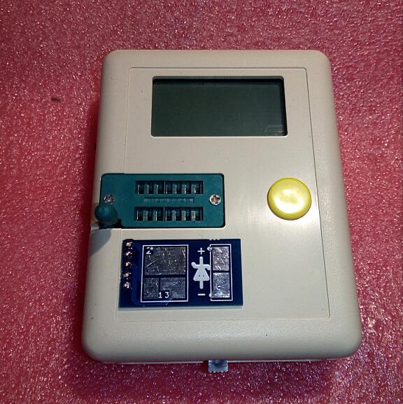

Hallo Ich habe mir diesen Bausatz gekauft Ebay 231951700622 Allerdings funktioniert es nach dem Zusammenbau nicht. Es leuchtet nur die Displaybeleuchtung solange die Taste gedrückt wird. Alles noch mal kontrolliert, aber keinen Fehler gefunden. Es sieht so aus als würde der Kontroller nicht starten. Der Kontroller ist gelockt. Eine Abfrage der Fuses ergab bei BOD undefined value:0x01 Einen neuen Kontroller programmieren ist an sich kein Problem. Allerdings weiß ich nicht welches Display das ist und welche Version ich daher laden soll. Vielleicht kann mir wer einen Tipp geben. Hubert
@Hubert G See here :) http://www.eevblog.com/forum/testgear/$20-lcr-esr-transistor-checker-project/msg969074/#msg969074
@Tomas P Danke. Neuen Kontroller geflasht und das Ding läuft. Wenn einem geholfen wird und man sich selbst auch helfen kann ist das ja auch kein Problem. Nochmal Danke Hubert
Hubert G. schrieb: > Es leuchtet nur > die Displaybeleuchtung solange die Taste gedrückt wird. Den gleichen Fehler hatte ich auch. Offensichtlich hat der Hersteller vergessen, den ATmega328P zu programmieren. Lediglich die Sicherheitsbits sind gesetzt, die das Auslesen der Software verhindern sollen. Die Unterstützung für das verdreht eingebaute Display mit ST7735 Controller habe ich in das SVN-Archiv eingebaut (Verzeichnis trunk/mega328_color_kit). Wie bereits festgestellt, sind die 680 Ohm und 470 kOhm Widerstände keine Meßwiderstände mit 0.1% Toleranz. Bei meinem Kit habe ich diese Widerstände ersetzt. Die Spannungsreferenz kann natürlich auch durch bessere ersetzt werden. Dafür ist aber das Display mit einer korrekten Pegelanpassung (5V/3.3V) versehen.
Da ich keine negative Bewertung abgeben wollte habe ich den Verkäufer angeschrieben, mal sehen ob er darauf reagiert. Auch wenn es nur ~€12,00 gekostet hat, sollte es doch funktionieren.
Hubert G. schrieb: > mal sehen ob er darauf reagiert. Das habe ich auch so gemacht. Nicht alle Nutzer können sich selbst helfen, zumal auch die ISP-Schnittstelle fehlt.

The first update in mid- 2016 circuit board version Thanks for the hard work of dear Karl-Heinz

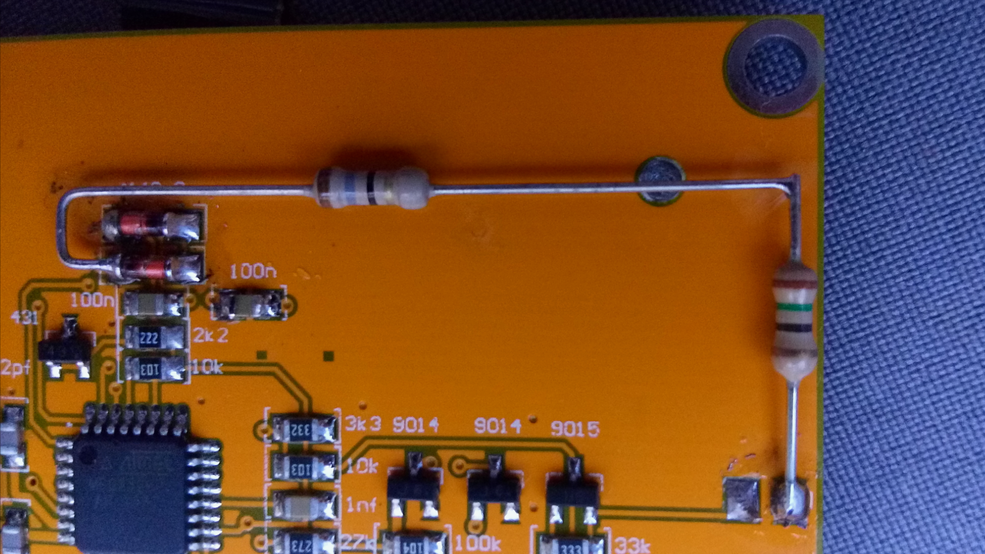

Sooo... Habe mal gemessen Obere Diode linke Seite 4,98V Untere Diode linke Seite 4,33V Verstehe ich es richtig, das der Wiederstand den du voschlägst nachzurüsten dazu dient den Strom zu erhöhen, damit der Spannungsabfall auf die gewünschten 2* 0,7V kommt??? Kannte es eigentlich nur so, dass immer je Diode 0,7V abfallen^^... Bzw 0,3V bei Germanium Dioden... (Aber bin ja auch nur Mechatroniker^^) Jedoch müsste wenn der Stromverbrauch des St7565 konstant ist Durch das nachrüsten von mehr Dioden auch die Spannung drücken lassen... Einen parallelen widerstand ist aber vllt erst einmal die bessere Lösung...
#4648604
Nebenbei... Beim starten des T4 Gerätes zeigt der display M Tester an ohne Version Ein T3 ist noch auf dem Postweg, dürfte aber denke ich nicht viel anders sein, außer dem versetzten display (Habe keine genaueren infos) Habe 9 Euro für den T4 bezahlt inklusive Acryl Gehäuse. Denke dafür kann ich ihn kaum selber aufbauen. Den T3 hatte ich vorher für 8 Euro bestellt da ich den T4 erst später gesehen hatte... Schätze aber die Arbeit sehr, die hier investiert wird für Software, Hardware und Hilfestellung
Dominic schrieb: > Durch das nachrüsten von mehr Dioden auch die Spannung drücken lassen... Es bleibt aber immer noch das Problem mit den Pull-Up Widerständen. Wenn 2 Signale mit den Widerständen auf 5V gezogen werden, fließt über die Schutzdioden an den ST7565 Eingängen ein Strom zur 3.3V Spannungsversorgung. Wenn der Strombedarf des Controllers nur im Bereich 100µA liegt, könnte selbst dieser Strom durch die Pull-Up Widerstände schon zu hoch sein. Da ist noch kein Strom über die 1N4148 Kette mitgerechnet. Man darf nicht vergessen, daß die Pull-Up Widerstände an 5V angeschlossen sind. Die Si-Dioden haben natürlich auch eine Spannungskennlinie über den Stromfluß. Bei 100µA ist die Schwellspannung einer Diode etwa bei 0.5V
#4648794
Das heißt, wie sieht dein vorschlag aus? Ein widerstand in Serie zwischen vdd und gnd? Habe mich bisher nie mit displays und deren controllern beschäftigt, von daher bin ich hier etwas raus... Du hast wie man sieht von der Materie mehr Ahnung :)... Es geht sich ja hier auch bisher nur um die Spannung am controller... An einem umflashen der Software bzw der Versuch wird wohl danach erst folgen... So wie ich das sehe gibts noch nicht viele die den t4 tester bisher haben... MfG Dominic
#4648804
Falls das mit dem widerstamd Oberhaupt was bringt... Bin etwas verwirrt :)... Hoffe stelle mich nicht doof an^^... Wünsche achonmal eine gute Nacht... :)
Dominic schrieb: > So wie ich das sehe gibts noch nicht viele die den t4 tester bisher > haben... Ich glaube schon, daß etliche T3/T4 Tester verkauft wurden. Der ST7565 Controller scheint nur deutlich robuster gegen Spannungsüberhöhung zu sein, als es das Datenblatt vermuten läßt. Es gibt wohl auch eine ST7565 kompatible Controller-Variante, die 5V Pegel an den Eingängen toleriert. Hier muß der Überspannungsschutz der Eingänge anders gelöst sein als mit einer Diode nach 3.3V . Möglicherweise sind hier mehrere Dioden in Reihe geschaltet oder auch eine 5.1V Zenerdiode nach GND. Nach meinem Kenntnisstand ist diese Version aber nicht beim T3/T4 -Tester verbaut. Dominic schrieb: > Ein widerstand in Serie zwischen vdd und gnd? Ja, wahrscheinlich am besten an der unteren Diode nachzurüsten.
