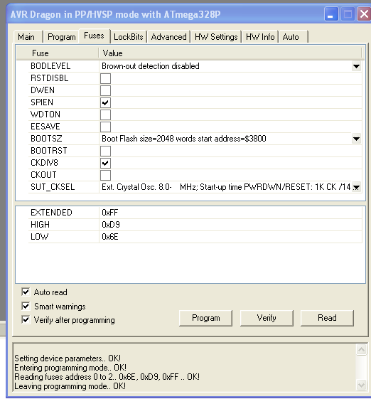

hi,
I just use usb to connect Arduino UNO R3,
& i use this makefile(in attachment) to make the source, is download
from svn.
then i got this problem when type command "make upload"
this issue compeleted output (make upload output.txt)
avrdude: 45 bytes of eeprom written
avrdude: verifying eeprom memory against ./TransistorTester.eep:
avrdude: load data eeprom data from input file ./TransistorTester.eep:
avrdude: input file ./TransistorTester.eep auto detected as Intel Hex
avrdude: input file ./TransistorTester.eep contains 45 bytes
avrdude: reading on-chip eeprom data:
Reading | ################################################## | 100%
0.15s
avrdude: verifying ...
avrdude: verification error, first mismatch at byte 0x0000
0x03 != 0x08
avrdude: verification error; content mismatch
avrdude: safemode: lfuse reads as 0
avrdude: safemode: hfuse reads as 0
avrdude: safemode: efuse reads as 0
avrdude: safemode: Fuses OK
avrdude done. Thank you.
please help me to solve this issue, thanks.
i have hardware :
Arduino UNO R3 x1
LCD LCM1602A x1
follow the document version 1.11k Figure 2.1(page 9) to build this
tester on my breadboard x1
(8.0 M Crystal Oscillator)
USB to TTL line x1
a begginer of AVR.

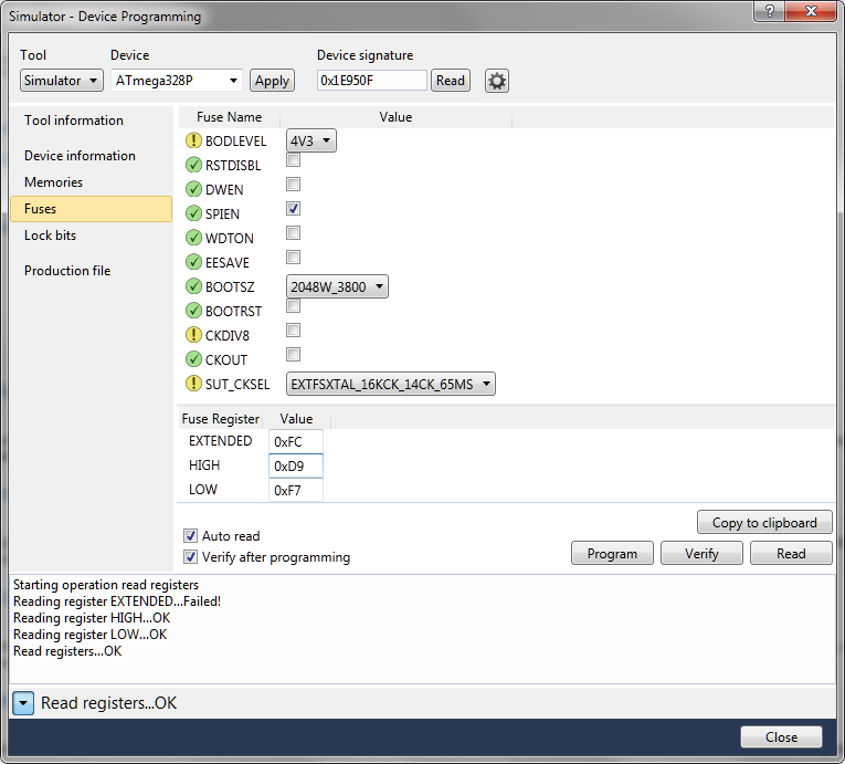

Hi, sorry for my problem & poor english again. Because i cannot find correct define about LCD monitor in the makefile, so search some define from config.h, & modify my makefile just set this 'CFLAGS += -DLCD_INTERFACE_MODE=1' about LCD monitor. ( i even try to use mega328_strip_grid, but i got the same issue =..= ) I even try to divide these schematic to several part and to do unit test. maybe like these step: 1.b block for atmel328p's control test. 2.a & b blocks for LCD monitor output test. 3.a & b & c blocks for Ardutester v07f. 4.d block use digital multimeter to check i/o voltage. These base testing got result is not bad. but ... something always got this ... but ... When i integrate these part and combine to the document version 1.11k Figure 2.1(page 9) , i got the bug when i push 'S1 Testen' button, result show on attachment image file, too. How can i get the correct compile configure and hex file, or to do other thing to get correct response ? Please help me to solve this issue, thanks again. my device : Arduino UNO R3. x1. implement the schematic with LCD LCM1602A on breadboard x1 ---- * when i tested the meter 'Ardutester v07f' that i was got lot of bug a few days ago; so, i search to got this, i think this meter maybe have good response. * because i cannot find element 'MCP1702-5002' & 'LM4040-2.5v' my market near, i replace from 'MCP1702-5002' to 'LM1117T-5' and 'LM4040-2.5v' to 'LM336-Z-2.5'. Although i think this is unimportant for LCD's bad output issue.
Robin Hsu schrieb: > How can i get the correct compile configure and hex file, or to do other > thing to get correct response ? Your picture of the circuit shows a LCD, which is not initilized. Only if all 6 signal connections of the LCD are done in the right sequence, the LCD can be initilized by the program. You should select the .hex file, which match to the sequence of your LCD connection. Only two connections are the same for the normal and strip_grid type (LCD-D6 and LCD-E). All other connections differ. You should check the connections of your LCD one by one for the selected hex file type. You can check the functionality of the test sequence by connecting a LED to any two of the three test ports. The LED should flicker sometimes during the tests. This LED test is independent of a running LCD.

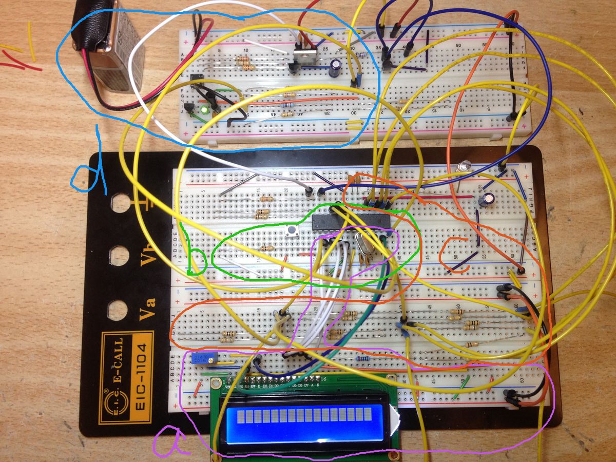

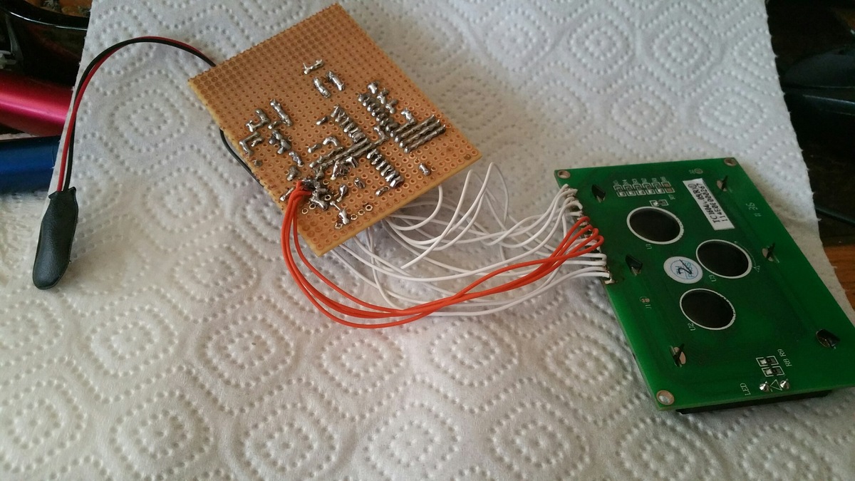

hello Karl-Heinz : > Your picture of the circuit shows a LCD, which is not initilized. Only > if all 6 signal connections of the LCD are done in the right sequence, > the LCD can be initilized by the program. You should select the .hex > file, which match to the sequence of your LCD connection. Only two > connections are the same for the normal and strip_grid type (LCD-D6 and > LCD-E). All other connections differ. You should check the connections > of your LCD one by one for the selected hex file type. > You can check the functionality of the test sequence by connecting a LED > to any two of the three test ports. The LED should flicker sometimes > during the tests. This LED test is independent of a running LCD. Thank you for your support. When i use a LED connect to probe pin TP1 & TP3 then push the button 'Test', i got the result is : nothing to happen. that is bad result really. >"< So, i think this implement just got a unknown result for me. I mean to be of the opinion that 1. i connect to error pinout from atmage328p to other elements. 2. my atmega328p on the breadboard has something mistaken. So, i must to confirm where is this mistake from above list. Because the document version 1.11k Figure 2.1 's schematic almost same the 'Ardutester v07f'; i want to modify a few pinout that compatible with 1.11k Figure 2.1. a. on 'Ardutester v07f', atmage328p's pin 27,28 is unused, so i do nothing. b. on 'Ardutester v07f', the power supply isn't need 'S1 Test' button, it must keep conduction, so i use a wire to short circuit it. c. on 'Ardutester v07f', use atmage328p's pin 26 to trigger testing from push a button; but i have not button anymore, so i use a wire to short circuit it to GROUND when i want to tesing. 4. modify the pinout define from his soruce for LCD connection ,let it compatible with 1.11k Figure 2.1. :
1 | |
I take a picture for this response. The response maybe can inference, these pinout connect with atmage328p is correct to working. So, something is wrong from atmega328p in my mind ? maybe, it's i upload once the bootloader of Arduino UNO R3 to this atmega328p ? or i used 'make upload' always setting wrong parameters ? like must setting fuse ? or others ? Thanks a lot for your help again.
Robin Hsu schrieb: > maybe, it's i upload once the bootloader of Arduino UNO R3 to this > atmega328p ? Hello Robin! Why don't you use the standard configuration for the LCD connection? The signals PD0 (RxD) and PD1 (TxD) are used for LCD-D4 and LCD-D5 connection in this case. You can simply add a resistor (>1k) to the connection of PD0 to your Tx0 output at JP2-2 to prevent a short between two output signals. The bootloader starts with every power up and starts the normal program, if there is no input detected (timeout). During normal operation of the tester nothing is connected at JP2. The PC3 pin is used as serial output if enabled so in the Makefile. What do you decide with a switch connected to PC3? The key signal should be connected to PD7. Without the power off logic, you can pull the signal down to GND with the key, but a pull-up resistor is also required. You should only change the pin assignment, if there is a reason to do so. You should remember for correct operation of the AUTOSCALE_ADC function, that you have to change the capacitor at the AREF pin to 1nF or you must remove the NO_AREF_CAP option in the Makefile.

Hello Karl-Heinz : I has still problem ... =..= I tried to modify define from makefile about i understand; but i cannot get correct response at LED that is connected to TP1 and TP2 ports for test, and LCD was display nothing as usual. Worth to talk about when i push test button then LCD backlight is on, and quit it then LCD backlight is off; this status just only circular when i push button. Apart from this how can i verify the hex is work correctly ? I try also the Markus's software 'ComponentTester-classic-1.19m.tgz' and modify some pinout for LCD; but i got the same result. =..= (http://www.mikrocontroller.net/svnbrowser/transistortester/Software/Markus/ComponentTester-classic-1.19m.tgz ) So .... maybe i used these materials cannot output accurate voltage, or must at somewhere must output key voltage ? * copy schematic from someone and change 3 materials different with the document version 1.11k Figure 2.1, because i cannot find these at electronic materials store. * My 9v battery just output 8.6v now, output from LM1117 output pin is 4.8v. Thank you. ---- Robin Hsu is a begginer of AVR.
Robin Hsu schrieb: > Worth to talk about when i push test button then LCD backlight is on, > and quit it then LCD backlight is off; Thw VCC power can only continue, if the PD6 output is set to high state. This is one of the first instructions of the tester program. If your tester does not hold the voltage in the on state with PD6, the program is probably not written correctly. Probably the flash is cleared again by writing the EEprom data or something like that. You should try to verify the program data after the EEprom is written. By the way, you should add a capacitor with at least 10uF at the VCC side of your regulator. Only two 100nF capacitors are too less to block the voltage correctly.

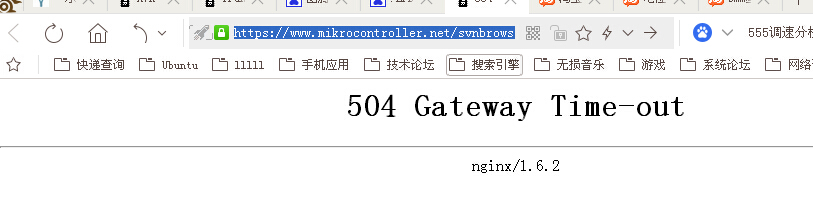

somethings wrong with svn.

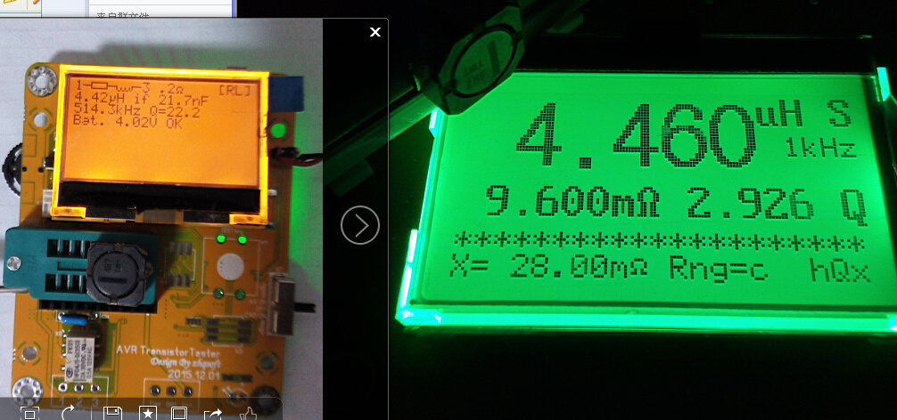

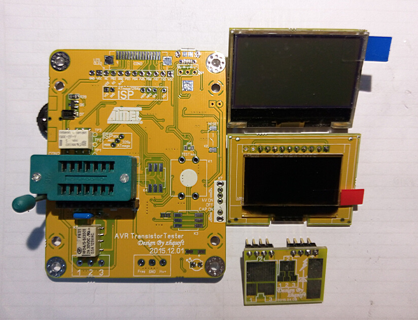

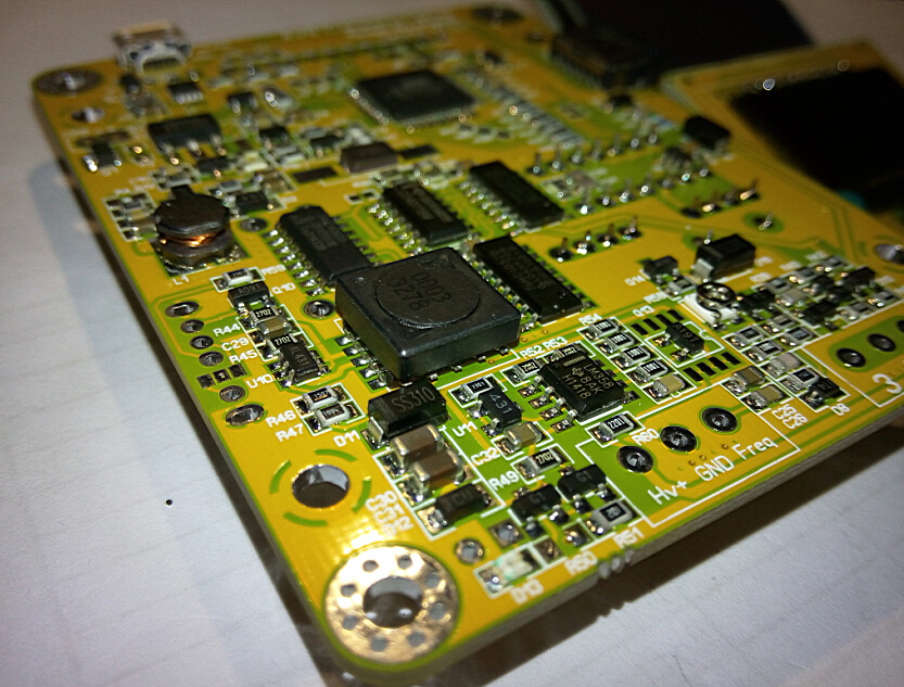

Experienced 6 revision and update, this version I am quite satisfied with. Supports 2 types of screen, including 2 LCD screen, 1 standard OLED screen. 1: lithium battery powered, 1A charging, microUSB through special adapter line output TTL. 2: voltage regulator, 5mA current source test, 40V (maximum 50V) maximum test range. 3: single key test, the side increase encoder, select menu more convenient, compatible with key functions. 4: test fixture and patch testing board, set aside all the ports, to facilitate their further increase the fixture. 5: small inductance measurement options. Open the high voltage and load the 22nf capacitor through a 3 switch selector. After loading to the TP1&TP3 by a two way relay, there is no residual capacitance effect after closing. 6: the critical position resistance 0.1%, the other is 1%. System VCC voltage regulator chip SPX2954, the benchmark voltage chip accuracy 0.1%. 7:TP1&TP2&TP3 port relay protection.
@Zhq S. Experienced 6 revision and update... Saubere Arbeit, Respekt! Thumbs up! Gruß Michael

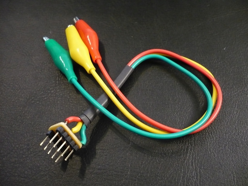

bianchifan schrieb: > Auch diesmal "Verlängerte" ich die Krokokabel mit den Messstrippen, > leider erschien im Display nur ein "?", der Widerstand wurde nicht > erkannt. Bei längeren Meßstrippen kann das Problem des Nichterkennens von Bauteilen auch an Störfeldern liegen, die durch die Antennenwirkung der langen Meßstrippen eingekoppelt werden. bianchifan schrieb: > Ein testweise angeschlossenes Paar Billigstmesskabel (ca. 50 cm) brachte > nach 2 oder 3 sec Bedenkzeit einen Wert zur Anzeige, allerdings kam es > bereits nach wenigen Messungen zum Reset. Bei sporadischen Resets könnte die Stromversorgung die Ursache sein. Um diese Ursache für einen Test auszuschließen, kann man die "Brown Out" Überwachung durch Ändern der Extended Fuse (BODLEVEL) abschalten. Wenn nach Abschaltung der Brown Out Überwachung kein Reset auftritt, sollte man die Abblockung der VCC (AVCC) Spannung verbessern und danach, um die Wirkung zu überprüfen, die Brown Out Überwachung wieder einschalten.

Hallo, bin am Verzweifeln versuche den Tester mit AtMega238p aufzubauen, Schaltung ist fertig, aber am LCD hängt seit Wochen dauerlesen Testen umschreiben versuchen, halt alles! Displays habe ich glaube ich inzwischen nur Mist!? DG-14032 (P368D) Tut aber nur eine Zeile, megabreiter Cursor, fast nicht lesbar! DV-20208 (P365A) tat mal Kurz! seit ich den Wert für die Capazität in der Make angeglichen habe, ich hatte es Versucht, nur noch Balken auch nach der Einstellung des alten Wertes! TC1604A-05 Tat einmal kurz seitdem nur noch komische Symbole in Zwei Zeilen. Data Vision P206 naja lassen wirs am besten sein, Touchscreen Grafisch oder Text wie ich herausgefunden habe... LCD-12232-4 macht garnichts, außer sporadisch auftauchender Linie die mal hier und da auftaucht! Und wenn der irgendwie Läuft stimmt die Capazität nicht, statt 100nf sind es 10,54 nf oder statt 470 mükro f sind es 47,00 hmmm..... Die spannungsmessung das er nur Batteriespannung bei realen 9V 4,8V anzeigt und meckert hab ich hinbekommen, aber an allem anderen hackt es, vor allem am Display, ich bekomm das nicht hin das es mit meinem Zeugs läuft, hab halt bei Pollin tief ins Klo gegriffen. nzwischen hab ich das unbeschreiblich starke verlangen das Ding in die Tonne zu treten, weil es nichts wird, auch wenn ich LCD Routinen versuche einzubauen, hilft auch nichts, oder nach dem Datenblatt für das TC1604A-05 die Zeichen von Hand generiere und in der entsprechenden Datei abändere oder auch eine eigene neue mit passendem Namen aufbaue und aufrufe ändert garnichts, vorallem gibt es nur A bis Z Groß und klein, und Omega Diode 1 und 2 u.s.w. aber der Rest was ist das die Suche nach einem Programm um mir die Werte auf einem Simuliertem Raster anzuzeigen hat auch nicht geklappt, alles fürt nirgendwo hin, und keine Lösung Funktioniert, Der Test Ordner ist megagroß zig varianten und Versuche und zusatz .c und .h dateien und vergebliche versuche die AVGCC abzudaten, danach hagelte es nur noch Fehler andere als vorher wo ein Update verlangt wurde, nach dem ich die LCD Routinen von Peter f. eingebaut habe, aber ständig Fehler, viele habe ich alleine geschafft zu beseitigen aber an einer LCD Routines.o hat es am ende dann gehangen, also hab ich alles deinstalliert und wieder von vorne, und heute wieder nach nur 5 Stunden versuchen und schreiben incl. Testen schreib ich hier was ja eh einen Sinn hat da ich eh immer nur verarscht werde, egal um was es geht! Naja egal ich hoffe ja glaube aber kaum das mir jemand hilft? LG
#4406878
Michael H. schrieb: > bin am Verzweifeln versuche den Tester mit AtMega238p aufzubauen, > Schaltung ist fertig, aber am LCD hängt seit Wochen dauerlesen Testen > umschreiben versuchen, halt alles! Zeig doch mal ein Bild (Foto) von Deinem Aufbau. Wenn es bei sovielen Displays nichts richtig wird, scheint es ein Grundlegendes Problem zu geben. Ich habe mir einen Bausatz aus China aufgebaut, der auf Anhieb funktioniert hat. Seitdem herrscht Ordnung in der Bastelkiste... Jan
Michael Haußmann (der_kochloeffel) schrieb: > Hallo, bin am Verzweifeln ... Uff, das ist ja ein Sack voll Probleme auf einmal! Welche Sourcen benutzt Du, die von a) Markus - SVN [transistortester]/Software/Markus b) Karl-Heinz - SVN [transistortester]/Software/tags oder c) SVN [transistortester]/Software/trunk d) selbstgeschriebene ? Was deine Displays anbelangt, so waren die Typen mir unbekannt, ich habe aber eine gut dokumentierte Seite gefunden: < http://www.spurtikus.de/basteln/pollin-lcd-roundup/ > Falls Du sie nicht kennst, dann ist sie jedenfalls einen Besuch wert. Aber wildes Herumprobieren hilft wohl nicht. Zuerst musst Du sicherstellen, dass die Hardware OK ist, d.H.: - Stromversorgung 5V messen, auch im Betrieb - Betriebsspannungen sauber und korrekt abblocken (100nF ker. mit kurzen Beinen - Taktfrequenz AtMega238p muss exakt 8MHz sein, die Fehlmessungen mit Kondensatoren deuten auf eine falsche oder unstabile Taktfrequenz. - sind die Fuses im AtMega238p richtig gesetzt? falss ja, versuchsweise Brown-out Detektor abschalten oder Schwelle herabsetzen (Siehe Beitrag kubi48). Ausserdem findest Du hier im Forum noch viele Tips (ja, es ist sehr, sehr umfangreich, aber mit der Anzeige auf "alles" und den richtigen Suchbegriffen im Browser wird man schnell fündig). Zum Display: Die meisten deiner Displays benutzen exotische Kontroller, sie sind mit der Standardsoftware nicht kompatibel. Eine brauchbare Lösung ist das TC1604A, es hat einen HD47780-Kontroller und arbeitet mit 5V. Für ein ähnliches Display (2 Zeilen / 16 Spalten) gibt es in der Standardsoftware > SVN [transistortester]/Software/Markus/ComponentTester-classic-1.20m.tgz > entsprechend konfigurierte Sources. Der LCD-Treiber HD47780.c / HD47780.h muss eventuell für deine Anzeige mit 4 Zeilen zu 16 Spalten angepasst werden, dann sollte das Programm schon mal was tun. Wenn diese Konfiguration dann erst mal läuft, hast Du eine gute Basis für weitere Anpassungen. Viel Glück, derri.
Jan schrieb: > Michael H. schrieb: >> bin am Verzweifeln versuche den Tester mit AtMega238p aufzubauen, >> Schaltung ist fertig, aber am LCD hängt seit Wochen dauerlesen Testen >> umschreiben versuchen, halt alles! > Zeig doch mal ein Bild (Foto) von Deinem Aufbau. > Wenn es bei sovielen Displays nichts richtig wird, scheint es ein > Grundlegendes Problem zu geben. > > Ich habe mir einen Bausatz aus China aufgebaut, der auf Anhieb > funktioniert hat. Seitdem herrscht Ordnung in der Bastelkiste... > > Jan Jetzt gibts was zu lachen, ist aber 1:1 nach Schaltbild, Bei Version 1 ist das 4 Zeilige Text Display nun dranngelötet, baugleich zu Version 2, bis auf die 2,5V Spannungsref. und ja es war schaut so aus als ob ich vor 2 oder 3 Jahren schon mal versucht hab den Tester nachzubauen. Wie doch die Zeit vergeht. Meine Nachbauten sind auf Lochraster, mit Zinnbahnen und Kabel, aus Mangel an Farben ist es nun recht Monoton auf meinem neuen Nachbau. Werde ja sowieso nur ausgelacht, was solls, ist wie immer, bin es ja gewohnt, ja kauf dir doch einen und s weiter, du kannst das nicht vergiss es und so weiter...
Michael H. schrieb: > Und wenn der irgendwie Läuft stimmt die Capazität nicht, statt 100nf > sind es 10,54 nf oder statt 470 mükro f sind es 47,00 hmmm..... Die falsche Kapazitätsanzeige liegt sehr wahrscheinlich an der falschen Taktrate des Prozessors. Wenn die Fuses des ATmega nicht gesetzt sind, läuft der Prozessor auf 1 MHz Takt. Die Software geht aber im Regelfall von einem 8 MHz Takt aus. Wählbar ist in der Software (Makefile) auch ein Betrieb mit 1 MHz oder 16 MHz. Warum allerdings nicht wenigstens die TC 1604 oder DV 20208 Module laufen, ist schwer zu sagen. Mindestens die erste Zeile sollte eigentlich korrekt dargestellt werden. Bei den 2. bis 4. Zeilen gibt es unterschiedliche Zuordnung des Zeilenanfangs zur DD-RAM Adresse.
Marcel D. schrieb: > Michael Haußmann (der_kochloeffel) schrieb: > >> Hallo, bin am Verzweifeln ... > > Uff, das ist ja ein Sack voll Probleme auf einmal! > > Welche Sourcen benutzt Du, die von > > a) Markus - SVN [transistortester]/Software/Markus > b) Karl-Heinz - SVN [transistortester]/Software/tags oder > c) SVN [transistortester]/Software/trunk > d) selbstgeschriebene ? > a, b, c, d (gleich Mischung aus a, b, c, Routinen aus dem Netz, oder von hier. @Marcel > Was deine Displays anbelangt, so waren die Typen mir unbekannt, ich habe > aber eine gut dokumentierte Seite gefunden: > < http://www.spurtikus.de/basteln/pollin-lcd-roundup/ > Ja habe ich Versucht, das Vierzeilige 1604 hatte mal zwischendurch auf Zeile 1 und 3 Text angezeigt, nach geringer änderung nur noch Komische Symbole oder Zwei Schwarze Balken, schaffe es nicht mehr ein einziges vernünftiges Zeichen aus dem 1604 herauszubekommen. > > Falls Du sie nicht kennst, dann ist sie jedenfalls einen Besuch wert. > > Aber wildes Herumprobieren hilft wohl nicht. Zuerst musst Du > sicherstellen, dass die Hardware OK ist, d.H.: > - Stromversorgung 5V messen, auch im Betrieb > - Betriebsspannungen sauber und korrekt abblocken (100nF ker. mit kurzen > Beinen > - Taktfrequenz AtMega238p muss exakt 8MHz sein, die Fehlmessungen mit > Kondensatoren deuten auf eine falsche oder unstabile Taktfrequenz. > - sind die Fuses im AtMega238p richtig gesetzt? falss ja, versuchsweise > Brown-out Detektor abschalten oder Schwelle herabsetzen (Siehe Beitrag > kubi48). > Ja Hardware ist okay auch wenn die Zwei nachbauten echt unübersichtlich Wild aussehen, aber die sind völlig Okay, sag ja zuerst Zwei Zeilen Textdisplay, das zwar anging und den Text recht zusammengestückelt anzeigte, dann das vierzeilige 1604 das auf Zeile 1 und 3 den Text anzeigte, und irgendwie fehlte das was, weil wenn der sich Calibrieren wollte hat der zum anzeigen was ich machen soll, ein paar Minuten gebraucht. und ging nachdem ich die Brücke gesteckt habe einfach aus, nach neustart das selbe. > Ausserdem findest Du hier im Forum noch viele Tips (ja, es ist sehr, > sehr umfangreich, aber mit der Anzeige auf "alles" und den richtigen > Suchbegriffen im Browser wird man schnell fündig). Welches sind die Zauberworte, den Thread habe ich schon zigmal durch, ich heule fast wenn ich Bilder von dem Tester sehe mit einem Graphikdisplay wo er so schön die Werte und die abbildung des Bauteils anzeigt, das aber ist mir dank meines schrott's von Display den ich habe vorenthalten. > > Zum Display: > Die meisten deiner Displays benutzen exotische Kontroller, sie sind mit > der Standardsoftware nicht kompatibel. Eine brauchbare Lösung ist das > TC1604A, es hat einen HD47780-Kontroller und arbeitet mit 5V. > > Für ein ähnliches Display (2 Zeilen / 16 Spalten) gibt es in der > Standardsoftware > SVN > [transistortester]/Software/Markus/ComponentTester-classic-1.20m.tgz > > entsprechend konfigurierte Sources. Der LCD-Treiber HD47780.c / > HD47780.h muss eventuell für deine Anzeige mit 4 Zeilen zu 16 Spalten > angepasst werden, dann sollte das Programm schon mal was tun. > > Wenn diese Konfiguration dann erst mal läuft, hast Du eine gute Basis > für weitere Anpassungen. > > Viel Glück, derri. Ja das 140x32 (DG-14032 (P368D)) Grafikdisplay zeigt sehr abgehakten Text an, ich schaffe es nicht und weis auch erlich nicht wie ich dem Tester beibringen soll wie die Resolution (auflösung) vom Display ist, zeigt Text in nur einer Zeile an, Zeite Zeile Leer, optisch gleich wie das Zweizeilige 2 x 16 Zeichen DV-20208 (P365A) an aber halt nur die obere Zeile, das umschreiben hat nichts genützt, Dateien gelöscht und Orginal wieder hergestellt, dann alle Hoffnung in das DV-20208 (P365A) gesteckt, und an dem getestet, da ja das Vierzeilige TC1604A-05 auch mal mit dem Mega den ich für das DV-20208 auf dem Chip hatte angesprungen ist habe ich zurzeit genau das drauf, es kommen die Balken auf dem Foto, aber nur etwa 1 Sec, danach nichts mehr, und nach ner weile schaltet er selbstständig wieder aus, das machen beide nachbauten des Testers. Gebruzzelt wird mit Drachen und AVR Studio4 nachdem die 5.xx und 6.xx nicht so gut laufen wie die 4.xx. Winavr die Aktuellste Version, Makefiles mit dem Programers Editor von Winavr. Hab Adapterplatinen für den Dragon gebaut ein Bild mit der die für den 328P ist sende ich als Anhang. Es darf nun gespottet werden! Werde einfach mal Sparen und mir nen Chinanachbau kaufen müssen, weil ich nicht die Kohle hab um mir ein Brauchbares Display zu Leisten, also hat es ja keinen Sinn. Was mir allerdings garnicht in den Kopf will, es hatte ja zwischendurch Funktioniert, und durch umschreiben habe ich die Falschmessung der Batteriespannung in den griff bekommen, aber als ich heute Morgen noch dachte, also der Kondensatortestwert, stimmt ja hinten und vorne nicht, war das das letzte das ich in Drei Schritten ausprobierte, Schritt 1 war Wert verzehnfachen, im Make steht ja wie man es macht drinn, größerer wert kleinere ausgegebene Werte, anders Logischerweise größere Werte, aber als ich zuerst aus ner 12 ne 1 machte ging nix mehr beim Display, was hat denn das mit dem Display zu tun dachte ich... und habe dann ne 10 draus gemacht, nix, alles gleich, also wieder ne 12, aber nichts geht mehr, nur noch eine Zeile Dunkle Balken und so ist es, da ich total Verzeifelt bin, hatte ich die Dumme Idee ich schreib von meinen Problemen, was sicher keine gute Idee war, weil ich erlich gesagt nicht Programieren also Schreiben kann, ich schaffe es komischerweise zeugs umzuschreiben, aber weis selbst nicht wie ich was ganz eigenes erschaffen kann, oder ich kann was kombinieren, egal interesiert eh keinen, ich bin nun mal der Typ der ständig verspottet wird, ind der keinen Titel in irgeneiner Form hat, egal, ich sollte aufhören zu nerven und einfach auf den CHinatester Sparen wenn es den vieleicht dann och gibt weil die Displays haben ja nach oben keine Grenzen, und nachdem ich derartig mit HD kompatiebel und Grafikdisplay und ST irgendwas Kompatibel auf die Schnauze gefallen bin macht es keinen Sinn ein Display zu suchen das vieleicht mit dem Tester auch irgendwie wenigstens ein wenig harmoniert. LG
8 Mhz Quarz bei beiden, oder soll ich nen 16Mhz reinhauen, hatte ich vor nem Monat auch besorgt? Im Make file wie auch in der Hardware habe ich 8 Mhz angegeben und Fuses auf Ext.Clock hatte auch Ext. 8 Mhz und die oberste mit ner 0 drinn versucht.
Michael Haußmann (der_kochloeffel) Hallo, Wie gesagt, mit der Software aus dem SVN ist der 8 MHz-Quarz korrekt (16 MHz geht nur mit entsprechenden Anpassungen). Aber aus Deinen Bildern sehe ich, dass die Fuses falsch gesetzt sind. Du benutzt "externe Taktquelle", was bedeutet, dass man eine Taktquelle mit der entsprechenden Frequenz an Pin 9 anlegen muss. In unserem Fall ist aber Xtal Oscillator gefordert! (siehe Bild). Ich benutze auch den Dragon mit Atmel-Studio (mittlerweile Version 7), und deshalb kann ich mit Sicherheit sagen, dass folgende Werte richtig sind: extended fuses: 0xfc high fuses: 0xd9 low fuses: 0xf7 Schreib das mal Deinem ATmega hinter die Ohren (;-), dann sieht die Welt schon ganz anders aus! Und dann probier eine bewährte Software aus, bevor Du eigene Änderungen versuchst. Wie gesagt, Du brauchst eine gesunde Basis zum Experimentieren. Und immer nur eine Änderung zugleich vornehmen, sonst kannst Du ja nicht feststellen, welche Änderung was gebracht hat. Und dann mach Dich nicht selber mies! Jeder hat mal klein angefangen, und aus Fehlern lernt man am meisten. So wie Dein Prototyp aussieht, seh ich gute Chancen, dass Du das Ding zum Laufen bringst. Du musst halt nur lernen, systematisch vorzugehen. Und das bedeutet, zuerst die Hardware kontrollieren, bevor man an der Software herumdoktert. Die beste Software kann nicht fehlerfrei auf einer fehlerbehafteten Hardware oder auf einem System mit mangelhafter Stromversorgung laufen. Also fang mit einer bewährten Software an, und passe sie dann, falls nötig, Schritt für Schritt an. Nur Mut! Zum Schluss ein paar Zauberworte: fuses, display, brown-out, ad-wandler, referenz, usw. Gruss, derri
#4407125
Hallo, also mit den Fuses geht garnichts geht sofort aus wenn ich den Test Taster loslasse, wenn ich drauf bleibe sehe ich mit dem ST7565 aus dem 111 Ordner nur einen Balken in Zeile 1 und 3 wenn ich den Taster loslasse ist alles sofort aus! >extended fuses: 0xfc >high fuses: 0xd9 >low fuses: 0xf7 LG.
Der Kochlöffel schrieb: > wenn ich den Taster > loslasse ist alles sofort aus! Dann läuft der Quarzbetrieb nicht! Bitte den Anschluß des Quarzes an Pin 9+10 des ATmega überprüfen. Im Zweifelsfalle ist es besser, wenn keine 22pF Kondensatoren angeschlossen sind anstatt zu große Kapazitätswerte! Mit 22nF kann der Quarz nicht schwingen.
#4407351
warum geht seit ich die fuses geändert habe auf einmal der quarz nicht mehr, also an der Hardware hat sich absolut nichts verändert, der quarz ist da wo er immer ist, außer er ist zufällig in dem Moment drauf gegamgen nachdem ich die Ändeung gemacht habe?
#4407357
Der Hardwareaufbau sieht doch - den Umständen entsprechend - ganz ordentlich aus. Bunte Drähte helfen bei der Fehlersuche, aber das hast Du ja schon erkannt. Immerhin ist es kein Breadboardaufbau, wo man schnell mal einen Wackelkontakt hat, oder der Draht rausrutscht und falsch zurückgesteckt wird. Hast Du ein Multimeter zur Verfügung? Jetzt müssen die Versorgungsspannung geprüft werden und wenn möglich die richtige Taktfrequenz. Zu den Fuses kamen ja schon eine Menge Hinweise. Wenn die Frequenz falsch ist, läuft die Displayinitialisierung und die Messung nicht richtig. Außerdem würde ich mich erstmal auf ein Display und eine Firmware eingrenzen. Sonst gibt es zuviele unabhängige Variablen und die Zahl der Fehlermöglichkeiten potenziert sich. Jan
#4407377
geht garnicht mehr irgendwas an den Fuses gefällt dem Ding scheinbar nicht da absolut nichts geht, power solange ich den test drücke danach ist es Off ausgeschaltet und zwar selbsttätig und sofort, vileicht sollte ich es besser sein lassen?
Der Kochlöffel schrieb: > power solange ich den test drücke Könnte beim Umsetzen der Fuses der Chip ausversehen komplett gelöscht worden sein? Dann bleibt der Tester auch nicht an weil PD6 nicht auf 1 geschaltet wird. Das gleiche passiert auch, wenn der Quarz nicht schwingt weil dann der Prozessor nicht startet. Ein Verify des Flash Speichers schafft Klarheit.
#4407424
Hallo nochmal, also nun Fuses Brownout off und Ext 8 Mhz gewählt und er bleibt wieder an, so sieht der Text beim 4 Zeiligen Display nun aus, besser bekomm ich das nicht Zweite Zeile Sumerische beschwöhrungszeichen? unlesbar, das Ding hatte tatsächlich einmal Text angezeigt, vieleicht hab ich auch schon Wahnvorstellungen. Ach ja warum geht bei egal welchem Programm garnichts mehr wenn ich nur Ext Osc. einstelle, immer nur wenn ich den Externen Quarz genau gleich wie in der Ext. angabe habe Funktioniert es, und warum sollte ich es vorher so Merkwürdig einstellen? gibt es gründe dafür, liegt das an meinem Studio, oder was weis ich wo sonst drann??
#4407428
Karl-Heinz K. schrieb: > Der Kochlöffel schrieb: >> power solange ich den test drücke > > Könnte beim Umsetzen der Fuses der Chip ausversehen komplett gelöscht > worden sein? Dann bleibt der Tester auch nicht an weil PD6 nicht auf 1 > geschaltet wird. Das gleiche passiert auch, wenn der Quarz nicht > schwingt weil dann der Prozessor nicht startet. Ein Verify des Flash > Speichers schafft Klarheit. Den Verifi mach ich bei jedem Brennen, beim Flash und beim Eeprom!
Die zwei ker Kos könnten schon 22pf sein, aber mit den 2 x-cm langen Drähten zwischen uC und Quarz wird das nix. Und war da nicht mal was mit unbedingt rote LED wegen Haltespannung? Mir sieht die LED weiss aus.
hab zwei beim einen quarz nachgerüstet an kabeln beim anderen nicht, beim Zweiten neueren Nachbau ist der Quarz direkt am Controller! da gibts trotzem Problemehab auf beidem rumprobiert der hier hat halt das 4 Zeilen Display, und jetzt ne erliche Antwort kann das TC1604A-05 überhaupt am Tester Funktionieren, und wenn ja hat jemand nen Tip oder ne Hilfe für mich, wenn nein dann hat es sich erledigt, denke ich mal! Oder eins der anderen Displays die ich habe????

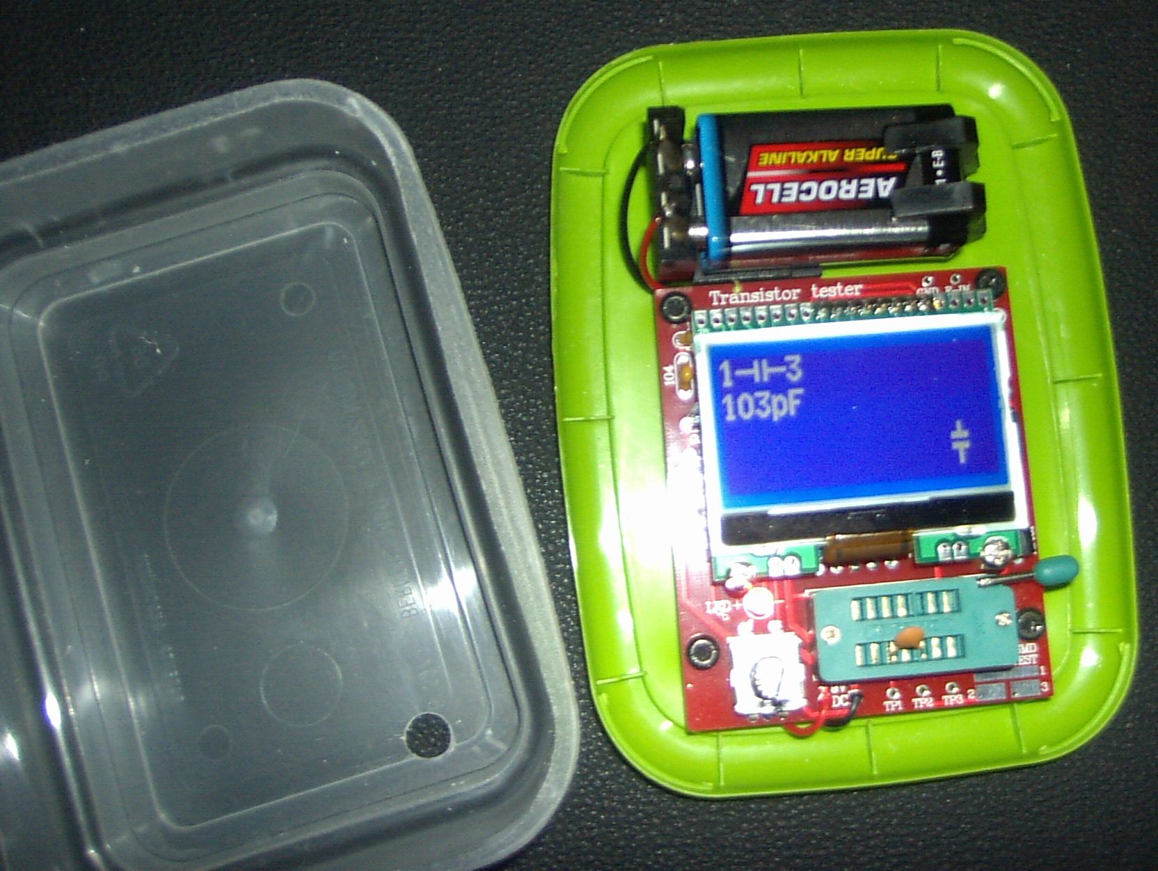

HNY an alle ! Hier mal ein Gehäusetipp von mir. Modefizierte Salatdose. Tester ist geschützt und rundherum zugänglich.

Hello again! I made a breadboard version of Transistor tester with m328p and 20x4 LCD display and burned the 1.12k FW. Seems to work "properly", but there is this problem: the characters for "omega" and "miu" (u) displayed on the LCD aren't the right ones for the job. What can be done to correct this situation? In older versions of software, there was the possibility to edit the line " #define LCD_CHAR_OMEGA 244 //Omega-character" in the "lcd-routines.h" file, but now that file don't include such a line. I browsed/searched into other files in the source code and didn't find yet such a line to edit. So, would you, please, point to the right file/line to edit? Another problem is about the possibility for me to edit in the source code and put the measured values (with DMM) for the 680 ohm and 470Kohm resistors, in order to improve the precision of the tester? Where can this be done? P.S.: I tried editing the line cpi r17, LCD_CHAR_OMEGA ; 222 in the "lcd-routines.S" file (222 would be the right code for omega on my LCD) and recompiled everything, but the problem remains the same. Thanks! Felix
#4429251
Edit: Muss man WinAVR-20100110 parallel zu AVR Studio installiert haben damit das mit der Toolchain funktioniert(hab grad mal "AVR GCC Plug-in Help" geworfen). Ich ging davon aus das man nur die aktuelle Toolchain braucht. Aber scheinbar baut das AVR Studio die Toolchain erst auf? "The plug-in component will automatically detect an installed WinAVR distribution and set up the required tools accordingly. " Das würde dann auch den komischen Bug mit dem Haken erklären und warum kein Toolchain Ordner vorhanden war. @ Karl-Heinz Kübbeler Danke für den Tipp mit dem 470k Widerstand zwischen PB1 und PC0. Ich werde das gleich mal nachmessen.
Felix Ratescu schrieb: > the characters for > "omega" and "miu" (u) displayed on the LCD aren't the right ones for the > job. Please use the option "CFLAGS += -DLCD_CYRILLIC" in the Makefile, if there is a problem with the omega and miu characters. With this option software defined characters are used.
#4429275
