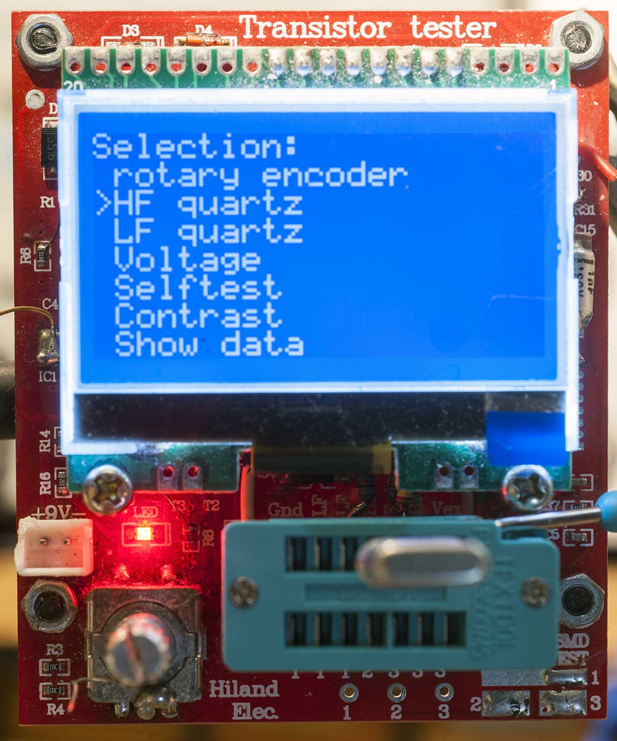

I find it useful when I am new to a protocol to get a quick glimpse of
how the data is encoded.
I find it useful, and I would appreciate if you share the code so that
the firmware developers can pick up.
That is "hacky thinking" also: Do not assume the usefulness of a
feature, because someone else might find a use you never could think of.
Regards!

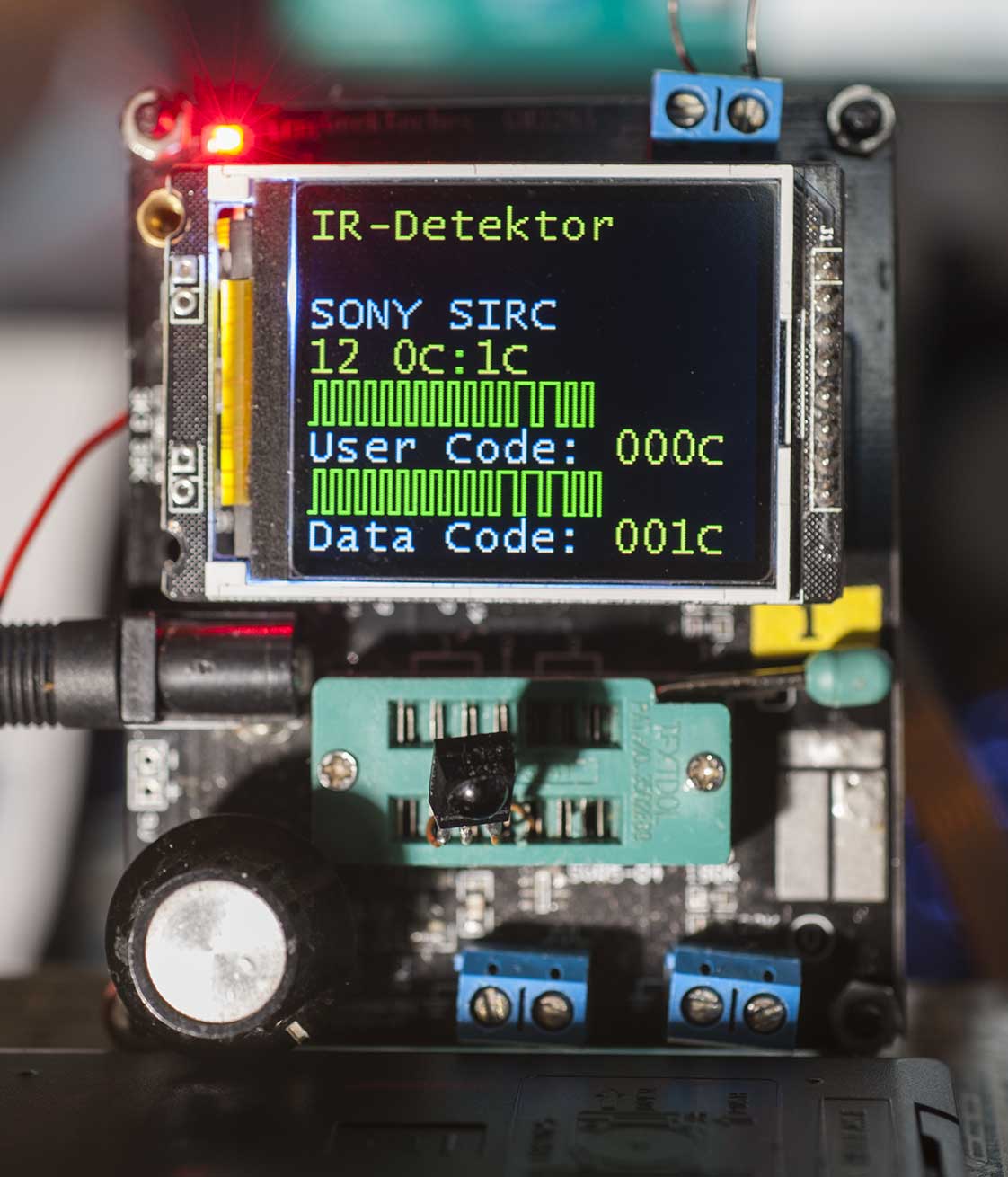

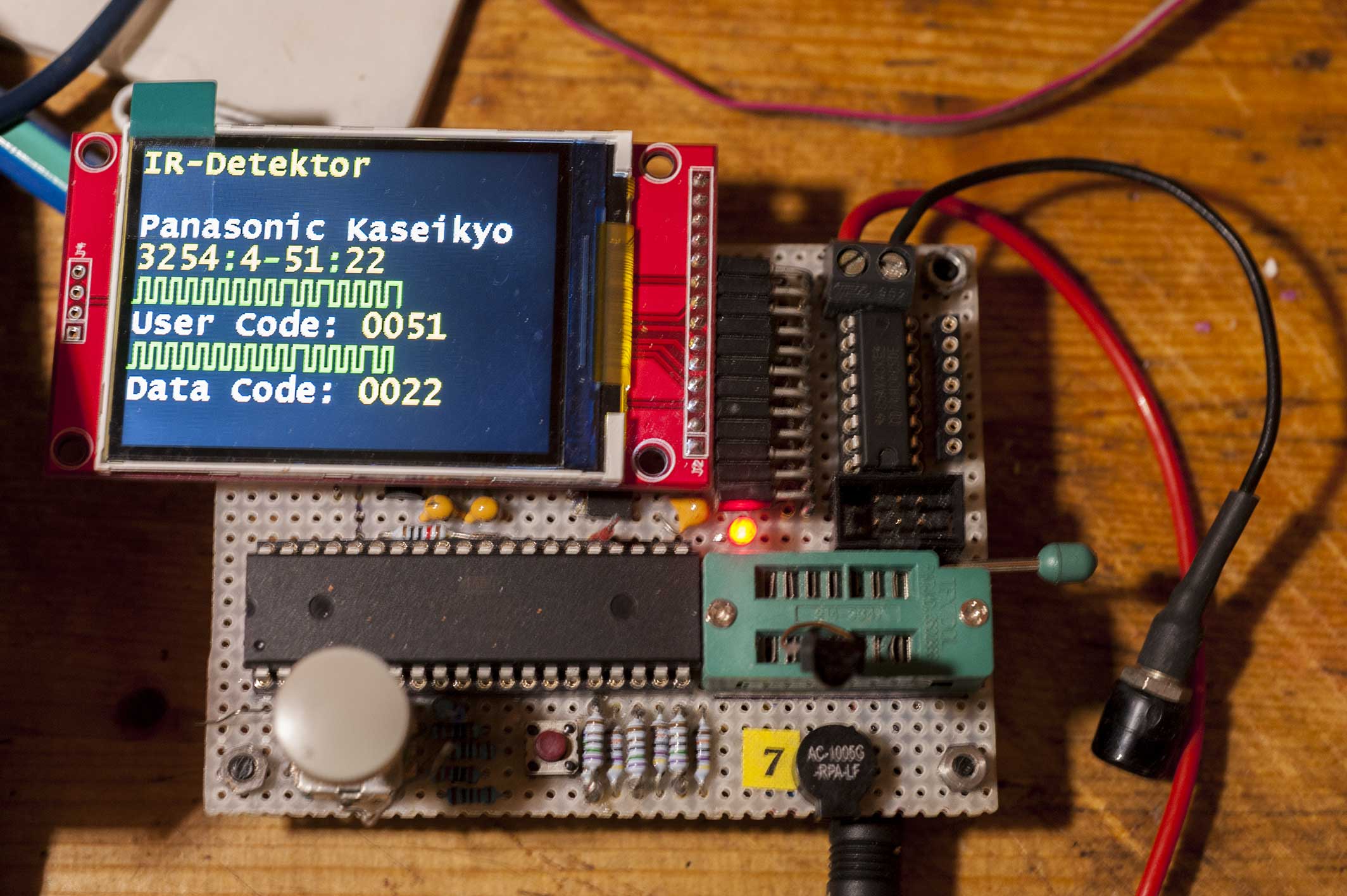

von Boleslaw J. (boleslaw_43)
The original, complete information about the data sent from the remote
control, which Mr. Reschke fit in one line, will be supplemented with
graphics simulating the image from the oscillograph.
I finished implementing graphics for the IR detector. I ran the tests on
several remote controls to which I have access. The remaining tests will
be performed after receiving the m328-644 adapters from China. They are
already after customs clearance.
For testing, I will use a second AY-AT tester on ATmega644. I already
have an additional tester and microcontroller. For testing, I will use
the IR RC function of the second tester.
I will give the modified files to the author of the program, Mr.
Reschke. He will decide whether to include the changes in the next
version of the program. I have no right to publish modifications without
the program author's permission.

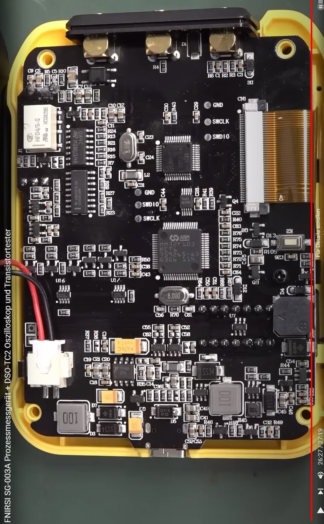

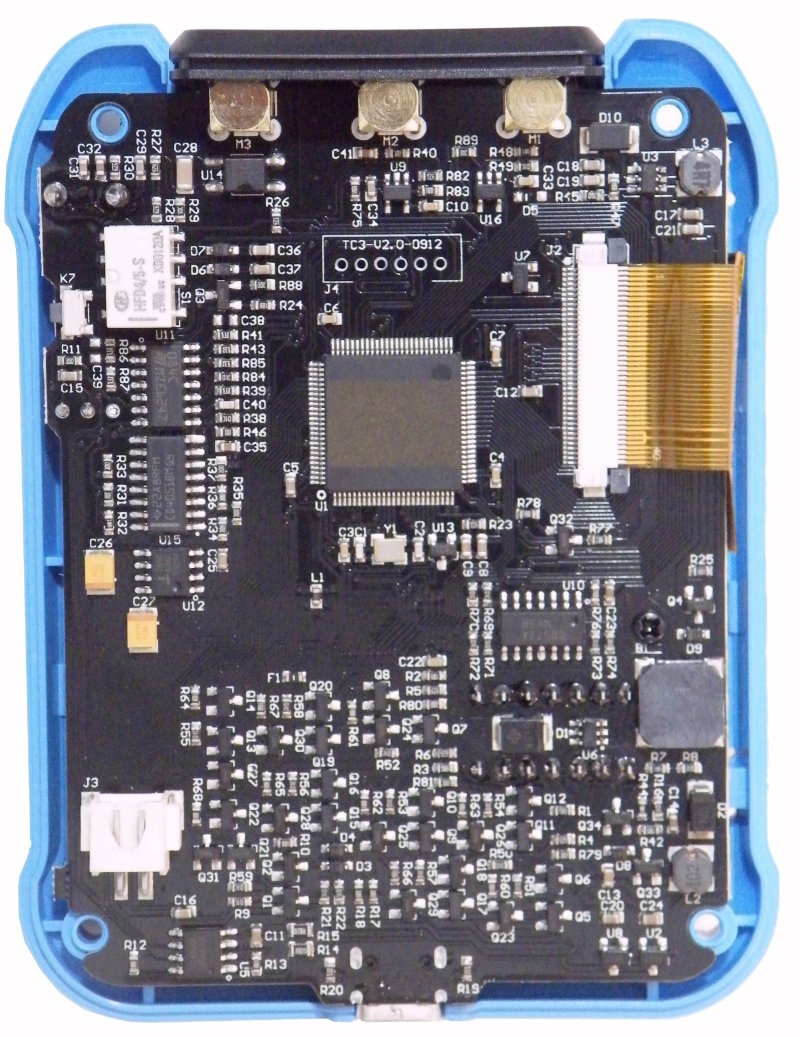

von R. H. (snapper)
Carsten W. schrieb im Beitrag #7077914
> Aber sieht interessant aus. Würde ich gerne mal aufmachen und reinschauen.
besser spät als garnicht!
Die eine Version verwendet zwei ARM Controller, bei der anderen ist nur
ein Controller verbaut wobei die Type unbekannt ist (nicht lesbar)!
https://de.banggood.com/FNIRSI-DSO-TC2-Handheld-Digital-Oscilloscope-LCR-Meter-Graphic-Display-Transistor-Tester-2_4-inch-TFT-Color-Screen-LED-Backlight-for-Auto-Repair-Appliance-Repair-p-1955385.html
https://de.banggood.com/FNIRSI-DSO-TC3-Digital-Oscilloscope-Transistor-Tester-Function-Signal-Generator-3-in-1-Multifunction-Electronic-Component-Tester-p-1982523.html
von Carsten W. (eagle38106)
Wäre mal interessant, die Mess-Schaltung des 122er zu sehen. Der µC wird
ja 3.3V als I/O-Spannung haben und eine sich sehr vom Atmel
unterscheidende interne Portstruktur.

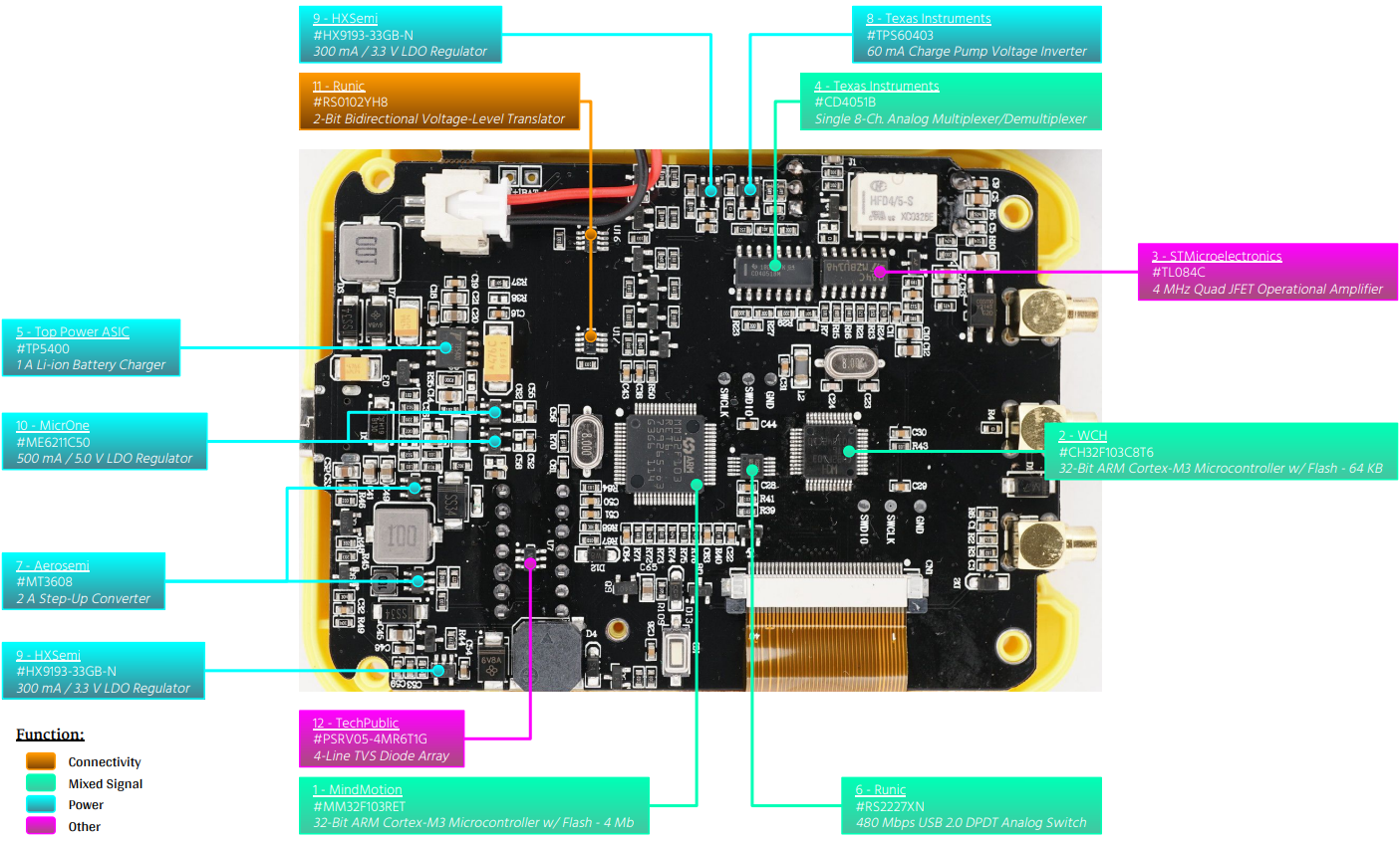

Aber bei dem 2523 sind dem Designer wohl die Pferde durchgegangen. Wozu
braucht man 30 Transistoren in der Mess-Schaltung?
Beitrag #7420347 wurde von einem Moderator gelöscht.
von R. H. (snapper)
Da der Vorgänger TC2 zwei ARM µC STM32 verwendet hat (einen für das DSO
und den kleineren für den T-Tester) gehe ich mal davon aus das man das
jetzt alles in einen großen gepackt hat z.B.  STM32F407VET6. Vor 2
jahren hat ja schon mal jemand die T-Tester SW auf einen
STM32F103/GD32F103 oder GD32F303 portiert, vllt. hilft das ja weiter
(für Leute die sich damit auskennen) ;-)

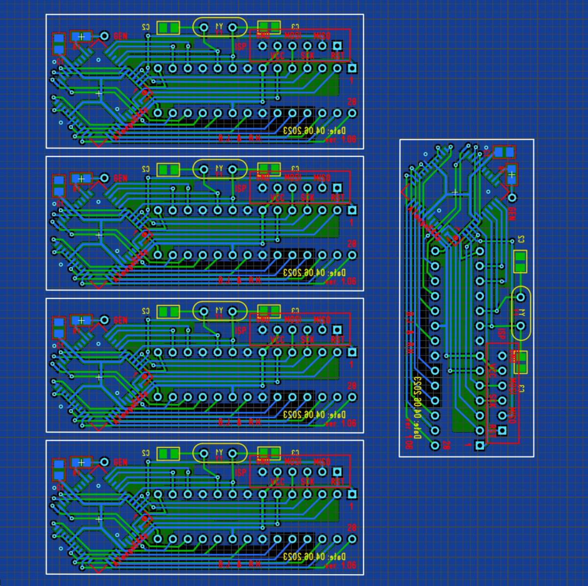

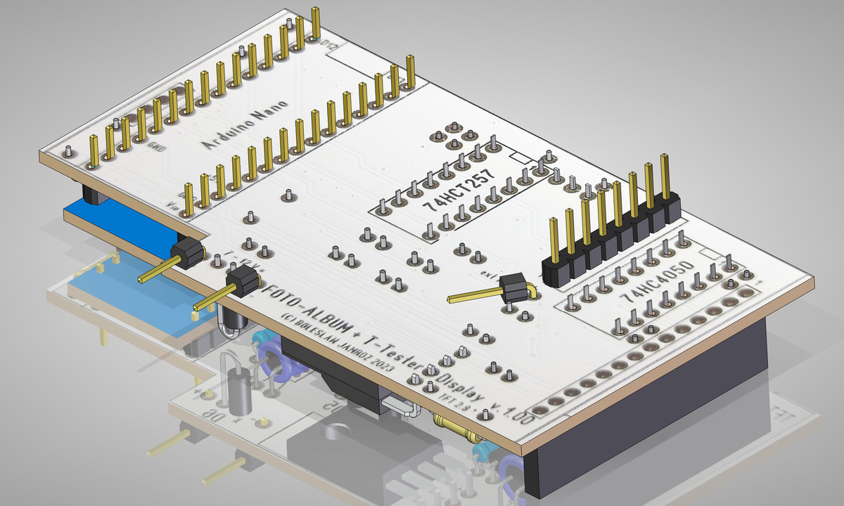

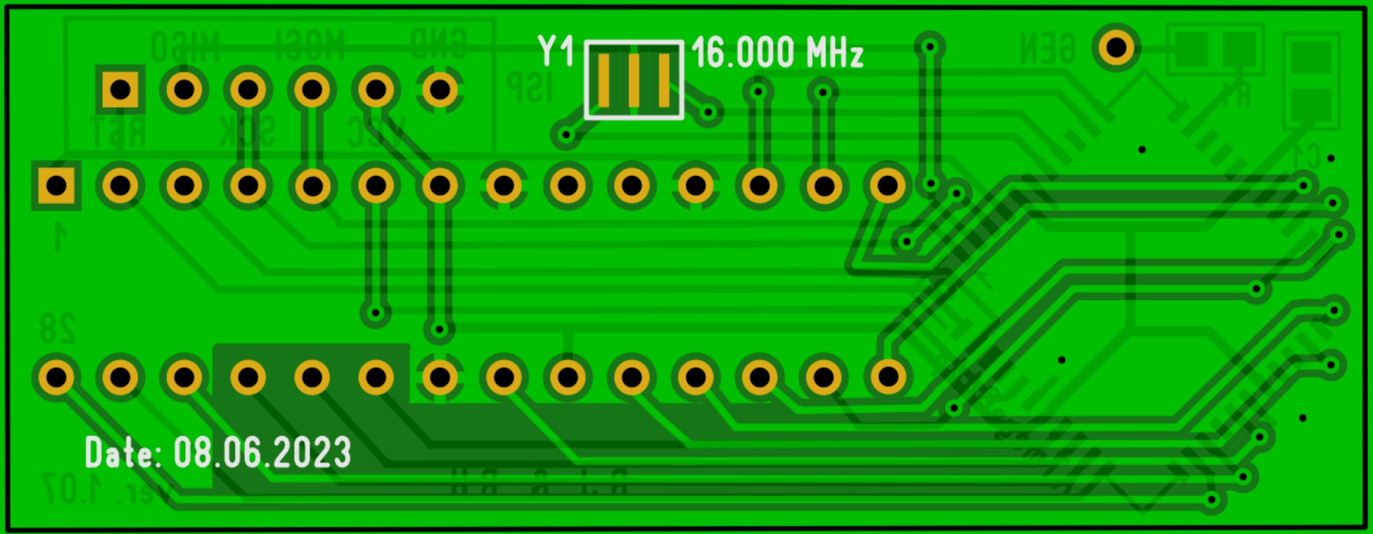

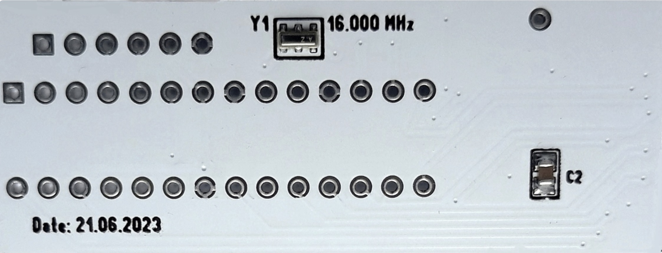

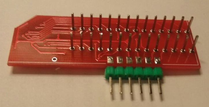

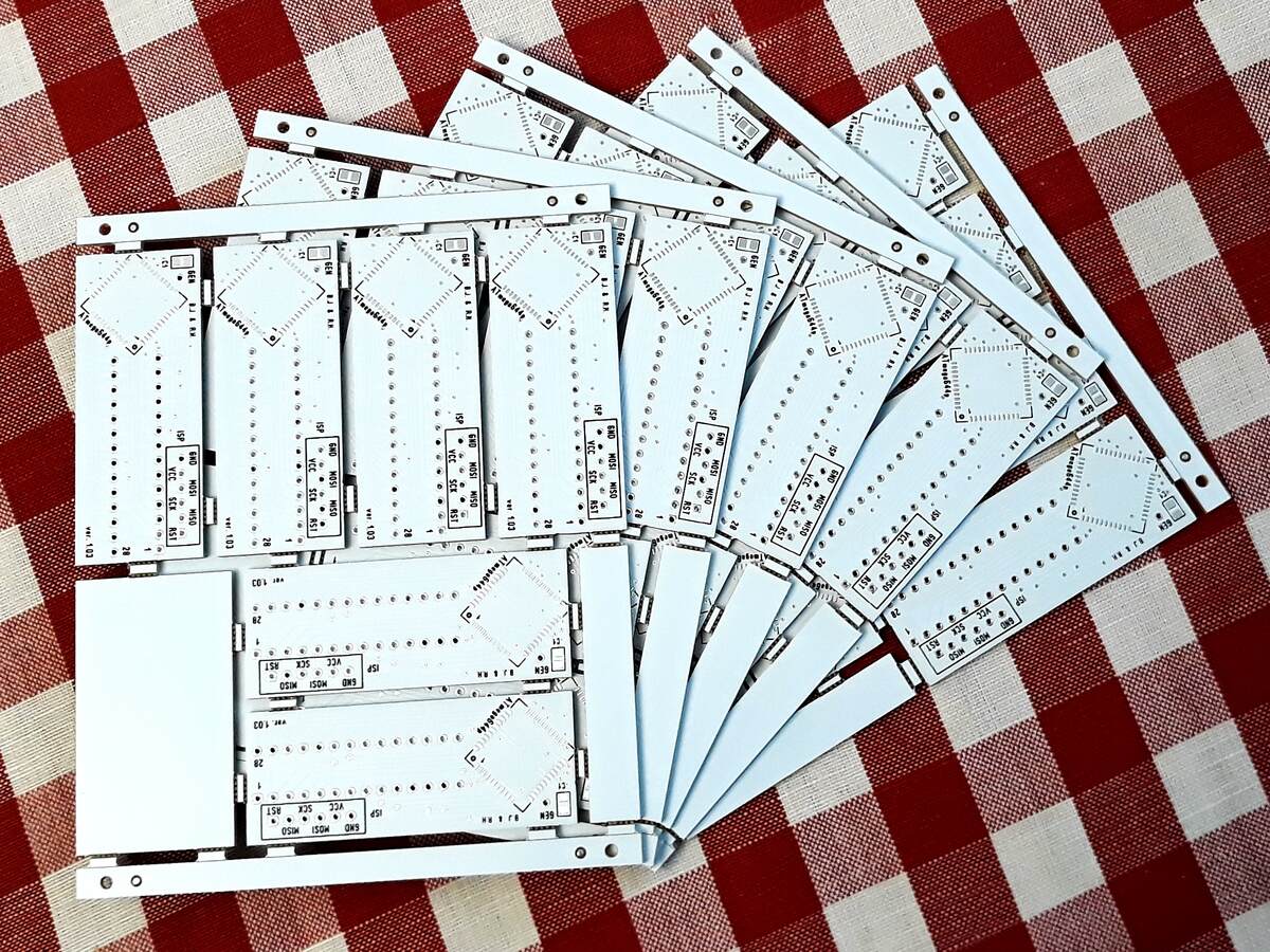

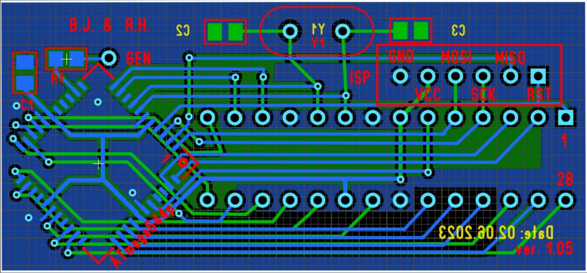

The shipment from China has arrived.
von Horst O. (obelix2007)
Hello Boleslaw 43,
Do you also sell any of these boards, if so, I would like to buy two?
Greeting Horst
von Roland B. (rol_b)
Hello Boleslaw_43,
if you sell some of this boards, I also would like buy two pieces of
them.
Best regards
von Klaus R. (klaus2)
Boleslaw_43, expect lots more of orders :) Good job!
Klaus.

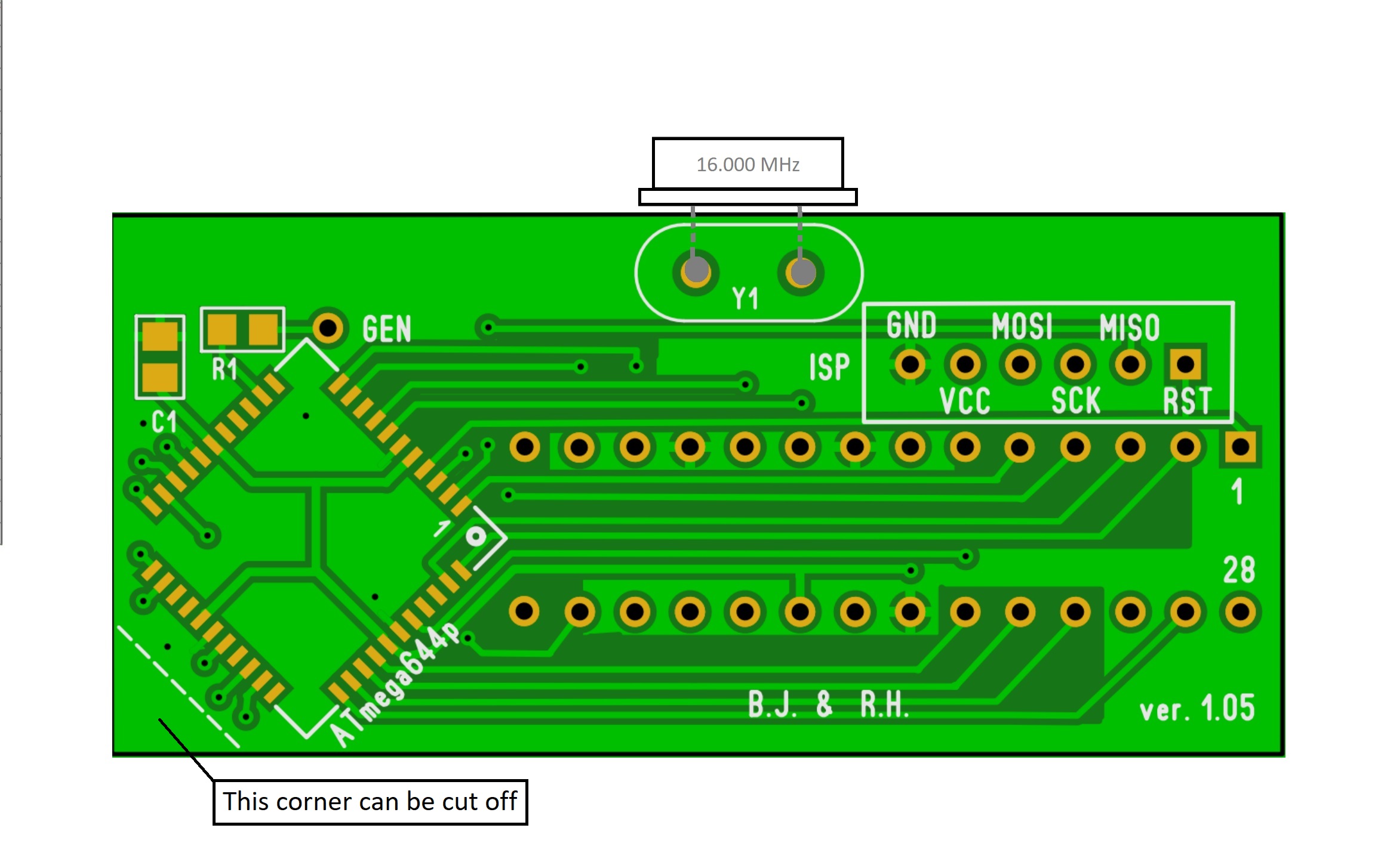

Thank you for your interest.
Since this is my first PCB project, I treat it as a training material.
Therefore, to Forum users residing in the EU, as part of the promotion,
I send the adapter for free.
Please send postal addresses for shipping to my PM.

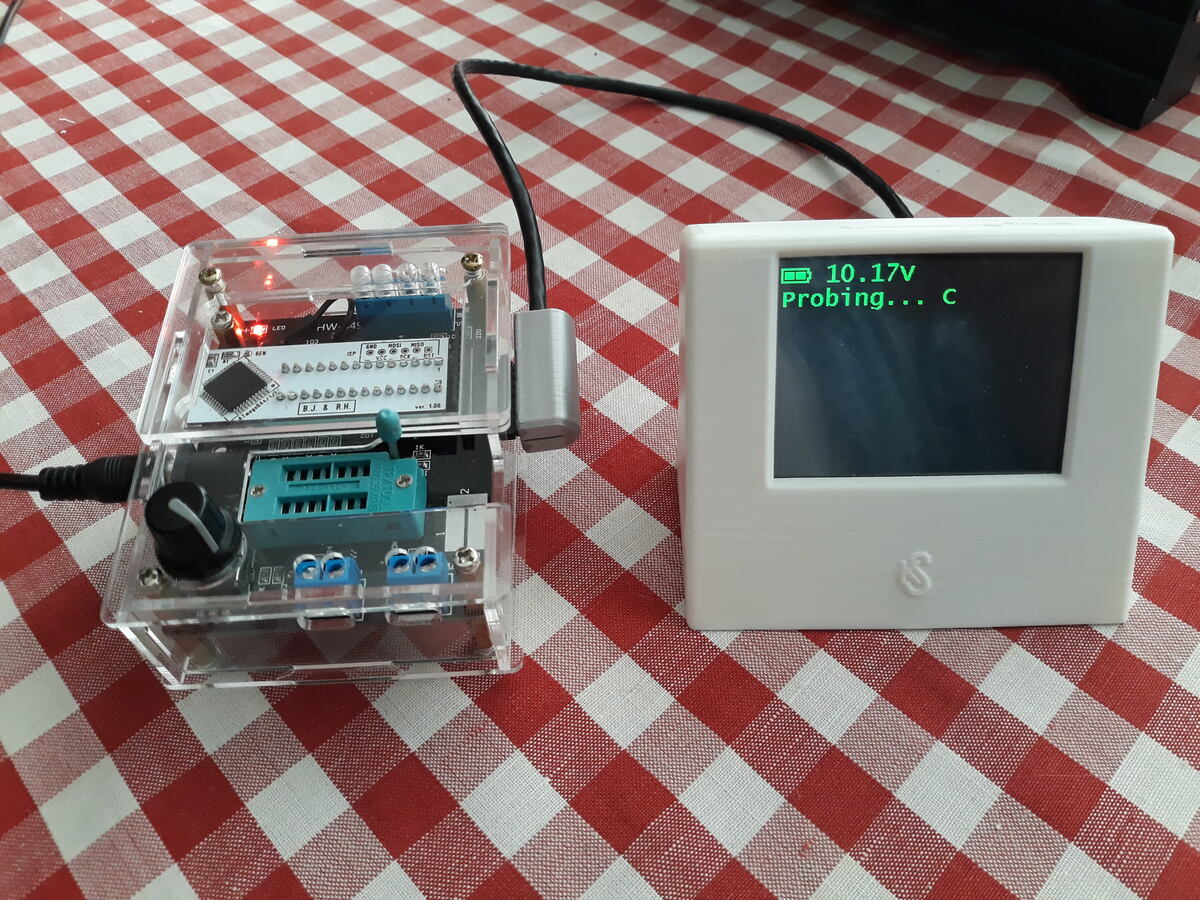

Tests and fixes in progress.
There are still 8 adapters left for the taking.

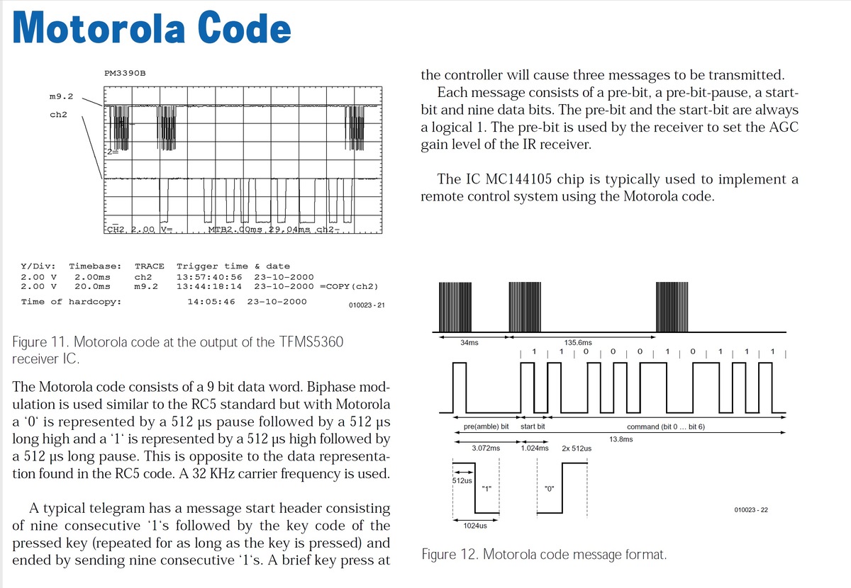

I have finished the implementation of the graphical form (a la
oscillogram) of the data read from the remote control for the "IR
detector" function, for the protocols entered into the Component Tester.
It took me a while because I ran into a problem reading data according
to the Motorola protocol that I could not understand. On my 8 megahertz
AY-AT tester, the IR receiver was unable to read the data transmitted by
the second Component Tester, set in the "IR RC" function to the
"Motorola" protocol.
I understood the reason by analyzing the IR protocol provided by
Motorola. After a short press of a key on the remote control, its
transmitter sends three packets of bits at strictly defined intervals.
The first package contains 9 ones - this is a starter package. The
second package contains the right command, and the third package, also
containing 9 ones - is a package ending the data transmission from the
remote control. By holding down the remote control key for a longer
time, the remote control repeats the command packet until the key is
released, which results in sending the end package (9 ones).  Well, the
time that elapses between sending the first packet of bits and sending
the second packet of bits is too short for the receiver to notice it,
busy at that time interpreting the received first packet. This second
packet, containing the command, was simply lost.
This critical time can of course be extended in the "IR RC" function,
which I did, but the real Motorola remote control does not have such a
possibility - it sticks to the established protocol.
The elegant, multi-packet handling of received packets did not work in
this case. The solution to the problem may be to receive three or at
least two packets in one cycle and remember them in RAM for later
analysis. This is a proposal to be included in the To-Do list for the
author of the program.

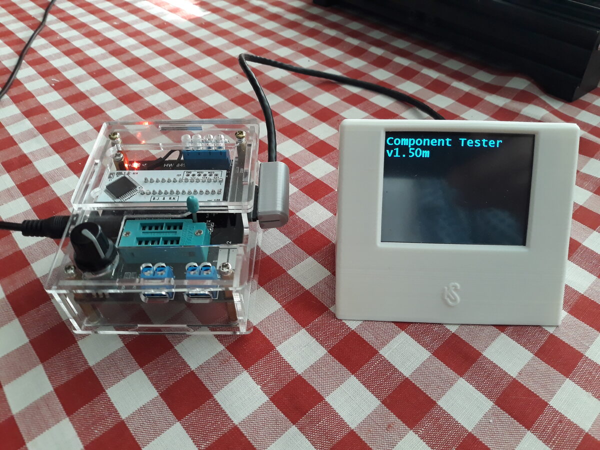

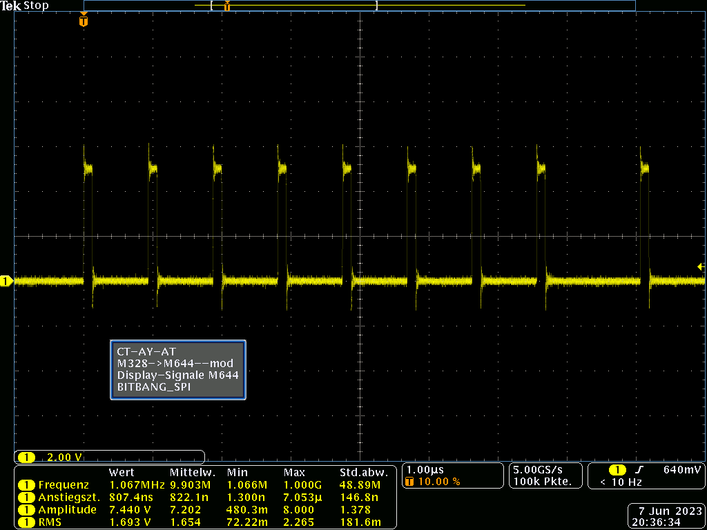

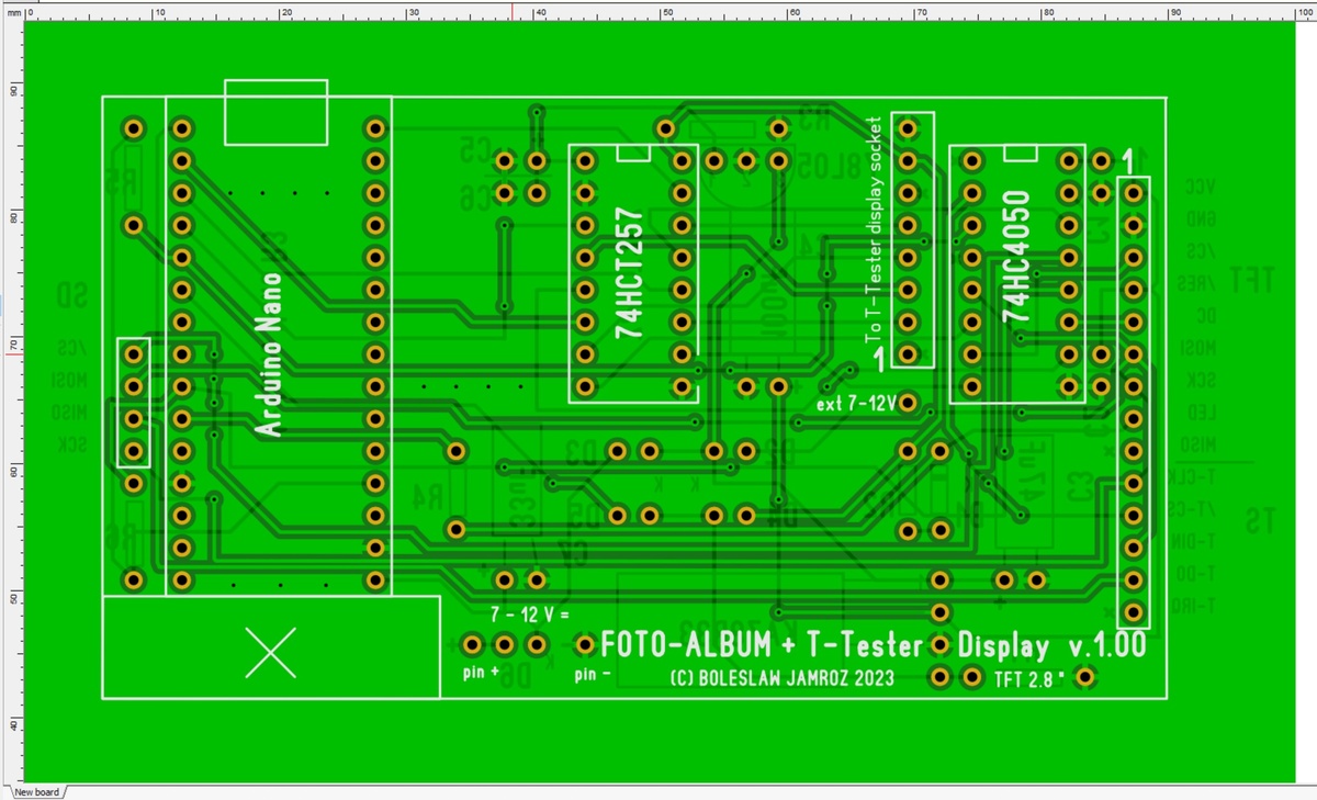

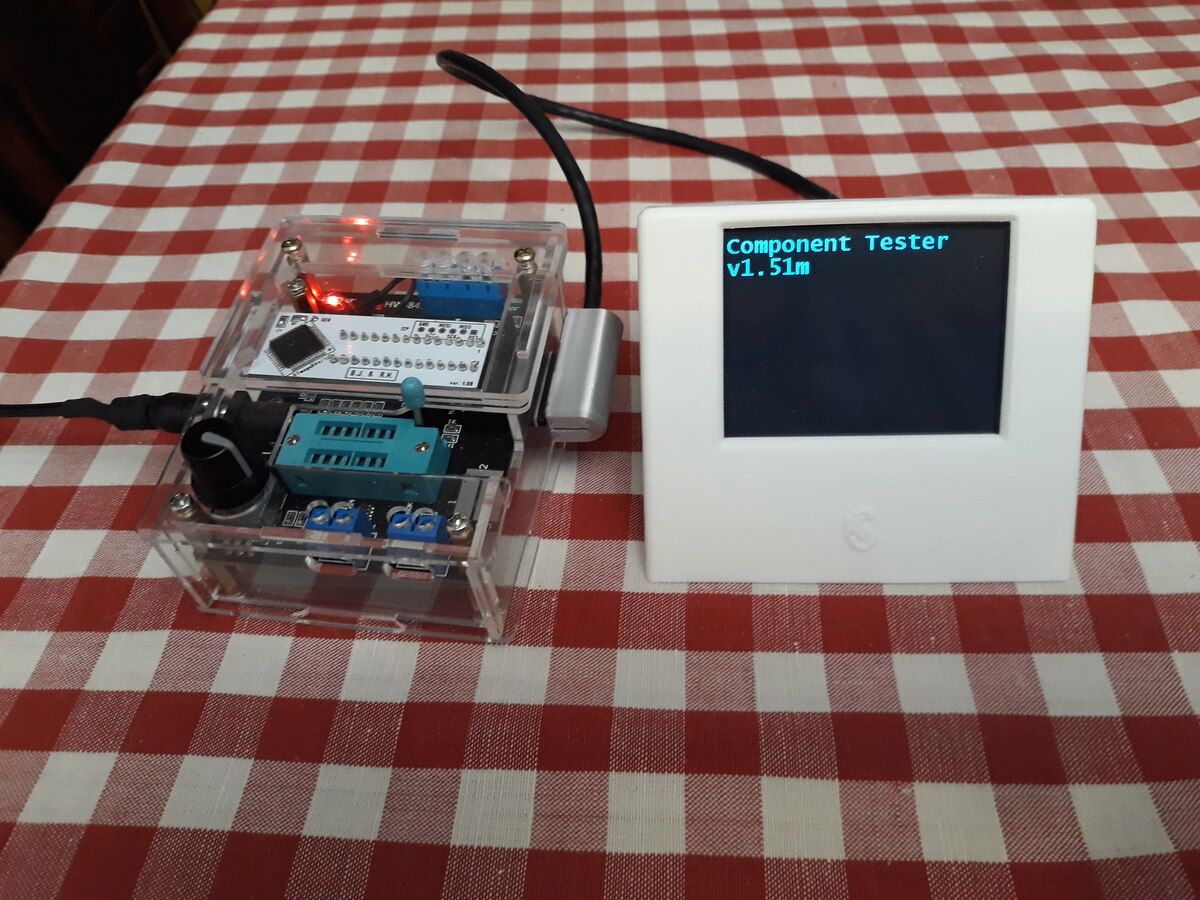

For people to whom I sent adapters m328_m644 for AY-AT, I share the
modified firmware.
The firmware has been supplemented with a graphical result of remote
control tests, SPI hardware support for the ST7735 display and generator
output from the OC1B port of the microcontroller.
The zip archive also contains the current adapter connection table for
version 1.03 (white).

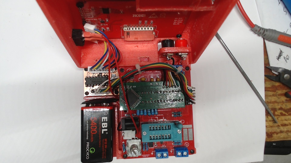

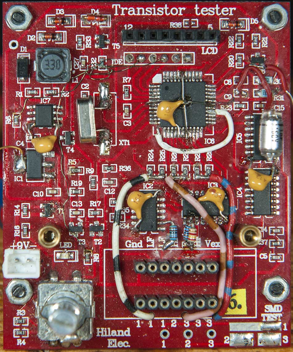

von Asko B. (dg2brs)
Hallo
Nachdem User Boleslaw J hier eine Adapterplatine vorgestellt hat,
beschäftige ich mich wieder mit dem Teil.
Ich wusste, dass ich noch eine "Leiche" im Bestand hatte.
Also habe ich mal gekramt, und auch gefunden!
Es ist ein AY-AT mit bedrahteten Bauteilen.
Damals gab es einen Kurzschluss mit einem Knall weil ein
At the request of Asko B. I added a quartz resonator to the adapter.
Hallo Boleslaw,
... auf Wunsch von... hört sich ja gut an.    ;-)
Aber es sollte eigentlich einfach nur ein Vorschlag sein.
So das man den schon verbauten 8MHz-Quarz für den M328 drinlassen
kann, und nach umstecken auf den M644 dann halt 16MHz nutzen kann.
Auch dachte ich eher an eine SMD-Ausführung um die Platine nicht
grösser werden zu lassen.
Übrigens müssen dann auch die zwei markierten Leiterbahnen entfernt
werden.
Gruss Asko
Hello Boleslaw,
... at the request of... sounds good ;-)
But it should really just be a suggestion.
So that you can leave the already installed 8MHz-quartz for the M328 in
and after changing to the M644 you can use 16MHz.
I was also thinking of a SMD version so that the board would not be
not to make the board bigger.
By the way, the two marked tracks must also be removed.
be removed.
Greetings Asko
@snapper
Bei mir sind die beiden Elkos genauso hoch wie die
Transistoren/Spannungsregler.
Gruss Asko
von R. H. (snapper)
Auslöten und entweder ganz bis auf die Platine drücken oder auch von der
Unterseite einlöten (auf die Polung achten!). Wenn Du kein chinesisches
Steckgehäuse hast brauchst Du dann aber 4 Abstandshalter. Aber Vorsicht
beim entlöten/löten das Du keine Durchkontaktierungen mit rausreißt und
das die Transistoren nicht überhitzt werden!
There is no need.
Just do not solder pins 9 and 10 of the DIP28 connector.
However, in this version, PCB is universal. When you want to use the 8
MHz quartz resonator installed on the main PCB, just do not solder the
quartz resonator and capacitors to the adapter.
If it is not possible to mount a quartz resonator either on the bottom
layer of the PCB or on the top layer, you can try to place it on the
side of the PCB, as in the attached figure.
Asko B. schrieb:
> I was also thinking of a SMD version so that ...
To reduce the dimension of the adapter, I moved the quartz resonator Y1
and capacitors C2, C3.
I added the inscription:
"If Y1, C2, C3 installed, do not solder pins 9 & 10"
Two suggestions:
* Make Y1 a SMD version
* Cut the tracks to the adapter pins. Not soldering them does not make
sure, that there is no contact at all. You might need to cut off the
adapter pins before soldering.
Carsten W. schrieb:
> Two suggestions:
Thank you for your valuable suggestions.
The basic design of this adapter in the source version (.lay6) is placed
in the Markus R. repository.
Everyone can download and modify this project for their own needs and
self-assembly capabilities.
I'm only an observer in this thread and I do not intend to use the
adapter.
I'm just suggesting some improvements, since it's not good design
practice to make a circuit's functionality dependent on whether two pins
of a larger component are soldered or not.
People who a not familiar with the circuit will search themselfs to
exaustion if the oscillator is not working as intended or will stop to
work at some point. They will simply overlook these two pins. And like I
wrote before: Even if not soldered, there is no guarantee at all, that
those plated holes and pins will stay out of contact forever.
...sry, a little bit more soup in the brain then after primary school
may be expected by persons using such testers AND at least in
combination with this adapter. But anyway this discussion might be OT.
Klaus.

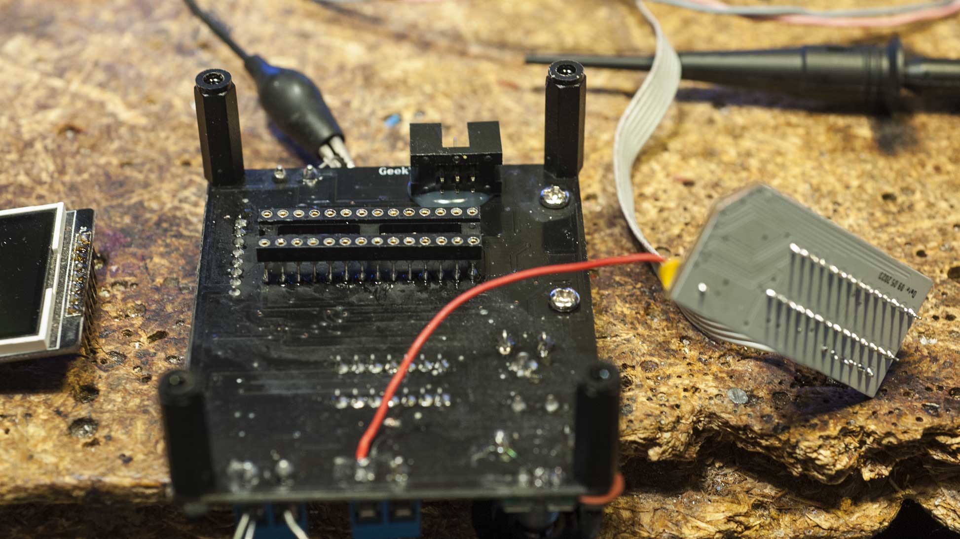

... von Anfang an gefiel mir Boleslaw 's Projekt mit dem
Erweiterungs-Adapter.
Im Laufe der letzten Jahre kamen immer mehr Messmöglichkeiten für den
Componenten-Tester hinzu, z. B. auch ein kleine Adapter zum Test von
Optokopplern.
Der begrenzte Speicherplatz beim Atmega328 zwang nun zum Auswählen der
Funktionen und zum Vorhalten mehrere 328er mit unterschiedlichen
Funktionen, die bei Bedarf dank IC-Fassung Auswechselbar waren.
Der o.a. 644er/1284er Adapter bringt da Abhilfe.
Boleslaw war so freundlich, mir 2 PCB 's zu überlassen. Am Montag waren
die in der Post und ich habe gleich 'nen Atmege644 aufgelötet.
Der Platz unter dem Display ist nicht so üppig und ich endschied mich,
den Adapter von unten mittels einer zweiten IC-Fassung einsteckbar
anzubringen.
Zunächst gab es ein Problem bei der Inbetriebnahme - keine Anzeige auf
dem Display? Eine eingesteckte LED in den ZIF-Testsockel zeigte durch
ihr Aufflackern das das Programm schonmal lief. Am Oscilloscope sah man
auch die Impulse der Display-Ansteuerung.
Zum Glück habe ich ja zwei dieser Tester und das andere Display
funktionierte auf Anhieb. Da beide Displays an den 328er Controllern
arbeiten, stellte sich durch Vergleich der Ansteuer-Impulse heraus, das
nur eins dem schnelleren HARDWARE-SPI folgen konnte. Habe dann zum Test
den Adapter auf BITBANG-SPI umgestellt und das "langsamere" Display
funktioniert nun auch am 644er Adapter.
Der momentane Füllstand des Atmega644 liegt bei Program: 74,4%, Data:
7,0% und EEPROM: 73,5%
Der zweite Adapter bekommt dann einen Atmega1284!
Gruß Horst
... from the beginning I liked Boleslaw's project with the expansion
adapter.
Over the last few years, more and more measurement options for the
component tester have been added, e.g. B. also a small adapter for
testing optocouplers.
The limited storage space of the Atmega328 now forced the selection of
the functions and the provision of several 328s with different
functions, which were interchangeable if necessary thanks to the IC
socket.
The 644/1284 adapter mentioned above will help.
Boleslaw was kind enough to let me have 2 PCB's. They were in the mail
on Monday and I immediately soldered an Atmege644 on.
The space under the display is not that plentiful and I decided to
attach the adapter from below using a second IC socket.
At first there was a problem when starting up - nothing on the display?
An LED plugged into the ZIF test socket showed that the program was
already running by its flickering. On the oscilloscope you could also
see the impulses of the display control.
Luckily I have two of these testers and the other display worked right
away. Since both displays work on the 328 controllers, a comparison of
the control pulses showed that only one could follow the faster HARDWARE
SPI. I then switched the adapter to BITBANG-SPI for the test and the
"slower" display now also works on the 644 adapter.
The current fill level of the Atmega644 is at Program: 74.4%, Data: 7.0%
and EEPROM: 73.5%
The second adapter then gets an Atmega1284!
Greeting Horst
I gratefully accept constructive criticism.
Thank you. Excellent choice!

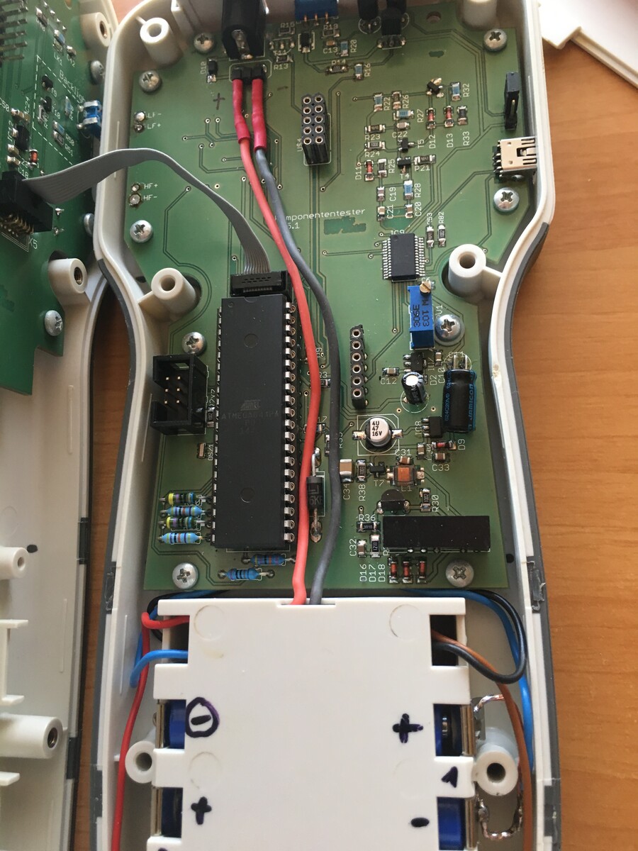

Es tut mir leid, dass ich diesen ungeheuer langen Thread mit meinem
Anliegen einfach kapere.
Hintergrund ist, dass ich die Transistortester-Entwicklung einfach ein
paar Jahre nicht verfolgen konnte.
Ich hatte ursprünglich eine Platine mit ATmega328 und DOGM-Display und
PWM-Helligkeitsknopf. Moritz Augsburger hatte das entwickelt und hier
überflüssige Platinen verkauft.
Der Transistortester funktionierte hervorragend, nur war der Einbau in
ein Gehäuse sehr schwierig (Zugänglichkeit der Bedienknöpfe).
Daher habe ich das ganze Projekt demontiert und mir folgenden von
Reichelt gekauft: JOY-IT LCR-T7 Komponententester
kurzes Fazit:
- Grafik-Display großes Plus
- LiPo-Akku mit USB-Lademöglichkeit schön und gut
- Messstrippen etwas billig
- Gehäusetechnik hakt (Bedienknopf)
ABER: Es können keine J-FETS gemessen werden! Es wird immer "Z-Diode"
angezeigt. Messgenauigkeiten überhaupt etwas fraglich, es wird hier und
da auf "falsche Bauteiltypen eingerastet", so kommt es mir vor.
Ich habe lieber einen Transistortester, bei dem ich Hardware UND
Software genau kenne.
Frage (nach so vielen Jahren der Abstinenz vom Thema): Was muss ich tun,
um einen genauen, zuverlässigen Tester zu bekommen, der robust in ein
Gehäuse einbaubar ist? Notfalls entwerfe ich mir selbst eine Platine mit
KiCAD, die ich bei JLCPCB oder PCBway fertigen lasse.
Ich habe nur den Anschluss zu der neuesten Hardwareversion verloren.
"Boleslaw" sagt mir nichts. Kennt noch jemand die Vorteile von
DOGM-Displays? Die sind taghell und glasklar, aber sehr zerbrechlich.
Oder den Ansatz von Moritz Augsburger?
Jegliche Hilfe ist willkommen!
Christian
von R. H. (snapper)
Bei dem Adapter Projekt von Boleslaw und mir geht es um den Austausch
des ATM328 gegen den ATM644 wegen des größeren Speichers und Boleslaws
Firmware zum messen von IR Komponenten. Die Platine passt aber nur zum
AY-AT Tester und ggf. anderer Tester mit gesockeltem ATM328 siehe die
Beiträge ab 28.03.2023!
Als DIY Projekt mit ATM644 kenne ich nur den MEGA4GSL -->
Beitrag "Re: Transistortester AVR"
Dein LCR-T7 sollte auch einen ATM644 haben, schon mal mit einer anderen
Firmware versucht? Sitzt da ein ATM324 drin lässt er sich gegen den
ATM644 problemlos austauschen (vorausgesetzt man kann SMD löten)!
Hallo Christian,
Dein Tester hat einen kleinen Haken.
Dort wird ein extra Controller für die Tastensteuerung benutzt.
Bei Softwareänderungen ist dieser Chip entweder neu zu programmieren
oder zu entfernen und durch eine Transistorschaltung zu ersetzen.
Egal ob jetzt da ein M324 oder M644 drin werkelt.
Genauere Hinweise können Dir Markus(madires) oder Horst O.(obelix2007)
geben.
Im eevblog zum gleichen Thema hat User Indman mal eine Liste
der meistgehandelten Transistortester veröffentlicht.
Allesamt Made in China.
Die hänge ich mal an.
Gruss Asko
Hallo Christian,
Asko hatte erste Hinweise gegeben - um die Software zu ändern, muß
zunächst die Hardware geändert bzw. ergänzt werden:
Die Einschaltdauer wird von einem kleinen Chip gesteuert und ist nicht
mit der Standartsoftware kompatibel. Man kann den neu programmieren oder
gegen eine kleine 2-Transistorschaltung tauschen. Desweiteren muss ein
Programmier-Steckverbinder angebracht werden.
Abhängig von deiner bevorzugten Software (Karl-Heinz Kübbeler KH-1.13
oder Markus Reschke CT-m1.49) ist die Konfiguration etwas
unterschiedlich - bei KH nur über das Makefile, bei Markus über
Makefile, config.h und config_644.h.
https://github.com/madires/Transistortester-Warehouse/tree/master/Firmware/m-firmware
Gruß Horst

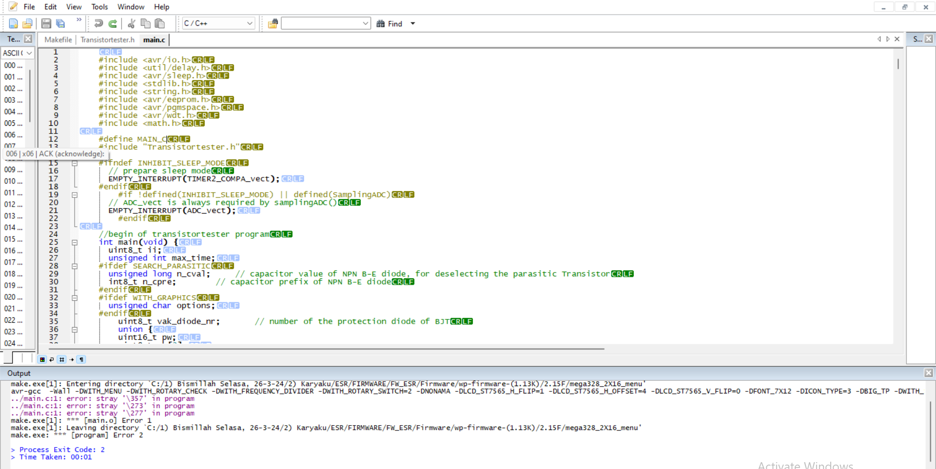

von DiagSoftware (diagsoftware)
Hello everyone, could you help me to modify the language of the
TransitorTest. Since when you want to compile it with WinAVR it throws
an error
I leave a block of notes for you to review the error..
...und mit einer anderen Sprache GEHT ES? Bzw völlig unverändert?
Klaus.

von Marcel D. (derri)
> an error
Some time ago my Windows PC came up with the same error (for short:
      0 [main] sh 5812 sync_with_child: child 1264(0x1D4) died before
initialization with status code 0xC0000142
  35305 [main] sh 5812 sync_with_child: *** child state waiting for
longjmp)
Start a Windows Console and type "make --version".
make should answer with the following message:
C:\Users\md\console2>make --version
GNU Make 4.2.1
Built for Windows32
Copyright (C) 1988-2016 Free Software Foundation, Inc.
License GPLv3+: GNU GPL version 3 or later
<http://gnu.org/licenses/gpl.html>;
This is free software: you are free to change and redistribute it.
There is NO WARRANTY, to the extent permitted by law.
If you get a different prompt, you're having the same problem that I
had, i.e. the wrong make utility.
I traced down this error to a make utility that was incompatible with
avr-gcc since it doesn't understand the gcc make syntax, it issues the
cited error messages. The Delphi IDE that I had installed, changed -
without warning of course - the default path environment variable to
point to its own make.exe. So when I called "make xyz", the Delphi
make.exe was run.
So, imho, what you can try is to edit your path variable to put the
avr-gcc related parameters before any other compiler's perameters. You
might also try to call make and all other GNU utililities with a fully
specified path. I don't know if thats possible with winavr. In any case,
the test call of make must give the result above.
What I finally did is to cut the gordian knot all together, and I now
use the Windows Subsystem for Linux to compile avr-gcc source files.
When you grant access to your linux user folders, where avr-gcc stores
its results, you can read the compiled files from windows.
I hope this helps,
derri

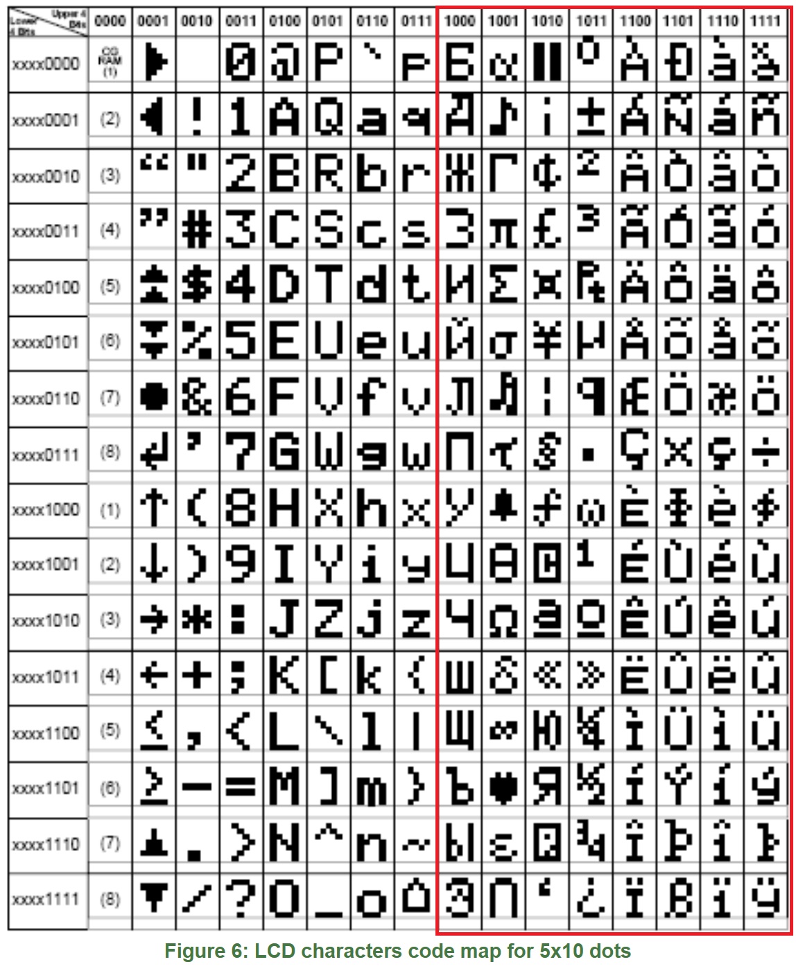

> when I changed the language some characters disappeared...
This may be a feature of this 2x16 LCD display, which in the second half
of the character table (codes 128 to 255) does not contain the
characters used here, instead has spaces, filled with bytes of 0xFF.
With the default language it works perfectly. It only fails when I
select another language already modified
Quote from the file "language-dependent_characters.h":
  #elif defined LANG_SPANISH
      PIX_a_acute            /* 0x80 a_acute  e1 */
      PIX_c_cedil            /* 0x81 c_cedil  e7 */
      PIX_e_acute            /* 0x82 e_acute  e9 */
      PIX_i_acute            /* 0x83 i_acute  ed */
      PIX_o_acute            /* 0x84 o_acute  f3 */
      PIX_u_acute            /* 0x85 u_acute  fa */
      PIX_u_uml              /* 0x86 u_uml    fc */
      PIX_A_acute            /* 0x87 A_acute  c1 */
      PIX_E_acute            /* 0x88 E_acute  c9 */
      PIX_I_acute            /* 0x89 I_acute  cd */
      PIX_O_acute            /* 0x8a O_acute  d3 */
      PIX_U_acute            /* 0x8b U_acute  da */
      /* PIX_a_super */           /* 0x8c a_super     */
      /* PIX_o_super */           /* 0x8d o_super     */
      /* PIX_n_tilde */           /* 0x8e n_tilde     */
      /* PIX_N_tilde */           /* 0x8f N_tilde     */
      /* PIX_updown_exclam */     /* 0x90 updown_exclam  */
      /* PIX_updown_question */   /* 0x91 updown_question */
All the above listed characters of the Spanish alphabet are included in
the second half of the ASCII character table.
The default language (English) does not use them. Change the LCD to the
correct one or use the default language.
von Karl-Heinz K. (kubi48)
> that when I changed the language some characters disappeared...
With the "k" software only the cyrillic characters are supported for a
special version of character displays (2x16 lines).
For all other languages besides Russian and Ukrainian, special
characters are replaced by ASCII characters for the character displays.
Please see the lines 405 to 533 in lcd_defines.h! Language-dependent
special characters are only supported for graphic displays.
For the spanish language (langSPANISH.h) special characters are not
implemented now. Please see the czech language (langCZECH.h) how special
characters must be handled correctly. You can find the supported special
characters for all languages in the file fonts/std_defines.h ! But you
should keep in mind, that all special characters are only operative for
graphical displays. For character displays these special characters are
replaced by ASCII characters automatically.
So I don't understand, why your character display make problems with
other languages. Probably you can send your Makefile to my email
address, which you can find at the title page of the documentation. I
will send you the compiled files back and can also test them with other
hardware.
I sent you an email with all the details.
For such a popular language in the world as Spanish, it is worth
implementing this language into the T-Tester program.
Most character LCD displays include Spanish characters in their maps (in
addition to Cyrillic and other national characters).
Since it is possible to implement the Cyrillic alphabet, it is also
possible to implement the Spanish.
In this forum, there are certainly many developers who use Spanish on a
daily basis ( in addition to C :) ) who could (and should) do so.
Don't wait for someone to do it for you!
... hallo Jörg,
ist Dein Transistor Tester Clon denn ein Clon vom Hiland M644 und
benutzt Du die "Hiland-Software von Karl-Heinz K. (kubi48)" oder hast Du
die Software auch selbst "gestrickt"?
Ev. zeigst Du uns mal ein Foto?
Gruß Horst
von Jörg S. (profjs)
... hallo Horst,
ich weiß nicht, ob es 2015 schon den Hiland gab. Mein 'Clone' ist eine
komplette 'Eigenentwicklung' basierend auf dem Schaltungsdesign aus der
Doku von K.H.Kübbeler, Seite 33, eingebaut in ein Hammond Gehäuse.
Betrieben mit 3 LiFePO4 AAA Zellen, erweitert mit Lade- und
Schutzschaltung derselben.
Die Software ist die originale Version von Karl-Heinz mit einer
klitzekleinen Änderung in Bezug auf die Initialisierung des DOGM-LCD.
MfG
Jörg
Hallo Jörg,
mein 'Hiland' habe ich Ende 2018 gekauft, das Datum vom Vorteiler IC4
entspricht wohl 27ste Woche 2017. Im Anhang einige Fotos vom Einsatz des
'Hiland'.
In version 1.08 of the m328/m644 adapter for AY-AT tester I used a 16
MHz SMD quartz crystal, which doubled the data transfer speed to the
display on the SPI bus. Increasing the clock frequency also allows you
to use additional capabilities of the tester, such as increasing the
accuracy of measuring capacitors with a capacity below 100 pF and
checking quartz resonators.
The original 160x128 display, 1.77 inch of the AY-AT tester is too small
and too dark for me. In daylight, you can't see much on it.
I replaced it with a larger and brighter display - TFT 320x240, RGB, 2.8
inch with ST7789 controller.
When designing the interface for the new display, I tried to take full
advantage of its capabilities - also the touch screen and SD card
reader.
The 2.8 inch TFT display with my interface can work:
- in a common, enlarged housing with the AY-AT tester, using the same
8-pin socket as the original display
- in a separate housing, using an additional connection socket (on the
side of the tester) and a cable connecting the tester to the display.
- as a standalone device for displaying a sequence of photos from an SD
card, i.e. Photo-Album. This is where the touch screen comes in handy to
control the display.
Making a virtual model of graphical display with its interface is very
helpful when designing a display housing for the Transistor/Component
Tester.
Author of the housing design - KS.
Schematic and PCB of 2.8 inch color TFT display interface for Transistor
/ Component Tester.
The option with Arduino is used to display a sequence of photos from an
SD memory card.
von R. H. (snapper)
Hi B.
schön das du noch so aktiv bist (an dem Sprint-Layout hast du ja auch
sehr großen Gefallen gefunfen wie ich sehe) aber das wäre mir dann doch
zuviel Aufwand nur um damit Bilder anzusehen, dafür habe ich ein
Smartphone ;-))
ich hatte die Idee mit einem größeren Display auch schon mal und hab da
den Beitrag von Yuriy_K aus dem EEVBLOG Forum gefunden wo er das an den
HILAND-644 angeschlossen hat, leider sehr umständlich mit einer
Adapterplatine. ich hatte dann die original HILAND Platine kopiert,
vergrößert und die Anschlüsse für ein 2.4/2.8" Display sowie einen
fertigen LIPO Lader von Aliexpress vorgesehen (den kann man für das Geld
nicht selber bauen !)
https://www.eevblog.com/forum/testgear/$20-lcr-esr-transistor-checker-project/msg4882043/#msg4882043
https://de.aliexpress.com/item/1005005278905855.html
aber ich hab ja jetzt mein DSO-TC3 mit 2.4" und bin damit eigentlich
ganz zufrieden.
R.H.
Thank you for your comment. I owe my progress in using SprintLayout to
your valuable advice in private correspondence.
I used THT technology for the display interface PCB, taking into account
people with poor eyesight who would like to solder the elements on their
own. In addition, there was no need for miniaturization - there was more
than enough room.

A:
Same as in tester AY-AT. If the Vcc of the display is 3.3 V and the Vcc
of the controller is 5 V, then the display can be controlled, for
example, by a 74HC4050 chip, powered by 3.3 V.
Hello Horst,
Pay attention to the supply voltage of the display on this PCB from R.H.
If you have a display at 3.3 volts on Vcc, that could be a problem,
because that's where the 5 volt power line comes in on the PCB.
Greetings,
Boleslaw
If you are interested in the m328/m644 adapter PCB at minimal cost,
please contact me at PM.

von Alois N. (alois)
Boleslaw J. schrieb:
> Attached are modified files for ComponentTester version 1.50m for
> m328-m644 (AY-AT) adapter.
Can you provide a compiled version of the source code?
Which Crystal was used 8 or 16 MHz?
Which FUSES must be used?
FUSES for ATmega644p:
L:0xF7
H:0xD9
E:0xFC
Yes, I can.
The compiled version is for ATmega 644p, 16 MHz resonator and fuses:
L:0xF7, H:0xD9, E:0xFC.
> Yes, I can.
Thanks for the binary code. However, the display only shows white after
switching on. I use the original display from the HW-849A device.
That would have to be a 1.77 inch, 160x128 display with ST7735
controller.
Do you know the problem?
> controller.
Yes, I know this problem. For this reason, the author of the program
includes the source files of the program, thus giving the user the
opportunity to adapt it to his hardware configuration, functionality and
interface language.
My display is a color graphic display with a diagonal of 2.8",
320x240px, ST7789.
For such a display I included binaries in the English version in the
previous post.
Now I'm attaching the binaries in the English version compiled for your
display (I checked them in the component tester).
Attached are modified files for ComponentTester version 1.51m for

Finished doing the Adapter_m328_m644_AY-AT ComponentTester
Thanks to von Boleslaw J.,von Markus R. and all who made it possible.
I used KiCAD to make possible to CNC mill TFT Adapter and make traces
larger.

von AdityaWahyuArdiansah (aditya_wahyu_a)
Hallo Sir,,,
ich würde gerne fragen, wie man diese Art von Fehler beheben kann ?
Ich danke Ihnen im Voraus und
wünsche Ihnen immer gute Gesundheit :D
../main.c:1: error: stray '\357' in program
../main.c:1: error: stray '\273' in program
../main.c:1: error: stray '\277' in program
make.exe[1]: *** [main.o] Error 1
make.exe[1]: Leaving directory `MY DIRECTORY'
make.exe: *** [program] Error 2
> Process Exit Code: 2
> Time Taken: 00:01
von Markus R. (madires)
Da sind ein paar ungewöhnliche Zeichen in den Sourcecode geraten (copy &
paste, nationale Zeichen). Es kann sein, dass der Editor diese nicht
anzeigt. Anderen Editor nehmen oder die Zeile einfach überschreiben.
PS: Die Zeichen sind oktal angegeben.
