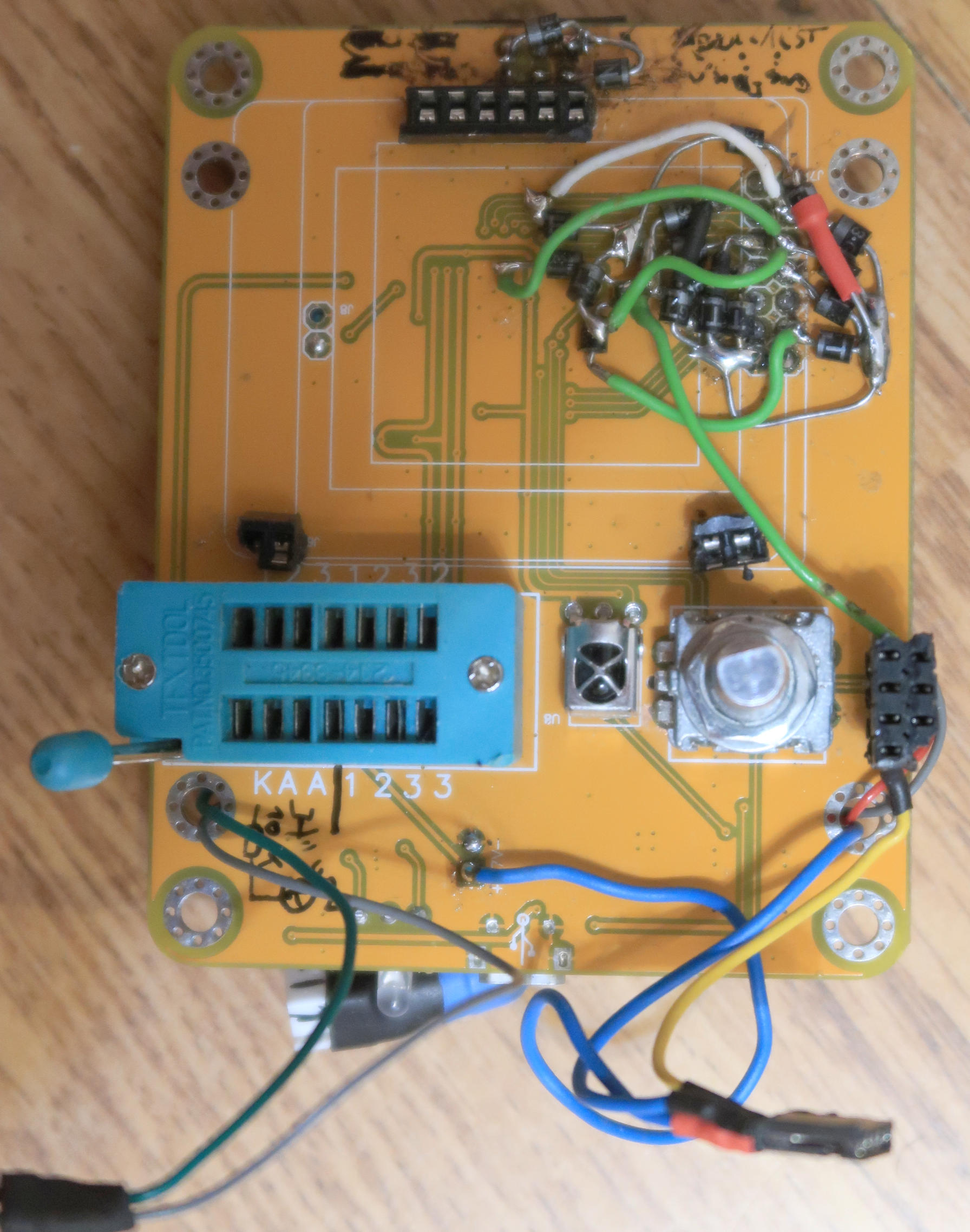

von MisterGNZ (Gast)

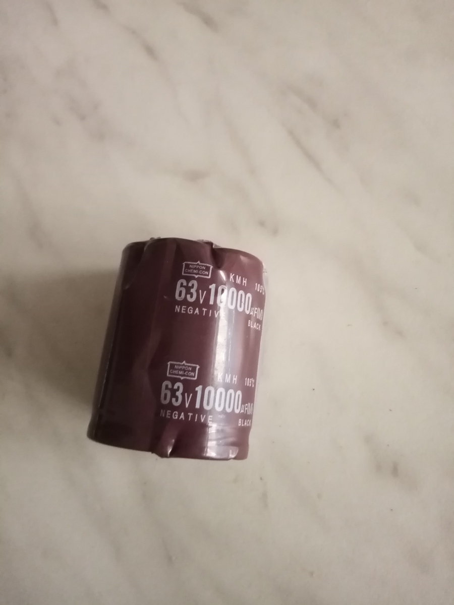

Hi everyone !, I have two nippon capacitors 10000 microfarad 63v, I
measure with the conponent tester, the first is correct, the second
measure: 33.01 millifarad (33000 microfarad), but its printed value is
10000 microfarad, ???????????? help!!!
von Marcel D. (derri)
> measure: 33.01 millifarad (33000 microfarad) …
The capacitor showing the larger value might be leaking, so the tester
needs more charge pulses to reach the reference voltage level (see
chapter 5.3.2 of the user manual).
Are you shure to have connected the two capacitors using the same
polarity (- on the lower number test pin)?
Have they been discharged completely? Note that even after a short
cicuit with a resistor such a large capacitor may restore a residual
voltage between its terminals when the short is removed. This memory
effect might influence your measurement.
Greetings, derri
Hi Derry, thanks for the explanation.
the capacitors are new with esr .01, maybe it is the component tester,
which has reading problems on large capacities
von Ben (Gast)
MisterGNZ schrieb:
> ... maybe it is the component tester,
Did you build the tester yourself or did you buy it?
Once i had the same error, and it was due to R11, I had made a mistake
in the Assembly and had soldered a wrong Resistor.
With me, also with larger Capacitor values too high values were
indicated.
In about every fifth Measurement a large Capacitor was correctly
displayed.
R11 must have a value of 10k (look at the Schematic).
When i soldered the 10k resistor, everything was measured correctly.
Would be worth a look.
von Leon T. (ltumm)
I had the same problem on 3 builds 1 2200 uF read as about 6850 uF.
After trying everything it seems to be the capacitor, I tried another
capacitor and it reads correct, both were new and bought together. Best
way is to try a lot of other capacitors and check if a few or a lot of
capacitors read much higher. If you have access to a bought capacitor
meter you could check the capacitor on that.
I noticed that the 10000 microfarad condenser, if I shake it, moves
inside, it seems that it hits the walls as if the liquid inside it has
dried, the good one does not move. capacitor to throw away?
von Klaus R. (klaus2)
...you can check it with an voltage source, resistor and measure time
until 66% of supplied voltage, its an e-fcn and then calculate C from
known R, t & V. The basic way :) But if the other C is always good very
likely the other C is bad - even if I do not really understand, why it
maybe they sold me fake nippon capacitors
Hi Klaus R. I gave 13v voltage to the capacitor, I had to disconnect
because it heated a lot, new never used, the tester component works very
well
...take it appart to se whats inside :) So, yes, its very likely fake.
Klaus.
Hi Klaus R. I opened it, look at pictures
Searching the net I found <
https://www.chemi-con.co.jp/products/relatedfiles/capacitor/catalog/KMHN-e.PDF
> on the manufacturers site. There you find the exact dimensions of your
caps. This could be a clue to determine a fake.
As of your pictures, they seem to show the original type, but your
specimens might well be a few years old. The remaining capacity is
largely dependent on storage conditions and duration, but could never
increase to the triple value of the original. So the device measured as
33.000 uF is (was) surely defective.
The fact that the cap heated up with only 13 Volts across shows that
there was something seriously wrong with it. In general, old chem-caps
may need reforming after very long storage durations, but then you must
use a series resistor of a few hundred Ohms to limit the leakage
current, and the voltage should correspond to the maximum operating
voltage of the device (63V in your case). After several hours, maybe
even days, the leakage current should drop to normal values. If this is
the case, you can still use the device. If it keeps on leaking strongly,
it is definitely dead and you should dispose of it.
I hope this helps,
derri
Hi Klaus R. I threw it immediately, in order not to have unpleasant
situations, I also have 4 RIFA18000 microfarad 35v capacitors, they too
have wrong measurements, but they work, I also have 2 ROE 10000
microfarad 50v, the measurement is ok, all new never used. I think when
a capacitor moves inside, it is to be thrown away, do you agree?
MisterGNZ schrieb:
> I think when
Yes, I do!

von Michael J. (hessemichel)
Hallo Transistortester Gemeinde
Ich schon seit Jahren stolzer Besitzer eines T4 von unseren chinesischen
Freunden.
Kurze Eckdaten:
- orange/gelbe Platine ohne Aufdruck
- Blauer Taster
- LX-12864B5 Display mit externem Backlight, 14-poligem Flachbandkabel
COG mit UC1701 Controller)
- M328P Chip mit 8 MHZ Quarz
- Chinesische Software Mtester 2.07
- Fuses Lockbyte 0xFF, H-Fuse 0xD9, L-Fuse 0xFF, E-Fuse 0xFC
Nun möchte ich ein Firmware upgrade durchführen, finde aber keine
passende Version, die das Display anspricht.
Weder 1.12k und die m-Versionen bekomme ich zum laufen.
Das Display ist ein LX-12854B5.
Nach meiner Recherche soll ein UC1701 Controller verbaut sein,
vermutlich Kompatibel zum ST7565 Controller.
Am M328P ist es scheinbar mit anderen Pins verbunden, als der Standard
Schaltplan angibt.
PD0 = RST
PD1 = A0
PD2 = SCK
PD3 = SDA
Testfirmware ist die 1.12k mit dem Makefile aus dem Verzeichnis
..\ttester_112k\trunk\mega328_T3_T4_st7565
Kompiler ist der Programmers Notepad aus meinem modifizierten
WinAVR-20100110 (GCC-Paket aus dem Arduino IDE, Anpassungen hier aus dem
Forum übernommen)
Bei meinen bisherigen Versuchen wird nur das Backlight angesprochen, der
LCD bleibt leer
Jetzt zu meiner Frage wie kann ich den Controller dazu bewegen mir eine
Anzeige auszuspucken.
Muß nur das Makefile angepasst werden?
Darf/sollte ich in der config.h rumpfuschen und dort das Pinout für das
Display ändern?
Sind noch andere Einstellungen nötig?
Über Vorschläge und Hilfestellungen bin ich sehr Dankbar.
Falls das ganze klappen sollte hab ich noch vor einen Baugleichen mit
I2c Oled mit SSD1315 Chipsatz zu bestücken, aber das ist eine andere
Baustelle

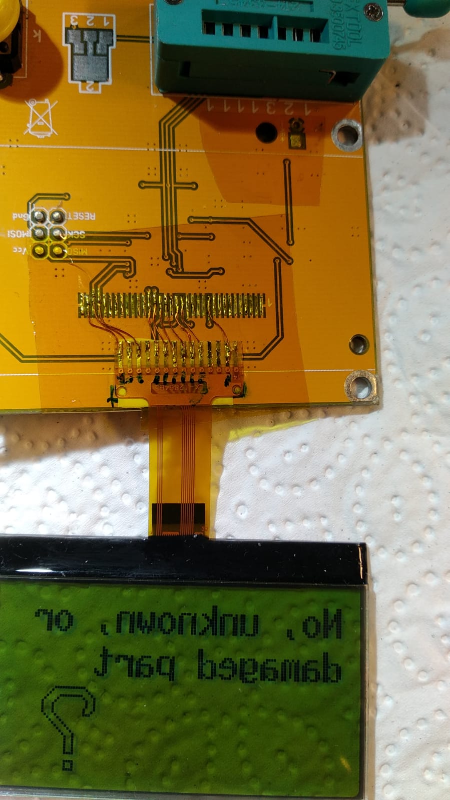

Sodele ich hab en wenig Zeit gefunden und mich erneut an dem T4
versucht.
Was hab ich gemacht?
Diverse Versionen der m- Version, beginnend ab der Version 1.34 wurden
neu Kompiliert mit angepastem Makefile, config.h und sowie config_328.h.
Als Beispiel im Anhang die Variante der Version 1.44m.
Das Kompilieren ging fehlerfrei vonstatten mit einer angepassten
WinAVR-20100110 Version.
Das tolle Microchip Studio, ehemals Atmel Studio, wollte sich mangels
ausreichenden Erfahrung und Geduld meinerseits nicht so wirklich
bedienen lassen... Ja, ich bin noch zu Doof es zu bedienen.
Jede auf diese Weise erstelle Variante war scheinbar lauffähig,
allerdings zeigt das Display immer noch nichts an.
Hintergrundbeleuchtung leuchtet munter vor sich hin, LCD zegt nicht
einen Pixel
Dann kam ich auf die Idee mal mein Multimeter zu schnappen, eine
Leuchtquelle mit Lupe und bin auf Verfolgungsjagd nach der Verbindung
von Pin am LCD zu Pin am Controller gegangen und konnte bestätigen, was
unsere russischen Kollegen auf Yandex.ru veröffentlicht haben.
https://disk.yandex.ru/d/yW8xa5NJgUo5z/LCR-T4(T3)NoStripGrid/Schematic%20diagram/LCR-T4(T3)NoStripGrid.JPG
PD0 = Reset des LCD;
PD1 = SD/CD/A0 des LCD;
PD2 = SCK des LCD;
PD3 = SDA / MOSI des LCD
Langsam gehen mir die Ideen aus.
Ist der UC1701 Chip doch nicht kompatibel zum ST7565?
LCD zickig oder defekt?
Oder haben wir einen Super-DAU? (ich)
Hast du die orig. FW gerettet? Vll probiert es ja jmd mit nem ST T4 aus.
Klaus.
von Horst O. (obelix2007)
Hallo Michael,
Deine hochgeladenen Dateien habe ich compiliert. An meinem rel. neuen T4
(hat statt der zwei Dioden einen Spannungsteiler mit Widerständen)
fünktioniert diese Firmware, allerdings steht die Anzeige auf dem Kopf,
die Portbelegung stimmt also zumindest bei meinem Display.
Im Anhang findest Du die Orginal-Firmware.
Gruß Horst
Hallo Leute.
heute hab ich mal wieder Zeit gefunden und mich mit dem Tester
beschäftigt.
Der Fehler ist gefunden, die Folienplatine hat eine Unterbrechung direkt
am LCD, sehr ärgerlich, kann ich nicht reparieren.
Naja, hilft alle nix, dann versuche ich mein Glück das Teil auf
OLED-Anzeige umzurüsten, sollte nicht all zu schwer sein.
Die nun freigewordenen Datenpins fürs ehemalige LCD könnte ich ja für
i2c nutzen, ich meine in der Config war was drinnen gestanden.
Mal schauen, ob das zu einem Erfolg führt.
Die Originaldateien hatte ich mir bei meinen ersten Versuchen mit dem
Avrdude leider zerschossen.
Man sollte nach dem Auslesen und Speichern der Daten, diese direkt als
Sicherheitskopie in einem extra Ordner ablegen und diese nach
Möglichkeit nie wieder anfassen!
Danke für das Hochladen deiner Original Firmware.
Gruß Michael

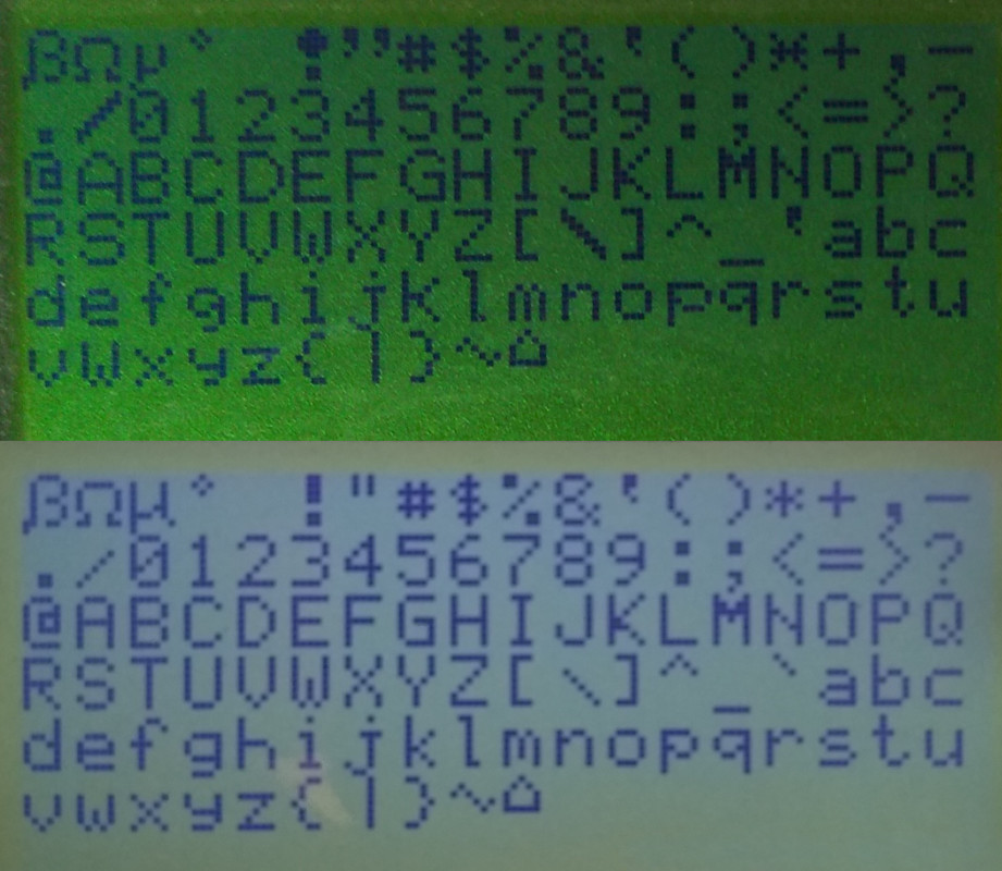

von Fuzzy Star (Gast)
Hello,
I was trying different font files for my tester with ST7108 display and
discovered some issues.
When I tried to compile with "FONT_8X8" There was an error about
language-dependent_characters. Inside the file "8x8_vertikal_LSB_1.h" it
says ' #include "language-dependent_characters" ' but it's missing the
'.h' extension. After correcting it I was able to compile. But I didn't
like the 8-pixel-high character rows touching each other.
I wanted to try another font and I saw there is a '7x8_vertikal_LSB_1'
font file in the fonts folder but it isn't listed in the make file
section:
"If option WITH_LCD_ST7565 is present one of the following fonts should
be choosen."
Then I added "CFLAGS += -DFONT_7X8" to the list and compiled with it and
it works. I liked the font size but I didn't like some characters. So, I
modified the following characters for consistency and my liking:
μ ! " & * / 3 A D G J M Q S \ ^ _ ` f g k m p s t w y
Attached the font file if others would like to use it. Also attached a
comparison photo of the original and modified font on my display.

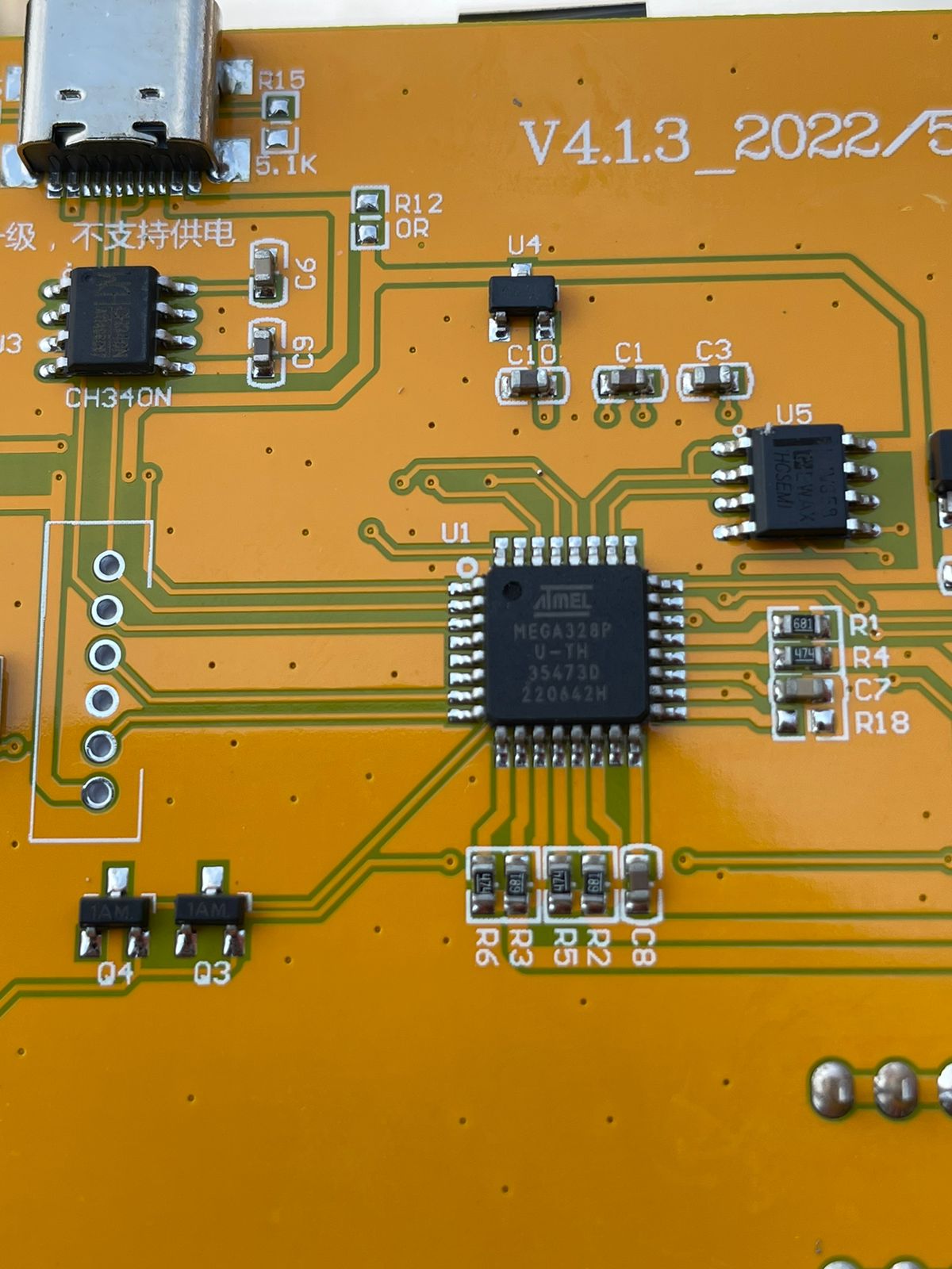

stelle mir einen neuen User aus Indonesien vor..
Gestern habe ich den neusten Typ LCR T4 gefunden.
Vielleicht ist es aus China.
weil ich es vom lokalen Markt in Indonesien bekommen habe.
Auf diesem Board sehe ich ganz anders als der LCR T4 Typ allgemein aus
China..
Es gibt eine neue unterstützende Komponente..
1. Das ist das Auffälligste. Es gibt eine Komponente LMV358. Ich weiß
nicht, wofür es funktioniert.
2. Es gibt USB-Typ-C- und CH340-Treiber mit Paketen vom Typ sop8. es
funktioniert für software upgrade (nicht für stromversorgung)
3. Es gibt eine SMD-Taste. weiß nicht wofür..
4. Im Batterieeingang befindet sich ein SMD-Mosfet ... gekennzeichnet
mit 3401
5. Es gibt eine neue Komponente. mit Markencode 6624. Wahrscheinlich als
Ersatz für tl431. Überprüfen Sie die U4-Komponenten
und in dieser Schaltung verwendet der Transistor 2n3904 (1AM)
Vielleicht gibt es Freunde, die diese neueste Art von LCR
T4-Hardware-Update bereits kennen.
Hier können Sie Ihre Erfahrungen teilen
von AdityaWahyuArdiansah (aditya_wahyu_a)
Nachdem ich nachgesehen habe ... verwendet der Chip Atmega328PU-TH
von Markus R. (madires)
Die T4 mit der Platine "V4.1.3_2022/5/18" haben wahrscheinlich alle
einen APT32F172K8T6 mit gefälschter Atmel-Beschriftung statt einem
echten ATmega328. Man sieht das an den unterschiedlichen Pins zur
Stromversorgung. Inzwischen sind auch T7 mit dieser MCU aufgetaucht.
Die haben bisher immer die Beschriftung "MEGA328P  U-TH  35473D /
220642H" und werden nicht von den OSHW-Firmwares unterstützt. Auch
sollen die Tester mit APT32F172K8T6 merklich schlechter laufen.
Daneben gibt es Tester mit LGT8F328P, einem ATmega-Clone, der allerdings
mehrere Unterschiede hat. Die gute Nachricht ist, dass jemand angefangen
hat, die m-Firmware dafür anzupassen.
Danke für die Antwort, Herr Markus..
möge Gesundheit immer gegeben sein...
Ich bin auch verwirrt, Sir, weil ich überprüft habe, dass sich die
Pinbelegung erheblich vom atmega328 unterscheidet.
am seltsamsten sind die RX- und TX-Pins zur MCU. dies unterscheidet sich
offensichtlich sehr von atmega328
wenn ich mir die Form (das GEHÄUSE) der MCU ansehe, ist sie etwas dicker
als die atmega328. es ist wie bei der LGT MCU..
aber für seine pinbelegung ähnlich wie MCU APT
es riecht jetzt wieder nach vielen ATmega328-Klonen, daher ist es
schwer, den Unterschied zu erkennen, Sir
von Dirk S. (dirksan)
Markus R. schrieb:
> Dirk S. schrieb:
>> - Ist obiges Fehlerbild das eines geschädigten/defekten ST7565
>> Conntrollers
>>   => Display tauschen und 3,3V Spannungsregler nachrüsten
> Gut möglich. Ob es die zu hohen Spannungen oder Alterserscheinungen
> sind, kann ich nicht sagen.
Hallo Markus,
vielen Dank für die freundliche Antwort.
Habe das Problem mit dem Display mittlerweise ausmachen können - es war
ein Haarriss im Flachbandkabel kurz vor dem eigentlichen Display.
Beim Einlöten musste ich dann feststellen, dass ich versehentlich den
falschen Anschluß bestellt hatte. Sollte das ausser mir noch jemandem
passieren (und sei es auch nur wegen Beschaffungsengpässen) poste ich
hier mal ein Bild, wie es dann trotzdem funktionierte ;-) Und ja, das
geht schöner... aber es war halb drei Uhr morgens... ;-)
Grüße,
Dirk

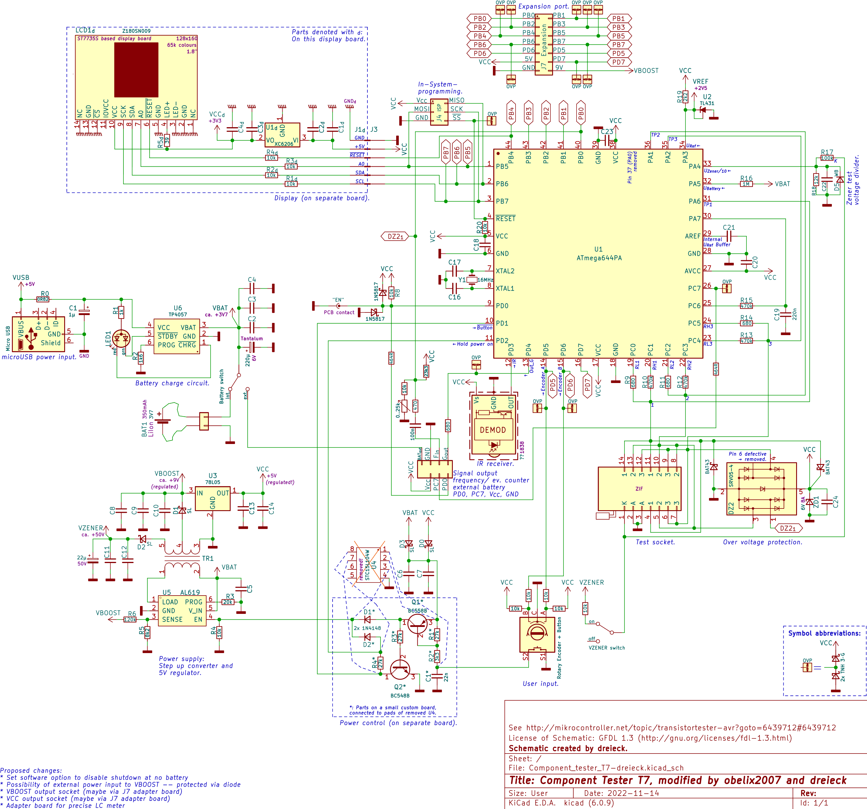

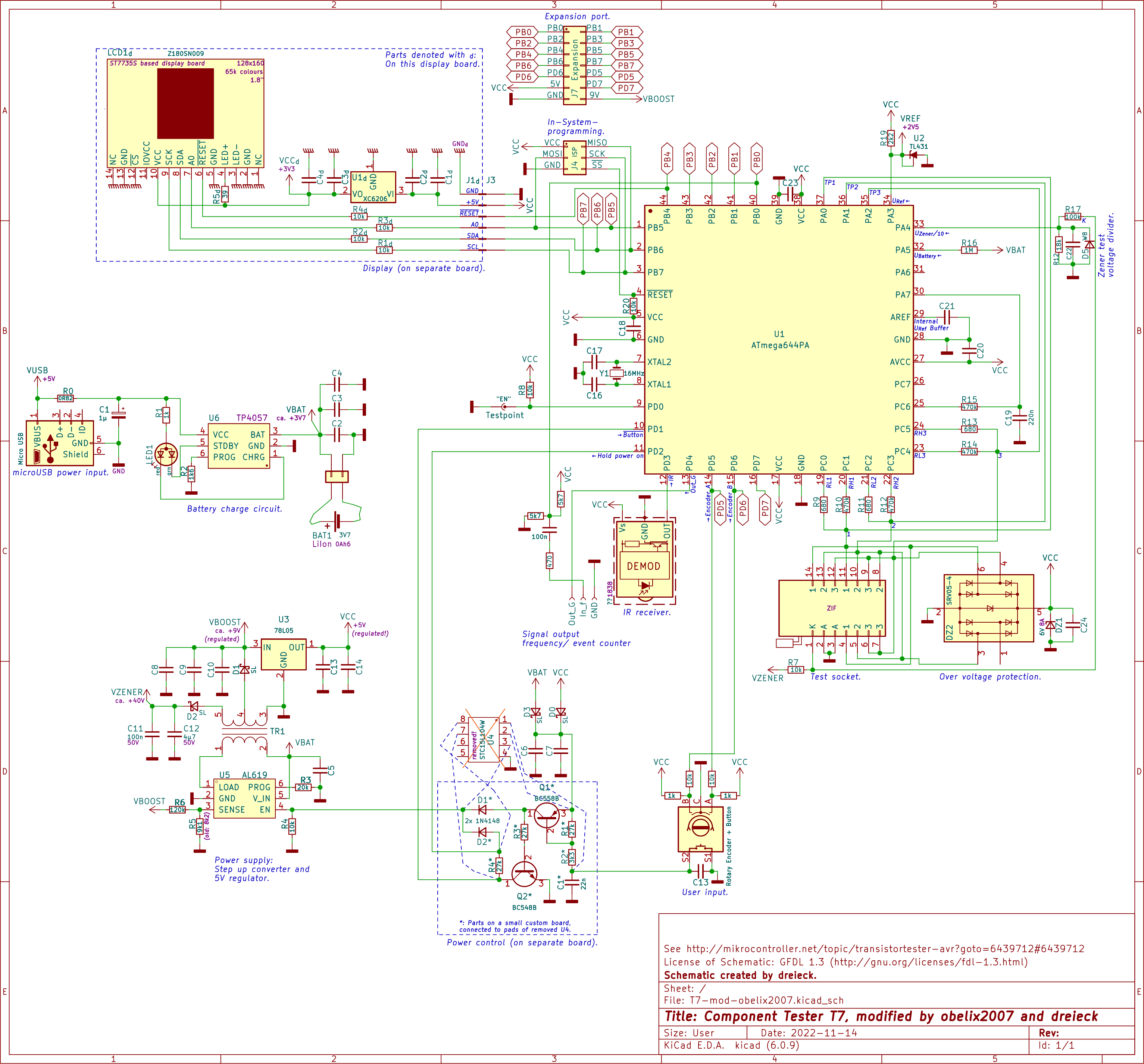

Wozu ist C19 da? Im
[Schaltplan](/attachment/575725/LCR-TC1_T7_M644_.png) hängt C19 an einem
Pin des µC, und über einen 470k-Widerstand (R15) an einem anderen Pin
des µC. Ansonsten sind diese beiden Pins mit nichts weiter beschaltet.
Ist C19 eine Kapazitätsreferenz/ sind R15+C19 als RC-Glied eine
Zeitreferenz für irgend etwas?
Im Foto Deiner Modifikation (von
[hier](/topic/transistortester-avr?goto=6439712#6439712) genommen) sehe
ich da noch einen weiteren Widerstand, der mit eine Rolle spielt.
Ich habe Dein Foto annotiert -- siehe Anhang zu diesem Beitrag. -- sind
C19 und R15 in meiner Kommentierung richtig zugewiesen oder ist R15
(immernoch, entsprechend Platinenbedrucking) das Bauteil was ich mit
"??" bezeichnet habe? Was ist der zweite Widerstand, womit ist der
Verbunden -- laut Schaltplan sollten nur ein Widerstand und ein
Kondensator da sein.
Auf jeden Fall ist bei mir an der Stelle tatsächlich was kaputt:
Der bedrahtete Widerstand und der bedrahtete Kondensator sind beide von
den SMD-Lötpads losgerissen. Der mit "??" bezeichnete Widerstand ist
nicht mehr da.
Kann ich also einfach wieder festlöten! Bevor ich das mache: Gehört der
470k-SMD-Widerstand da auch wieder hin (wie auf Deinem Foto zu sehen),
oder nicht (wie es nach Schaltplan der Fall wäre?) -- Den würde ich
nämlich sonst zuerst hinlöten.
Hallo Holger,
... bei den 3 Testern (TC1, T7, T7-H), die ich umgebaut habe war der C19
immer knapp an der Kapazitätsgrenze > 100 nF. Die Firmware der Chinesen
hat sich nicht darum gekümmert, aber um die kh-Software oder die
m-Software darauf laufen zu lassen, habe ich C19 jeweils auf 220nF
Folientyp getauscht. Dabei ist auch R15 mit gewechselt worden.
Diese Beschaltung wird zum Autoabgleich benötigt.
Der „alte“ R15 ist da nicht mehr drin, und wenn, so dient er einseitig
als „Lötstütze“.
Falls C19 und R15 keinen Kontakt mehr zu Pin 25,30 und GND haben,
solltest Du den wieder laut Schaltplan so herstellen.
Gruß Horst

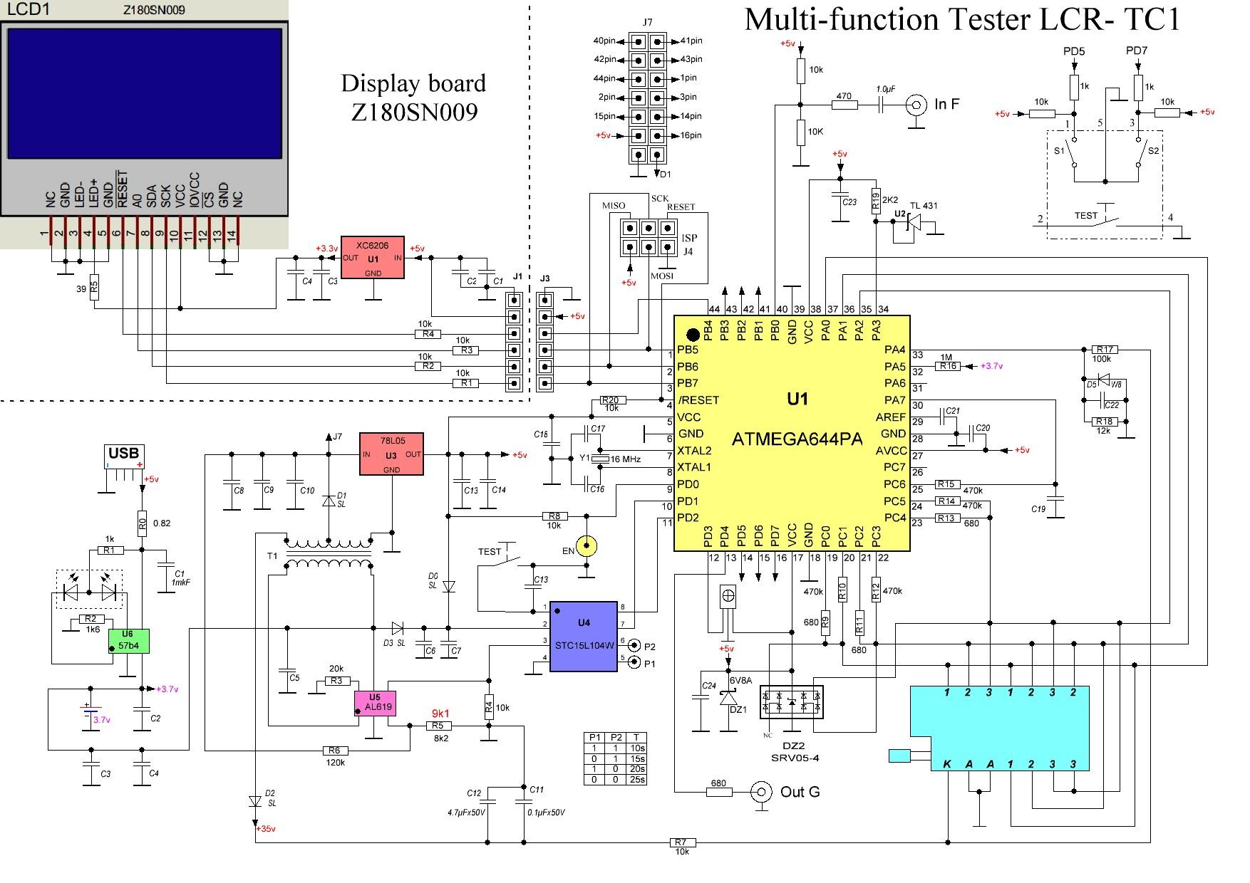

Hast Du Deinen Schaltplan eigentlich auch als Originaldatei? (Du hattest
mal eine JPEG-Datei eingestellt, jetzt eine PNG-Datei die
augenscheinlich aus JPEG erstellt wurde (jedenfalls sind auch da
deutliche Artefakte sichtbar), zum Weiterarbeiten ist eine Vektorgrafik
oder die Schaltplan-Erstellungs-Software-Datei gut.) Ich will meine
Modifikation (physischer Aus-Schalter) mit einarbeiten.
Ich habe noch ein paar andere Fragen zur Schaltung, die mir bei genauem
Hinsehen kamen:
* Im Schaltplan gibt es einen IC U4, Typ STC15L104W. Dies ist auch
irgend ein Mikrocontroller wie ich rausfand. Aber wo ist der auf der
Platine? Bin ich blind?
  Ich sehe einen unbestückten Platz, markiert mit U4 da, wo Deine kleine
blaue Platine mit dem BC557B und dem BC550B-Transistor und vier
Widerständen und zwei Dioden und einem 220nF-Kondensator ansetzt. Hast
Du beim Umbau den U4 entfernt und durch erwähnte Platine ersetzt (es
sieht so aus, als war da mal was angelötet)? Wenn ja, hast Du davon die
korrekte Schaltung, ohne den nicht mehr vorhandenen STC15L104W?
* Schaltregler U5, ein AK619: Ich wollte mal ein Datenblatt dazu finden
wurde aber nicht fündig. Hat wer eines dazu?
* Akku-Laderegler U6, ein 57b4: Ich wollte mal ein Datenblatt dazu
finden und fand dazu [diesen
Thread](https://www.eevblog.com/forum/projects/help-identifying-ic-131357/).
Demnach sei das ein TP4057, für den es nur chinesische Datenblätter gebe
(ich habe auch nichts anderes gefunden). Hat wer zufällig doch ein
Englisches Datenblatt für genau diesen IC?

Zu U4:
Es handelt sich hierbei um einen zusätzlichen Microcontroller, der für
das Starten des Programms genutzt wird und nach der Messung zur
Festlegung der Abschaltzeit. Es gibt im Netz Anleitungen zum
Umprogrammieren.
Für mich ist es einfacher, die kleine blaue Lochraster-Platine (TC1-Mod,
Lösung von Markus) zu bauen und stattdessen einzusetzen.
Gruß Horst

https://github.com/madires/Transistortester-Warehouse/raw/master/Hardware/TC1-Mod.pdf
Hast Du die (Vektor-/ Schaltplaneditier-)-Datei des Schaltplans, den Du
hier eingestellt hast? Da ist U4 nämlich noch drin und Deine blaue
Platine nicht. Würde gerne den "ist"-Status auf Schaltplan haben und,
wenn Du das nicht selber hast, selbst noch machen.
Und C19, wozu ist der gut? Ist das ein Spannungspuffer für den in der
Doku erwähnten Abgleich des internen Komparators?, und der exakte Wert
von R15 und C19 ist nicht wichtig?

Und: Was für ein Display ist da angeschlossen -- ich lese "Z180SN009" in
Deinem Schaltplan, aber den String "180SN" und auch "Z180" finde ich
weder in einer `config.h`/ `config_<MCU>.h`, noch in der `README` oder
in der PDF-Doku. Was muss ich da auswählen?

OK, habe den direkten Anschluss von Testpin 1 vom µC-Pin 37 (PA0) zum
µC-Pin 31 (PA6) verlegt.
Ich habe dann erstmal das 1.45m-Firmware-Archiv von obelix2007 genutzt
was mit dem Gerät kam, und habe alleinig
#define TP1              PA0       /* test pin / probe #1 */
geändert zu
#define TP1              PA6       /* test pin / probe #1 */
make clean
make
make fuses
make upload
lief erfolgreich durch.
Nun startet der Tester mit der gleichen Fehlermeldung, allerdings ist
die angezeigt Spannung im 1-2 Volt-Bereich:
Batterie?
1: 1310 mV
(Auch mal im Bereich 15xx mV).
Auch wenn ich Testpin 1 mit Testpin 2, 3 oder GND verbinde.
Kann es sein, dass hier
> Lower 3 pins of the port must be used for probes.
zuschlägt, oder wäre das Symptom dann anders?
Weiß jemand ob:
Ist das durch eine einfache Änderung im Code umgehbar?
Um das Gerät noch zu Dingen wie ESR-Abschätzung zu verwenden, dachte ich
mir dann tausche ich die Definitionen von Testpin 1 und Testpin 2 (so
dass, für die Software, Testpin 2 der problematische wird, und die
"Spezialmessungen" an 2-poligen Bauteilen, die ja Testpin 1 und Testpin
3 wollen, weiterhin gemacht werden können).
Nun habe ich in der `config_644.h` einfach folgende defines getauscht:
* `#define TP1` und `#define TP2`,
* `#define R_RL_1` und `#define R_RL_2`,
* `#define R_RH_1` und `#define R_RH_2`.
Auch nach diesem Tausch (make clean, neu kompliliert, neu geflasht)
kommt noch die Meldung "Batterie?" mit Testpin 1(!).
In der `config_644.h` steht auch
> Please don't change the definitions of TP1, TP2 and TP3!
Kann es sein, dass man die gar nicht vertauschen kann?, kann es sein,
dass TP1 immer am niedrigsten Pin des gewählten Ports ist?
(Dass ich die richtige Datei bearbeite und das Flashen geht, habe ich
geprüft in dem ich einfach mal `#define TP_REF` und `#define TP_BAT`
getauscht habe und die Batteriespannungs-Anzeige beim startup dann eben
~2.5 V war.)
Es zeigte sich übrigens, dass das Problem wo anders war:
Als ich den µC-Pin 37 abgesäbelt hatte, gab es immernoch die ca. 15 Ohm
von Testpin 1 nach GND. Es zeigte sich, dass das Problem in der
Schutzdiodenschaltung DZ2 lag. Als ich den Pin von DZ2, der zu Testpin 1
gehört, abgesäbelt hatte, war Testpin 1 wieder hochohmig nach GND. Nun
war der µC-Pin 37 allerdings schon weg ... also dennoch Testpin 1 mit
µC-Pin 31 verbunden, neue Schutzdioden (2x BAT43) an Testpin 1, und
Firmware wie oben beschrieben geändert und beschriebenes Resultat
gesehen.

Holger B. schrieb:
> Hast Du [@obelix2007]Deinen Schaltplan eigentlich auch als Originaldatei?
> (Du hattest mal eine JPEG-Datei eingestellt, jetzt eine PNG-Datei die
Da von Dir keine Antwort dazu kam gehe ich davon aus, dass Du das nicht
hast.
Ich habe daher jetzt mit Kicad den Schaltplan neu gemacht.
Basis: Deine PNG-Datei [1], die "TC1-mod.pdf" [2], und mein Gerät bei
dem ich eine andere Beschaltung des Encoders feststellte (10k statt 1k
Widerstände; PD6 statt PD7.)
Ist angehangen.
Schau' doch bitte mal drauf ob das korrekt ist, oder ob da andere Sachen
grob ungut sind, bevor ich das einem Repository hinzufüge.
[1] Schaltplan T7 von "obelix2007":
https://www.mikrocontroller.net/attachment/575725/LCR-TC1_T7_M644_.png
[2] Power-Controller-Modifikation am TC-1:
... Du hast Pin 1 und Pin 3 des ZIF-Sockels kurzgeschlossen, Pin 3
gehört an Pin 4 oder 1 von DZ2! Den Rest habe ich nicht geprüft, mir
reichten die PNGs.
Horst
von Holger B. (dreieck)
Oh, das hat Kicad gemacht, vermutlich bei einem Verschiebevorgang. Ich
habe eine andere Führung vor dem Inneren Auge. (Zum Verschieben bereits
vorhandener Schaltungselemente finde ich Kicad sehr nervig.)
V.A. Check, ob ich Deine Modifikationen korrekt und vollständig
wiedergegeben habe, ist Kern meiner Bitte. Schließlich sind Deine
Modifikationen ja nicht (komplett) in der von Dir geteilten Datei, kann
gut sein dass ich beim Versuch, das in einen Schaltplan
zusammenzu"kompilieren" was grundsätzlich falsch gemacht habe.
... nimm einen Durchgangstester und prüfe die Verbindungen. Schließlich
> Im übrigen waren die Pläne der Ausgangspunkt der Modifikationen und es sind
meine Änderungen nicht in den Plänen, die von Indman im eevblog veröffentlicht
wurden.
Achso. Ich dachte bis eben diese Datei käme von Dir, weil Du sie immer
einfach mit Deiner modifizierten Variante mitgeliefert/gepostet hast.
Das ändert natürlich sehr meine Prämissen zu diesem Thema und macht
klar, dass Du nicht Ansprechperson zu diesem Schaltplan bist.
Danke für die Klärung wie die Informationen zusammengehören!
Ich habe jetzt durchgemessen und noch einige Abweichungen festgestellt
(und einen Fehler meinerseits).
Anbei nun ein Schaltplan, mit dem sich denke ich arbeiten lässt.
Falls interesse besteht dass das Eingang in die Doku findet (ist das
relevant?): Wo liefere ich das am besten ab/ bei welchem repository
checke ich das am besten ein?
https://github.com/madires/Transistortester-Warehouse/, oder wo anders?
Ich würde dann noch einen Text Metainformationen dazuschreiben.
Gruß!
... habe noch einen Fehler gefunden:
Du hast R13 und R14 vertauscht!
Gruß Horst
... im Übrigen, von den TC1 und T7 gibt es so viele Variationen und
"Fakes", da ist der Überblick schwer.
Die bei den versch. Quellen angebotenen Nachbauten haben alle keinen
Atmega644 eingebaut, so dass Deine Dokumentation hier nicht viel bringt.
Die paar Umbauten von mir und Indmann sind ja auch schon bestens
Dokumentiert. (siehe aktuelle Clone-Comparison-Chart.pdf)
Gruß Horst

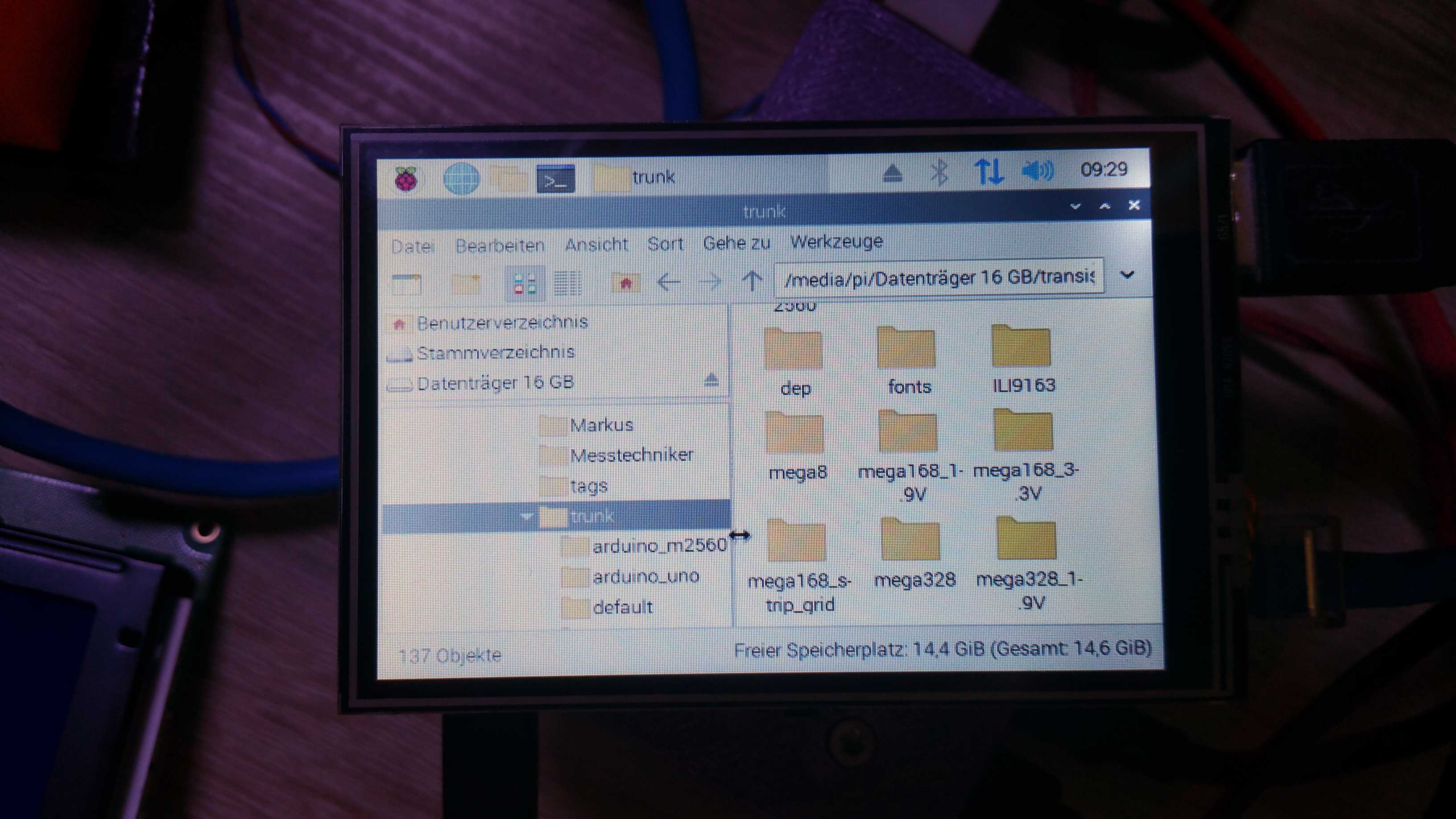

von andy171 (Gast)
Hallo an Alle,
Ich versuch gerade dieses Display (im Anhang) zum laufen zu bringen,Ich
hab es so angeschlossen wie in der Doku 1.13 K von K.H.nach Bild 2.12
mit HC164.
Die Schaltung für den 328P hab Ich schon lange am laufen mit 2004
Display, nur jetzt gelingt es mir nicht mit dem 128x64 Display.
Grüße Andreas
von andy171 (Gast)
Hallo nochmal!
Ich hab das mit dem Display gelöst!
Hatte einen Fehler beim erstellen der Files, ich hatte die Polarietät
des Displays auf Low.
Grüße Andreas
... zeige uns doch mal ein Bild von Deinem Selbstbauprojekt?
Gruß Horst
von andy171 (Gast)
Hallo !!!
Jetzt mal die Bilder von mir, Ich nehme fürs kombilieren ein Raspberry
Pi3.
Zum Programmieren bzw. flashen soll es auch noch das Raspi werden,
aktuell nehme ich zum flashen Atmel studio 7, STK500 und Win 10.
Meinen Alten hab Ich schon ein paar Jahre, so genau weiß ich das nicht
mehr.
Die auf dem Foto zu erkennende Platine ist auch in etwas verbesserter
Variante in meinem Alten drinnen.
Auf meiner Platine ist auch eine Ladungspumpe verbaut (ICL7660), wegen
der alten Displays 1602 und 2004.
Freundliche Grüße
Andreas

so, ich habe nun an meinem Komponententester (von @obelix2007 umgebauter
T7) noch etwas gebastelt.
Und zwar:
* Intern waren schon Löt-Löcher für einen Erweiterungsanschluss
vorhanden (einige Microcontrollerpins sowie Versorgungsspannungen). Ich
habe dort eine Buchsenleiste angelötet sowie ins Gehäuse die passende
Aussparung gefräst.
* Alle Microcontroller-Anschlüsse, die irgendwie ins freie Geraten,
wurden mit Schutzdioden versehen.
* Eingangsimpedanz Frequenzmessung/ Impulszählung erhöht, und
Ruhespannung am dazugehörigen Microcontroller-PIN nun justierbar.
* Pull-Up-Widerstände am Drehencoder von 1k auf 10k erhöht (Verringerung
der Stromaufnahme; der Encoder kann in der Ruhestellung ja auch mal
geschlossene Kontakte haben, da würden sonst dauernd 5mA schon allein
deswegen fließen).
* Der Signalgenerator-Ausgang, der von @obelix2007 nachgerüstet wurde,
wurde mit einem 680-Ohm-Kurzschlussschutzwiderstand versehen.
* Es wurde die Zener-Spannung über ein Kippschalter abschaltbar gemacht.
Somit kann der Zener-Messanschluss auch zum messen von Spannungen
verwendet werden.
* Der interne Akku ist über einen Kippschalter nun abschaltbar.
* Über den selben Schalter, über den der interne Akku abgeklemmt werden
kann, wird stattdessen, wenn der interne Akku abgeschaltet ist, ein
zusätzlich hinzugefügter Anschluss anstatt des internen Akkus
zugeschaltet. Somit kann das Gerät als "poor man"s LiIon-Akku Lade-/
Spannungsprüfgerät verwendet werden.
* Auf der Platine einen 220µF-Kondensator dorthin gelötet wo der Akku
hingehört. Scheint nötig damit mit nur-USB-Versorgung (ohne Akku) das
Ding angeht, ggf. zum Puffern von Spannungsspitzen, denn der
Akku-Lade-IC, durch den der gesamte Strom vom USB auch geht, hat einen
Kurzschlussstrom von unter 90 mA, und anscheinend auch eine
nicht-konstante Leerlauf-Ausgangsspannung wenn kein Puffer dranhängt.
* Zener-Dioden-Spannung mit einem zusätzlichen 22µF-Kondensator
gepuffert.
* Weiterhin wurden die noch brach liegenden Microconteoller-Anschlüsse
PD0 und PC7 rausgeführt.
* Der Anschluss, an dem bisher Eingang für Frequenzmessung/
Impulszählung, Signalgenerator-Ausgang und GND anlagen, wurde getauscht
gegen eine Buchsenleiste an der nun folgende Signale anliegen:
  - GND,
  - +5V,
  - Anschlussmöglichkeit externer Akku,
  - Eingang Frequenzmessung/ Impulszählung,
  - Ausgang Signalgenerator,
  - PC7,
  - PD0.
* Das Display ist nun steckbar, dies war nötig damit ich die
Überspannungs-Schutzdioden am Erweiterungsport anbringen konnte.
Anbei aktueller Schaltplan und ein paar Fotos.
Für den nun frei liegenden Erweiterungsport möchte ich bei Gelegenheit
mal die Präzisere LC-Messerweiterung bauen.
Für die Impulszählung möchte ich noch einen ansteckbaren Taster bauen,
so dass ich Tastendrücke zählen kann.
Eine FRAGE habe ich noch:
Auf der Platine ist ja so ein Kontakt der mit "EN" gelabelt ist. Hängt
am PD0-Pin des Microcontroller, der mit 10k nach VCC gezogen ist. Die
Gegenseite des Kontaktes ist auf Masse. (Vgl. Schaltplan.)
Bedienbar ist der Kontakt nur bei geöffnetem Gerät durch herstellen
eines Kurzschlusses auf der Platine.
Wozu ist das Ding da? Hat das Ding in der "m" oder "k"-Firmware eine
Funktion, oder ist das nur ein Relikt von der China-Firmware für irgend
eine Debug-/Service-Funktion? (Wenn es keine aktuelle Funktion mehr hat
würde ich den Pull-Up-Widerstand entfernen wollen, um einen "sauberen"
PD0-Port zu haben. Oder ist an genau dem Port aus anderen Gründen ein
externer Pull-Up-Widerstand sinnvoll?)
Lieber Gruß!,
und danke allen, die hier so fleißig beigetragen haben!
Ahoj,
zu der Frequenzmess- und Impulszählerweiterung (einfache Variante) habe
ich ein Unverständnis:
Wenn ich mir die Doku
https://github.com/madires/Transistortester-Warehouse/raw/master/Documentation/English/ttester-1.13k.Bohu.pdf
anschaue -- sowie Schaltpläne (Schaltplan angehangen) (und auch das
Gerät welches ich erhalten habe), so ist der Frequenzeingang über einen
470-Ohm-Widerstand und einen Entkoppelkondensator an einen
Mikrocontroller-Pin geführt. Über einen Spannungsteiler wird eine feste
DC-Spannung an dem Pin eingestellt.
Nun kann dies, wenn ich eine Freqzenz mit TTL-Pegel messen will, dies
doch zu Überspannung am Mikrocontroller führen:
Wenn der Frequenzeingang an die zu messende Stelle geschaltet wird, und
da erstmal eine konstante Gleichspannung von z.B. 0V anliegt, dann
stellt sich am Mikrocontroller-Pin über den Spannungsteiler und wegen
der Entkopplung durch den Kondensator ca. 2.5V ein. Der Kondensator ist
mit 2.5V aufgeladen.
Nun ändert sich das Eingangssignal zu 5V. Am Mikrocontroller-Pin liegen
nun, über den Kondensator, knapp 7.5V an!, strombegrenzt nur über den
470-Ohm-Widerstand.
Ist das wirklich so zulässig? Müssen da nicht noch zusätzliche
Schutzdioden hin?
Gruß!
> Schutzdioden hin?
Solange es nur wenige mA sind, sind die internen Klemmdioden vom ATmega
ausreichend.

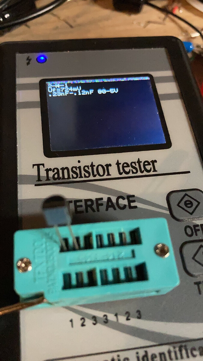

hello guys, i have a problem, i programmed atmega328p, with fusebit low:
F7, high: DF, ext: F9, quartz 16MHZ, but, when I turn on the component
tester, with 16x02 display, all squares appear to me, with the writing :
eta, but if I put a capacitor, on pidini 1e3 it works regularly, what
can be the cause ???
Have you also programmed the EEPROM?

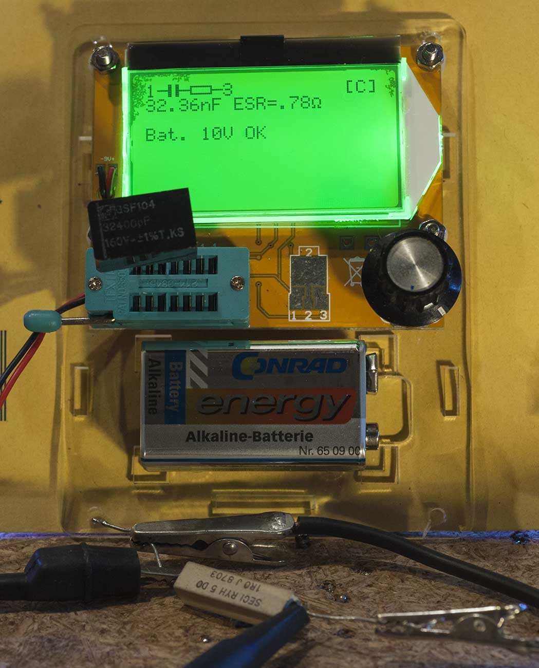

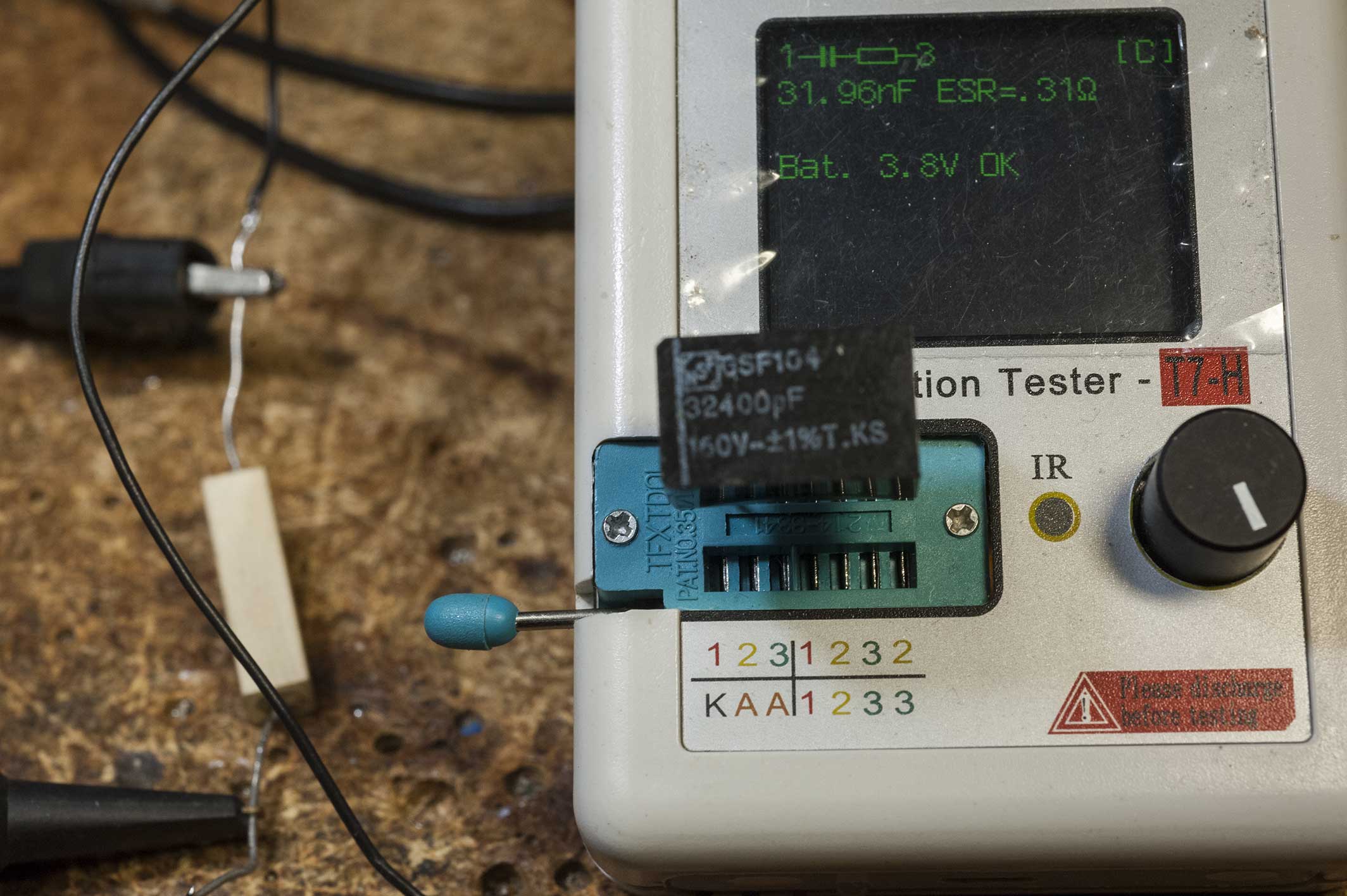

von Lukey S. (lukey3332)
Hallo Zusammen,
Ich habe den Joy-It JT-LCR-T7 und will ein paar alte Kondensatoren
testen.
Laut wiki wird ja ab 20 nF der ESR angezeit. Allerdings ist das bei mir
nicht so: Ich hab jetzt mehrere Kondensatoren >= 100uF getestet und nur
ab und zu wird der ESR angezeit.
Bei brandneuen Low-ESR Kondensatoren wird der ESR garnicht angezeigt.
Wie sind diese messungen zu Interpretieren? Kein ESR = Niedriger ESR?
von Ingo W. (uebrig) Benutzerseite
Würde ich so sehen. Schalte doch mal einen Widerstand von einigen Ohm in
Reihe!
Ich weiss nicht, ob es deinen Tester betrifft, aber wegen den aktuell
hohen Preisen für ATmegas kommen manche Tester mit LGT8F328P oder
APT32F172K8T6 als MCU. Die Hersteller dieser Tester haben die Firmware
nicht wirklich an die anderen MCUs angepasst, und deshalb liefern die
Tester u.A. bei der ESR-Messung keine brauchbaren Ergebnisse. Ansonsten
nicht vergessen, den Selbstabgleich laufen zu lassen.
