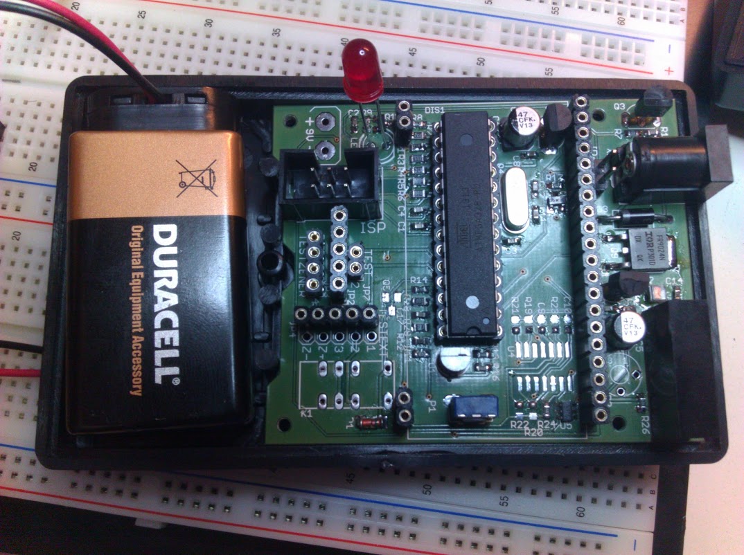

So, habe mein Layout dann auch mal bestückt, und gleich noch zwei
Probleme festgestellt. Die werden aber bis zur finalen Version auch noch
behoben, bzw sind es in den aktuellen Eagle-Files auch.
Nun muss die nächste Reichelt-Bestellung nur noch das passende Display
bringen, ich vermute mal die LCD-Routine muss für das DOGM leicht
angepasst werden, was die Initialisierung angeht. Aber das hat
Karl-Heinz ja schön ausgelagert in eine eigene Datei, die sogar per
Makefile auswählbar ist.

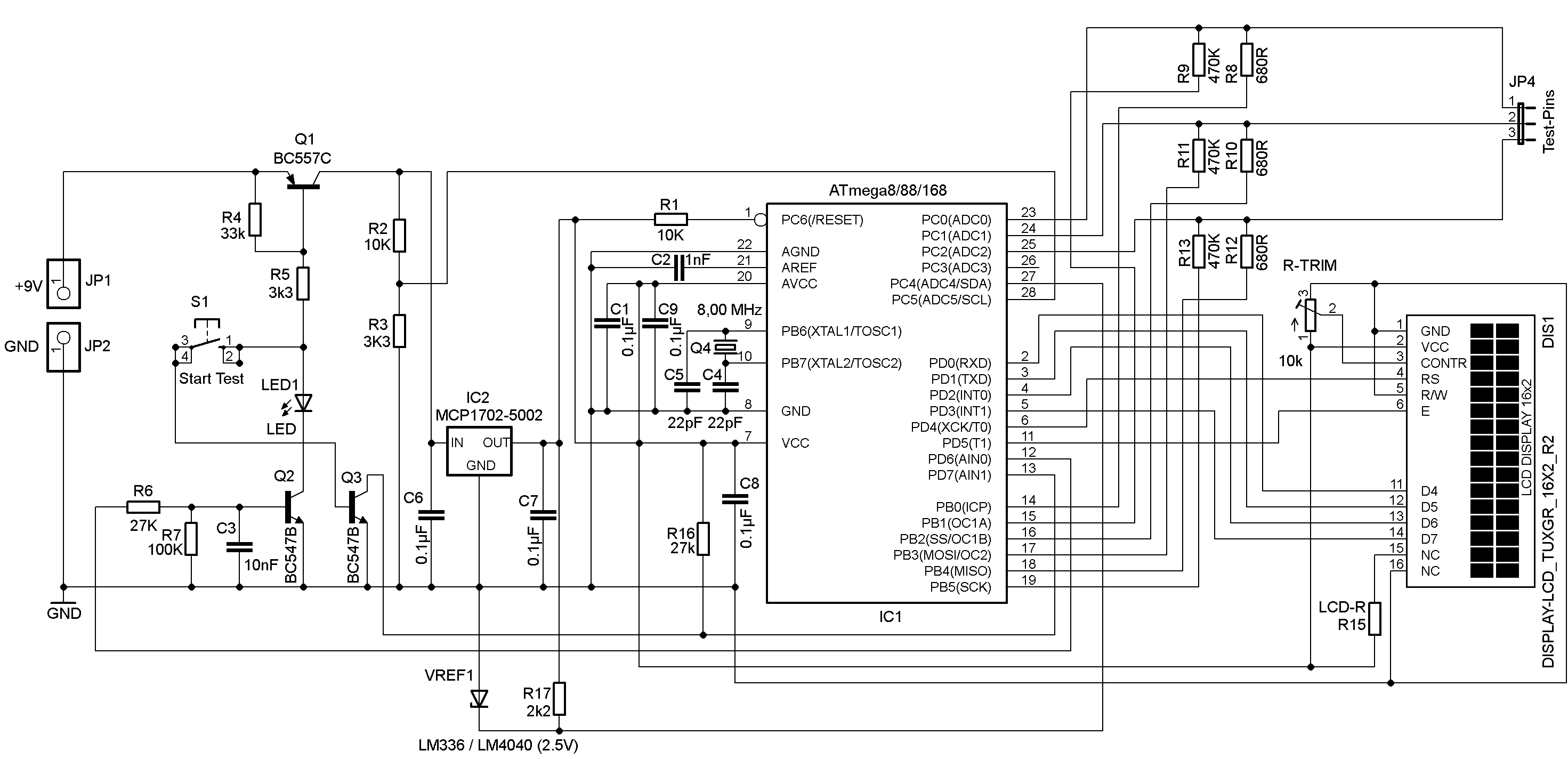

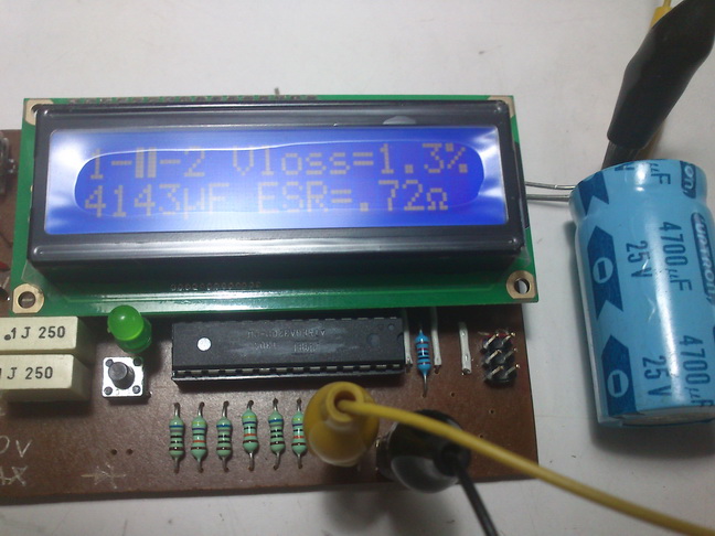

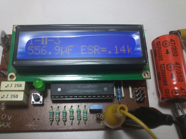

Hi guys,
I have upgraded my M8 transistor tester with M328/external 8MHz xtal
using tom666 hex/eep/fuse bits. done all the hardware modifications as
well. and also the firware selfcheck. all is working ok until I measure
capacitor:
I can not read ESR because of ">>>><" on LCD... that also appears when I
check resistors in the <1ohm range...
are there any software fix for this?
thanks all :)

von mj m. (emjay)
Hi tom666,
 sorry my bad! I forgot to remove the 100nF smd cap at Vref. you
sometimes overlook things because of the size of this smd. now it works
OK after I re-run the self-test. :)

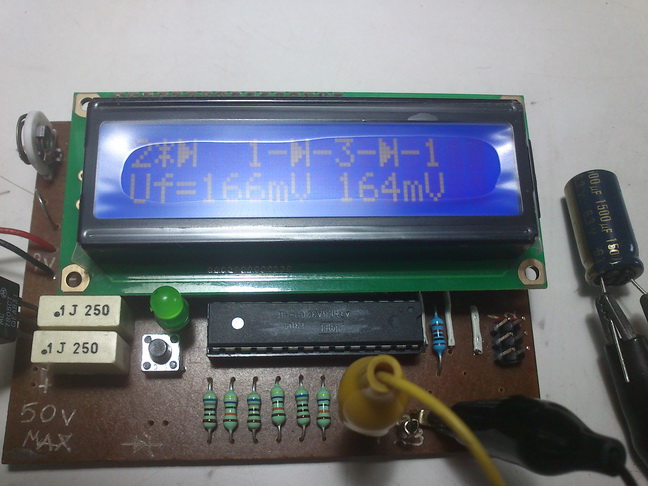

von mj m. (emjay)
Hi Karl
 can recompiling be done in windows environment? maybe you could post
here hex/eep with Vext enabled?
during my parts testing, here is what I have found out:
-> 2N5060 (it reads as diode)
-> 1 watt white LED , sometimes it registers as pF cap
-> 1 Farad 2.5v registers as "cell" ( I know its out of range, I just
tested it :) )
MJ

I do not know the reason, why your 2N5060 (thyristor) is not detected.
A white power LED is not tested by myself, but you should prevent effect
of external light for testing.
The 1 Farad capacitor is probably a "gold foil" type, which have always
a high impedance (ESR). The detection of this type is not possible, even
if the capacity value is within the specification (< 0.1F).

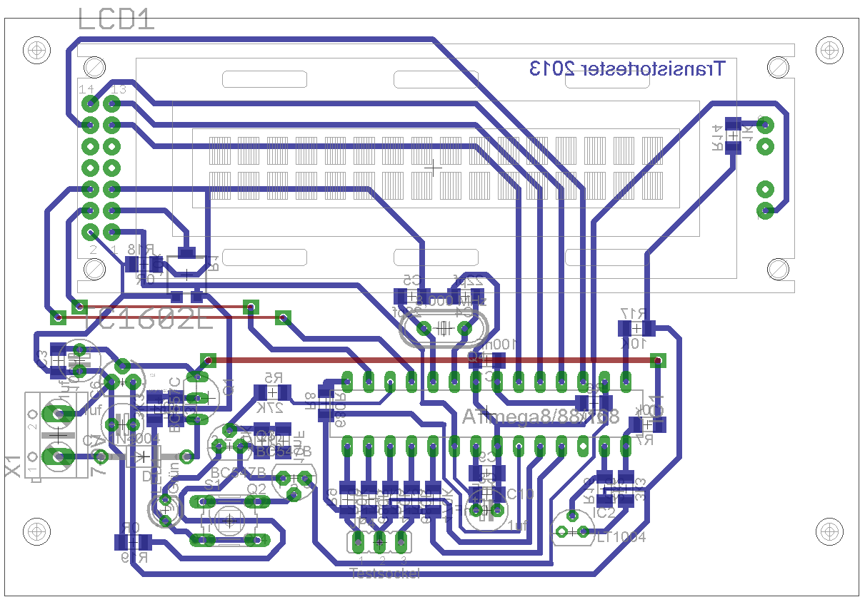

von mirror (Gast)
Tom666's layout needs to be mirrored, I found it out the hard way :(
von Tomas P. (tom666)
Mirrored variants of PCB templates for Mr. "mirror" :)

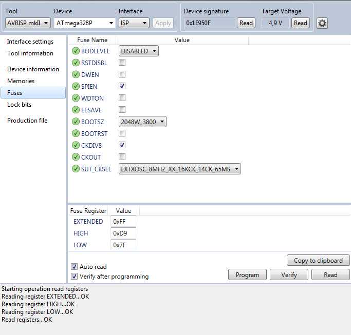

von interessant (Gast)
Ne, da flackert nichts.
Die Klötzchen sind in beiden Zeilen und der Kontrast laesst sich
einstellen...
Passt die Firmware?
Fuses hab ich gerade auf -U lfuse:w:0xe2:m -U hfuse:w:0xdc:m -U
efuse:w:0x01:m (ohne Quarz).
von Karl-Heinz K. (kubi48)
> einstellen...
Wurde der ATmega168 richtig programmiert?
Es muß die .hex in den flash Speicher, die .eep ins EEprom.
Dabei darf aber NICHT beim zweiten Brennen der ganze Chip gelöscht
werden!
Sonst die Betriebsspannung direkt an den ATmega Pins überprüfen.
Der Pin PD6 (12) wird direkt beim Programmstart auch auf VCC Pegel
geschaltet. Wenn dieser Pegel fehlt, läuft das Programm nicht.
Grüße, Karl-Heinz

von MadMax (Gast)
Hello,
For ATmega328p with external crystal 8Mhz i saw at post
Beitrag "Re: Transistortester AVR"
tom666 recommends
lfuse:0xff hfuse:0xd9 efuse:0xfc
however when you set fuses with crystal with Karl-Heinz make file it
uses:
lfuse:w:0xf7:m -U hfuse:w:0xd9:m -U efuse:w:0xfc:m
Difference is at low fuse FF specifies exactly an external 8Mhz crystal
while F7 just an external without value.
which is better to use?
With the low fuse value 0xf7 you choose the "full swing" crystal mode,
a value of 0xff defines the "low power" crystal mode.
The "full swing" mode is more resistant to external jamming.
The "low power" mode save a little supply power.
Normaly both modes are useable. The measurement results should not
differ.
Best Regards, Karl-Heinz
von MadMax (Gast)
thank you for your info. was important to clear thinks however i face
some measure mulfunctions. tried both 0xf7 and 0xff. no diference as
already said.
Photo1: 47uF measure at probes 1-3
Photo2: 47uF measure at probes 2-3 very wrong measurement; i sometimes
face such proplem with caps especially at probe 3, i think is not very
good probe connection as it fixes when i make contact better and then
works fine.
Photo3: 1000uF measurement as double diode whatever probe i use on every
test repeat.
Photo4: 1500uF measurement as above.

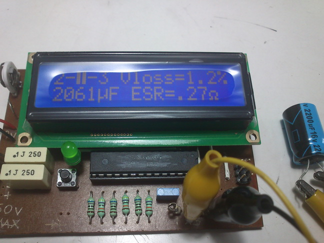

Photo5: 1500uF probes 1-3 measurement as above.
Photo6: 2200uF seems ok but i'm not sure about the tolarance.
Photo7: 4700uF same as above.
Photo8: another 4700uF same as above.
Seems that there is a gap at caps measurement from values 800uF-1500uF
(also tried 850uF) measured as diodes. Tried many times at different
probes still same result. caps were brand new.
is this a software bug? program version is 1.07
I also experienced a similar problem with v1.07. Try a new test version
1.08k.
have you made the selftest (calibration) before the measurements?
I wonder about your result 47_2_3_Wrong.jpg. The 140 Ohm result of the
ESR measurement shows, that there is a problem with the connection.
If I measure a 47uF capacitor, the result is 46.5uF for pin 1:3 and
46.7uF for the pin 2:3 combination.
The software version 1.07 has a problem to identify the capacitor. But I
had noticed this problen only with some capacitors.
The reason for this problem is, that a diode is not identified by the
current flow direction. The current flow direction can not be used for
two reverse directed diodes. The diode is identified by the flux
voltages with the 680 Ohm and 470 kOhm resistors. The voltage behavior
of a diode differs from that of a resistor. In version 1.07k the voltage
with the 680 Ohm resistor is measured before the measurement with the
470k resistor. For a perfect capacitor the voltage of the second
measurement should grow. But sometimes some electrolytic capacitors
don't do so.
In the developer version (pre_1.08k) the sequence of the tests is
swapped to avoid this problem, but this version has more problems to
detect a parallel circuit of capacitor and diode.
You should make the calibration with selftest, but you should use better
connection cables. The voltage values of Test 2,3,5,6 and 7 should be
below 10mV.
Regards, Karl-Heinz
von Pete K. (pete77)
Guten Tag,
ich finde den Fehler nicht. Der Spannungsregler bekommt keine Spannung,
auf Kurzschlüsse habe ich intensiv geprüft.
Hinter der Diode liegen 8,8V an, sollte für einen MCP1702-5002E reichen.
Kann jemand einen Fehler in der Schaltung entdecken?
Besten Dank!
von MadMax (Gast)
I had already made a selftest before the measurements.
But now after a closer look and the readme pdf, seems that the results
of some tests aren't so good.
T2 +RL- 1 1 1
T3 +RH- -11 -9 -4
T5 RH-  28 28 35
T6 RH+  -32 -35 -41
T7 RH/RL 0 0 0
Ri_Hi=22.3 ohm
Ri_Lo=20.5 ohm
According to pdf tests 5-6 must have a lower value.
I wil try to reclean the pcb or try a different atmega328.
seems that something is wrong with the 470k resistors. Or this is
because of their tolarence (i use 1%)
I also try version 1.08. it stills fails to detect caps from
850uf-1500uf.
But as my curcuit has mistakes, maybe this is not a firmware issue. And
as you explain you are already familiar with this.
von MadMax (Gast)
Pete K. schrieb:
> Guten Tag,
> Besten Dank!
hello,
LT1004 pin3 not connected to GND
Also R16 not connected to GND.

Pete K. schrieb:Kann jemand einen Fehler in der
Hallo Pete,
nach meiner Meinung bekommt der LT1004 und der 3.3k Widerstand keine
Masse (GND) Verbindung.
Wegen dem Einschalten sollte man prüfen, ob der PNP Transistor (Q1)
durchgeschaltet wird, wenn der Taster gedrückt wird.
Bei gedrücktem Taster kann man die Spannung an den Versorgungspins des
ATmega (VCC/AVCC) auch ohne eingesteckten Prozessor messen. Die GND
Verbindungen kann man vorher mit einem Ohmmeter prüfen.
Viel Glück bei der Fehlersuche,
Karl-Heinz

von Jörn P. (jonnyp)
Der 4040 hat keinen gnd, der µC kein vcc.. weiter habe ich gar nicht
geschaut.
> Hallo Pete,
> Karl-Heinz
Hallo Karl-Heinz,
danke für Deine Antwort.
Die GND-Verbindung vom LT1004 habe ich ergänzt. Das war eine
Schaltplanänderung in letzter Sekunde.
Den Q1 habe ich mal ausgetauscht. Es liegen nach Anschluss der Batterie
an B und E jeweils 8,5V an, an C 0V.
Beim Drücken des Tasters messe ich eine Spannung von 1,6V am Kollektor
von Q1.
Das ist zuwenig für den Regler.
Mit dem Ohmmeter habe ich keine Kurzschlüsse gefunden.
VG,
Pete
@Pete K (pete77):
You have no connected power (+5V) to the MCU. Pin7 (Vcc) must be
connected to +5V. Do this for instance by the attached picture.
Tomas P. schrieb:
> @Pete K (pete77):
> connected to +5V.
The MCU becomes connected to VCC via S1.
> von Q1.
Hallo Pete,
das ist deutlich zu wenig Spannung am Kollektor.
Der Q1 sollte einen Stromverstärkungsfaktor von über 200 haben, der
Basisstrom bei gedrücktem Taster sollte über 2mA liegen.
Die Stromaufnahme aus der Batterie kann man mit einem Amperemeter
messen.
Wenn hier kein großer Strom fließt, ist entweder der Basiswiderstand
3.3k falsch bestückt oder der Transistor Q1 wird invers betrieben
(Kollektor und Emitter vertauscht). Möglicherweise kann auch noch der
Basis-Emitter Widerstand (33k) falsch bestückt sein.
Die Spannung am Taster gegen GND sollte kleiner 0.8V sein.
Die Spannung zwischen Emitter und Basis von Q1 sollte größer als 0.6V
sein.
Grüße, Karl-Heinz
Kannst Du bitte noch einmal auf dem Schaltplan schauen, ob das so seine
Richtigkeit hat? Die Bestückung ist ok, wenn dann tippe ich auf einen
Fehler im Schaltplan.
Vielen Dank!
@Pete K.(pete77):
Your circuit diagram is wrong in terms of power the MCU. Repair the
connection according to the attached image.
Note:
S1 starts the MCU and continuously establishes activate the measure
(test).
Tomas P. schrieb:
> @Pete K.(pete77):
> Note:
> (test).
You are correct, pcb is repaired. Thanks!

Damit ist es nicht getan, der Quarz (in Deutschland ohne "t")muss auch
per Fusebits im AVR angemeldet werden. Ansonsten klappert der AVR
weiterhin mit seinem internen RC-Generator vor sich hin.

It published a new version of the software.
I had the same problem in version with the date 30.06.2013.
Now, thanks to Mr. Karl-Heinz Kübbeler measurement is OK.
Freshly compiled a new version is attached.
Thanks
herb hauser schrieb:
> Die 3 verwendeten 1000er-Kondensatoren werden als Doppeldiode angezeigt,
> der Test ist auch viel schneller beendet. Einen 470µF wird richtig
> gemessen und der Test dauert länger.
die falsche Detektion eines Diodenverhaltens entstand durch eine
vertauschte Testfolge und einem erweiterten Gültigkeitsbereich für das
Diodenverhalten (wegen Germanium-Dioden und Leistungsdioden).
Die vermeintliche Diodenspannung wird mit dem 470k und den 680 Ohm
Widerstand gemessen.
Ein 100uF Kondensator bringt etwa folgende Spannungen:
18mV mit 470kOhm,  224mV mit 680 Ohm
Die Werte einer Basis-Emitter Strecke eines AC176 Transistors:
27mV mit 470kOhm,  232mV mit 680 Ohm
Die neue Entwicklerversion prüft wegen des sehr ähnlichen Verhaltens die
Spannung mit dem 470k Widerstand noch einmal nach der Prüfung (Ladung)
mit dem 680 Ohm Widerstand. Die Spannung darf dabei nicht über der
Spannung mit dem 680 Ohm Widerstand liegen, damit das Bauteil als Diode
erkannt wird.
Die 18mV mit dem 470k Widerstand sind sicher nicht durch den Ladestrom
mit diesem Widerstand entstanden, sondern eher durch eine interne
Umformatierung im Elektrolyt nach dem vorherigen Entladen (Vloss
Effekt).
Auch bei den älteren Softwareversionen konnte es zu einer
Falscherkennung eines Elektrolyt-Kondensators kommen. Eine universelle
Erkennung ist halt nicht ganz einfach.
Neu ist auch bei der Entwicklerversion, daß Versionen für den ATmega328
angeboten werden (Unterverzeichnis mega328 und mega328_strip_grid).
Bei der ATmega168 Version wird aus Platzgründen auf die hFE (B=)
Bestimmung in der Emitterschaltung verzichtet. Bei der ATmega328 Version
wird die Stromverstärkung sowohl in der Kollektorschaltung als auch in
der Emitterschaltung bestimmt. Das höhere Ergebnis wird ausgegeben.
Bei der Emitterschaltung wird jetzt auch der Kollektor-Reststrom (ohne
Basisstrom) berücksichtigt.
Grüße, Karl-Heinz
> T2 +RL- 1 1 1
> T3 +RH- -11 -9 -4
> T5 RH-  28 28 35
> T6 RH+  -32 -35 -41
> T7 RH/RL 0 0 0
> Ri_Hi=22.3 ohm
> Ri_Lo=20.5 ohm
> The T5 (RH-) and T6 (RH+) test switch the analog input with the 470k
> resistor to GND (RH-) and VCC (RH+). The exact value of the resistor is
> not important for this tests, the 1% tolerance should be good enough.
> The T3 (+RH-) compares the value of the 470k resistors. Probably the
> higher differences of this test can be caused by the 1% tolerance of the
> 470k resistors.
> If all 470k resistors have the same wrong value, this error can only be
> detected by the T7 (RH/RL), where the relation of 470k to 680 is
> measured. But only big errors can be detected with this test.
> The results of the T5 and T6 shows, that the analog inputs seems to be
> pulled to a middle voltage (2.5V). I don't know why this happens.
> Cleaning of the board may be a way to solve the problem. But I don't
> know, why all three ports have a simular problem.
> Best Regards and good luck for searching the error source,
> Karl-Heinz
Finally, the error source came from the probes. Low quality probes cause
wrong values during the selftest.
without probes these values were measured:
T2 +RL- -4 -4 -4
T3 +RH- -5 -5 -2
T5 RH-  2 2 2
T6 RH+  -4 -4 -5
T7 RH/RL 0 0 0
Ri_Hi=22.6 ohm
Ri_Lo=20.9 ohm
which seems ok. so everyone be carefull about the probes you use!
Furthermore, i notice some caps measurement difference with or without
external 8Mhz crystal.
values with lfuse:0xf7 using 8Mhz external crystal:
4700uF--> 4216uF
2200uF--> 2067uF
1500uF--> detected as double diode
470uF --> 458uF
220nF --> 205nF
values with lfuse:0xe2 using RC:
4700uF--> 4224uF
2200uF--> 2123uF
1500uF--> 1521uF
470uF --> 464uF
220nF --> 207nF
Just disabled external crystal with fuse on the same pcb.
All measurements done without using any probes.
Shouldn't be crystal measurements be more accurate than RC?
I used previous software version with the "caps bug" but as you can see,
in RC mode software was able to measure the 1500uF cap. Change only the
low fuse to 0xf7 couldnt detect it anymore.
Whats your opinion?
> Whats your opinion?
I miss the latest steps of the selftest (calibration).
The measurement results of the zero capacity measurements should all
three be near by 40pF. For the last step of selftest you have to connect
a high quality capacitor with more than 100nF to pin 1 and pin 3. Two
voltage correction values are found with this external capacitor.
The wrong detection of a diode with the 1500uF capacitor is caused by a
simular voltage behaviour with the test sequence of version 1.07k. The
voltage window for diode detection was increased for the detection of
older germanium diodes.
The latest developer version 1.08k (Software/trunk/ path) has extended
the test sequence for avoiding the capacitor / diode detection error.
You should use the Software/trunk/mega328 or
Software/trunk/mega328_strip_grid files for further testing. The older
default and mega168_strip_grid directory hold the ATmega168 versions,
which have not included the hFE (B=) measurement with common emitter
circuit.
It is difficult to say, which measurement results are clother to the
real capacity values, the one find out with or without the crystal.
As you can see in the PDF documentation, the measurement of electrolytic
capacitors capacity value is not easy to do. The results of high quality
capacitors (foil type) usually have a more accurate result. The most
false capacity results I had noticed with old paper isolated capacitor,
which can be identified by a high Vloss result.
The different behaviour with the 1500uF capacitor measurement may be
caused by the different wake up delay in crystal or RC oscillator mode.
The software must take care of this different delay time with the
Makefile option RESTART_DELAY_TICS=6 , if you use the RC oscillator. Or
you have to set the INHIBIT_SLEEP_MODE option. In this case the sleep
mode is never used for wait times, but this will increase the current
consuming.

von Ronnie T. (ronnie_t) Flattr this
Here's mine running Version 1.08k FIXED..
Regards,

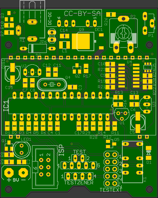

von Moritz A. (moritz_a)
da ich nochmal mein Board in aktualisiert bestellen muss, und die Preise
ja nicht wirklich linear mit der Menge skalieren, kann ich folgendes
anbieten:
- 2 Mitbesteller; 4€ pro Board + Versand

Strapubox 6000, Schutzrelais sowie 30V-Zenertest sind mit drauf, dazu
PWM-gesteuerte Display-Hintergrundbeleuchtung. Das Dipslay ist aus der
dogm-Serie,
http://www.reichelt.de/?ACTION=446&PROVID=2690&SEARCH=DOGM%20162 damit
es ins Gehäuse passt. Was davon wie bestückt wird ist natürlich
persönliche Wahl.
U5 kann ich bei Bedarf auch gleich einlöten, die restlichen SMD-Teile
sind mindestens 0805 oder SOT-23 und damit auch für ungeübte lötbar.
Bilder vom Prototyp, noch mit etwas anderem Layout, gibt es unter
https://plus.google.com/u/0/104891266768880083812/posts/fyVQ8cj3mdR.
Am besten per Nachricht hier im Forum oder die Mailadresse hinterlassen.
und da hierzu auch schon Nachfragen kamen: Da die "Platinenstücke" eine
feste Mindestgröße haben, werde ich an jede Platine noch 2-3 (habe die
genauen Maße gerade nich im Kopf) der SMD-Adapter anhängen, um den
Restraum besser auszunutzen.
Von der Hauptplatine sind sie durch einen V-Schnitt getrennt,
untereinander aber nicht. Da darf dann jeder selber die Säge ansetzen,
für alles andere will der Fertiger wieder mehr Geld haben.
Grüße
Moritz

von Mathias B. (bzzz)
Mal ne "kurze" Meldung von mir, wenn alles fertig und eingebaut ist,
schieb ich noch Bildmaterial nach.
Hatte gestern mal Zeit, meinen schon länger rumstehenden
nichtfunktionalen Tester zu debuggen...und ging dann auch ganz schnell,
manchmal müssen Ideen eben reifen. Pin 23 und 25 waren vertauscht, was
@Karl-Heinz die superduper Werte für Testpin 2 erklärt, während 1 und 3
komische Sachen fabrizieren. Aber wenn für den Selbsttest-Start alle
kurzgeschlossen sind, fällts auch nicht weiter auf. Seltsam ist dagegen,
warum der Kondensatortest zum Schluss mit 2-3 ging...naja, egal ;)
Jedenfalls lief das Schätzchen dann schonmal grundsätzlich, allenfalls
die Kondensatormessungen waren um den Faktor 8 zu klein, und ohne
Bauteil wurden stets 68-69 nF gemessen (hatte benek schonmal). Ersteres
riecht natürlich verdächtig nach falschem Takt, evtl. hatte ich früher
mal testweise auf 1 MHz runtergestellt. Nochmal Flashen und

Was sieht man nun auf dem 4/5-fertigen Teil? Ist ne 19"-Blende mit 4HE,
die mein rechtes Rack (das gleichzeitig u.a. diesen Tisch trägt) dann
komplettiert. Ich schätz mal, den Bauteiltester kann jeder ausmachen,
die Messstrippen laufen als ich glaub 0,75mm² weiter zum Tester und
kriegen noch ne steckbare Lüsterklemme zwischendrin verpasst. Das LCD
ist über das sichtbare Flachbandkabel und Pfostenbuchsen angebunden, je
zwei Adern parallel, sonst wär ja die Hälfte ungenutzt. Stromversorgung
geht auch dadrüber. Der Tester kriegt momentan noch Saft via USB, wird
dann aber fix auf 5V verdrahtet.
Untere Reihe von links: Ausgänge vom versorgenden ATX-Netzteil, also
3,3V (grün) / 5V (rot), 12V (gelb), darunter Massenbuchsen, die weißen
darüber sind -5V und -12V mit geringerer Belastbarkeit. Daneben 1x
SATA-Stromstecker und 2x satt belastbare USB-Ports. Rechts das umgebaute
Statron 3207, mit 30V@1A max, zwei statt einem Ausgang, massefrei (aber
über den grüngelben in der Mitte auf definiertes Potential ziehbar). Mit
Ausnahme der negativen Spannungen haben alle schöne China-Schätzeisen
dran, die sich mit meinem Multi recht einig sind. Das Labornetzteil hat
zusätzlich das jetzt fix auf Stromstärke verdrahtete Drehspulinstrument
dran, vorher konnte man via Umschalter entweder Strom oder Spannung
ablesen.
Obere Reihe von links hätten wir noch ne vorgesehene Anzeige für ein
ESR-Meter, danach der Transistortester mit seinen 3 Messpins und dem
gelben Resetknopp, und nebendran noch beliebig verdrahtbare Volt- und
Amperemeter, ebenfalls erstaunlich präzise für Chinazeugs. Dazu gehören
auch die drei Buchsen daneben. Und das grün-schwarze sind noch 4,2V/1A,
fürs direkte Laden von Lithiumzellen. Da hängt künftig ein auf 5V
umgebautes Ladegerät hintendran.
Rote und grüne LED rechts unten sind Begrenzungsanzeige des Statrons,
die rotgrünen Duos rechts oben sind Status des ATX-Netzteils und
Ladestand der beiden Lithiumzellen, die ein paar der Anzeigen mit
ripplefreiem, potentialgetrennten Saft versorgen.
Soweit von meinem Erstlingswerk mit dem echten Dremel ;)

Vielleicht schafft es ja nochmal jemand die Liste gegenzuprüfen, ich
habe sie zwar mehrfach geprüft, aber bekanntermaßen wird man irgendwann
Betriebsblind. 4-Augen sind manchmal einfach besser.

von Heinz K. (hagejot)
Hallo Moritz,
warum nicht zwei 10k-Widerstände in Reihe für R25 vorsehen?
MfG
Heinz
Das macht es schwer, sofern der passende Widerstandswert vorhanden ist,
da dann wieder Brücken gebaut werden müssen.
Allerdings kann man auch 22kOhm || 220kOhm = 20kOhm verwenden, und hier
einfach die Pads für den zweiten R unbestückt zu lassen ist ja kein
Problem.
Ich werde das wohl noch auf der Platine einbauen, Platz ist ja noch da
an der Stelle.
Grüße
Moritz
Hallo Moritz,
falls Platz vorhanden, wäre auch das möglich:
zweimal 10k in Reihe und 20k parallel dazu
  --o-[10k]---[10k]-o--
    |-----[20k]-----|
Viel Erfolg
Heinz
in der Theorie ja, nur sehe ich da ehrlich gesagt echt keinen Vorteil
mehr. Die Bestellbarkeit der Teile bei Reichelt ist auch anders gegeben,
und Mengenrabatt gibt es dort für die .1% sowieso nicht.
Grüße
Moritz
von Helge T. (htefs)
Heinz K. schrieb:
> Hallo Moritz,
>     |-----[20k]-----|
> Viel Erfolg
> Heinz
Ich denke, der Zielwert ist 20K??? Oder ging es nur darum, Platz für
eine Alternativbestückung vorzusehen?
Abgesehen davon: Wir wollen einen Widerstand mit 0.1% Toleranz haben.
Bei Reihenschaltung mag die Summe der Toleranzen ja vielleicht noch
unkritisch sein (max. 0,2%), aber bei Parallelschaltung von 22kOhm und
220kOhm macht man so aus 0,1% ganz schnell mal ca. 1% Toleranz
Das musst du mir mal zeigen. Ich rechne es dir aber auch gerne mal vor:
20k * 0,999 = 19,98k
20k * 1,001 = 20,02k
 22k * 0,999 =  21,978k
 22k * 1,001 =  22,022k
220k * 0,999 = 219,78k
220k * 1,001 = 220,22k
21,978k || 219,78k = 19,98k
22,022k || 220,22k = 20,02k
Ich sehe da kein 1%, ja nichtmal eine Verbesserung oder

von Mirko P. (mpa)
Moritz A. schrieb:
> - Reichelt hat keinen 0805-Widerstand in 20k, welcher für den
> Spannungsteiler Zener (R25) benötigt wird.
Könnte man für den Spannungsteiler nicht auch 162K/18K verwenden?
Die gibt es bei Reichelt.
Das ist sogar noch eine bessere Idee – soll mal einer deren Portofolio
verstehen, E24 nicht vollständig, aber E48 im Angebot.

von Mirko P. (mpa)
Moritz A. schrieb:
Qty     Parts                           Reichelt-BestNr         RWK-K  RWK        SB         SBK        SBR
   1    JP6                             T 250A RT               1      1                     1
Wie verbindest Du den Taster mit der Platine?
Ist dafür eine Steckverbindung vorgesehen?
Viele Grüße,
Mirko
Ich werde die Verbindung wohl direkt mit Drähten dran löten, wenn es
jemand anders machen möchte ist es natürlich seiner Phantasie
überlassen; für den 2.54mm-Abstand gibt es ja diverse
Steckverbindermöglichkeiten.

> test 4 (T4). The second action is to connect a high quality capacitor
> with more than 100nF to the test pin 1 and test pin 3.
Thanks Karl and Ronnie.
I connected the capacitor of 680nf and still said the same message. it
turned out I didnt set the fuses for external clock and system was still
running internal clock. After I burned the fuses for external clock (and
fix the dry solder on the clock) I was able to complete the selftest and
everything works fine now.
thanks for the help
Karthik

von MiniComp (Gast)
Hallo
Meinen Respekt für die Arbeit die hier geleistet wird.
Ich habe den Tester als Streifenraster nachgebaut.
Dazu habe ich die Software aus dem Trunk mega328_strip_grid Revision 180
verwendet.
Ich habe den Fehler der in der Dokumentation, das die Kapazitäten um den
Faktor 8 zu klein gemessen werden.
Laut derer würde der Takt mit 1 MHz arbeiten.
Die Fuses habe ich jedoch nach dem Bild eingestellt 8MHz extern. Sollte
doch passen oder nicht?
Wie muss ich die Fuses im Atmel-Studio6 einstellen das es korrekt
arbeitet?
Danke
von hp-freund (Gast)
CKDIV8 ?
von MiniComp (Gast)
Das war es schon
Vielen Dank

ein Verständnisproblem. Im Schaltplan wird PC0 zwischen R8/R9 und JP4.1
geschlossen...analog geht es mit PC1 und PC2. In der Boardansicht ist
aber P0 zwischen R12/R13 geschaltet, so dass eigentlich P0 und P2
vertauscht sind.
Für mich stellt sich hier jetzt die Frage, in wie weit muss dies in der
Software angepasst werden? Oder ist dies sogar schon berücksichtigt?
Hintergrund meiner Frage ist schlicht und ergreifend der Versuch, dieses
Projekt auf ein anderes Layout-Program zu portieren, da ich kein großer
Freund von Eagle bin (auf Grund der doch recht teuren Lizenzen) und
lieber das wesentlich kostengünstigere Sprint-Layout von Abacom nutze.
Da ich das Board nach dem Schaltplan route und das Board aus V5_1_4 zum
Vergleich habe, bin ich auf diese Unstimmigkeit aufmerksam geworden und
bin ich natürlich noch in einem Stadium, in dem alle möglichen
Änderungen einfach zu berücksichtigen sind. Sollte es also Grund für
eine Anpassung geben, so wäre ich  für einen Hinweis sicher dankbar.

von Asko B. (dg2brs)
Hallo Thomas
Ich hab mal in alten Dateien gekramt.
Bei mir stimmt das.
Bloss ist Messpin-1 und Messpin-3
wirklich vertauscht wenn man, wie ich,
die Messpins auf der "Loetseite" anbringt.
So wie ich auch Taster, LED und Display
auf dieser Seite vorgesehen hatte.
Karl-Heinz hatte deswegen in der Software
auch die moeglichkeit vorgesehen, die
Reihenfolge zu tauschen.
Version 5_1_4 ist nun wirklich nicht
die neueste. Und auch die neueren Versionen
bieten keinen Anspruch auf vollstaendige
Fehlerfreiheit.
Ich bin nur loetender Amateur und kein
professioneller Entwickler.
Was die kostenfrage von Eagle angeht:
Ich benutze einfach die Free-Version davon.
Bis zu einer halben Eurokarte brauchbar.
Wenn Du aber selbst eine Platine routen
moechtest, dann empfehle ich Dir mindestens
noch einen 10-20µF Kondensator direkt an
den Pins 7 und 20. (am besten SMD)
Die Notwendigkeit hat Karl-Heinz hier
desoefteren beschrieben.
Gruss Asko.
von Christian (Gast)
Hallo und guten Tag
Ich bin neu hier verfolge aber schon länger diesen Text.( Beitrag )
Habe ein Layout erstellt einseitig ohne isp und brücken könnte mal einer
ein Auge drauf werfen und sagen ob das so ok ist.
vielen Dank im voraus.
Christian
von Thomas G. (sumpfbulle)
Hallo Christian,
nach einem oberflächlichem Draufsehen fällt mir als erstes auf, dass
dein LM336 keine Masse bekommt...könnte problematisch sein.
Auch würde ich die nicht angeschlossenen Pins des Displays fest auf
Masse legen...mach ein Display verlangt das zwingend, andere akzeptieren
das auch so...hat bei mir aber schon mal Probleme gemacht.
Thomas
Hallo Thomas vielen Dank für deine Antwort.
Die verbindung ist schlecht zusehen durch den Kondensator.
Die nicht angeschlossenen Pins des Displays kann man ja wenn es so nicht
gehn sollte am Display gegen Masse legen.
mfg
Christian
